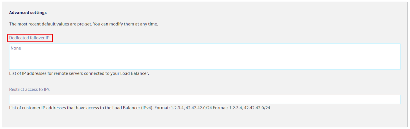

You can define dedicated Additional IPs via the by navigating to the Network section, then Load Balancer.
Once you have selected the Load Balancer you want to modify, navigate to the Front-ends tab, where you can either create a new front-end or edit an existing one.
In Advanced settings, you can select the Additional IPs you would like to associate with your front-end.
Configure the front-end by associating an Additional IP
Once the front-end has been configured, click Add or Modify, depending on whether you are configuring a new or existing front-end.
