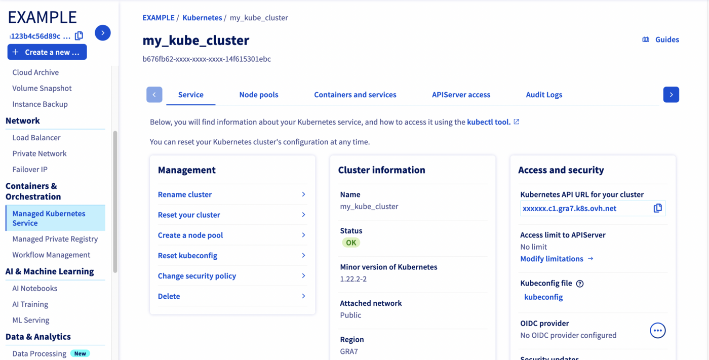

Click your cluster name to open its details page.
In the Connection information card of the Overview tab, click Download next to kubeconfig to download the kubectl configuration file.

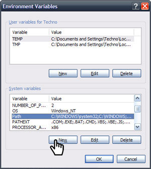

For Windows 7, 10 and 11 :
  1. From the Windows menu or Cortana search bar, search for "Modify system environment variables".
  2. In the System Properties window, click on the Advanced tab, then click the Environment Variables button near the bottom.
  3. In the window that opens, add a new variable, KUBECONFIG, with the path to the kube-config file as its value.
