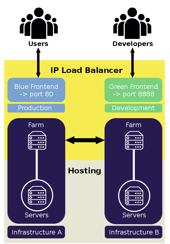

The principle of a blue-green deployment involves being able to switch easily from a development infrastructure to a production infrastructure, and vice versa. This switch must be done in a way that is transparent for your users. To do this, public traffic will be routed to the standard HTTP port 80 for access to the production infrastructure, and a non-standard port, such as 8888, will be used to access the development infrastructure.
Deploy the infrastructures
In this scenario, your Load Balancer service plays a central role. It is the element you use to expose your two infrastructures (production and development) to different users at the same time.
The production infrastructure can be accessed by your customers on the standard HTTP service (port 80), and your development infrastructure can be accessed by developers and admins on the non-standard port 8888.
During the initial setup phase, roles are provisionally assigned to each infrastructure component. Infrastructure A serves as the initial production environment, while Infrastructure B serves as the staging environment. At this stage, we will consider them to be similar to one another.
A blue-green infrastructure involves switching from infrastructure A to infrastructure B, once infrastructure B has been fully updated and validated. The Load Balancer will manage this switch.
The diagram below gives a general idea of the architecture:
General diagram of blue-green architecture

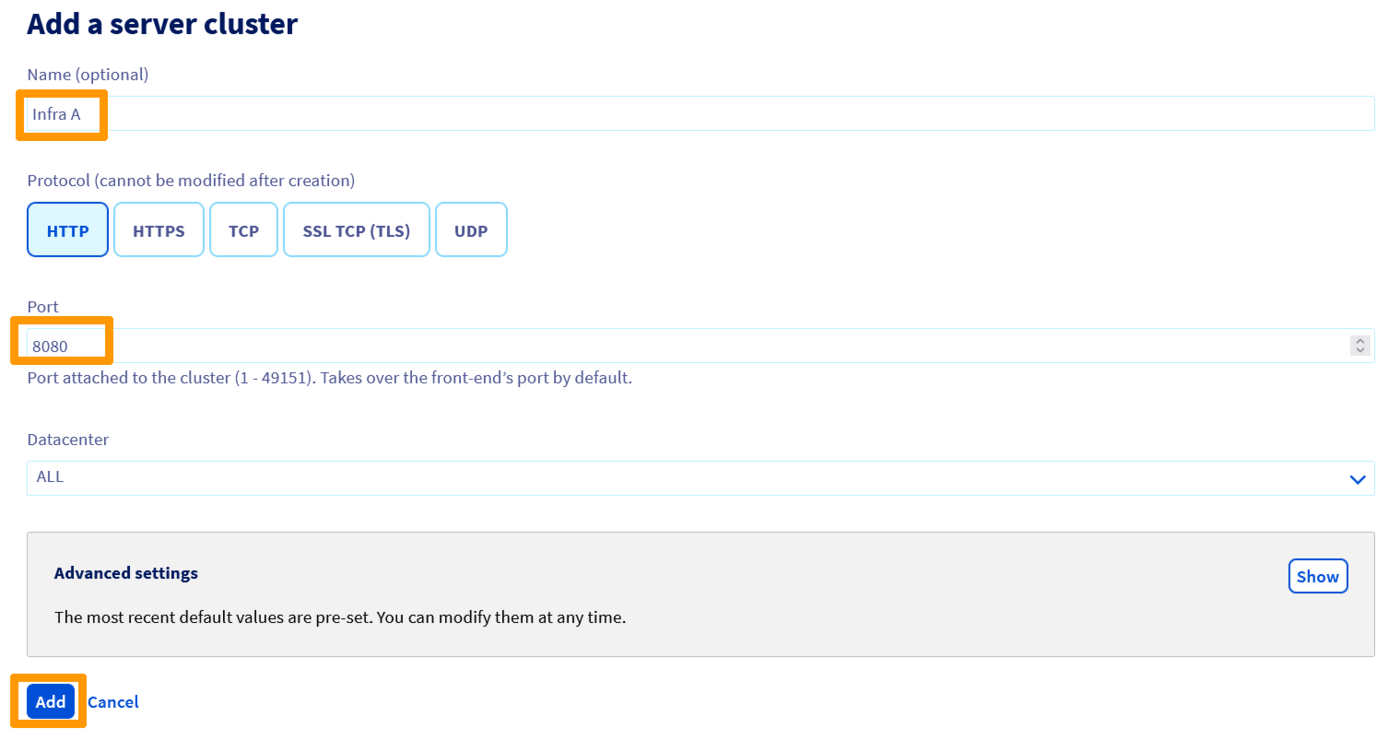

This infrastructure is made up of a server farm that will later be associated with a front-end of your Load Balancer. This farm will expose an HTTP, TCP or UDP service to the front-end. It also balances loads by sending the front-end's incoming traffic to the servers. For more details on the role of the various components of the OVHcloud Load Balancer service, please refer to the following guide: Introduction to the OVHcloud Load Balancer.
In our scenario, we will declare a farm of servers for the HTTP service. Please note that you can create as many farms (as well as TCP and/or UDP services) as are required for your final service to be exposed to your customers.
Via the OVHcloud Control Panel
Add a new HTTP farm dedicated to infrastructure A

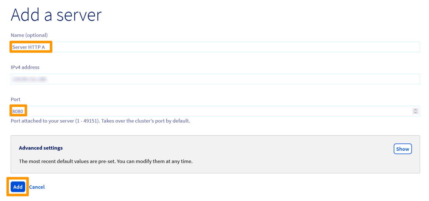

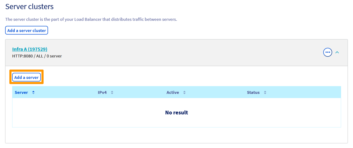

Link a dedicated server to your farm if it hosts your production infrastructure. The service is exposed to the front-end via the server's port 8080. Note that you may LINK one or more servers with each farm (for example, to balance the load or offer higher fault tolerance).
Add a new server to the farm HTTP A
Enter the HTTP A server's configuration
Via the OVHcloud API

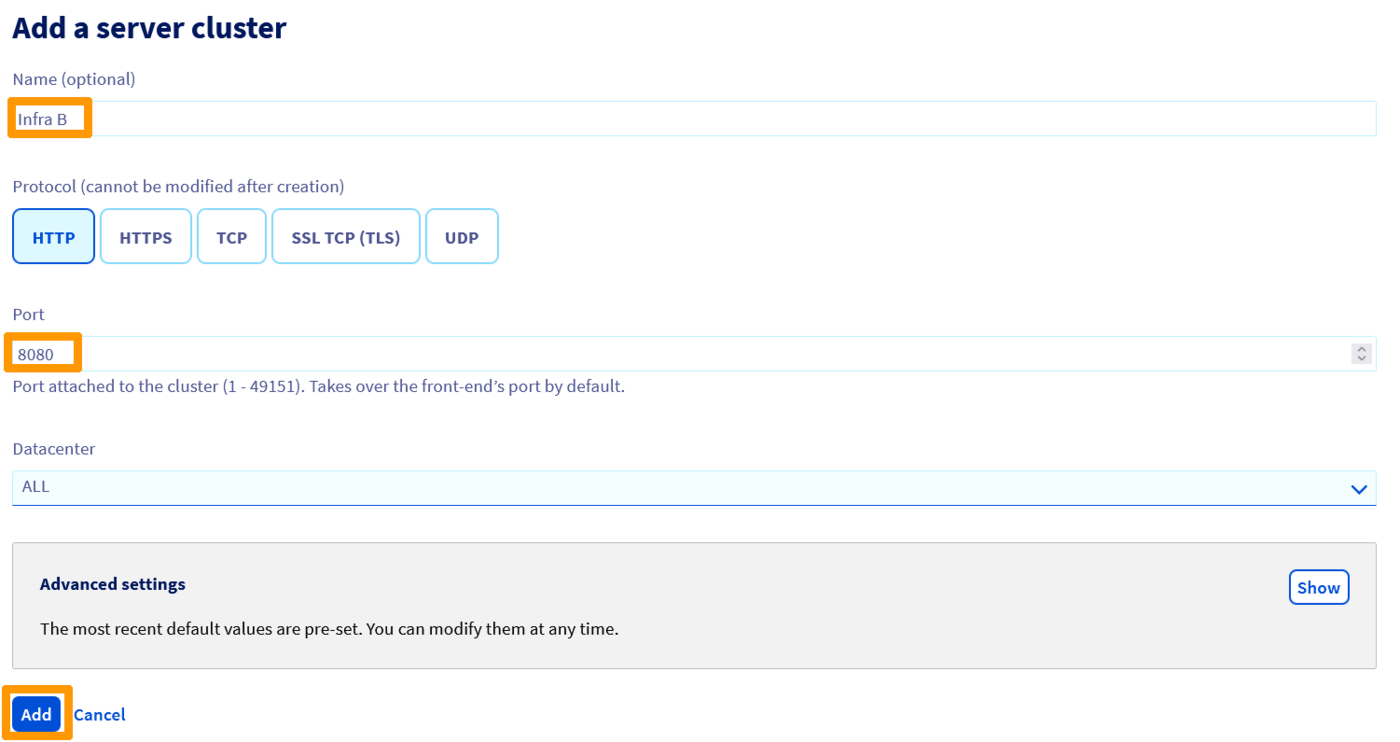

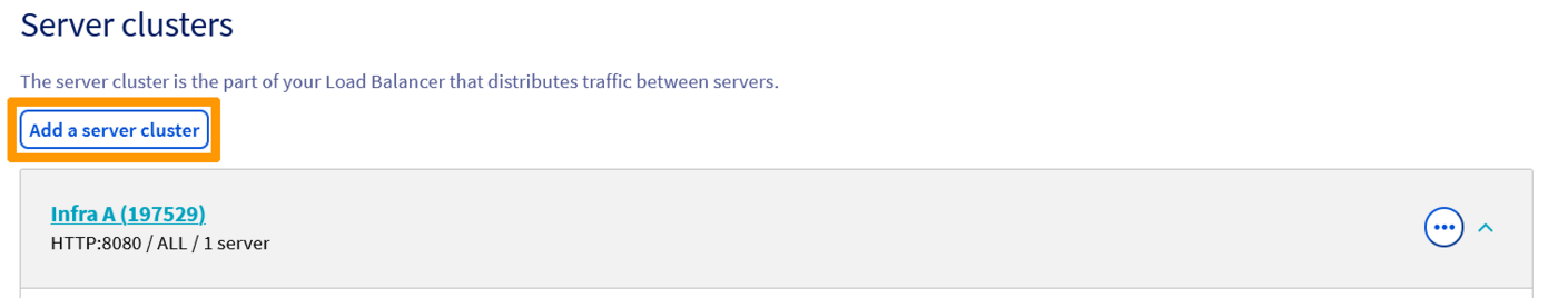

Infrastructure B
Functionally, this second infrastructure is identical to the first. It is also composed of a server farm that will later be associated with a second front-end of your Load Balancer. This server farm exposes the same service to the front-end as the first server farm. This service is supplied on the servers by port 8080.
Deploy the server farm for the HTTP service (and/or any other TCP or UDP services required for your final service to be exposed to your customers).
Add a new HTTP farm dedicated to infrastructure B
Create a second farm dedicated to infrastructure B

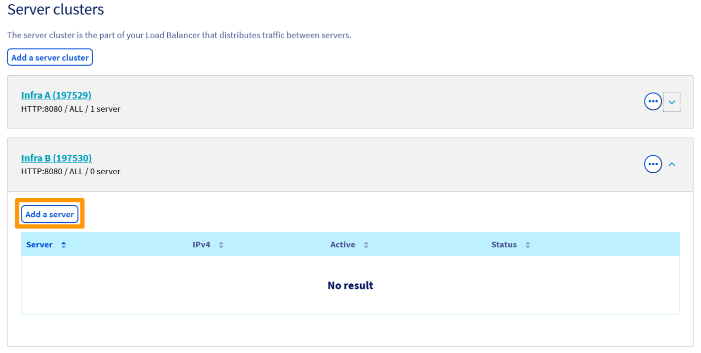

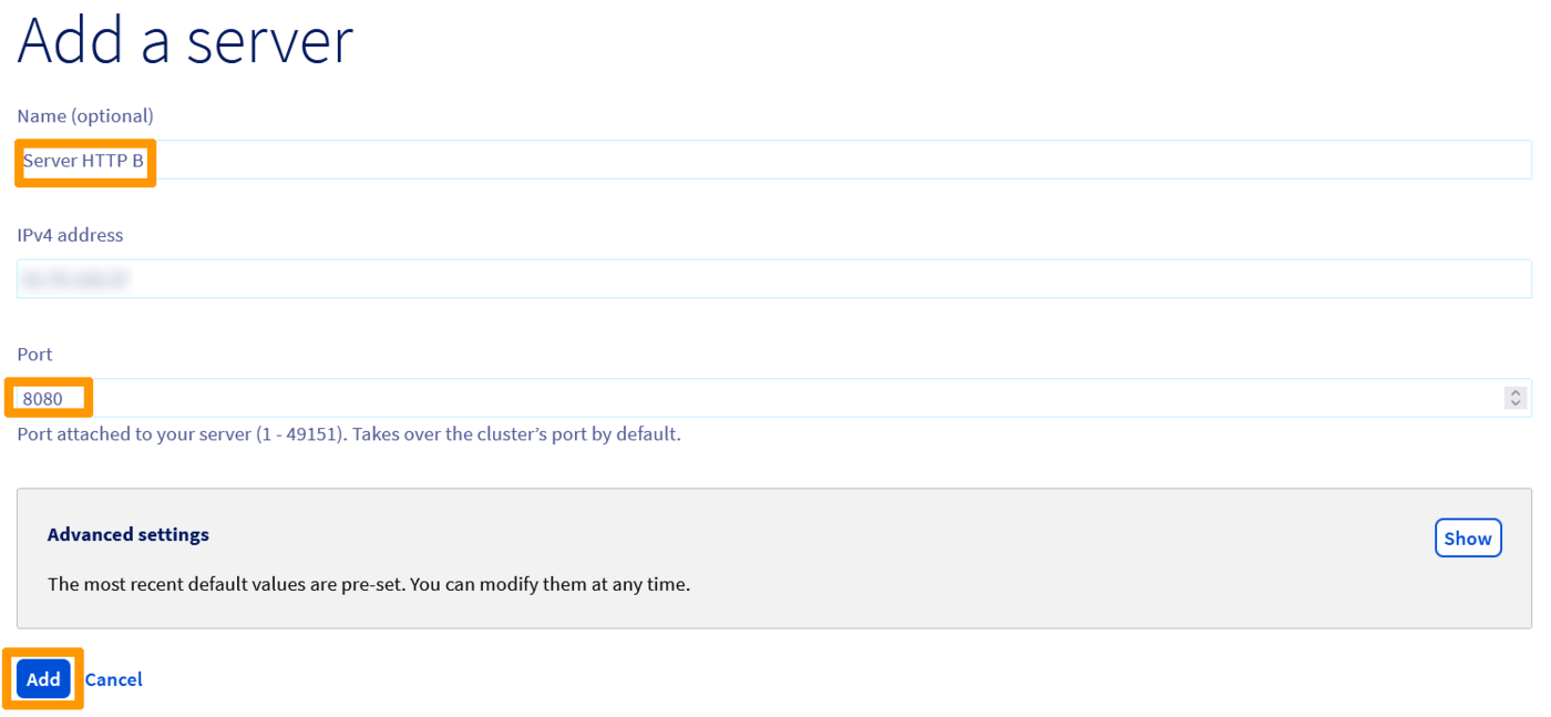

Associate a server with your farm. Here, it involves one or more physical servers hosting your development infrastructure.
Add a new server to the farm HTTP B
Enter the HTTP B server's configuration

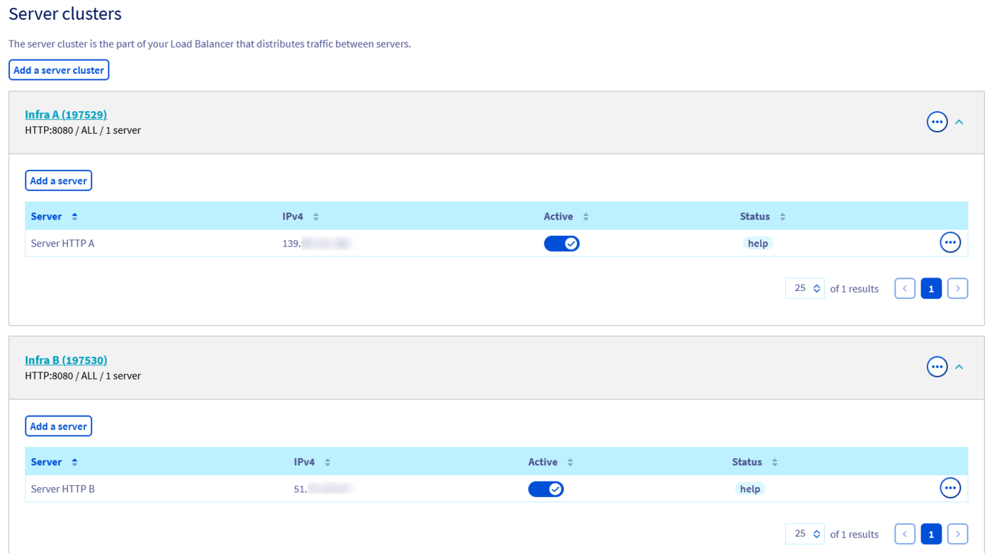

At this stage, here is the configuration status for your two farms:
Farm configuration

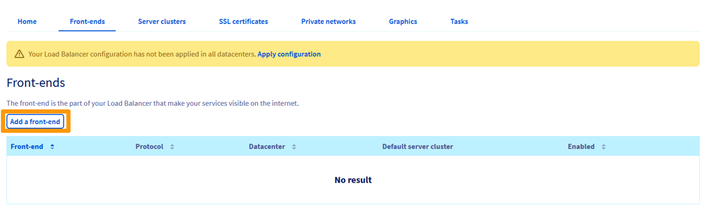

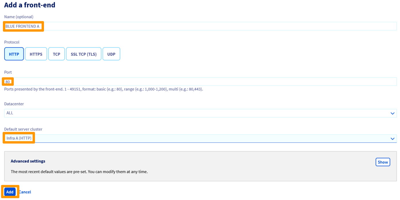

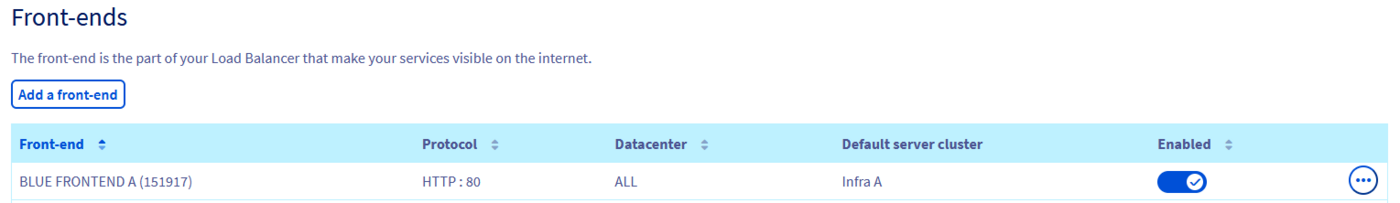

Blue front-end
This front-end is dedicated to accessing the production infrastructure. The ports exposed to your customers are the standard ports for accessing the service. In this case, we are exposing an HTTP service, so we will use port 80 (443 if you would like an SSL termination).
Adding a front-end dedicated to production, a blue front-end
Enter the blue front-end's configuration

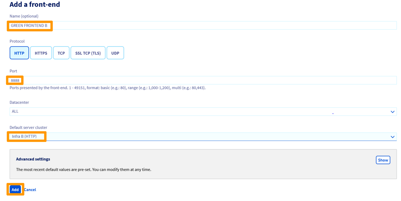

Green front-end
This front-end is dedicated to accessing the development infrastructure. The ports exposed to your customers will be non-standard ports that you can choose arbitrarily. In this case, we will expose the HTTP development service on port 8888.
Add the green front-end, dedicated to development
Enter the green front-end's configuration
SettingRequiredMeaningExample

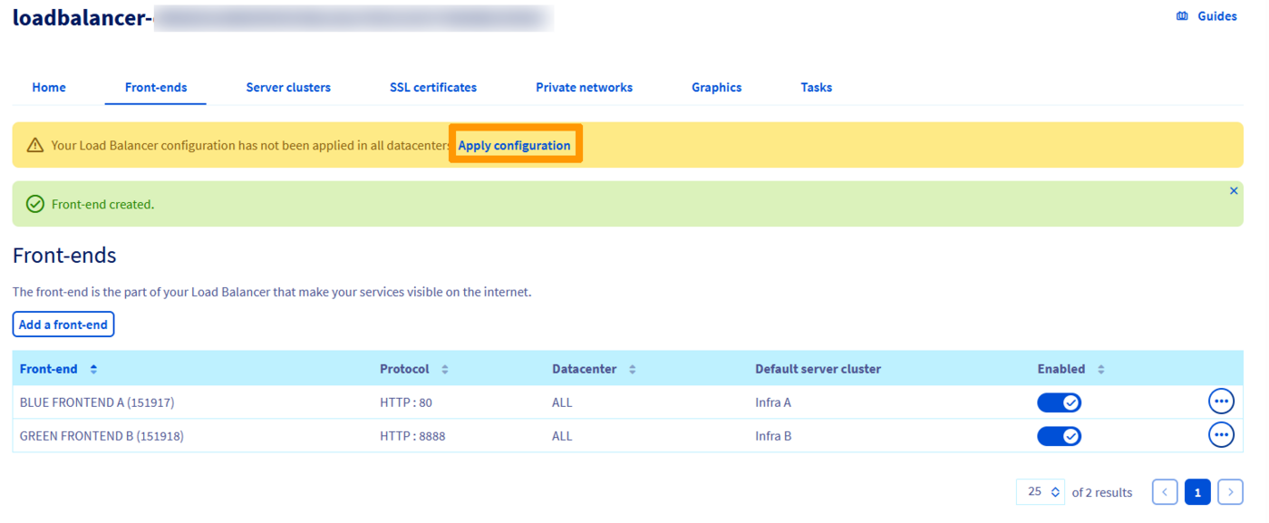

Once you have finished configuring the components of the OVHcloud Load Balancer service, the only thing left to do is apply your changes.
Apply your changes to the zone

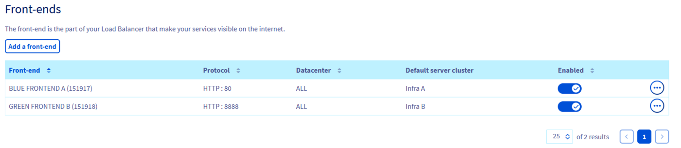

The production/staging switch
At this stage, our initial environment is deployed and ready to use. Now, you need to switch over your front-ends from one server farm to another.
Let's take a look at our scenario:
  • The production infrastructure (A) is deployed on HTTP farm A (id 77212), which in turn is attached to HTTP server A. This infrastructure can be accessed through the blue front-end.
  • The development infrastructure (B) is deployed on HTTP farm B (id 77213), which in turn is attached to HTTP server B. This infrastructure can be accessed through the green front-end.
Once you have modified/applied updates to infrastructure B and checked that the service is working properly, you can decide to put it into production.
To switch between the two farms, you can simply update your different front-ends by modifying the ID of the farm it is attached to, and applying the modification.
The blue front-end (id 70089) will then be associated with Farm B (infrastructure B, new production, id 77213).
The green front-end (id 70090) will then be associated with Farm A (infrastructure A, new development, id 77212).
This should be the result on the OVHcloud Control Panel after updating the front-ends and applying the new configuration:
Result after updating front-ends
