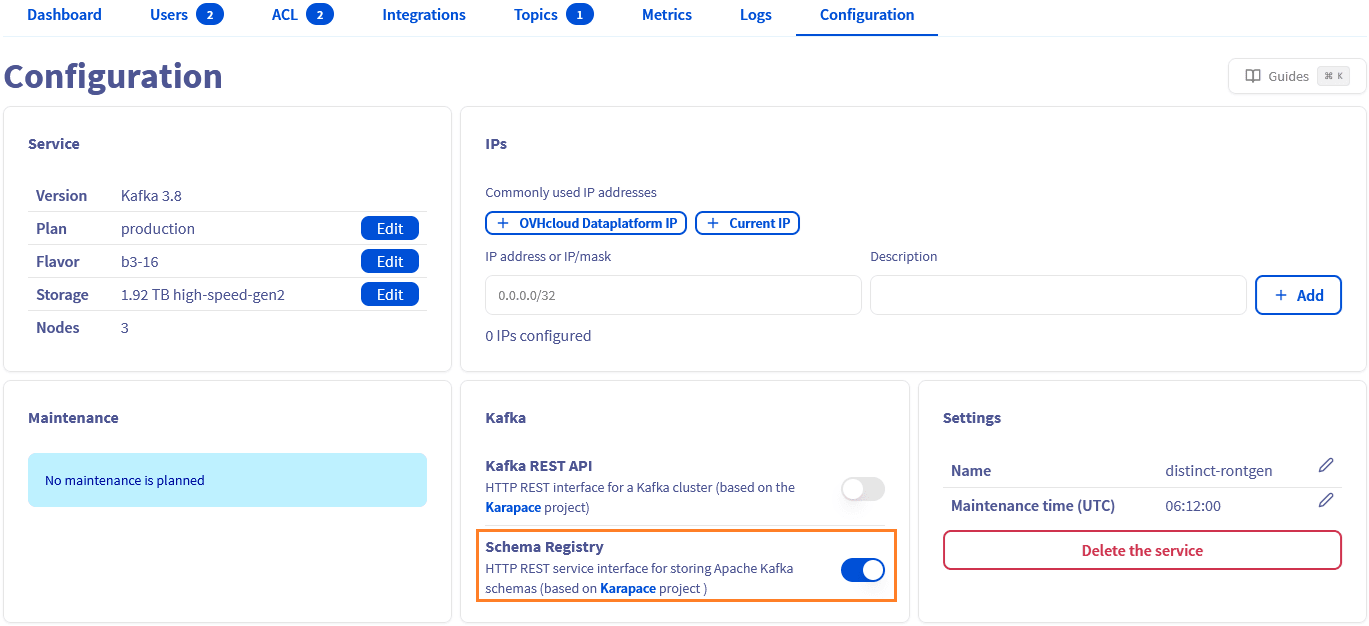

Go to the Configuration tab of your Kafka service. In the Kafka features section, turn on the Schema registry switch.
The Schema Registry can be disabled with the same switch.
