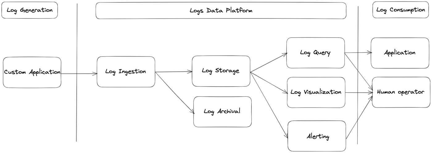

The Lifecycle of Logs
The lifecycle of logs can be split into 4 phases:
  • Generation: Logs are generated by applications, systems they are run on, or even by your cloud services. In most cases they are stored locally in files. You may decide to push some or all of them to Logs Data Platform, either using an appropriate SDK directly in your code or a log forwarder software such as Rsyslog, Logstash, etc. A log forwarder is a software that gathers logs from different sources (local files but potentially also remote systems), optionally transforms them and forwards them to a remote system or stores them locally.
  • Ingestion: Logs are received by the ingestion agents of Logs Data Platform, called inputs. They check the validity of the source, the formatting of the logs (following these guidelines) and may add, change or remove fields in your logs before forwarding them to the storage.
  • Storage: After ingestion, your logs are stored in Logs Data Platform. They can be stored under two non-exclusive forms: as indexed data that is exposed via APIs and other tools, or as archived data.
  • Consumption: There are many ways to use your logs. On Logs Data Platform, users can display logs in real-time, build dashboards, craft complex queries and launch them (via UI or API) and even define alarms.

Summary
To help you visualize the information of this guide, the picture below should sum up what each component from Logs Data Platform brings you:
 summary of the concepts described in this guide.
After reading this documentation, you should be familiar with most concepts used in Logs Data Platform. When you feel ready to work with Logs Data Platform, jump to the Quick Start guide to configure your service, create a first stream, send your first logs to Logs Data Platform and watch it appear on Graylog!
