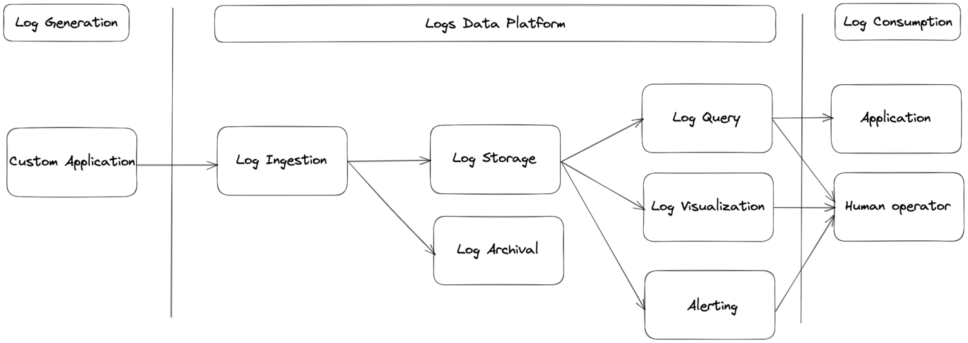

To help you visualize the information of this guide, the picture below should sum up what each component from Logs Data Platform brings you:
 summary of the concepts described in this guide.
After reading this documentation, you should be familiar with most concepts used in Logs Data Platform. When you feel ready to work with Logs Data Platform, jump to the Quick Start guide to configure your service, create a first stream, send your first logs to Logs Data Platform and watch it appear on Graylog!
