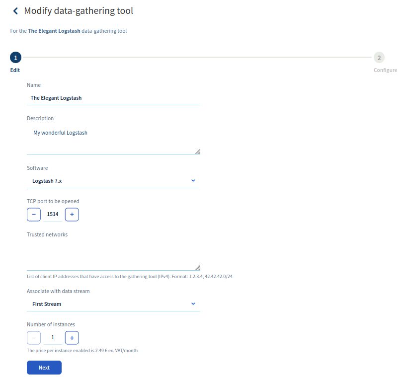

Exploit a dedicated Logstash Data-Gathering tool
Once you have activated the tcp or http logs of your HAProxy instance, you must then send them and transform them. For this part of the tutorial you will need your own dedicated Logstash collector. Logstash is one of the most powerful tool to transform logs. Create a Logstash data-gathering tool as described in the Logstash tutorial, and configure the port 1514 (or the port of your choice) as the exposed port.
edit\_logstash
Logstash collector configuration
As you may guess we have to configure the Logstash collector with some clever Grok filters to make the collector be aware of our field naming convention. The collector will accept logs in a generic TCP input and use grok filters to extract the information. Thanks to the wizard feature, you won't even need to copy and paste the following configuration snippets, but they are still given for reference purpose.

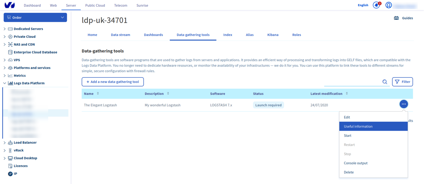

For the first action you will need the collector certificate and its hostname, you will find them both in the menu of your collector
collector\_menu
Copy the certificate in a file logstash.pem and copy the hostname and your port. Depending of your flavor of rsylog and HAProxy, your configuration file may be already present at a particular location. If you do not have any HAProxy related file in the directory /etc/rsyslog.d/, create a new file in this directory. If the directory does not exist , simply edit the /etc/rsyslog.conf file. Don't hesitate to review the rsyslog documentation to have more information. On Debian flavors for example, if you used the rsyslog and HAProxy packages you may have a file located in /etc/rsyslog.d/46-haproxy.conf. In that case, you should prefer editing this file.

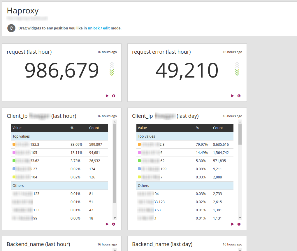

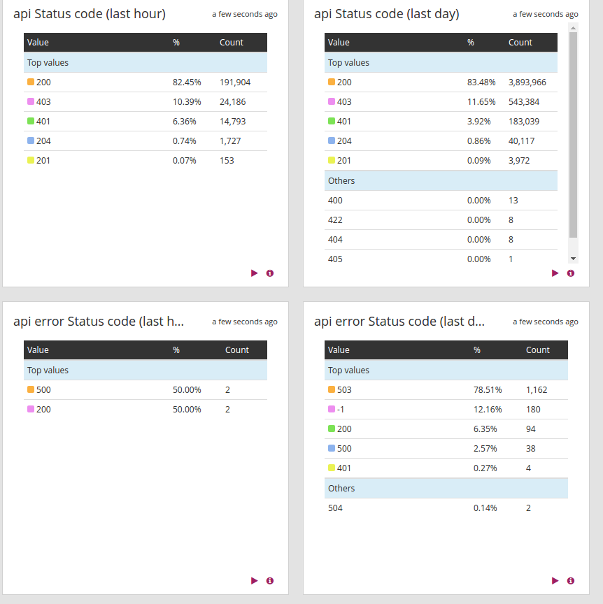

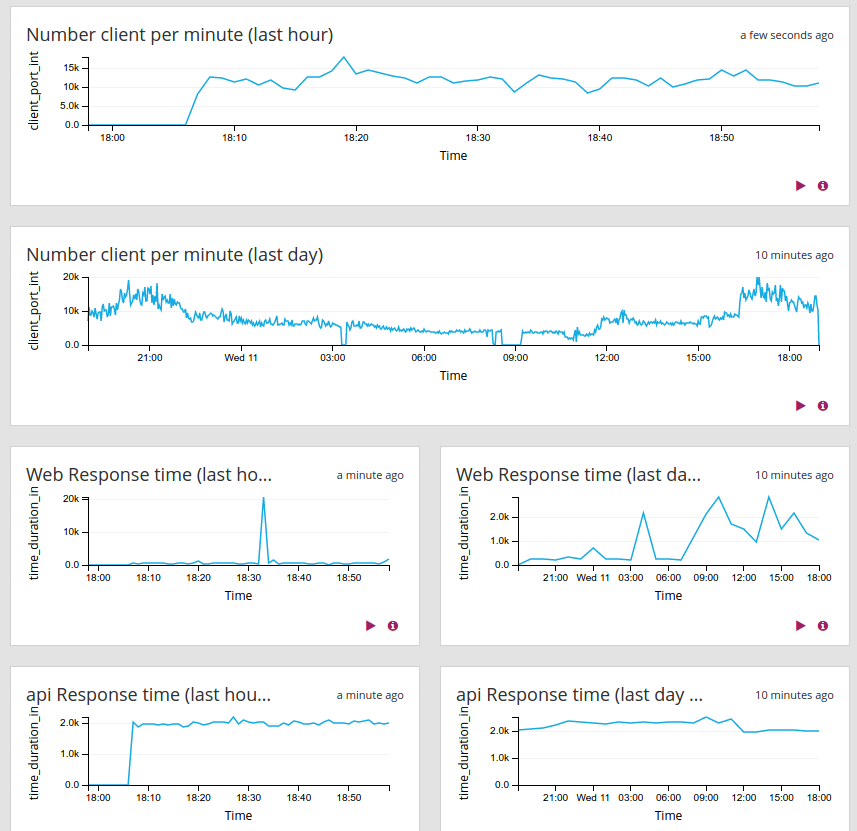

Dashboard and alerts
Here is an example of a dashboard that you can craft from the HAProxy logs. HAProxy logs give you a lot of information about your application and infrastructure. It's up to you to exploit them in whichever way suits you best. You can also configure some alerts to warn you when a backend is down or is not responding properly.
dashboard\_1 dashboard\_2 dashboard\_3
