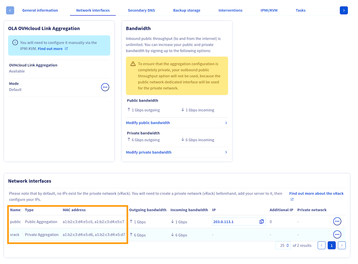

Retrieving MAC addresses
Switch to the tab Network Interfaces and take note of the MAC addresses for each interface (public/private) which are displayed at the bottom of the menu.
OVHcloud Control Panel
The main public interface handles public connectivity in the default configuration. Its MAC address is the aggregationFallback value of the public interface, which you can retrieve with the following API route:
