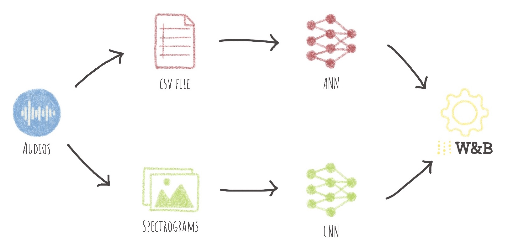

Hand-drawn diagram of two approaches where audio files are turned either into a CSV file fed to an ANN or into spectrograms fed to a CNN with both results sent to Weights and Biases
Here we will mainly discuss how to write the data processing and models training codes, the requirements.txt and packages.txt files and the Dockerfile. If you want to see the whole code, please refer to the GitHub repository.

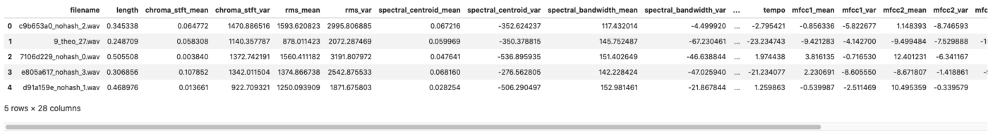

The head of the csv file:
First five rows of the extracted features dataframe with the filename length chroma_stft rms spectral_centroid spectral_bandwidth tempo and mfcc columns totalling 28 columns

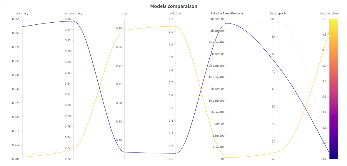

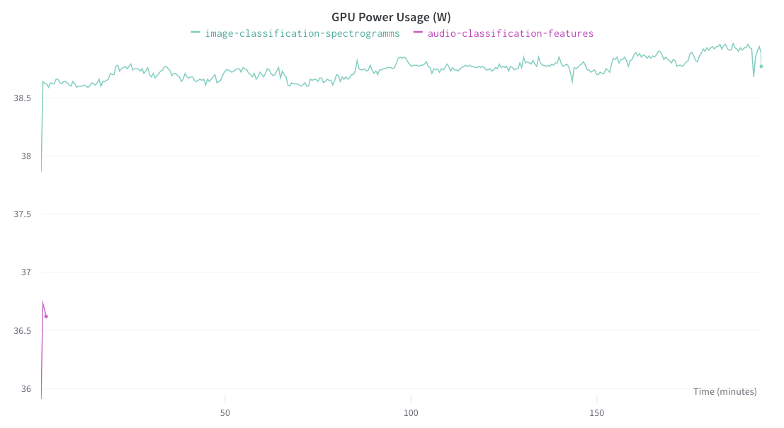

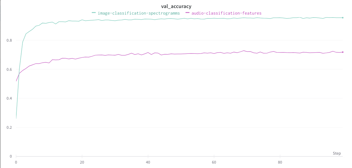

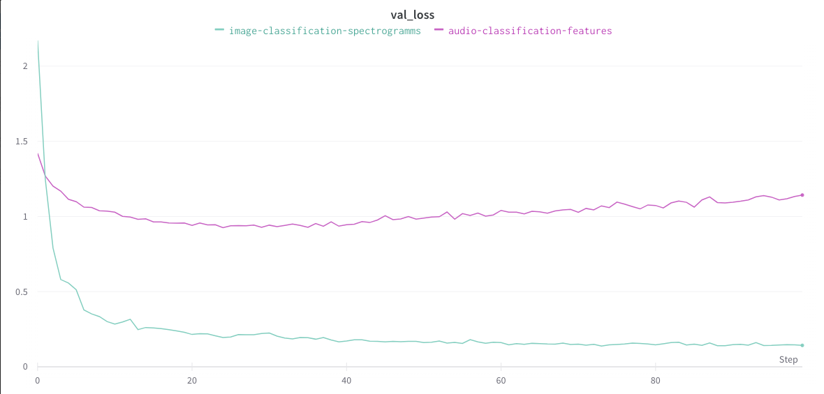

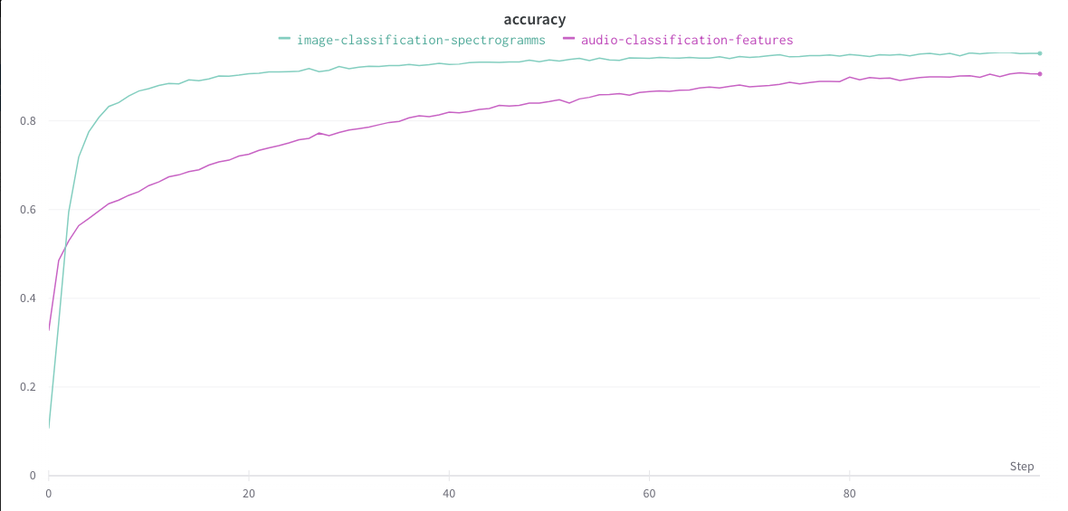

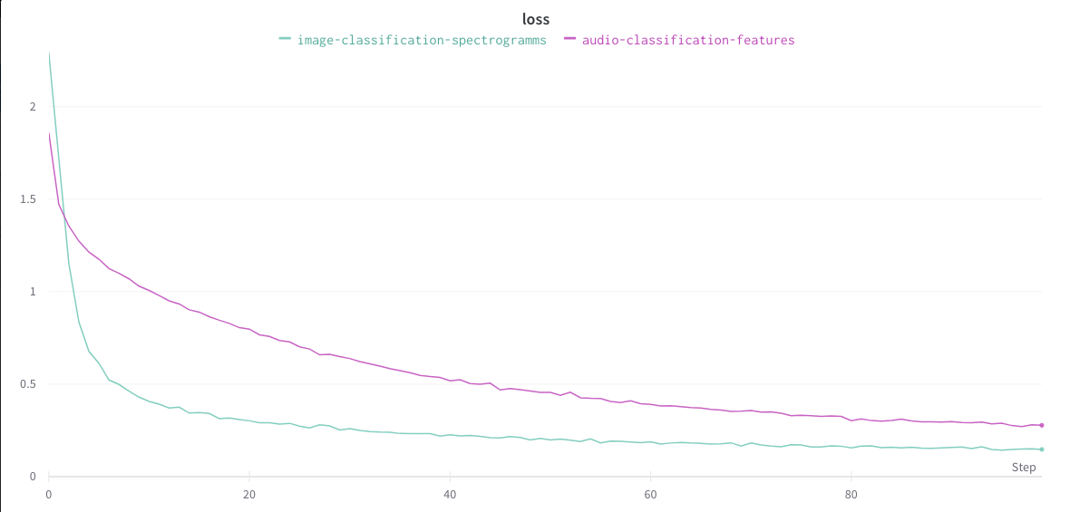

You can now compare your models with Weights & Biases.
Compare with Weights & Biases
You will be able to check your models training once your jobs are in running status. Run the following command:
ovhai job get <job-id>
Once the jobs are in running status, you can check the logs to obtain the Weight & Biases link. Run the command:
ovhai job logs <job-id>
Now, you can access the Weights & Biases panel. You will be able to check the accuracy and the loss values for the training and the validation sets.
  • Training data:
Accuracy:
accuracy chart where the image-classification-spectrogramms run rises above 0.9 while the audio-classification-features run climbs more slowly to about 0.9
Loss:
loss chart where the image-classification-spectrogramms run falls quickly below 0.2 while the audio-classification-features run decreases gradually to about 0.3
  • Validation data:
Accuracy:
val_accuracy chart where the image-classification-spectrogramms run plateaus above 0.9 while the audio-classification-features run plateaus around 0.7
Loss:
val_loss chart where the image-classification-spectrogramms run drops below 0.2 while the audio-classification-features run stays around 1 and rises slightly at the end
You can then observe which model is better in terms of speed, accuracy or resource consumption...
GPU Power Usage chart in watts where the image-classification-spectrogramms run stays near 38.7 W for almost three hours while the audio-classification-features run appears only as a brief spike near 36.6 W
In this case, we see that the model classifying the spectrograms is better in terms of accuracy and loss on the validation set.
However, it takes longer to train and consumes more computing resources.
