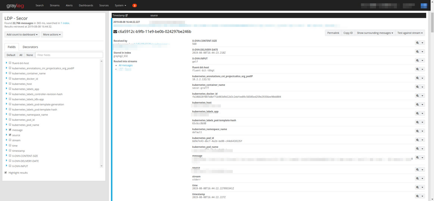

You can now open the stream interface to check that your logs are correctly structured.
Graylog stream showing a Kubernetes log entry with its kubernetes metadata as separate fields
Your Kubernetes activity is now fully logged in one place.
