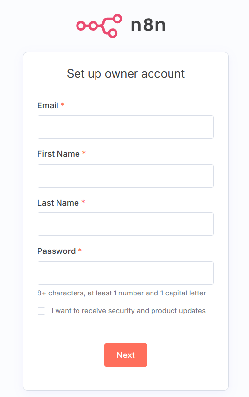

Since version 1.0 of n8n, you must create an administrator account when you first access your self-hosted instance, even if you already have an account on n8n.cloud. The accounts are specific to each instance. An account created on your VPS cannot be used on another instance, even with the same email address.

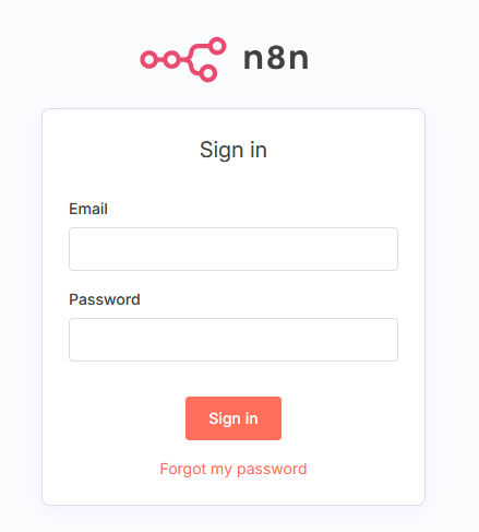

First access
Your n8n account is already created
A form for creating an account will appear. Complete it to configure the first admin user of your n8n instance.
