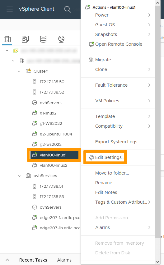

Go to the vCenter interface of your Hosted Private Cloud cluster.
Right-click the virtual machine and click Edit Settings.
03 Connect Network Card to Segment 01

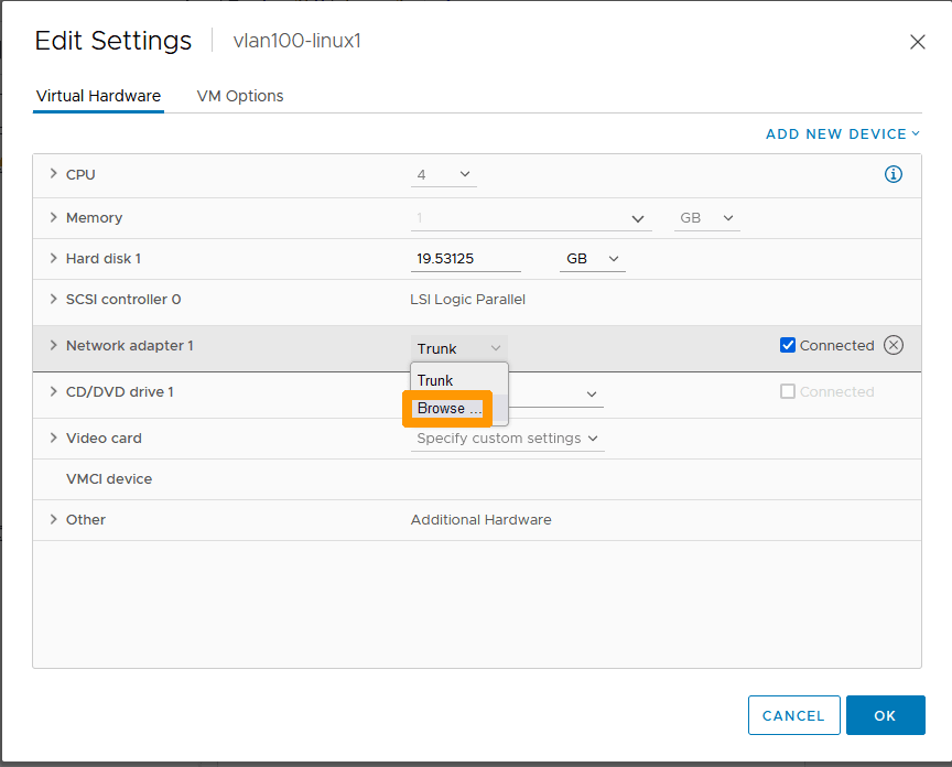

Scroll to the right of your network adapter and choose Browse.
03 Connect Network Card to Segment 02

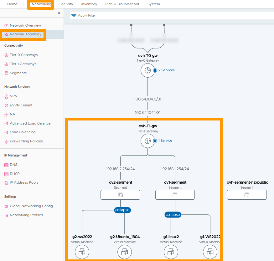

Go to the Networking tab, choose Network Topology.
04 display network topology with one segment and one vm 01
The virtual machine associated with the network appears in the network topology.
Use the first part of the guide to create a second segment named ov2-segment with these parameters 192.168.2.254/24 in order to have two segments connected to ovh-T1-gw.
05 display four VM on two segment01
Then, from the vCenter console, put two virtual machines on the first segment and two more on the second segment.
Return to the NSX interface in Network Topology to bring up the new network configuration.
05 display four VM on two segment02
Both segments are connected to the gateway ovh-T1-gw. Routing between the two subnets is enabled without any network restrictions by default.

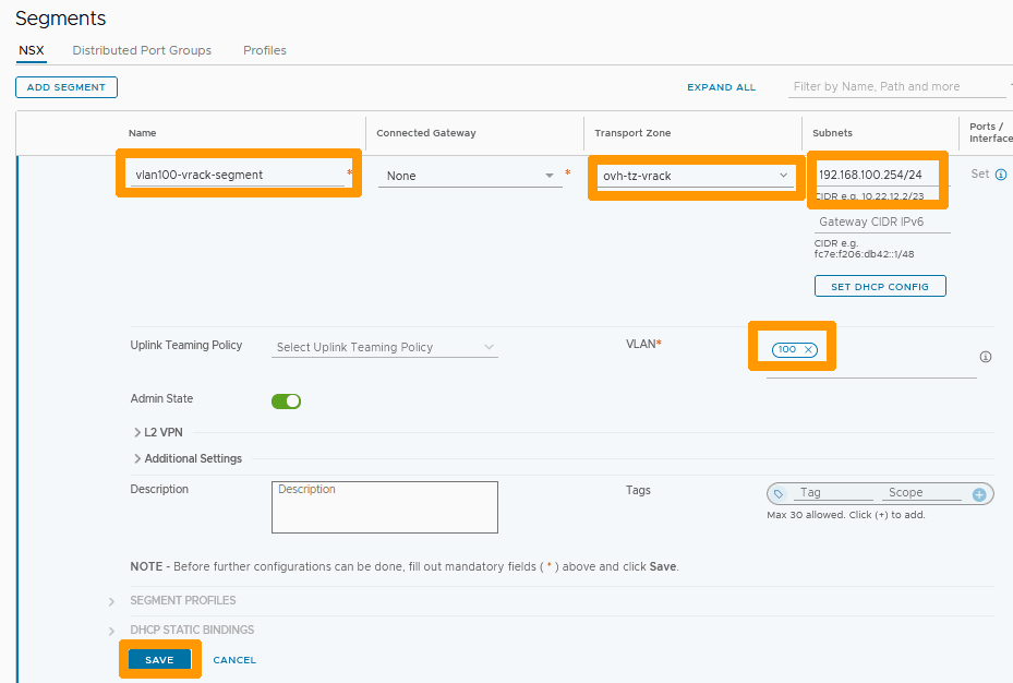

Through the NSX interface, click on the Networking tab and click on Segments on the left in the Connectivity section. Then click ADD SEGMENT.
06 Add vlan segment 01
Fill in this information :
  • Name : Type vlan100-vrack-segment.
  • Transport Zone : Select ovh-tz-vrack.
  • VLAN : Write the number 100.
  • Subnets : Enter the gateway address and range on this segment 192.168.100.254/24
Then click SAVE.
06 Add vlan segment 02

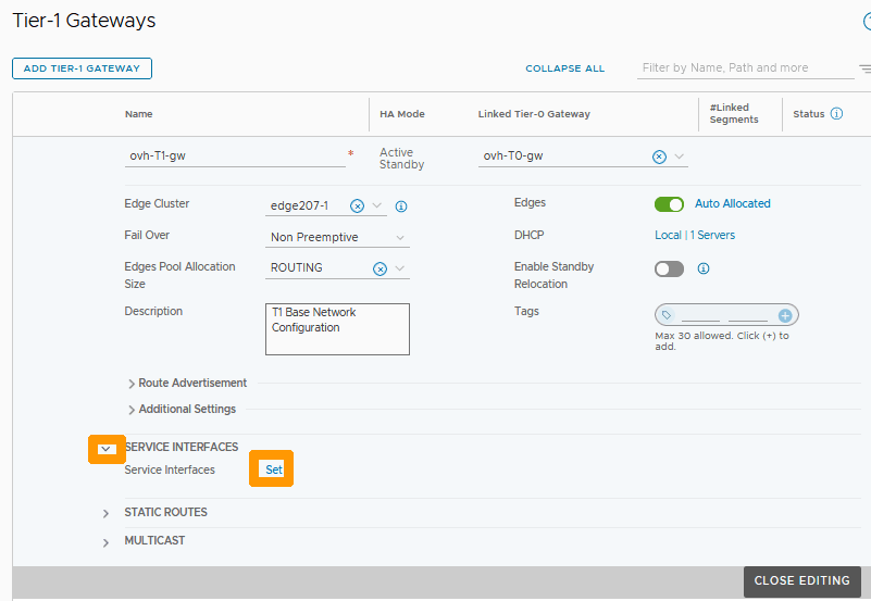

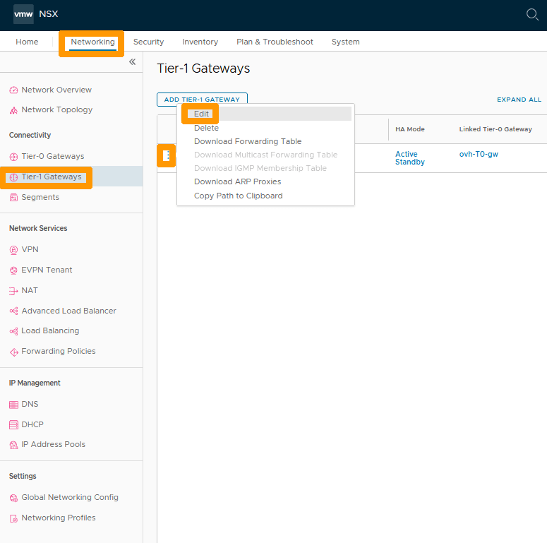

Through the NSX interface go to the Networking tab and click on Tier-1 Gateways on the left in the Connectivity section.
Then click on the three vertical points and choose Edit from the menu.
07 add interfaces to ovh-T1-gw with vlan 01
Click on the Down Arrow to the left of SERVICE INTERFACES and click the Set button that just appeared to the right of Service Interfaces.
07 add interfaces to ovh-T1-gw with vlan 02

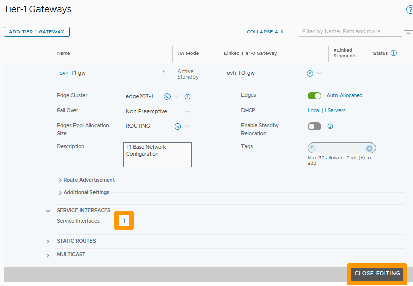

Then click SAVE to confirm the creation of the interface on ovh-T1-gw.
07 add interfaces to ovh-T1-gw with vlan 04
Click CLOSE.
07 add interfaces to ovh-T1-gw with vlan 05
The number 1 next to Service Interfaces indicates that the interface is created, click CLOSE EDITING to complete the creation of the interface.
You can now connect outside this segment through the interface with gateway 192.168.100.254/24.

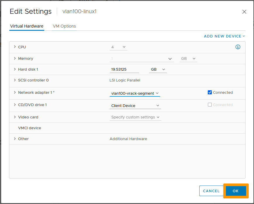

Assigning a VLAN Segment to a Virtual Machine
Go to your vSphere interface; right-click your virtual machine and choose Change settings.
08 connect VM to VLAN segment 01
Go to your network adapter and click Browse.
08 connect VM to VLAN segment 02
Click the segment associated with your VLAN and click OK.
08 connect VM to VLAN segment 03
Click OK to commit the changes.

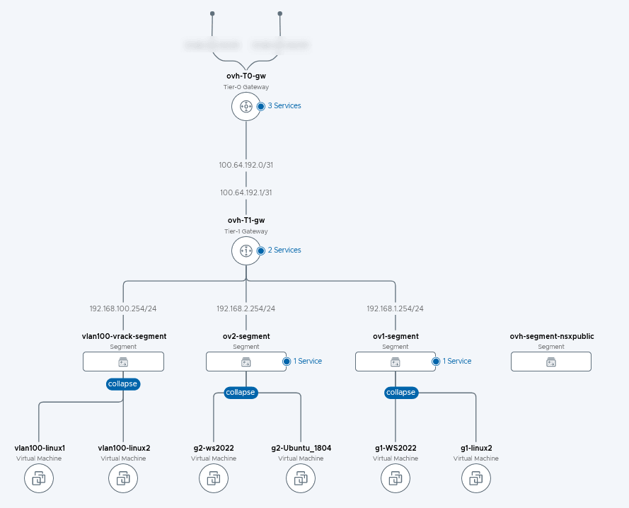

Displaying a network topology with overlay segments and other segments on VLANs
Go back to the NSX interface, go to the Networking tab and click on Network Topology on the left to view a graphical view of the network. You will see networks of type Overlay and those of type VLAN connected through an interface on ovh-t1-gw.
