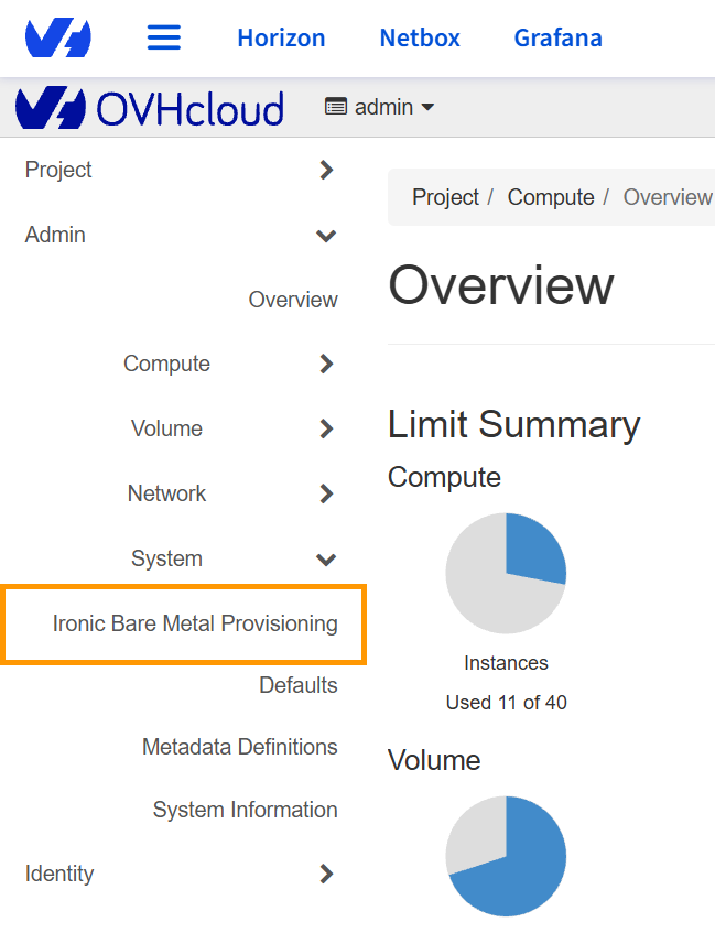

You can check the status of a node directly from Horizon via the Admin > System > Ironic Bare Metal Provisioning tab:
server-status
You will find the list of your nodes and their various statuses.

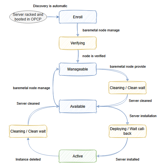

Node lifecycle
node-lifecyle
When a node is installed and booted in an OPCP rack, its discovery is automatically performed by the control plane. At this moment, the node retrieves its properties and traits based on its hardware profile.
Once the node is in the Enroll state, you can change its state so that it is managed by Ironic.

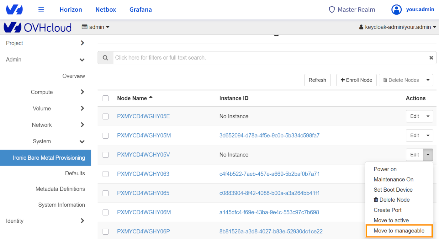

From the Horizon interface:
server-manageable
From the OpenStack APIs:
baremetal node manage $BAREMETAL_NODE_ID

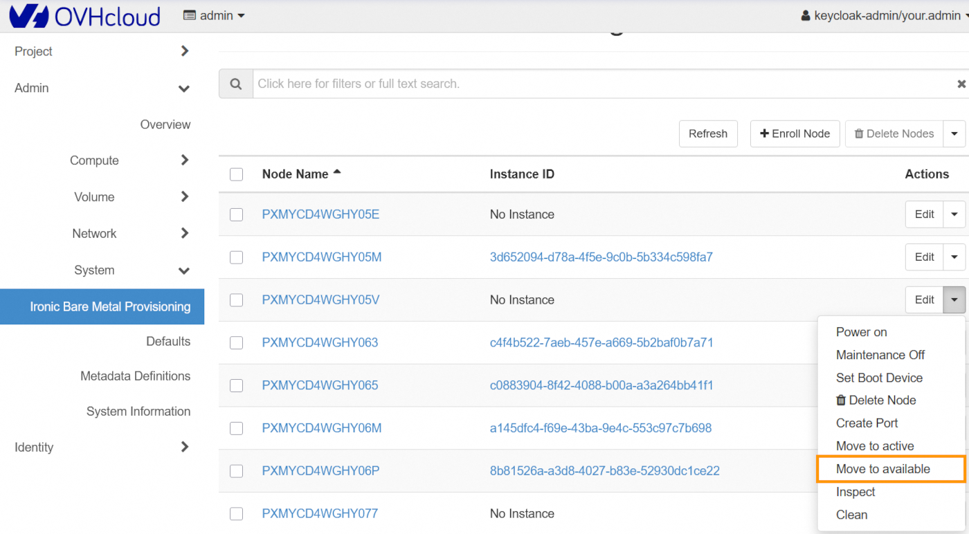

To make the node available for installation, it must then be transitioned to the Available state:
server-available
baremetal node provide $BAREMETAL_NODE_ID
The node then transitions to the Cleaning state before reaching Available, making it deployable by the various projects in your OPCP environment.

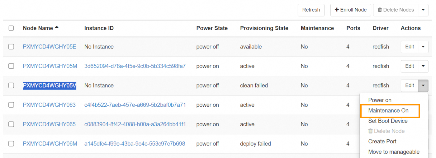

This mode can be enabled to ensure a node cannot be used for installation, even if it is in the Available state.
Maintenance-on

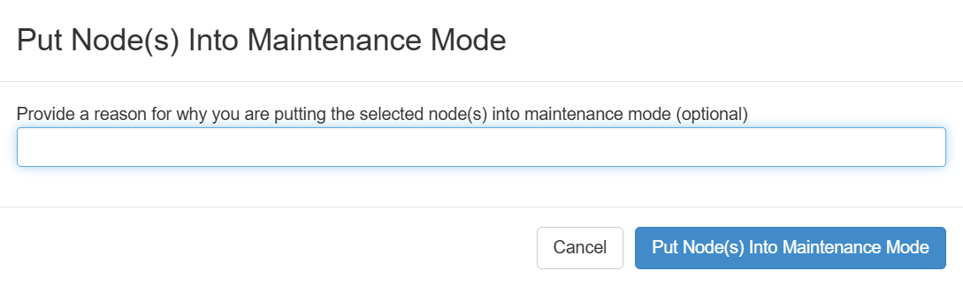

When enabling maintenance, you may specify a reason so that the team responsible for the nodes has the information. This reason is optional.
Maintenance-reason

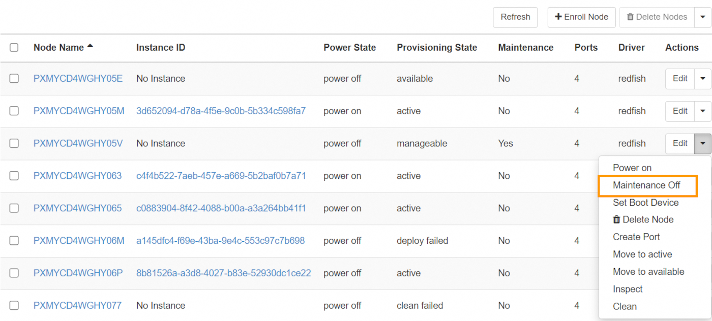

Once your maintenance operations are complete, you can disable maintenance:
Maintenance-off
