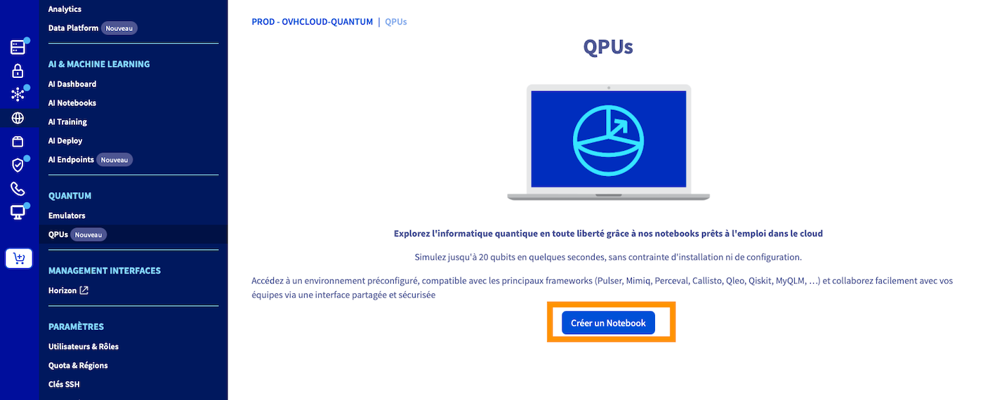

Navigate to the Public Cloud section of the and click the Quantum QPUs category. Click the Create a Notebook button and follow the prompts to specify the configuration of your Quantum Notebook.
Create a Notebook Control Panel manager 01

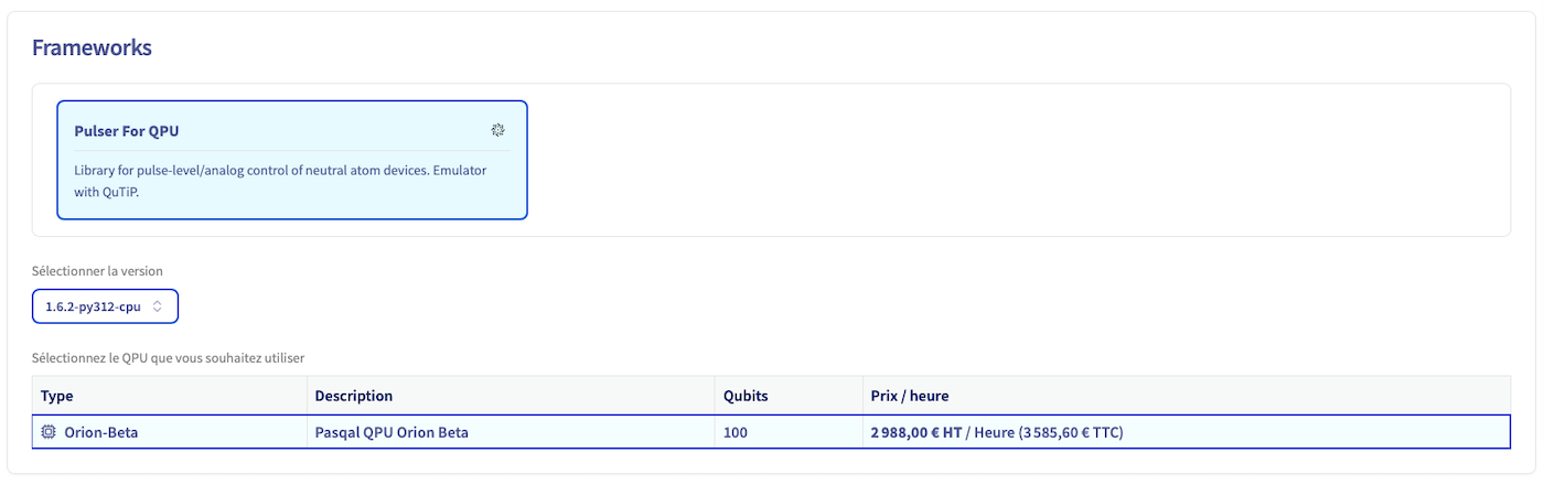

4. Pre-configured frameworks
Choose the Quantum Python framework you want to use, which will be pre-installed and ready to use when your notebook is launched. Select the version that suits your needs. Then, click Next to continue.
Create a Notebook Control Panel manager 04

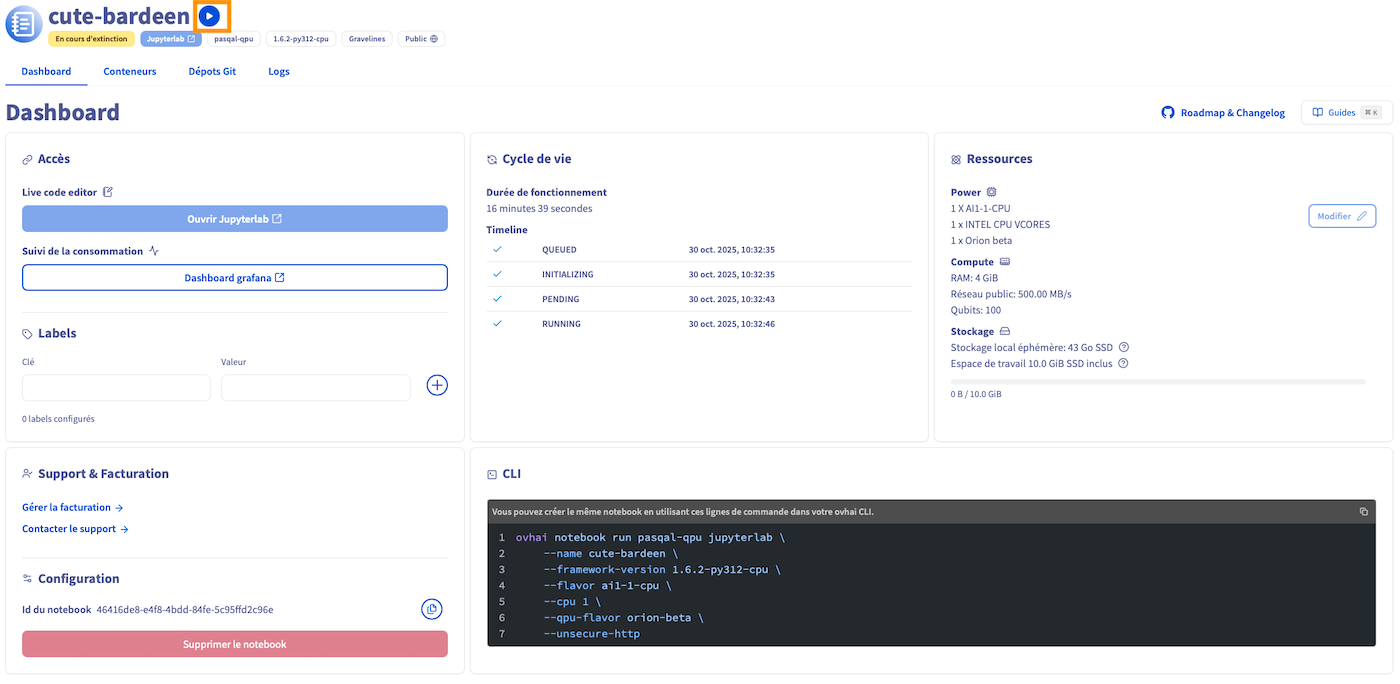

At the end of the process, review your settings and click the Order now button to confirm and launch the creation of your Notebook. You will be redirected to your notebook dashboard:
Create a Notebook Control Panel manager 10
Note at the bottom of the screen the equivalent ovhai CLI command. This command allows you to run the exact same Notebook using the CLI.

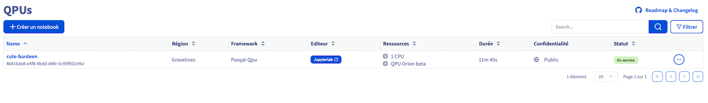

When your Notebook is created, it will appear on your Quantum QPUs tab:
Create a Notebook Control Panel manager 11

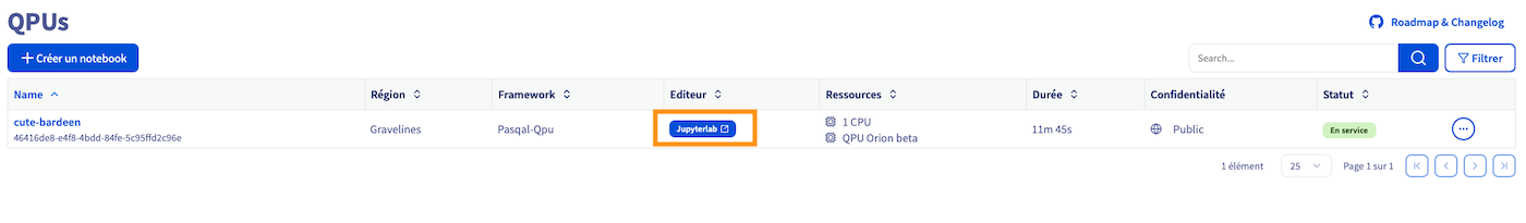

Click the JupyterLab link in the Access column:

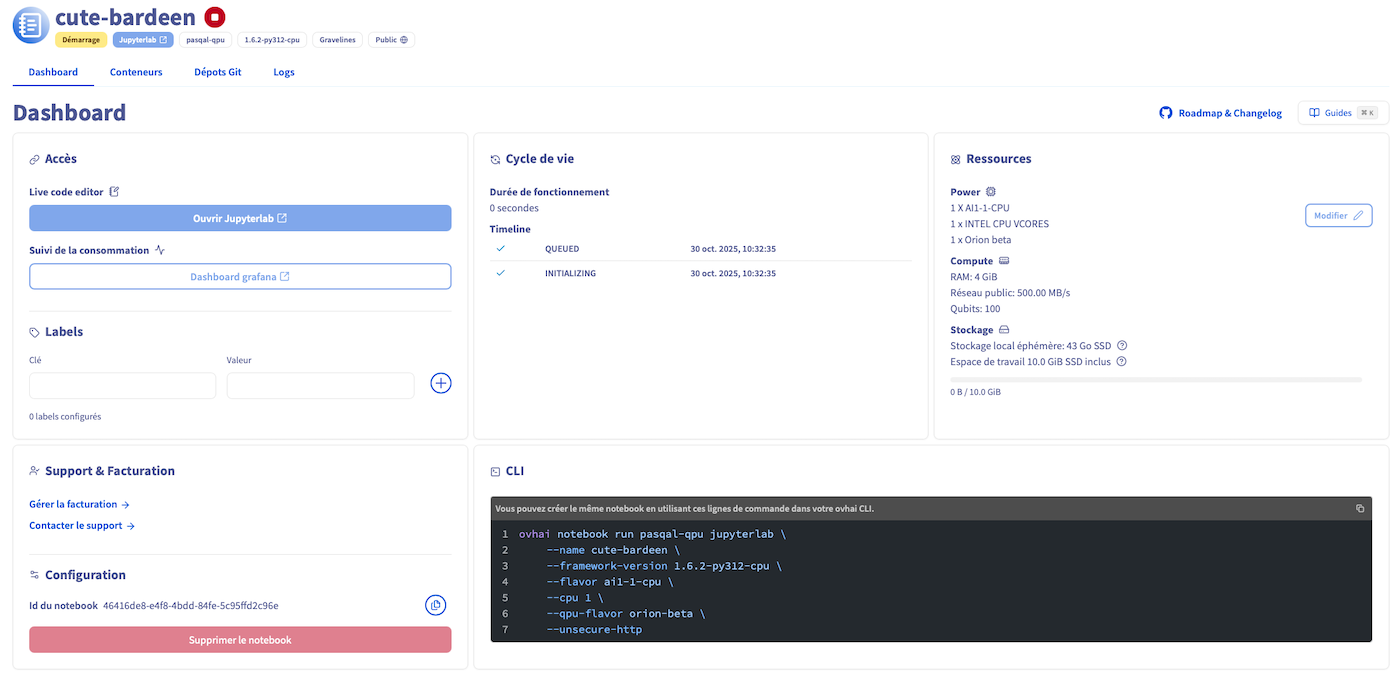

Stopping a Quantum Notebook
You can stop your Quantum Notebook at any time to release its compute resources. This will release its compute resources but will keep your Notebook data and installed libraries. Therefore, you will not incur any further charges for compute unless you restart the Notebook. However, attached storage will be billed at the price of OVHcloud Object Storage (consult the Quantum Notebooks Billing documentation for more information). To do so, follow these steps:

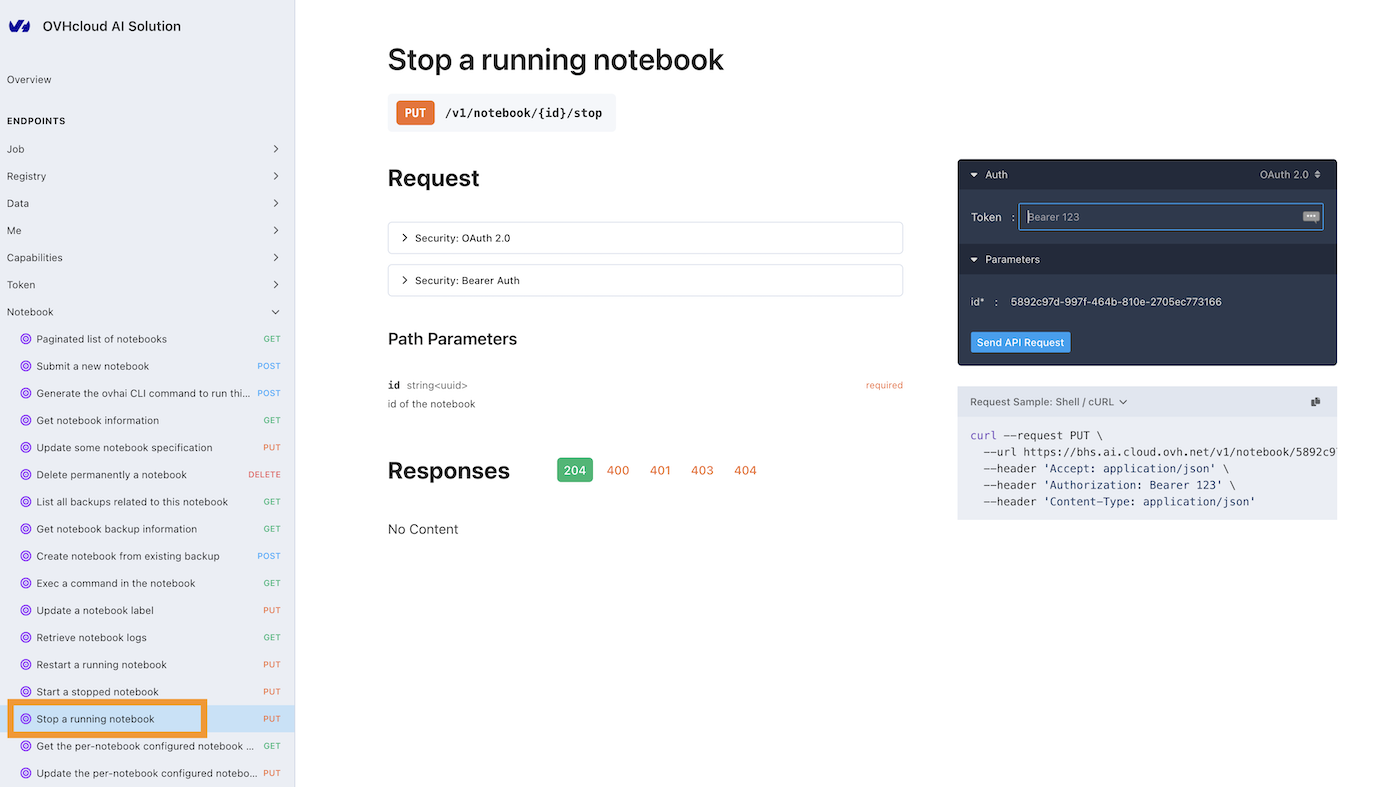

Go to the Quantum Notebooks board and click on the ... button next to the Notebook you want to stop. Click the Stop button to stop the Notebook. Or, on the notebook board, you can click on the red button at the top of the page.
Stop a Notebook Control Panel manager

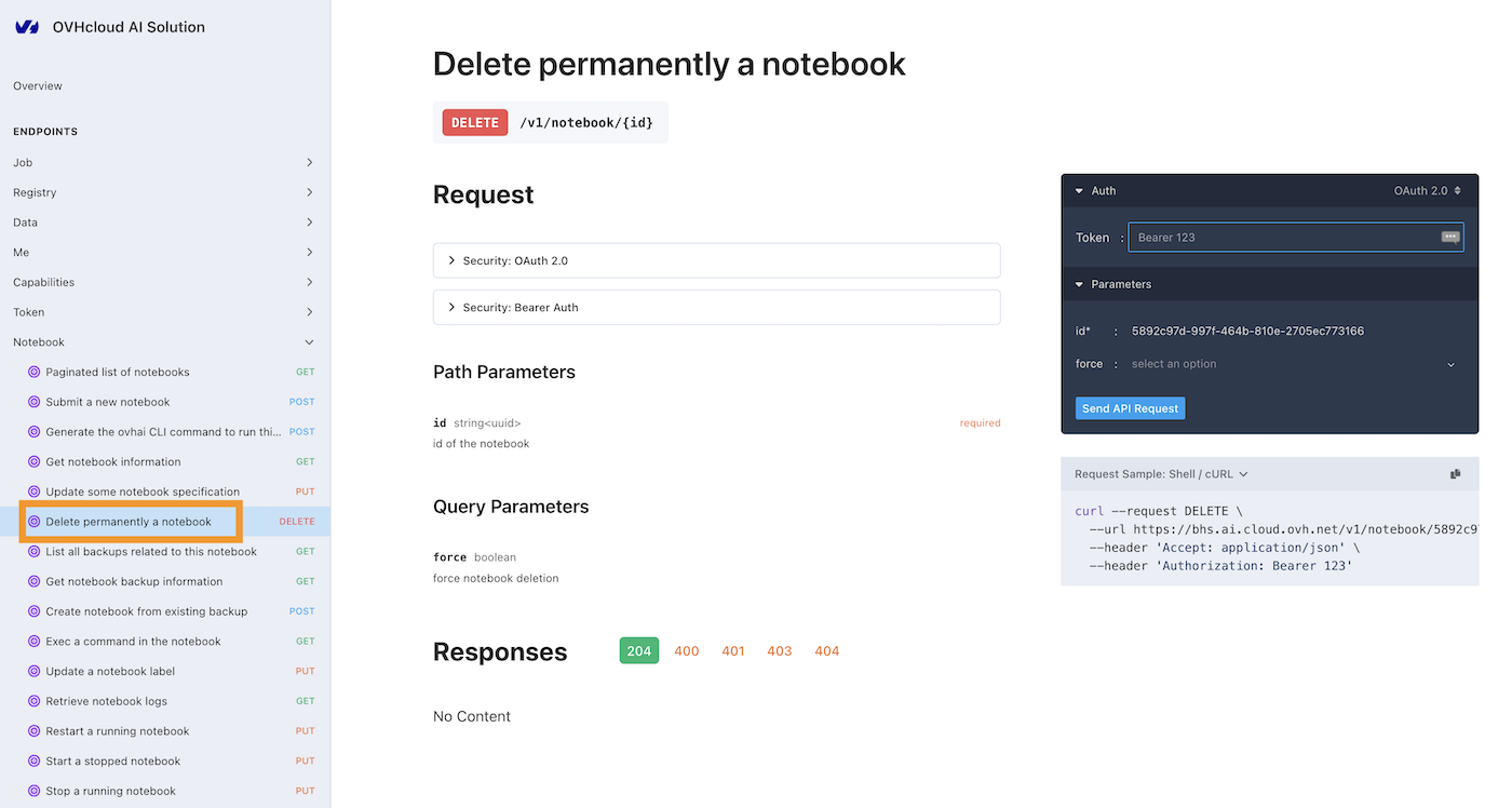

The notebook must be stopped before deleting it. To delete a Notebook, follow these steps:
Using the Control Panel (UI)
Using ovhai CLI
Using the Quantum API
Using the Python SDK

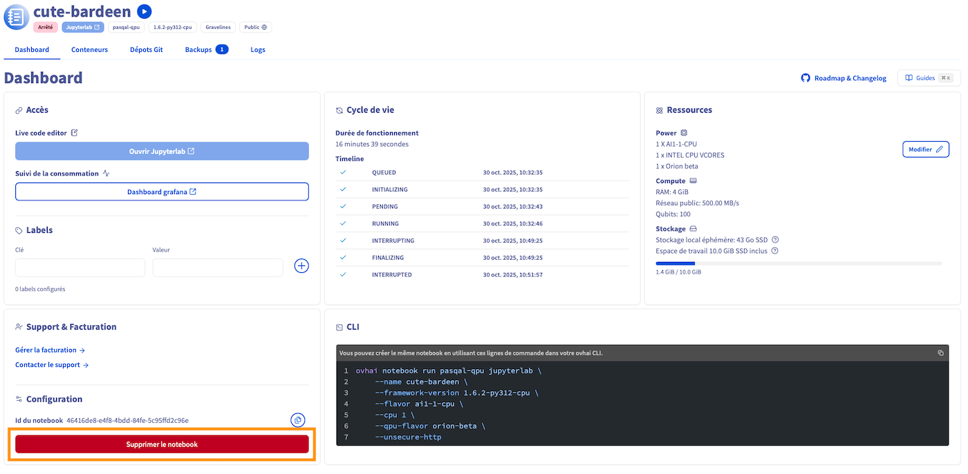

Go to the Quantum Notebooks board and click on the ... button next to the Notebook you want to delete. Click the Delete button to stop the Notebook. Or, on the notebook board, you can click on the Delete notebook button at the bottom of the page.
Delete a Notebook Control Panel manager
