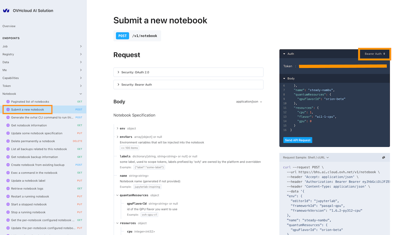

If you're using the API, CLI, or SDK, you will need to complete an authorization process before creating a Quantum QPUs Notebook. To do so, click QPUs under Quantum in the left-hand menu of your Public Cloud project: if the Authorise this project for AI services banner is displayed, click Authorise the project.

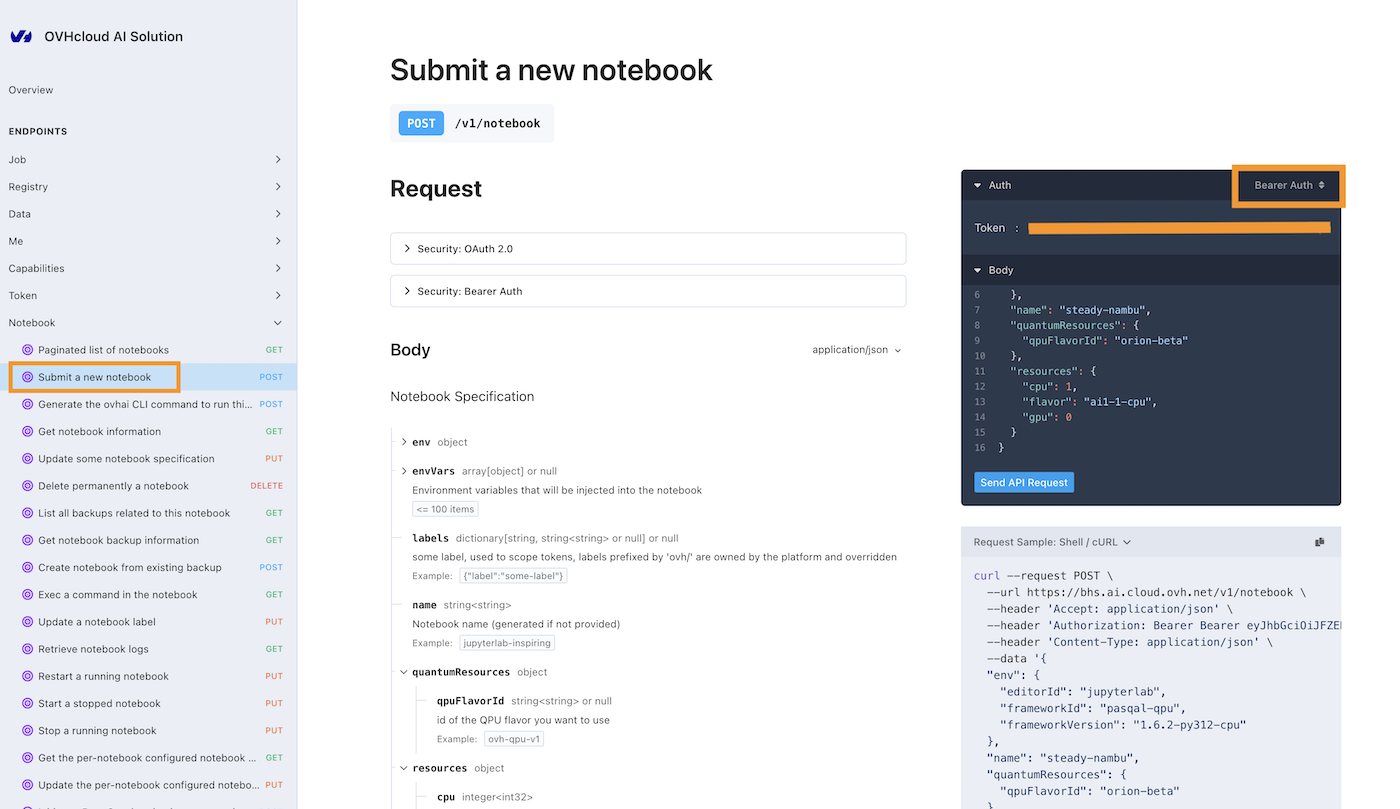

To create a Quantum Notebook, follow these steps:
OVHcloud Console
AI Solution API
ovhai CLI
Python SDK

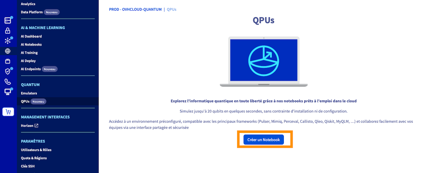

In the left-hand menu of your Public Cloud project, click QPUs under Quantum.
Click the Create a notebook button. The Create a notebook page opens: specify the configuration of your Quantum Notebook in the sections below. A summary of your configuration and its estimated price per hour is displayed on the right-hand side.

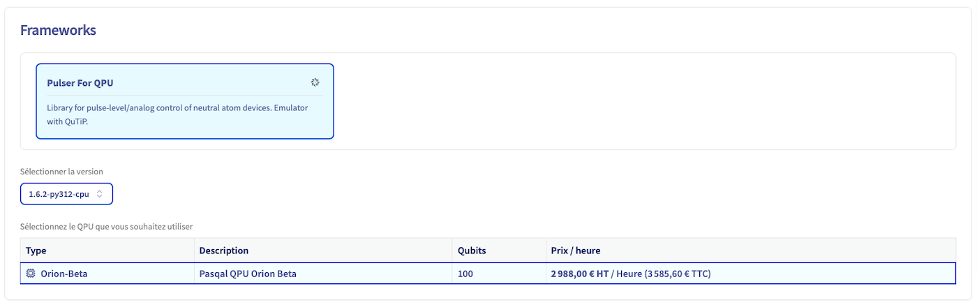

Framework
Choose the Quantum Python framework you want to use, which will be pre-installed and ready to use when your notebook is launched. Select the Version that suits your needs.

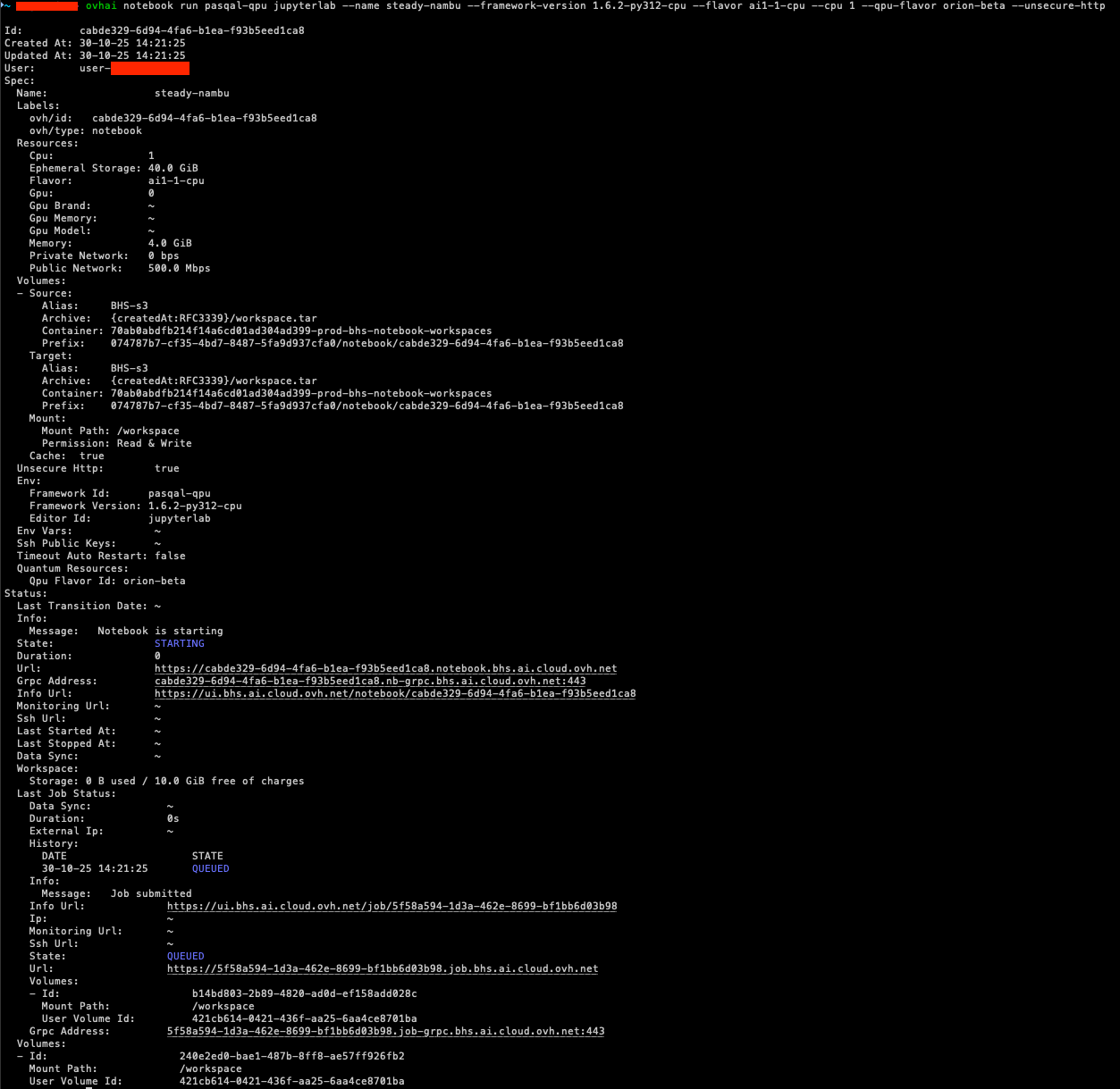

At the end of the process, review the summary of your settings and click the Create the notebook button to confirm and launch the creation of your Notebook.

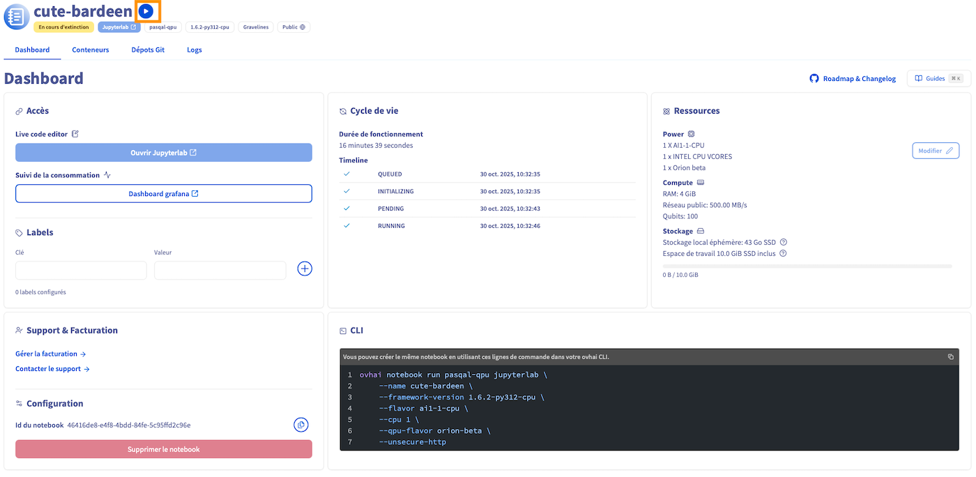

Click CLI equivalent to display the equivalent ovhai CLI command. This command allows you to run the exact same Notebook using the CLI.

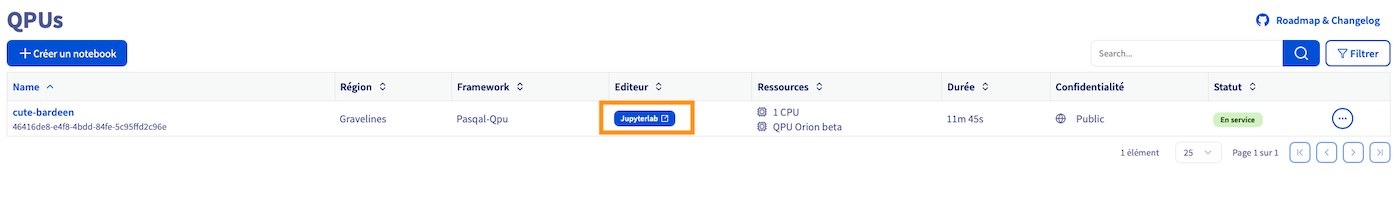

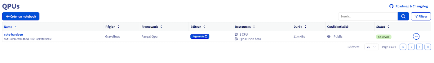

When your Notebook is created, it will appear in the list of your Quantum QPUs notebooks.

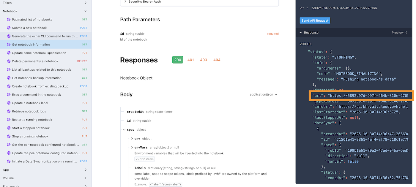

Once your Quantum Notebook is created and running, you can access it using the Open JupyterLab button of the notebook page or through the ovhai CLI, Quantum API, or Python SDK.

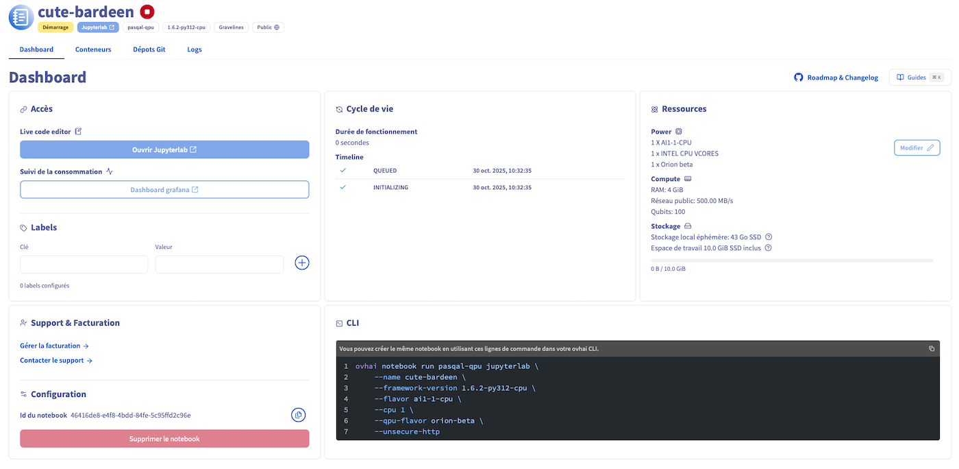

In the left-hand menu of your Public Cloud project, click QPUs under Quantum. Then, click the name of the notebook to open its Overview tab.
In the Connection details card, click the Open JupyterLab button (the button is named after the editor you selected).
On the Notebook page, you will find information about the Notebook, including specifications, life cycle, and attached data, as well as a monitoring link (Monitoring Grafana) for real-time metrics.

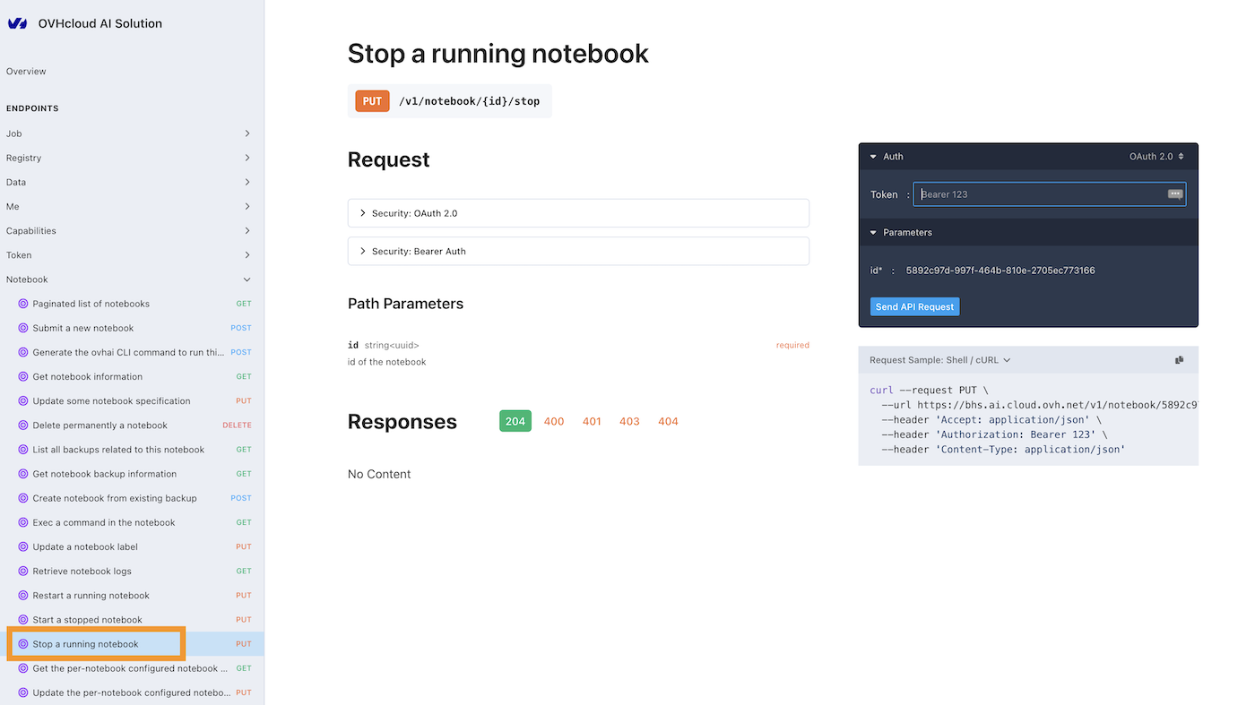

Stopping a Quantum Notebook
You can stop your Quantum Notebook at any time to release its compute resources. This will release its compute resources but will keep your Notebook data and installed libraries. Therefore, you will not incur any further charges for compute unless you restart the Notebook. However, attached storage will be billed at the price of OVHcloud Object Storage (consult the Quantum Notebooks Billing documentation for more information). To do so, follow these steps:
OVHcloud Console
Quantum API
ovhai CLI
Python SDK
In the QPUs list (under Quantum in the left-hand menu of your Public Cloud project), click the ... button next to the Notebook, then Stop. You can also click Stop in the General information card of the notebook. Confirm with Stop.

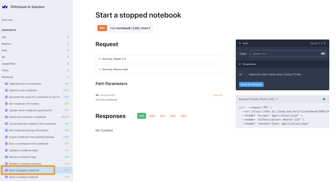

To restart a stopped Notebook, follow these steps:
OVHcloud Console
Quantum API
ovhai CLI
Python SDK
In the QPUs list (under Quantum in the left-hand menu of your Public Cloud project), click the ... button next to the Notebook, then Start. You can also click Start in the General information card of the notebook. Confirm with Start.

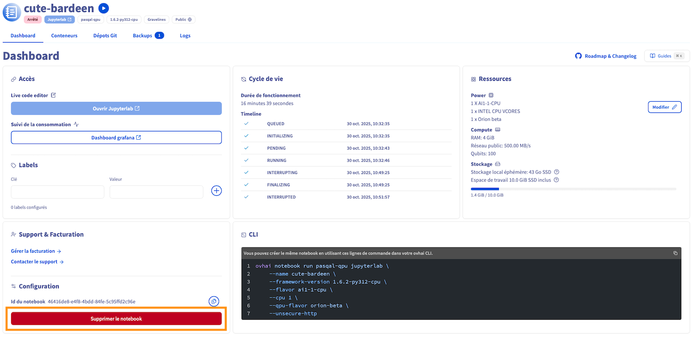

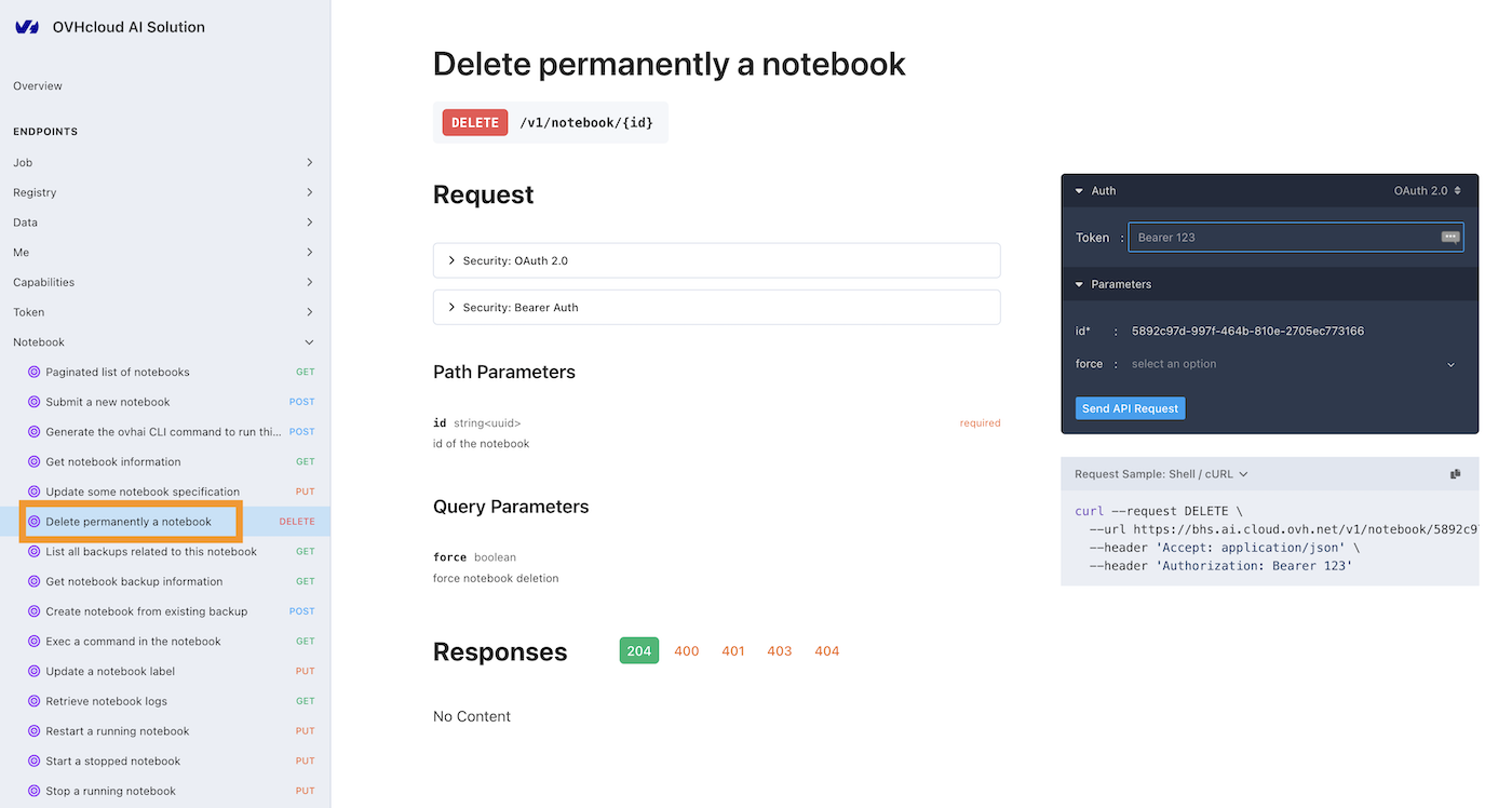

The notebook must be stopped before deleting it. To delete a Notebook, follow these steps:
OVHcloud Console
Quantum API
ovhai CLI
Python SDK
In the QPUs list (under Quantum in the left-hand menu of your Public Cloud project), click the ... button next to the Notebook, then Delete. You can also click Delete notebook in the General information card of the notebook. Confirm with Delete.
