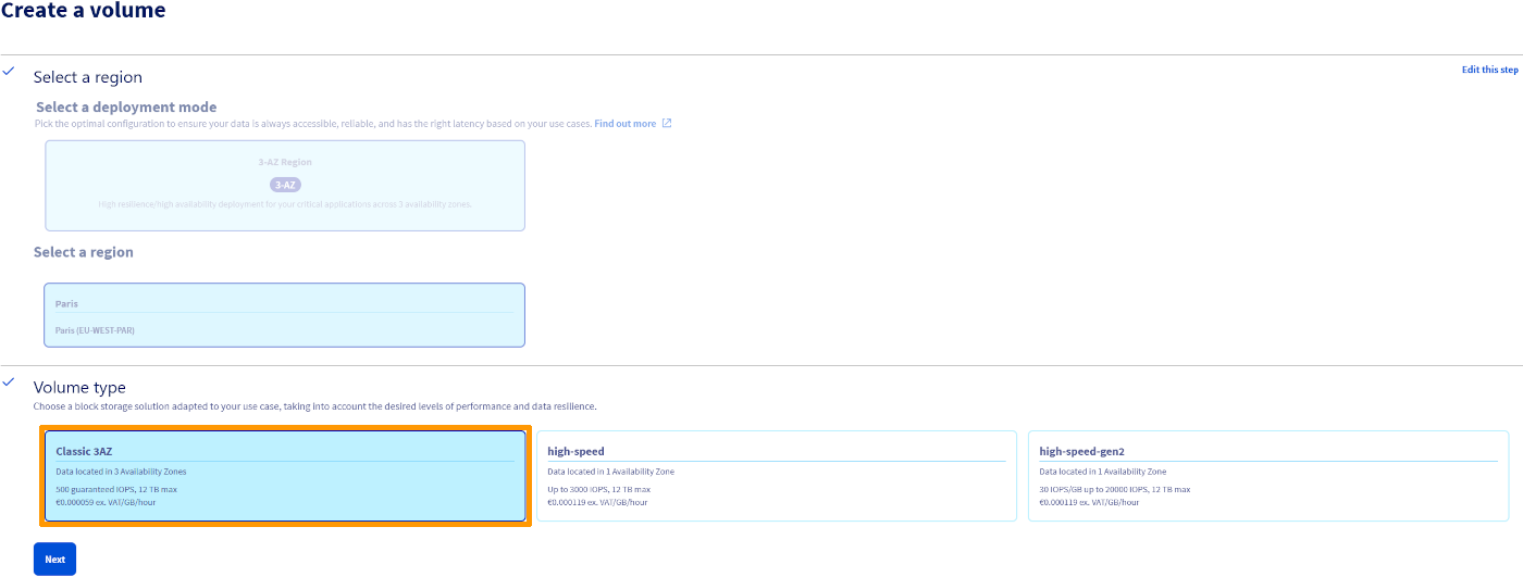

In the OVHcloud Console, on the Create a volume page, select a 3-AZ region in the Choose a region section, then select the Classic 3AZ offer in the Select an offer type section.
