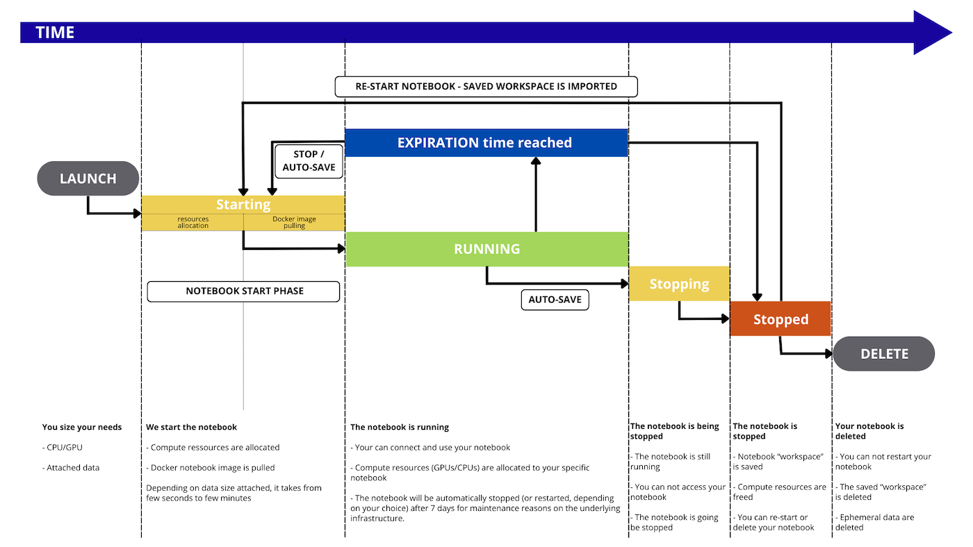

Quantum Notebooks lifecycle
During its lifetime, the notebook will go through the following statuses:
  • STARTING: the notebook is being started and, if any, the remote data is synchronized from the Object Storage. To learn more about data synchronization, please check out the Data - Concept and best practices documentation. Then the system allocates the necessary compute resources (CPUs/GPUs) for your notebook. Finally, the base framework you have chosen is pulled for use in the notebook.
  • RUNNING: the notebook is running, you can connect to it using its endpoint and benefit from your compute resources and your attached data.
  • STOPPING: the notebook is stopping, your compute resources are freed, your work and status is saved and, if any, the data is synchronized back to the Object Storage.
  • STOPPED: the notebook ended normally. You can restart it whenever you want or delete it. It will keep the same endpoint.
  • FAILED: the notebook ended in error, e.g. the process in the notebook finished with a non 0 exit code. For more information, refer to the "CLI: My notebook is in failed status " section of our Troubleshooting documentation.
  • ERROR: the notebook ended due to a backend error. You may reach our support.
  • DELETING: the notebook is being removed. When it is deleted, you will no longer see it, it will no longer exist.
lifecycle

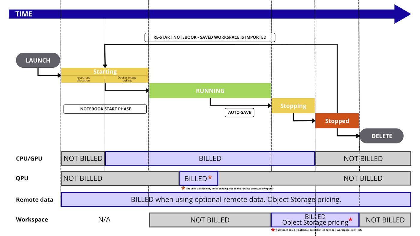

Billing principles
Quantum Notebooks is a pay-per-use solution. You only pay for the resources consumption.
Included in Quantum Notebooks resources:
  • Dedicated CPU/GPU compute resources (based on the selected amount during notebook creation).
  • For Quantum QPU, an additional remote Quantum Processing Unit compute resource is available on your notebook.
  • Ephemeral local notebook storage (the size depends on the selected compute resources). The first 10GB are free.
  • Workspace remote storage (Optional).
  • Ingress/Egress network traffic (Optional).
Here is a detailed graph that illustrates every step that is billed or not during the Quantum Notebooks workflow:
billing
Compute resources details
During the notebook creation, you can select compute resources, known as CPUs or GPUs. Their official pricing is available in the or on the OVHcloud Public Cloud website.
When your program needs to access to the remote QPU, QPU time is charged by the second. You will only be charged for your QPU usage time.
Rates for compute are mentioned per hour to facilitate reading of the prices, but the billing granularity remains per minute.
As stated above and shown in the image above, you pay for these resources as long as you consume them. This happens when the image of your notebook is pulled, during the STARTING phase, but also during RUNNING and STOPPING phases, until you reach the STOPPED phase.
