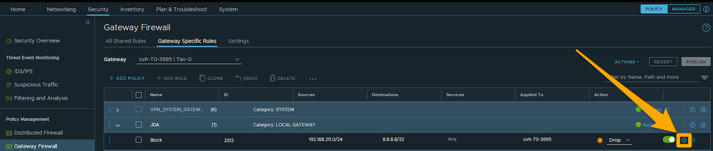

Before logs can be retrieved, you will need to enable the logging option on the corresponding rule.
Warning: by default, logs are not enabled on rules!
For example, consider a rule that blocks all IP addresses between 192.168.211.0/24 and 8.8.8.8/32.
To access the configuration of a rule, click the settings button (in the form of a cogwheel) to the right of the rule you have chosen.
Configuration rules for the Gateway Firewall
The rule settings are then available. Enable the logging option that should switch to green.
Activation of logs for the rule
Make sure to apply the new configuration and publish it.
