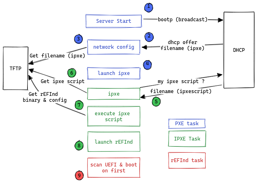

Netboot startup overview
A major component exists in 2 versions:
  • PXE: Using a standardised client/server environment, based on BOOTP/DHCP/TFTP protocols, to enable boot/deployment through the client system network.
  • iPXE: Using a more advanced, standardised client/server environment, based on HTTP, iSCSI, AoE, FCoE, Wi-Fi protocols to enable client system network boot/deployment.
A quick overview of Netboot startup at OVHcloud
List of components involved during startup:
  • A DHCP server: Assigns a network configuration (lease with IP address) for a client machine that is attempting to boot.
  • A TFTP service: Resources available across the network that will be queried by PXE and iXPE.
  • The rEFInd solution, in the form of a BootLoader, was chosen because it was perfectly adapted. It will allow the search of boot sectors of client machines: local disk, USB, etc.
Here is a (logical) Netboot boot schema:
Netboot in action
Description/Details
1. Sending a discover request to DHCP from the client machine (in broadcast)
2. DHCP assigns an IP address to the client machine (offer/request/ack). iPXE binary recovery request
3. iPXE binary TFTP recovery
4. Loading iPXE binary as firmware
5. iPXE firmware recovery request
6. Retrieving the associated iPXE script in TFTP
7. Running the iPXE script. Retrieving rEFInd resources: required binary and configuration file
8. Running and loading the rEFInd binary
9. rEFInd launches its scan task to identify boot sectors for local disks
This description is as generic as possible, in order to remain clear, and so as not to add technical elements or constraints that go beyond our example. The aim of this scheme is to provide an overall view of the operating principle.

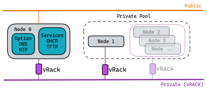

Below is an example of a basic private infrastructure (layer 2 diagram):
Schema
Example:
  • Services hosted/shared on Node 0.
  • Only one Node 1 client machine with active OLA.
After booting the systems, and in order for DHCP services and optional services (DNS and NTP) to be fully functional, consider declaring/adding rules in the local firewall, via the private network interface of the machine hosting the services.
