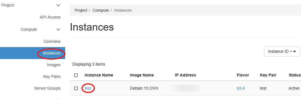

Go to the Instances menu and click on the instance to back up (the test instance in this example).
Overview page of the test instance

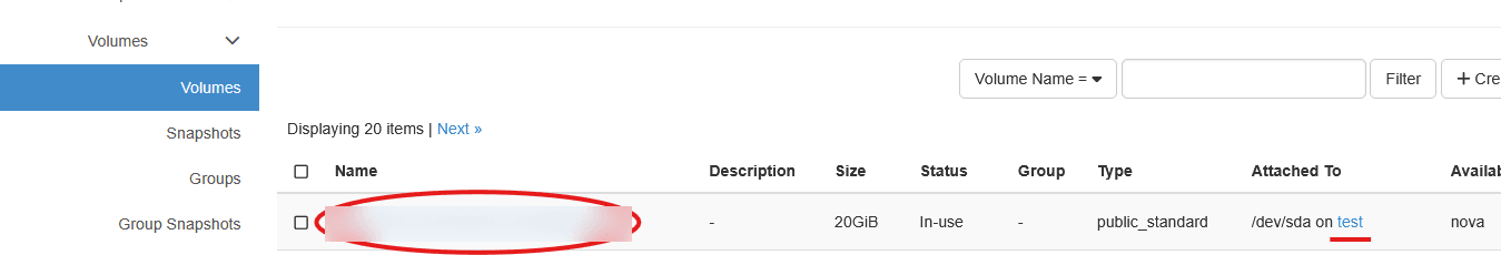

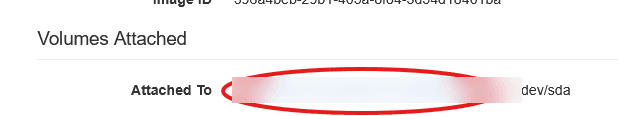

In the Volumes Attached section at the bottom of the instance details page, click the attached volume.
Volumes Attached section showing the volume attached to the instance
You can also find the volume in the Volumes menu by searching for the one attached to the instance.
Volumes menu with the volume attached to the instance

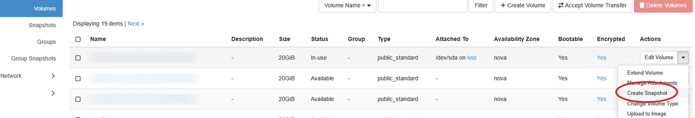

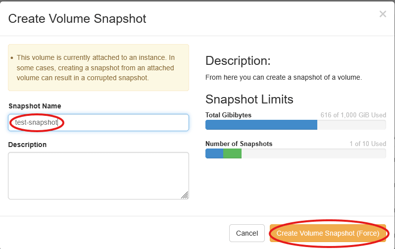

For a volume in use, such as the system volume of an instance, the Volumes menu no longer offers a snapshot: the Edit Volume form of that volume only contains its name and description. The snapshot actions are only available on volumes in the Available status. Two paths remain:
  • from the instance row, the Create Snapshot action creates an image (named as entered in the form) and a snapshot of the system volume, automatically named snapshot for <image name>.
  • with the CLI (see the OpenStack CLI tab), which only creates the volume snapshot.
The following steps (creating a volume from the snapshot) use the volume snapshot produced by either path. In Horizon, this guide uses the instance row.
Then create the snapshot from the instance row, in the Instances menu:
Create Snapshot action on the instance row in the Instances list
Enter a name and click Create Snapshot. The volume snapshot will be named snapshot for followed by that name. The operation is almost immediate.
Creating a snapshot of a mounted, in-use volume is crash-consistent but not application-consistent. To guarantee 100% consistency of the backed-up data, it is recommended to stop the instance beforehand.

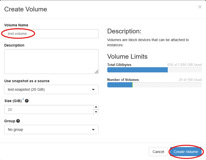

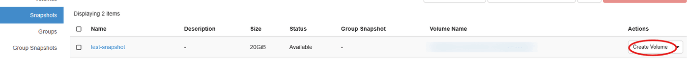

Go to the Snapshots menu and create a volume from the snapshot of the system volume.
Snapshots menu with the create volume action
Name it and leave the other values unchanged. Click Create Volume. The operation is almost immediate.
Volume creation from snapshot form

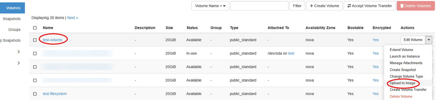

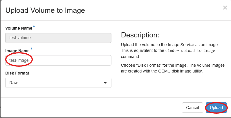

In this example, the volume is saved as an image, which you can then download locally for external backup, for example.
Choose the Upload to Image action in the volume's list of actions.
Upload to Image action in the volume actions list
Name the image, and keep Raw as the disk format. Click Upload.
Upload to image form with Raw disk format
The volume switches to the Uploading status. Image creation time depends on the volume size. Wait until the image is fully created.

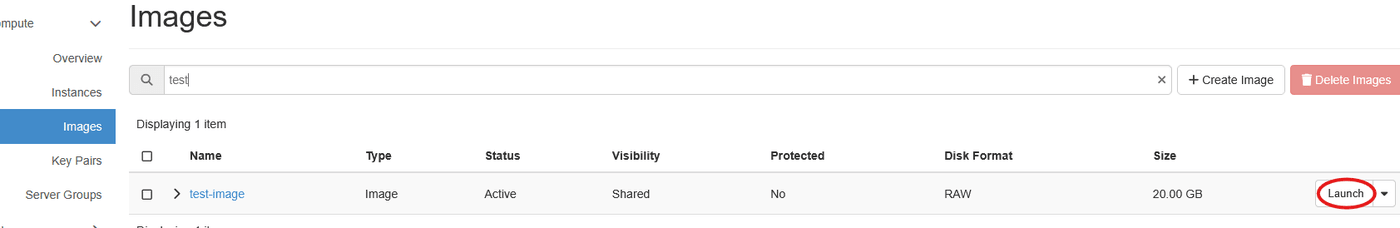

To create a new instance from the image, go to the Images menu and click the Launch action for the image.
Launch action on the image in the Images menu
The instance creation wizard then opens, as described in the Creating an instance and connecting to it guide.
