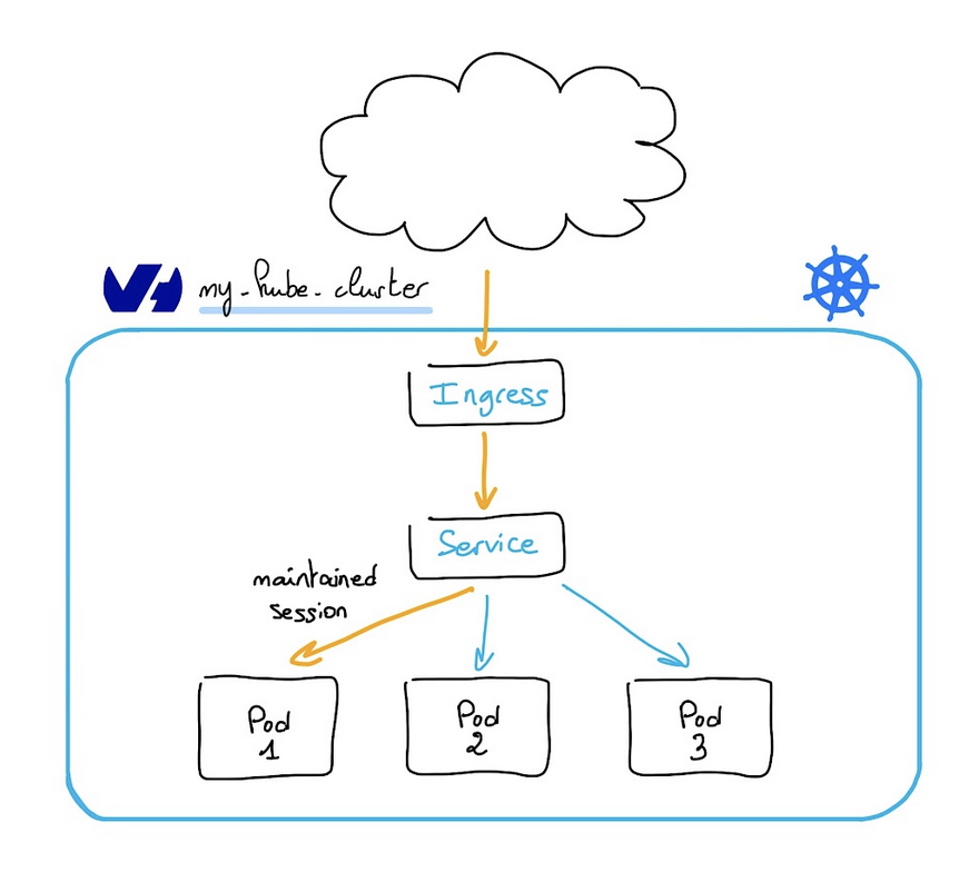

You have set-up and configured a Kubernetes Ingress resource that will maintain sessions for users, as in the illustration below:
Sticky session on Kubernetes schema

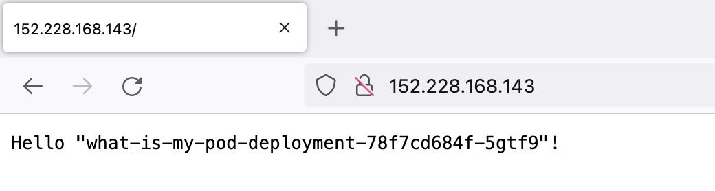

Now you can access this IP through your favorite browser and reload the page several times:
session affinity
Everytime you reload the page, you should get the same cookie value, so the Ingress redirects you to the same Pod.
