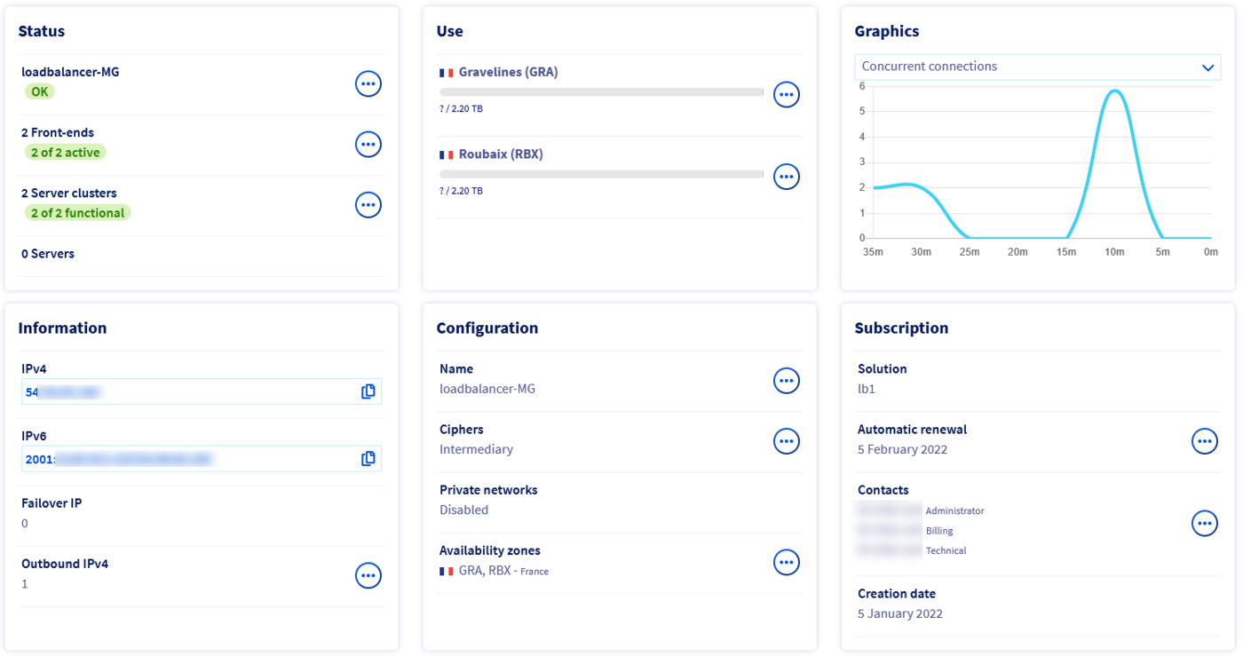

The features detailed below are accessible from the OVHcloud Control Panel:
OVHcloud Load Balancer Service
For more information about the features of the OVHcloud Control Panel, see the Managing the Load Balancer service via the OVHcloud Control Panel page.

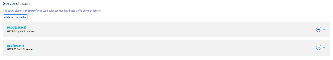

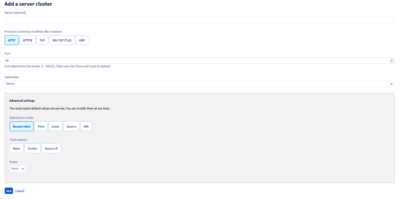

In the Server Farms tab, click the Add a server farm button.
Fill in the fields. The only mandatory fields for a simple configuration are the Protocol and the Datacentre. It is recommended to explicitly define a Port, generally port 80 for a web service. If no port is specified, your OVHcloud Load Balancer will automatically use the same port as the corresponding frontend and the probes may not work as expected.
If you add several servers in your farm, it is recommended to configure an HTTP availability probe. When a probe is configured, the OVHcloud Load Balancer service can automatically disable a server that is down or under maintenance, in order not to affect visitors.
Adding a server farm via the OVHcloud Control Panel
Click the Add button once you have filled in the fields.
Your server farm should appear in the list, under the Server Farms tab.
Details of the created server farm

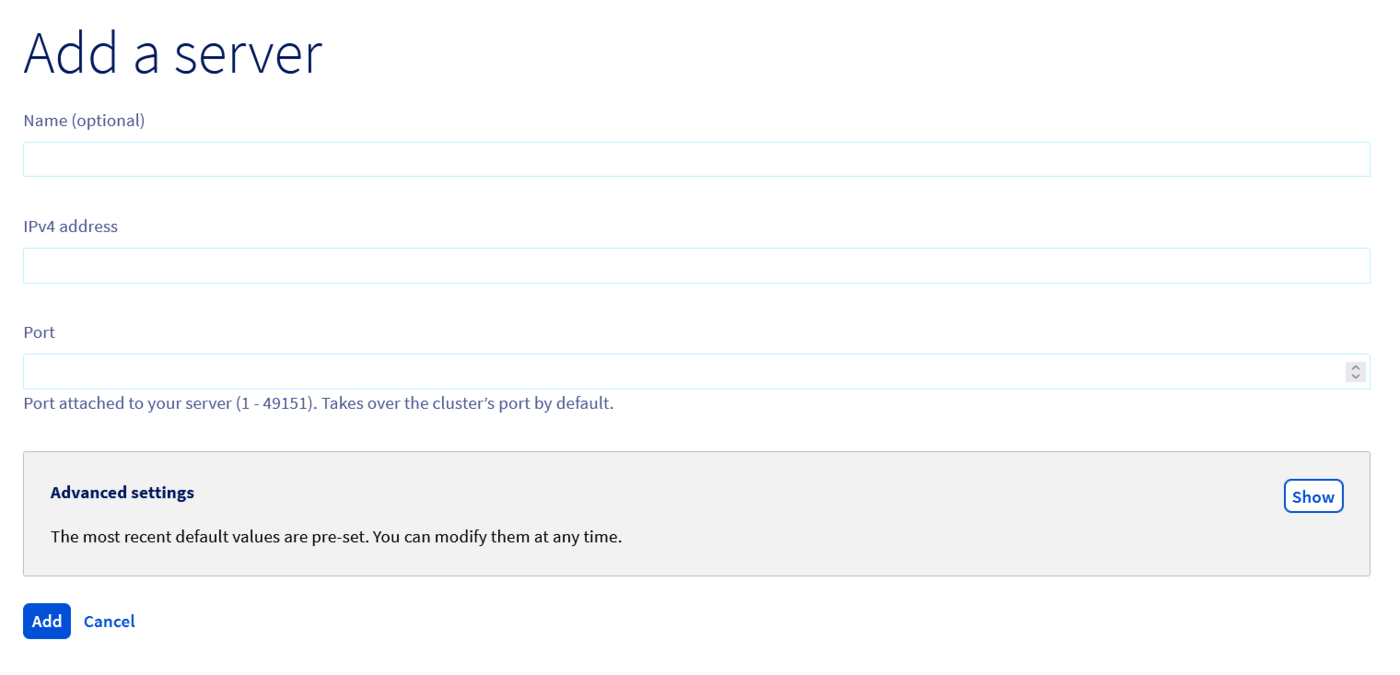

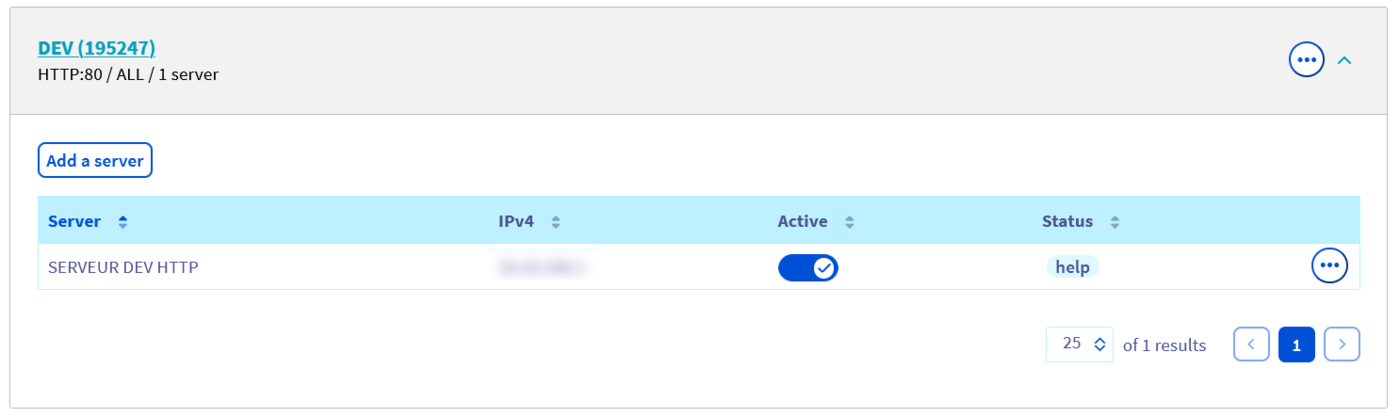

Still in the Server Farms tab, select the farm to which you want to add a server by clicking on the corresponding line. The list of servers already configured in the farm appears below the list of farms, as well as the Add a server button. Click on this button to add a new server.
Only the IPv4 Address field is mandatory. If a server does not use the same port as the one defined above in the farm, it is possible to override it in the server configuration. However, in order to maintain the most homogeneous and maintainable configuration possible, it is recommended to use this parameter only in advanced cases.
Adding a server to a Farm.
Your server should appear in the list of servers, in the Server Farms tab, just below the list of farms.
Details of the created server.

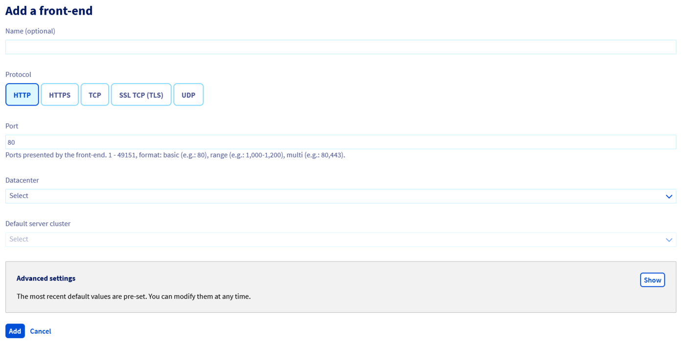

In the Frontends tab, click the Add a frontend button.
Fill in the fields. The only mandatory fields for a simple configuration are the Protocol, the Port (80 for a standard HTTP web service) and the Datacentre. If you want your service to be available on several ports at the same time, you can specify a list of ports separated by commas or a range of ports in the form "START_PORT-END_PORT".
If you have routed Additional IPs to your OVHcloud Load Balancer service, you can also attach a frontend to one or more specific Additional IPs.
Adding a frontend

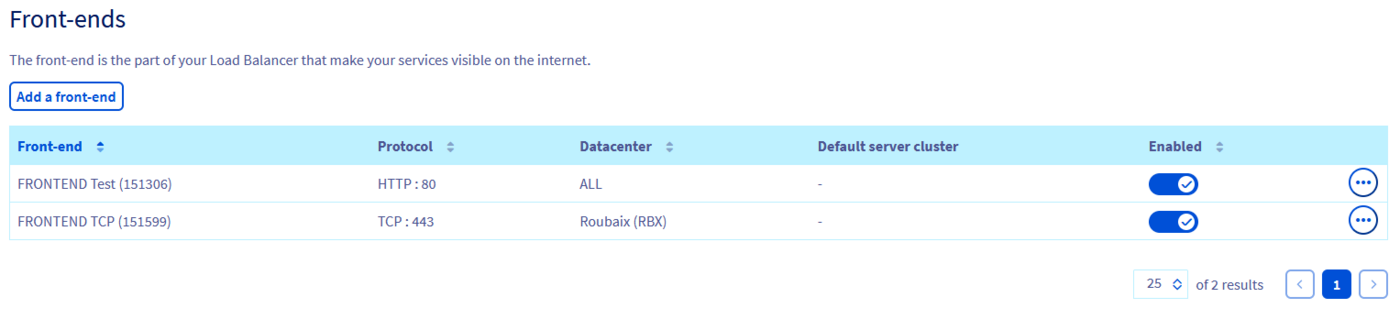

Your frontend should appear in the list, under the Frontends tab.
Details of the created frontend

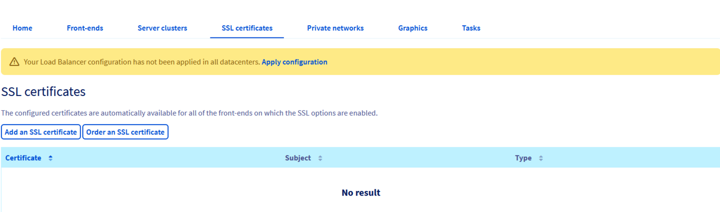

The list of SSL/TLS certificates configured on your OVHcloud Load Balancer service is in the SSL Certificates tab. This interface offers the 2 options mentioned above, namely importing an existing certificate (via the Add an SSL certificate button) and Order an SSL certificate managed automatically by your OVHcloud Load Balancer service.
Certificate addition buttons

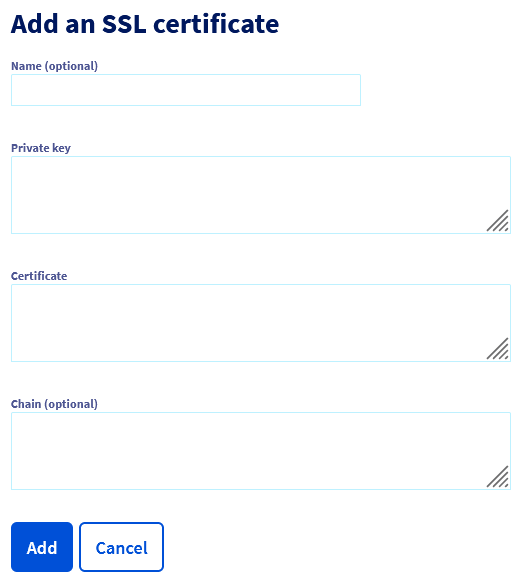

If you choose to import an existing SSL/TLS certificate, click on Add an SSL certificate. The Private Key and Certificate fields are mandatory.
Click the Add button once the fields are filled in. Your certificate will then appear in the certificate list.
Adding an existing certificate

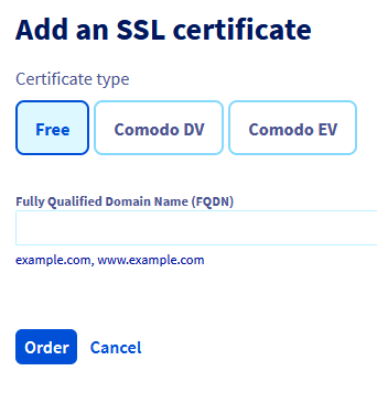

To add a Let's Encrypt certificate, click on Order an SSL certificate, enter your domain, make sure it points to your OVHcloud Load Balancer service and follow the emails you receive. You will then see it appear in the list of available certificates.
Ordering a Let's Encrypt certificate

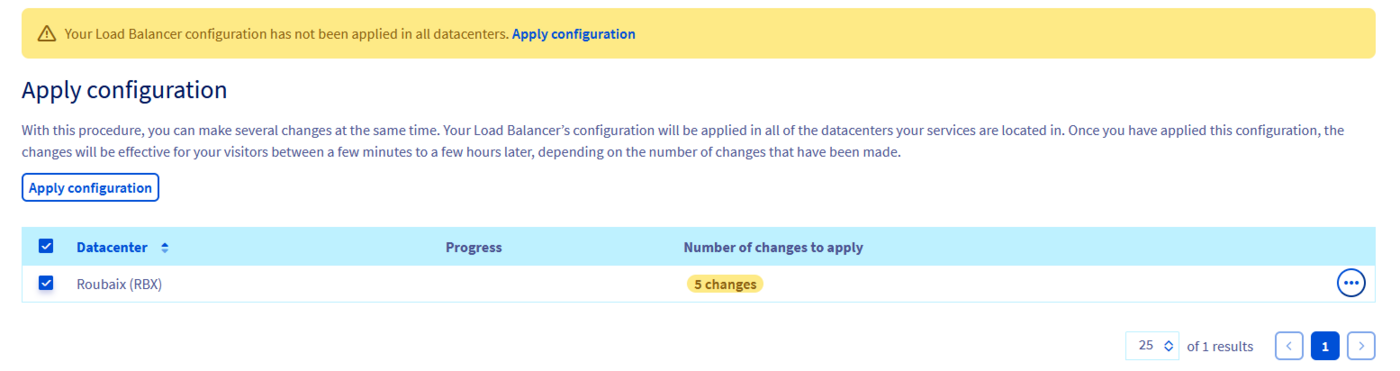

Apply the changes
The changes made to your OVHcloud Load Balancer service must be explicitly applied in each of the zones configured for your OVHcloud Load Balancer service. Only then will they be visible to your visitors. This allows a complex configuration change to be made in a single step.
If you have several zones, you will have to apply the same configuration for each of your zones.
From the OVHcloud Control Panel
Go to the home page of your OVHcloud Load Balancer service, click on the ... dots next to the name of your service and click on Apply the configuration.
Then select the list of zones you want to deploy and click on the Apply the configuration button.
Apply the configuration zones
