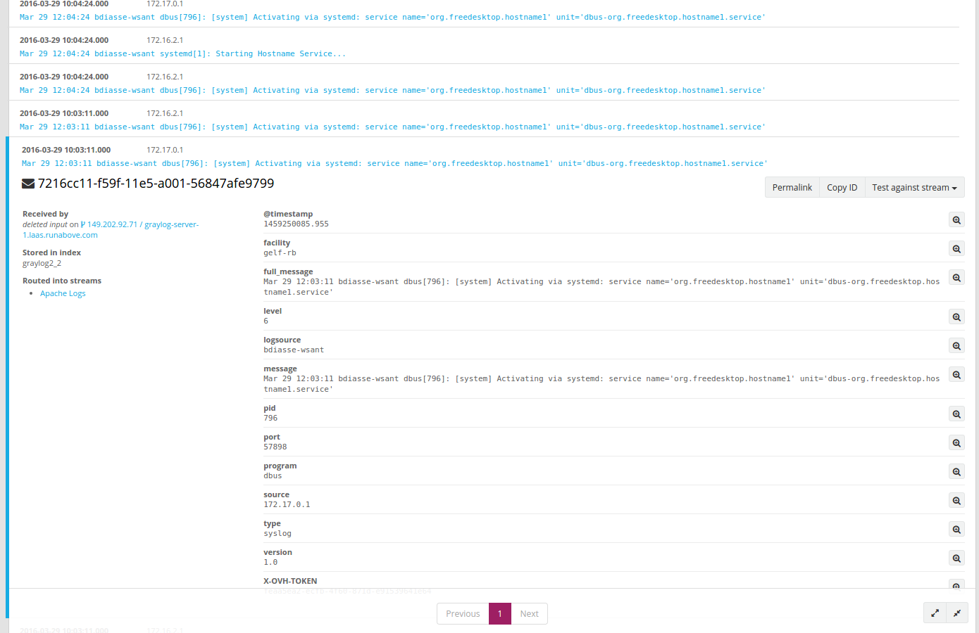

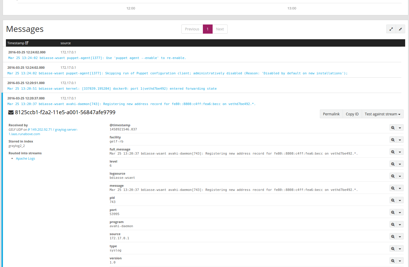

You will have the following result in your stream in Graylog:
local\_logstash\_graylog
So, let's suppose you have a lot of hosts and you want to send all your syslog outputs to Logstash. One way to do it is to put one Logstash on one of your machines and send all the logs to this hosts. This will work but what happens if your hosts go down? Or is not fast enough? Or if it isn't compatible with Java? Don't worry, the best thing about the Logs Data Platform is that we can host your Logstash for you. We also allow you to configure the input and the filter as you wish and you can even define custom Groks. The next section will tell you how to do it!

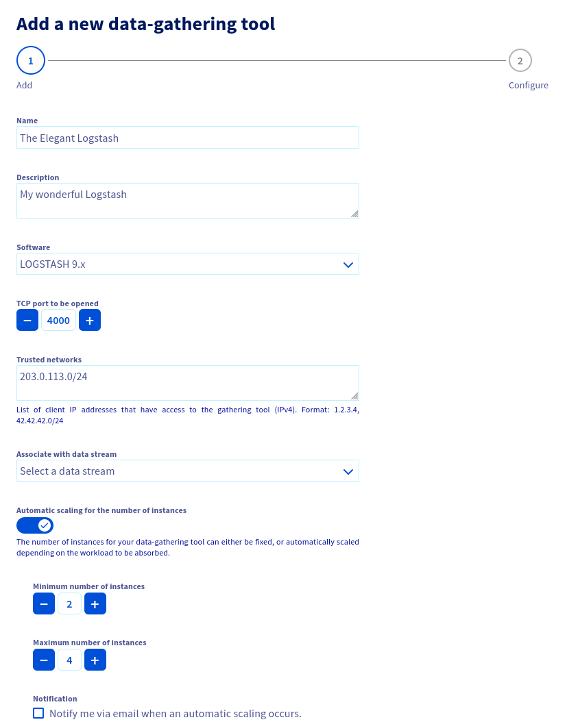

To host this collector in the Logs Data Platform, you will need to configure it in the Logs Data Platform manager:
  • Check the Data-gathering tools tab and click on the button Add a new data-gathering tool.
  • The Manager will then ask you to provide an elegant name and a wonderful description.
  • Select your Software: Select Logstash 9.x.
  • Fill the main port of your input. We need to know which port you will use in your input configuration. We will put 4000 for now. This is also a setting you can change later.
  • If you want to restrict the Logstash to specific IP Adresses, you can use the Trusted Networks field to firewall your instances. Add every IP Adress or subnet you want to allow, separated by comma. Leave it empty to allow any IP to contact it. Your collector will have a public IP Adress, you can use this feature to prevent people to send you false information in it.
  • Select one of the streams you have to attached this collector to the stream you have. That means that every message that goes out of this collector is automatically routed to the stream.
  • Finally, select the number of instances you would need to handle your load. We recommend to have at least two instances to ensure the high availabilty of your Logstash. However some uses cases need you to limit the number of instance at 1.
    • Note that you can also choose to automatically scale the number of instances. In this case, you need to select a minimum and maximum number of instances. Your input will then be started with the selected minimum number of instances. If these instances face a heavy load for a certain amount of time (more than 1 minute), your input will be automatically scaled up — one new instance at the time — until it reaches the selected maximum number of instances. On the other hand, if the load decreases, this number of instances will be scaled down until it reaches the minimum number of instances.

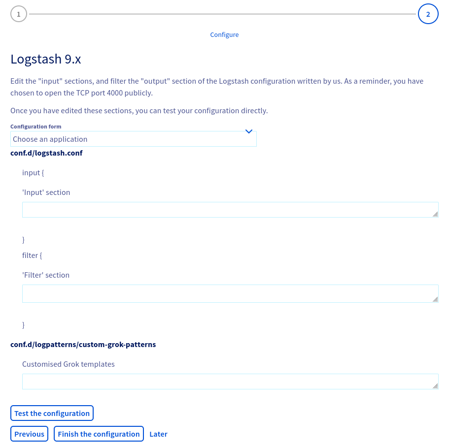

Click on Next button to display the Logstash Configuration Page as follows:
logstash_creation

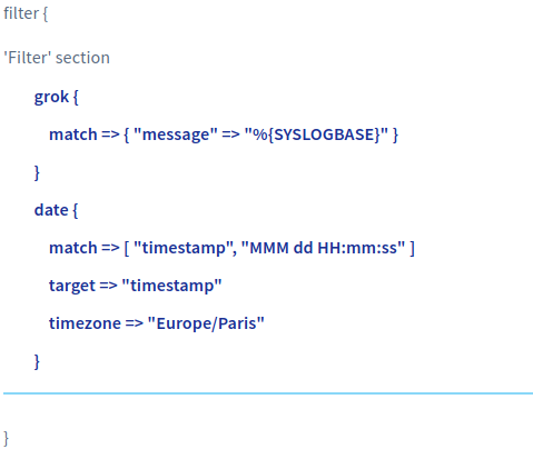

There are 3 sections in this page:
  • The Input section where you put the Input part of your configuration file.
  • The Filter section where you put the filter part.
  • The grok patterns sections where you can create your own grok patterns.
Note that unlike a classic config file, here you don't have to enclose the input grammar configuration.
input {
We will do it automatically for you.

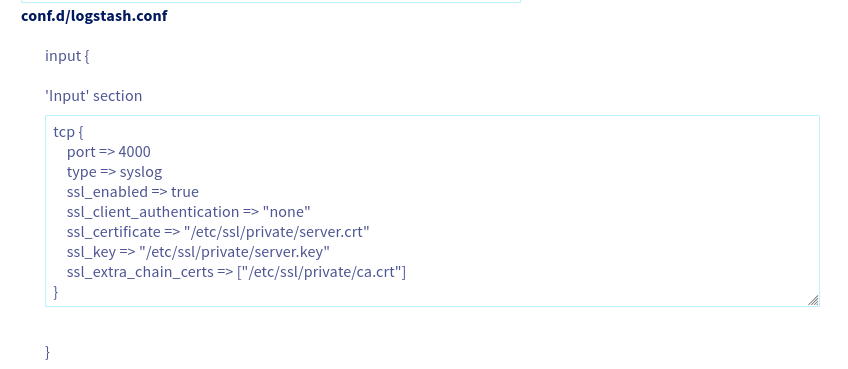

If we take the configuration example above and if we enable the SSL encryption, we have the following configuration for the Input Section:
 tcp {
     port => 4000
     type => syslog
     ssl_enabled => true
     ssl_client_authentication => "none"
     ssl_certificate => "/etc/ssl/private/server.crt"
     ssl_key => "/etc/ssl/private/server.key"
     ssl_extra_chain_certs => ["/etc/ssl/private/ca.crt"]
logstash_creation
As you can see, this is roughly the same configuration that before. The SSL configuration needs 5 extra parameters:
  • ssl_enabled: that allows to enable SSL. Must be set to true.
  • ssl_client_authentication: this deactivates the client certificate verification process that needs a trusted certificate on client side.
  • ssl_certificate: the location of the auto-generated server certificate.
  • ssl_key: the location of the associated key.
  • ssl_extra_chain_certs: the array contains the path to the CA certificate.
All the inputs have preconfigured SSL certificates at the fixed locations used in the configuration above. And for the filter part, you just have to copy and paste the previous configuration.
logstash_creation
The last section of the configuration is dedicated to custom Grok Filters. If you know about Grok, you can use this text area to create your own grok that you can use in the filter section above. It is an advanced usage of Logstash. Head to the end of the document to get some reference links that can help you use this functionality.

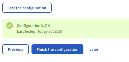

To validate the settings, you will have to click on Test the configuration button. After some fancy calculations you should see on the screen a green confirmation.
logstash_testing
You can then click on Finish the configuration button to save your configuration!

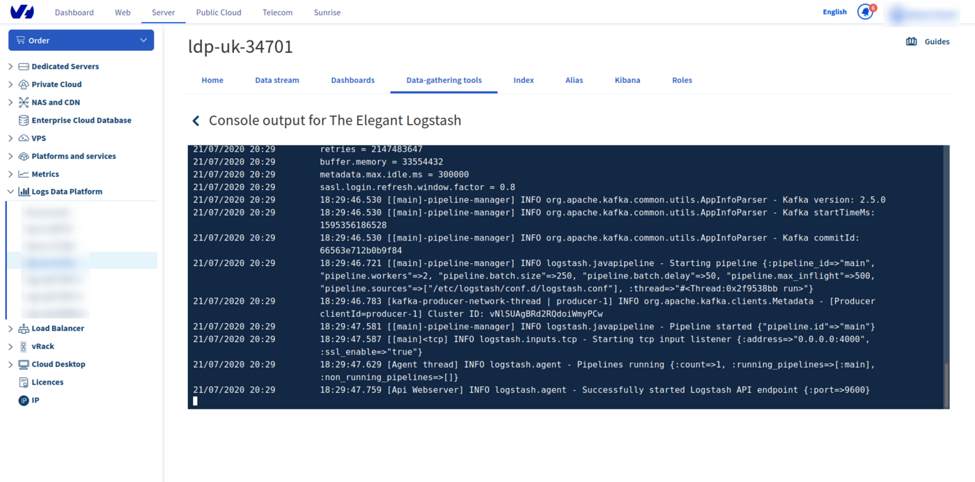

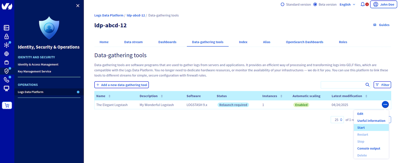

Starting the input
Starting the input is done by using the Start Button in the ... menu at the right of your input. Click on it to deploy your collector on Logs Data Platform.
input_start

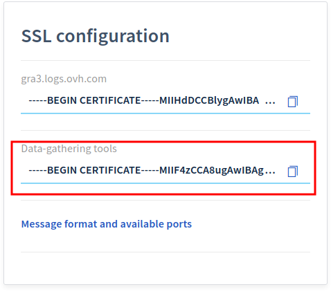

Collector useful information
Once your collector is started, you can copy several pieces of information to your clipboard.
  • The hostname
  • The public IP
  • The SSL Certificate
The hostname is in the following form:
<your_cluster>-XXXXXXXXXXXXXXXXXXXXXXX.<your_cluster>.logs.ovh.com
This is an address of your collector for the cluster on Logs Data Platform. Send your logs to your address to have them processed by your collector. Use for example the previous syslog Lines to test your collectors. If you head to Graylog, you will find your Logs in the attached Stream just as before.

SSL CA certificate
The CA certificate you can use to verify the authority presented by our hosted collectors can be copied from the homepage of the Logs Data Platform manager.
input_ca
Console output
Last but not least, if you have concerns about the way your logstash is handling your logs, you may be interested to follow the messages coming from your collector. To do this, please go to the dedicated page by clicking on the Console output button.
input_console
