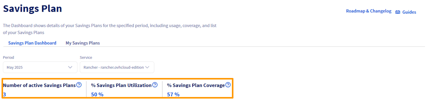

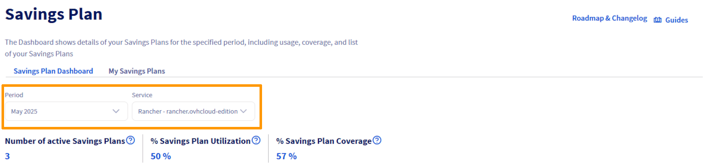

Use the dashboard to analyse your Savings Plans
The Savings Plans dashboard allows you to track and analyse your Savings Plans, providing essential information about their usage and coverage. You can view specific data by period and service.
The dashboard is not a separate page: it opens as a panel below your list of Savings Plans. To display it:
  1. In the left-hand menu of your Public Cloud project, click Cost center.
  2. Click the Savings Plan tab.
  3. In the My Savings Plans section, click Show the dashboard.
The Savings Plans usage and coverage panel opens below the table of your Savings Plans. It contains the filters, the indicators, the chart and the Savings Plan usage table described below. Click Hide the dashboard to close it.
a. Selection filters
The two filters sit at the top of the panel, above the chart.
  • Service: Allows you to filter the specific service the Savings Plans are associated with. The list shows each model code followed by its type, for example b3-8 · Instance or rancher.standard · Managed Rancher Service.
  • Period: Allows you to select a specific month to observe the use of Savings Plans and the associated coverage.
b. Savings Plan indicators
The indicators displayed in the Savings Plans dashboard are adjusted according to the filters applied. This makes it possible to customise the display of indicators to focus on specific periods or particular services and models.
Only data from the last 6 months are available.
The indicators are displayed above the chart:
  • Active plans: Total number of your active Savings Plans for the selected resource over the selected period.
  • Utilisation: Average use of your Savings Plans over the selected period for the selected resource, shown as a percentage gauge. For example, if you used 8 instances and your Savings Plans cover 10, the utilisation rate is 80%.
  • Coverage: Average coverage of your Savings Plans over the selected period for the selected resource, shown as a percentage gauge. For example, if you have consumed 10 instances and your Savings Plans cover 8, your coverage rate is 80%.
If the selected period has already ended (any month before the current one), two additional indicators are displayed to give you more detailed data:
  • Cost savings: Total savings over the selected period for the selected resource.
  • Amount billed (non-discounted): Invoice amount exceeding your Savings Plans configuration over the selected period for the selected resource, billed at the standard rate.

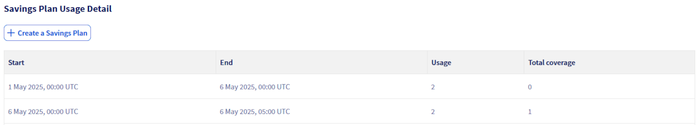

d. Savings Plan usage
The Savings Plan usage table is displayed below the chart.
Each period in the table corresponds to a change in resource usage, such as the addition or deletion of a resource or Savings Plan.
  • Savings Plan usage columns:
    • Start date: The start date and time of the resource consumption period.
    • End date: The date and time at which the resource consumption period ends.
    • Use: The amount of resources consumed during the selected period.
    • Total coverage: The total of resources covered by your Savings Plans during this period.
    • Actions: Holds an icon button to view the resources of the period.

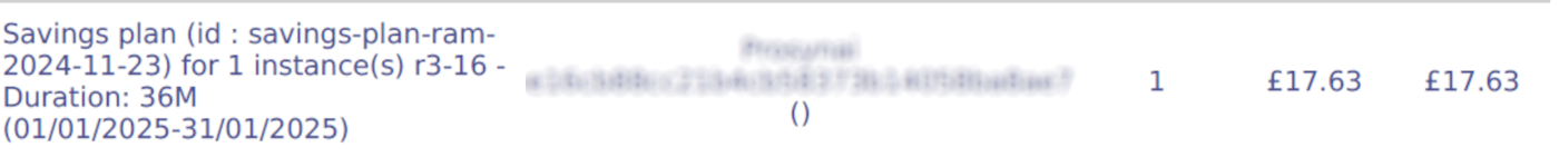

Billing for Savings Plan instances
  • a. Billing for your Savings Plans
When you subscribe to a Savings Plan, you agree to pay a fixed amount for a certain number of instances over a specified period. However, the instances covered by this plan are not itemised individually on your bill. On your invoice, you will only see the total amount corresponding to the Savings Plan, and not the specific instances it covers. This simplifies invoicing by showing only one line that groups all the instances covered by your commitment, without the need to detail each instance.
Billing instances Savings Plan
A pro rata will be applied if your Savings Plan starts during the month.

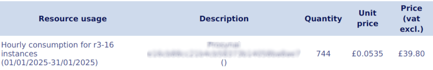

  • b. Billing for your additional instances
Additional instances, i.e. those not covered by your Savings Plan, are billed per second at the standard rate. For example, if you use 10 3rd-generation instances for 10 hours during the month, this represents 100 instance-hours of usage (10 instances x 10 hours), billed at the standard rate in addition to the Savings Plan line.

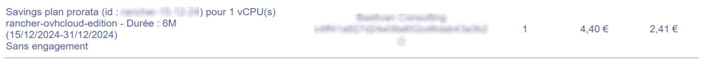

Billing for Rancher Savings Plan
When you subscribe to a Savings Plan, you agree to pay a fixed amount for a certain number of vCPUs over a specified period. However, the vCPUs covered by this plan are not itemised individually on your bill. On your invoice, you will only see the total amount corresponding to the Savings Plan. You won't have details of the different Rancher with the number of vCPUs that cover them belonging to the savings plan.
Billing Rancher Savings Plan

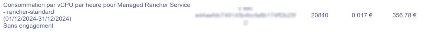

  • b. Billing for your additional vCPUs
Additional vCPUs, i.e. those not covered by your Savings Plan, are billed per second at the standard rate. For example, if you use 10 vCPUs for 10 hours during the month, this represents 100 vCPU-hours of usage (10 vCPUs x 10 hours), billed at the standard rate in addition to the Savings Plan line.
Billing Rancher per hour
Rancher is billed according to the total number of vCPUs on each of the work nodes in your downstream clusters.
