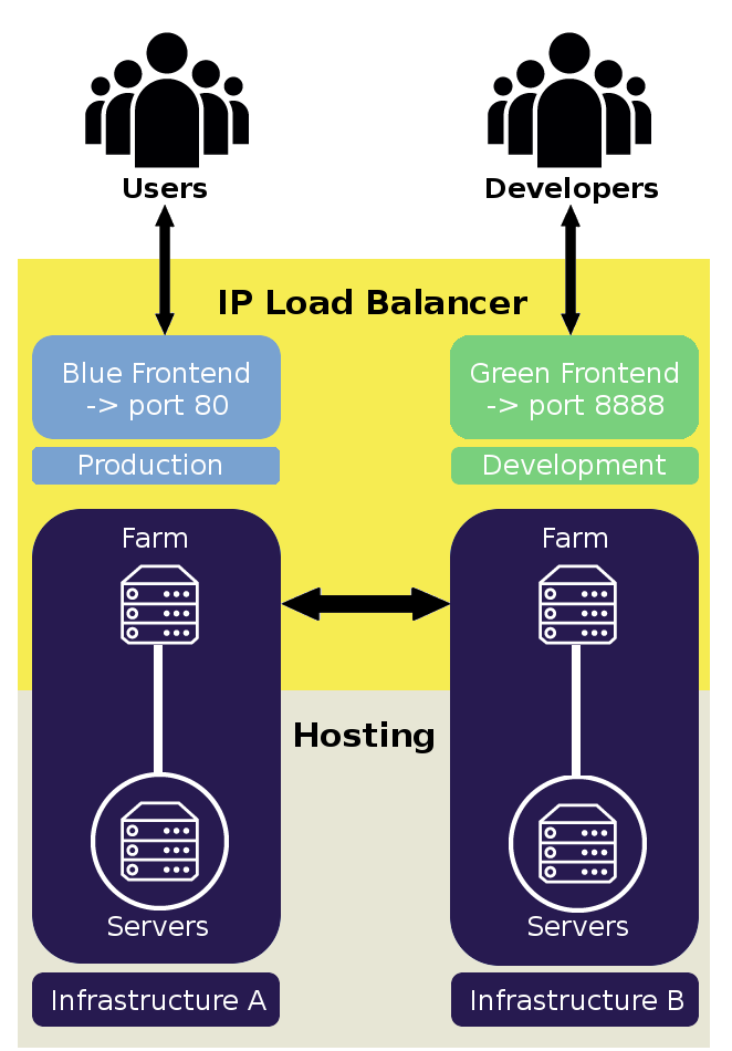

During the initial setup phase, roles are provisionally assigned to each infrastructure component. Infrastructure A serves as the initial production environment, while Infrastructure B serves as the staging environment. At this stage, we will consider them to be similar to one another.
A blue-green infrastructure involves switching from infrastructure A to infrastructure B, once infrastructure B has been fully updated and validated. The Load Balancer will manage this switch.
The diagram below gives a general idea of the architecture:
General diagram of blue-green architecture
Infrastructure A

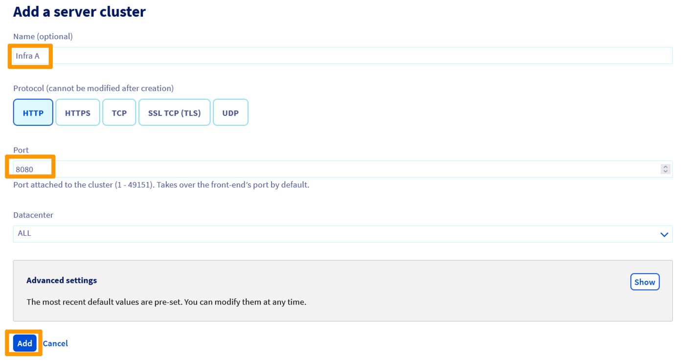

Via the OVHcloud Control Panel
Add a new HTTP farm dedicated to infrastructure A

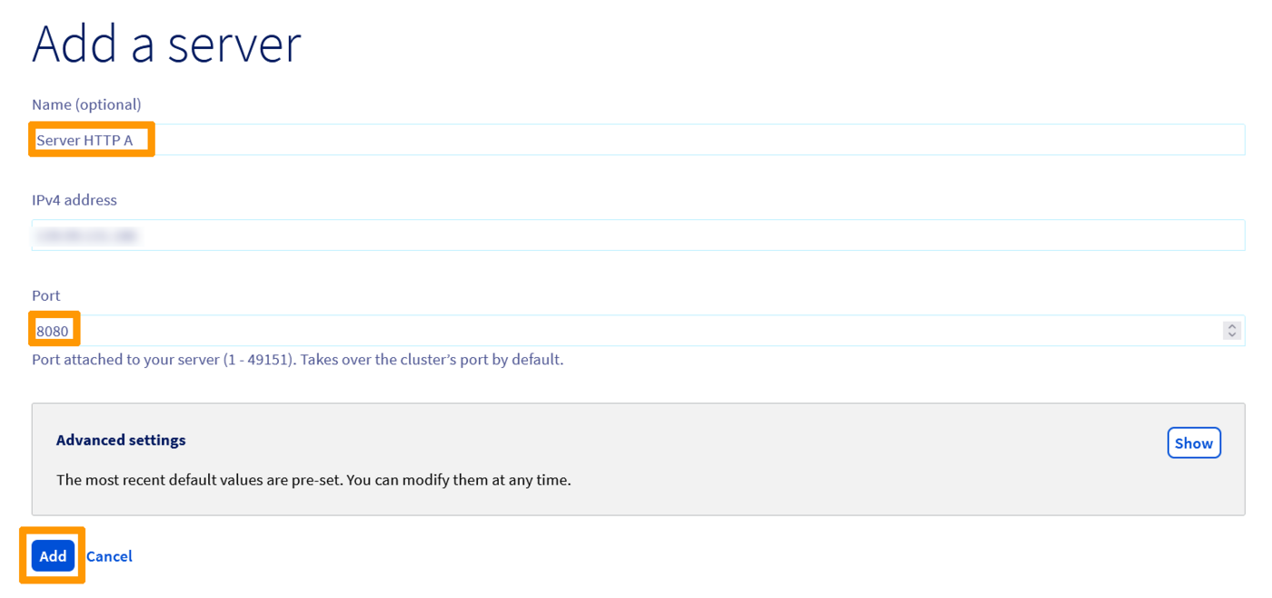

Link a dedicated server to your farm if it hosts your production infrastructure. The service is exposed to the front-end via the server's port 8080. Note that you may LINK one or more servers with each farm (for example, to balance the load or offer higher fault tolerance).
Add a new server to the farm HTTP A
Enter the HTTP A server's configuration
Via the OVHcloud API

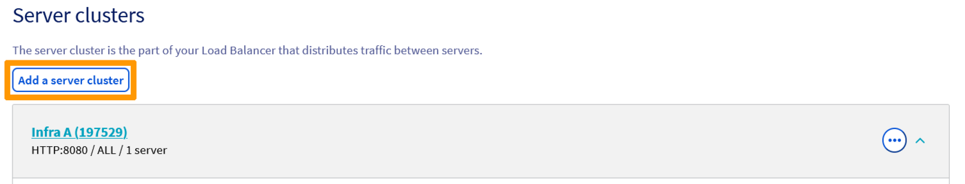

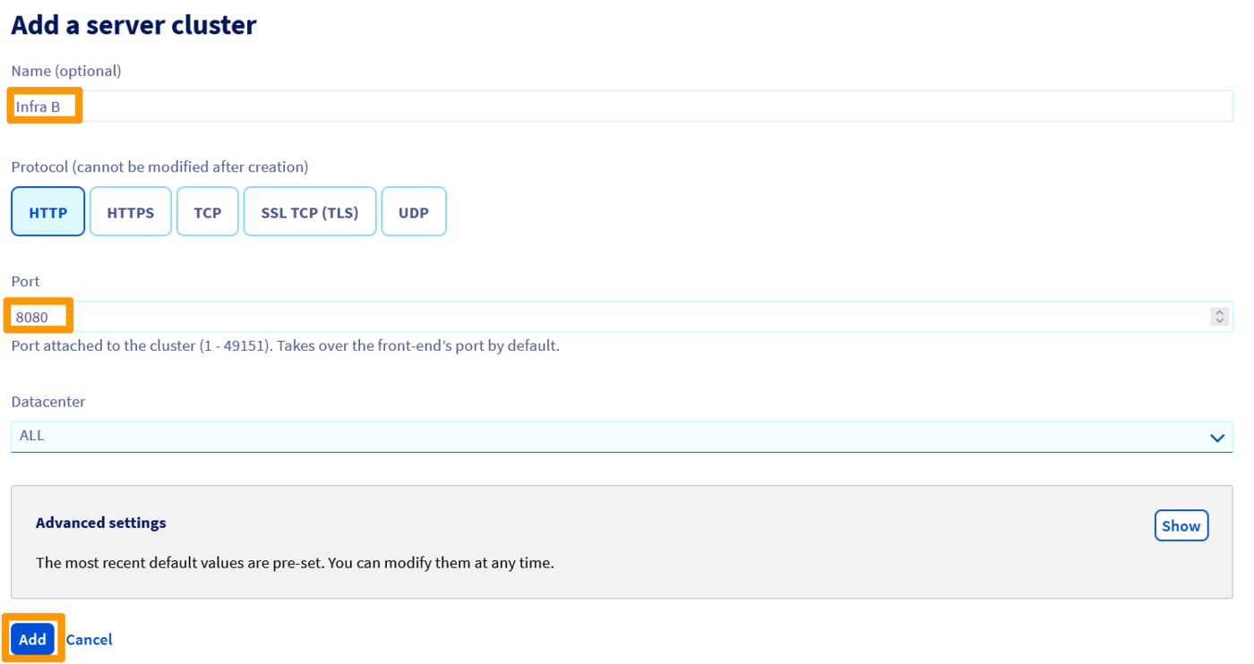

Functionally, this second infrastructure is identical to the first. It is also composed of a server farm that will later be associated with a second front-end of your Load Balancer. This server farm exposes the same service to the front-end as the first server farm. This service is supplied on the servers by port 8080.
Deploy the server farm for the HTTP service (and/or any other TCP or UDP services required for your final service to be exposed to your customers).
Add a new HTTP farm dedicated to infrastructure B
Create a second farm dedicated to infrastructure B

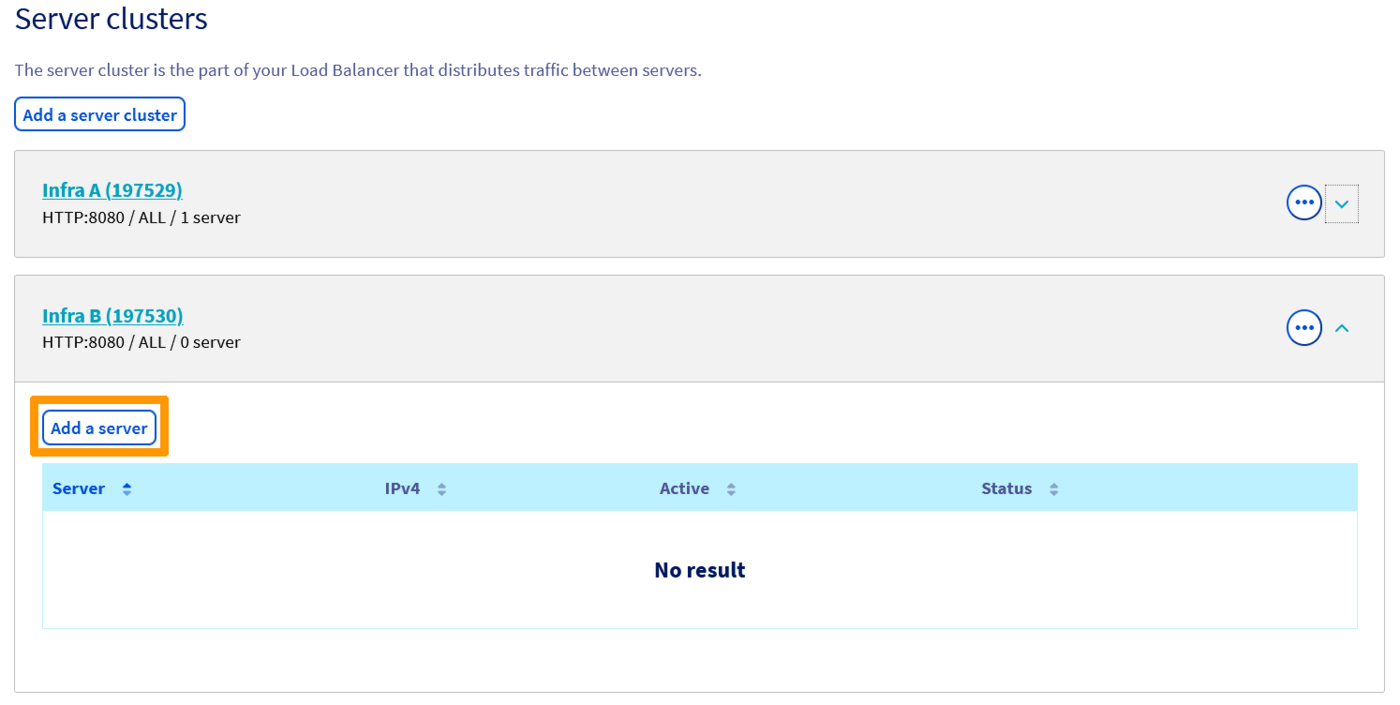

Associate a server with your farm. Here, it involves one or more physical servers hosting your development infrastructure.
Add a new server to the farm HTTP B
Enter the HTTP B server's configuration

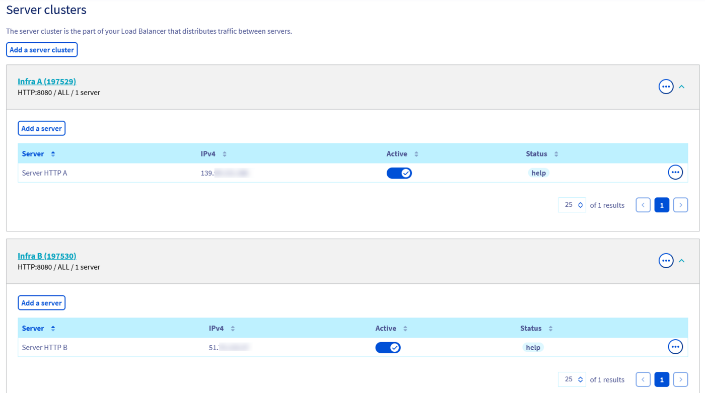

At this stage, here is the configuration status for your two farms:
Farm configuration

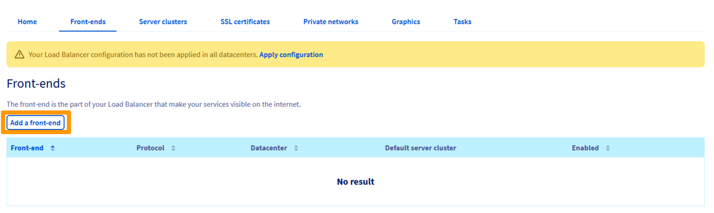

The magic of blue-green deployment lies in the configuration of your front-ends. At this stage, we have configured two functionally identical infrastructures. For both infrastructures, you have declared one or more server farms, each with their own set of associated servers.
To switch simply from one infrastructure to another, we will use front-ends.
To do this, we need to declare two front-ends. The first one will give you access to your production infrastructure, whereas the second will give you access to your development infrastructure. You can control access to one infrastructure or the other using the ports you expose to your customers.
If the final service you expose to your customers requires several server farms (e.g. ports 80 and 443), you will need to declare a front-end for each of your farms.

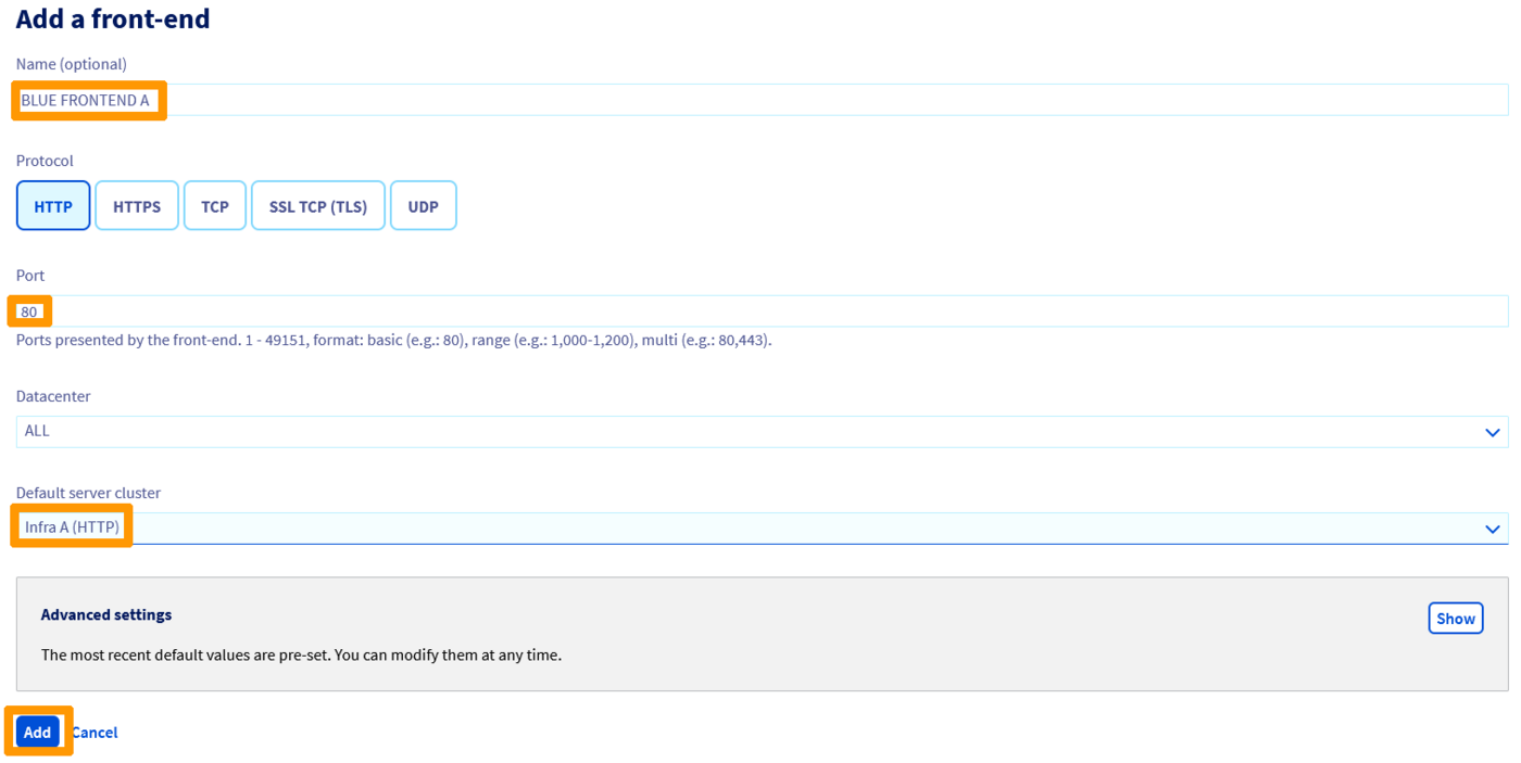

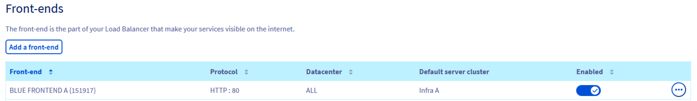

Blue front-end
This front-end is dedicated to accessing the production infrastructure. The ports exposed to your customers are the standard ports for accessing the service. In this case, we are exposing an HTTP service, so we will use port 80 (443 if you would like an SSL termination).
Adding a front-end dedicated to production, a blue front-end
Enter the blue front-end's configuration

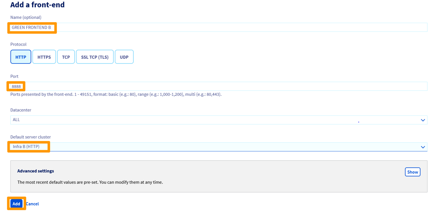

This front-end is dedicated to accessing the development infrastructure. The ports exposed to your customers will be non-standard ports that you can choose arbitrarily. In this case, we will expose the HTTP development service on port 8888.
Add the green front-end, dedicated to development
Enter the green front-end's configuration

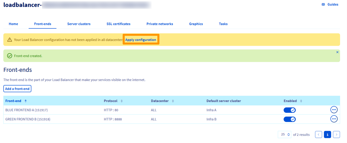

Once you have finished configuring the components of the OVHcloud Load Balancer service, the only thing left to do is apply your changes.
Apply your changes to the zone

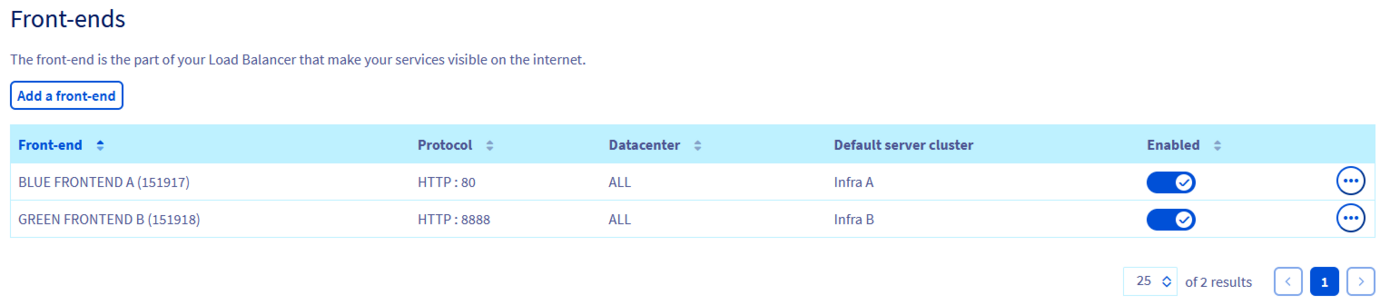

Once you have modified/applied updates to infrastructure B and checked that the service is working properly, you can decide to put it into production.
To switch between the two farms, you can simply update your different front-ends by modifying the ID of the farm it is attached to, and applying the modification.
The blue front-end (id 70089) will then be associated with Farm B (infrastructure B, new production, id 77213).
The green front-end (id 70090) will then be associated with Farm A (infrastructure A, new development, id 77212).
This should be the result on the OVHcloud Control Panel after updating the front-ends and applying the new configuration:
Result after updating front-ends
