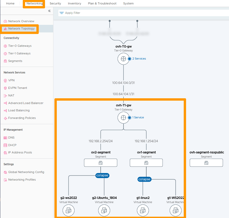

Use the first part of the guide to create a second segment named ov2-segment with these parameters 192.168.2.254/24 in order to have two segments connected to ovh-T1-gw.
05 display four VM on two segment01
Then, from the vCenter console, put two virtual machines on the first segment and two more on the second segment.
Return to the NSX interface in Network Topology to bring up the new network configuration.
05 display four VM on two segment02
Both segments are connected to the gateway ovh-T1-gw. Routing between the two subnets is enabled without any network restrictions by default.

Displaying a network topology with overlay segments and other segments on VLANs
Go back to the NSX interface, go to the Networking tab and click on Network Topology on the left to view a graphical view of the network. You will see networks of type Overlay and those of type VLAN connected through an interface on ovh-t1-gw.
