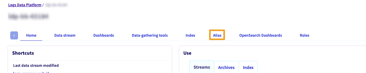

To create an alias in the management interface, go to the Alias section of your Logs Data Platform account as shown in this picture:
Logs Data Platform homepage alias button location

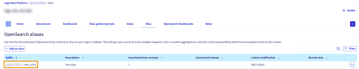

It should look like this:
Logs Data Platform alias section

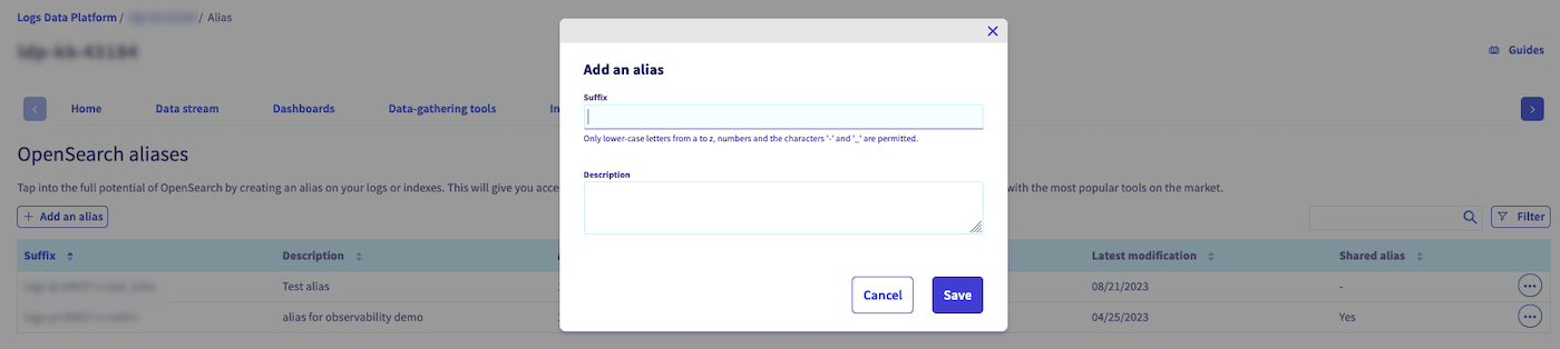

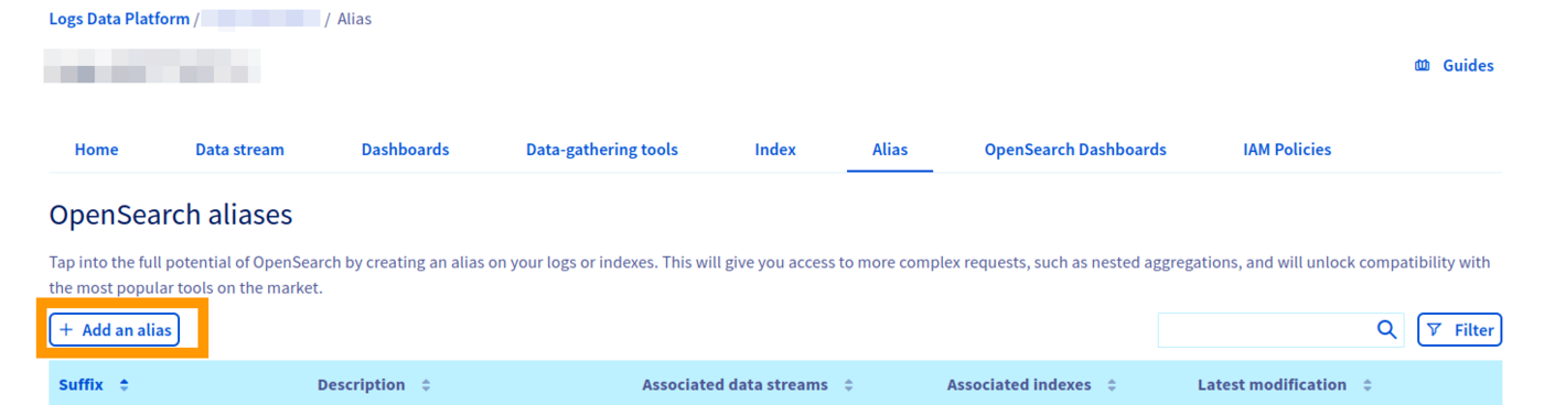

  • Create a new alias by clicking on the Add an alias button.
Logs Data Platform homepage alias creation
  • Once created, you can edit the description, access the alias via the OpenSearch web UI or delete the alias via the ... button.

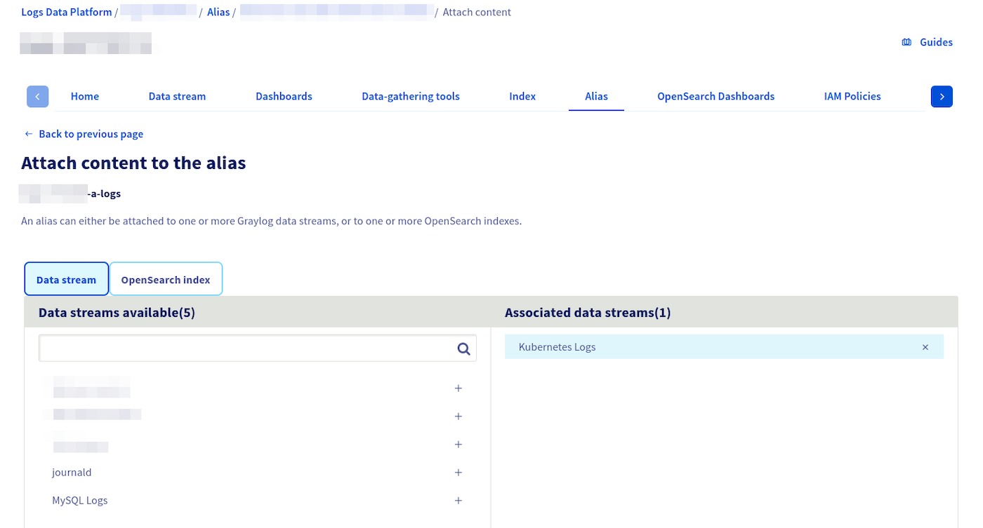

Attach an alias to a stream
  • Attach and detach streams and/or indices to an alias by clicking the ... button and then on the Attach content to the alias button.
  • Then you choose the stream you want to attach to the alias.
Logs Data Platform alias content attachment
