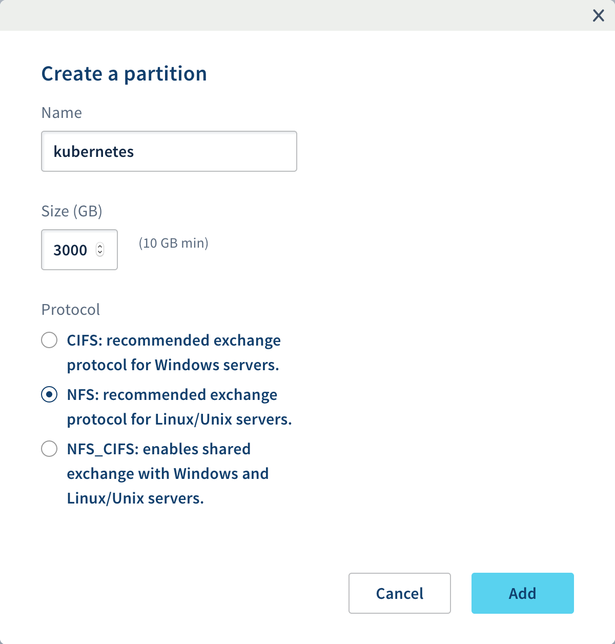

Your NAS-HA can expose multiple partitions, and supports a variety of protocols. Each partition is accessible only from a specific range of IPs. We will create one exposing NFS and make it accessible from your Kubernetes worker nodes.
In the OVHcloud Console, open Bare Metal Cloud > NAS-HA (under Storage) and click your NAS. In the Console, partitions are called volumes: open the Volumes tab, then click the Create a volume button. Fill in the Volume name, set the desired Size (GB), and select NFS as the Protocol, then click Create a volume.
Your cluster is installed with Public Network or a private network without using an OVHcloud Internet Gateway or a custom one as your default route

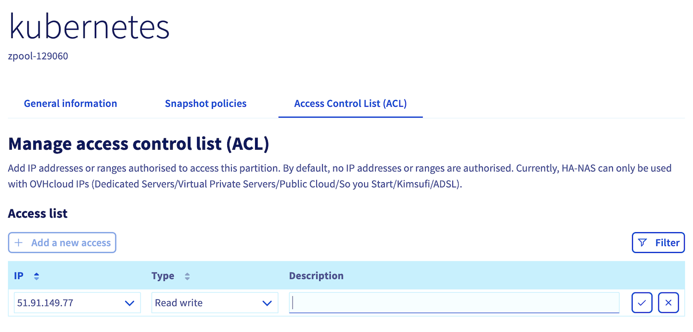

Once the partition is created, we need to allow our Kubernetes nodes to access our newly created partition.
Get our Kubernetes nodes IP:
kubectl get nodes -o jsonpath='{ $.items[*].status.addresses[?(@.type=="InternalIP")].address }'
$ kubectl get nodes -o jsonpath='{ $.items[*].status.addresses[?(@.type=="InternalIP")].address }'
51.77.204.175 51.77.205.79

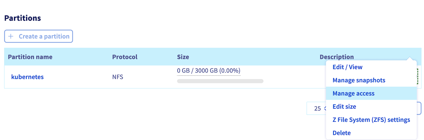

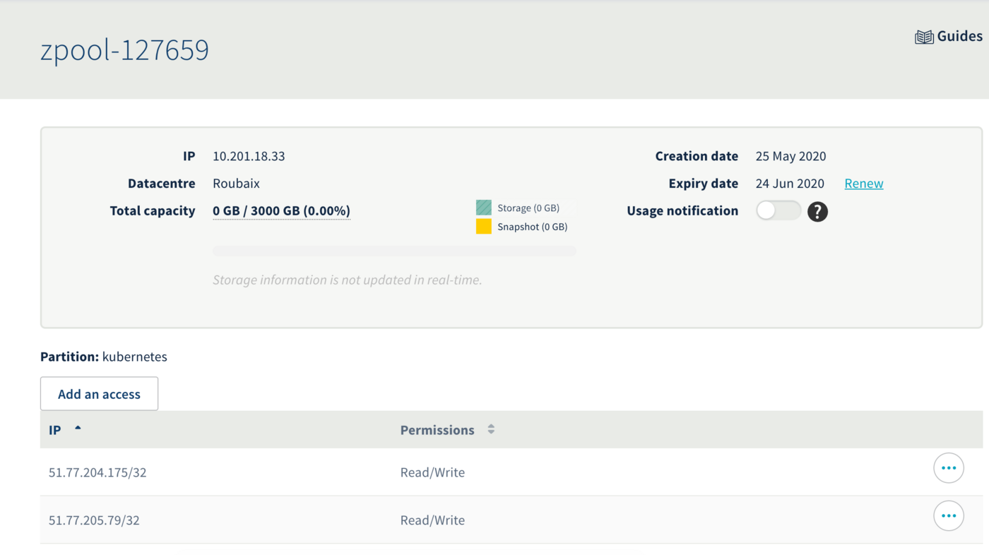

In the Volumes tab, tick your newly created volume, then click Actions and Manage access. Add either the nodes' IPs one by one or the Gateway's Public IP depending on your configuration. For each entry, click Add an access, select the address in IP, the Type of access, and click Add an access.
Once access rules are saved, note the zpool IP (ZPOOL_IP), the zpool name (ZPOOL_NAME), and the partition name (PARTITION_NAME) (the zpool name is the Identifier and the zpool IP the IP address shown in the General information card of the Overview tab of your NAS-HA).
In this example our ZPOOL_IP is 10.201.18.33, our ZPOOL_NAME is zpool-127659, and our PARTITION_NAME is kubernetes. Please modify this accordingly in the later steps.
