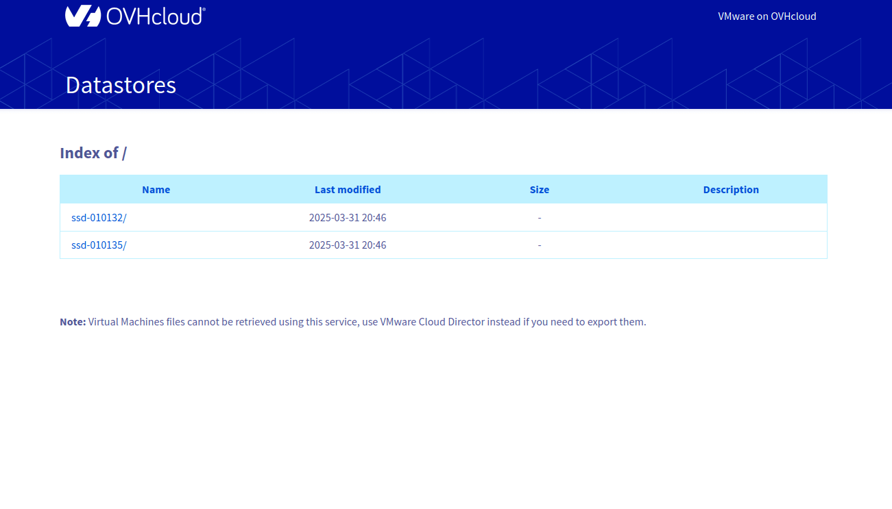

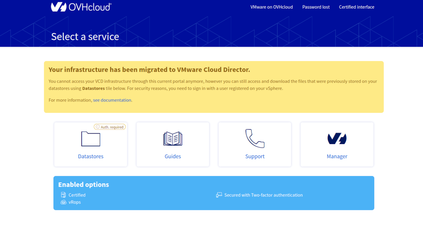

Accessing datastores after migration
After migrating your Managed vSphere service to your Public VCF as-a-Service organization, you can still access your datastores via the legacy Managed vSphere interface.
Datastores dashboard
This interface allows you to view and download the files still stored on your datastores.
For security reasons, only users who existed before the migration can log in.
Passwords for these users may have been reset during the migration process. If needed, you can update them using the with the following call:
Virtual machines cannot be recovered from this interface. To export your VMs, use your Public VCF as-a-Service organization.
