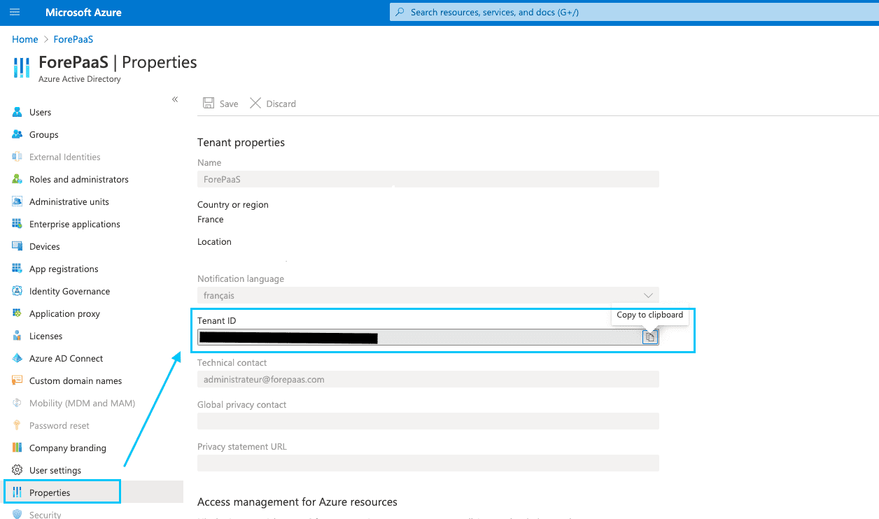

Step 1. Retrieve the Tenant ID
Note that the interface of Azure Active Directory may change over time, and screenshots could be outdated. Please refer to the Azure AD documentation portal if you are unable to find some of the features listed below.
The Tenant ID is the ID of your Azure company environment. To find it, select Azure Active Directory in the list of Azure Services. Then, in the sidebar click on "Properties".
Tenant
Note that this ID will be required later on during the IAM configuration.

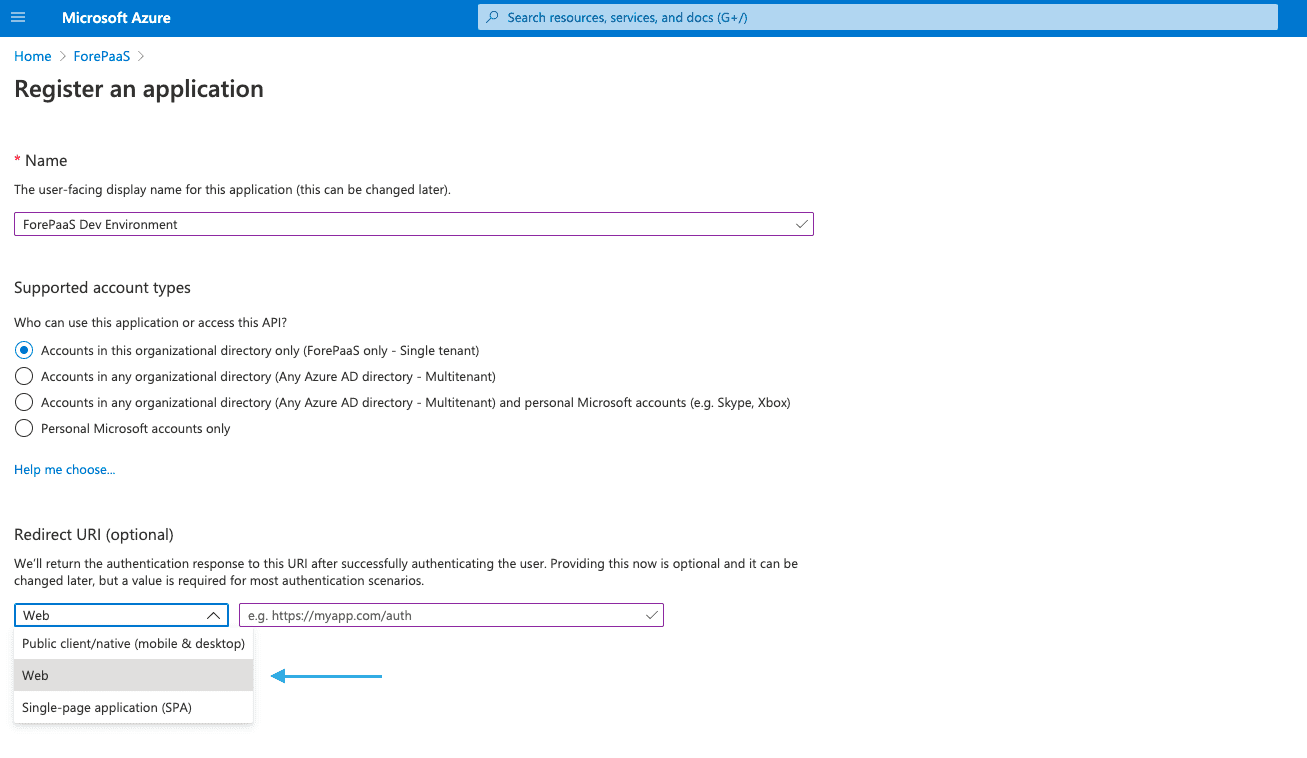

Step 2. Register the Identity Access Manager
You then need to register an application inside of Microsoft Azure AD. This works with any app you would like to connect to Azure but in this case, you are going to register the Data Platform IAM directly.

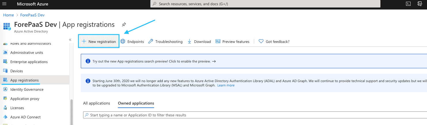

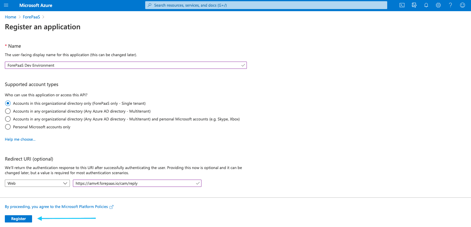

In the sidebar, select App Registrations. Then click on New registration.
App registration

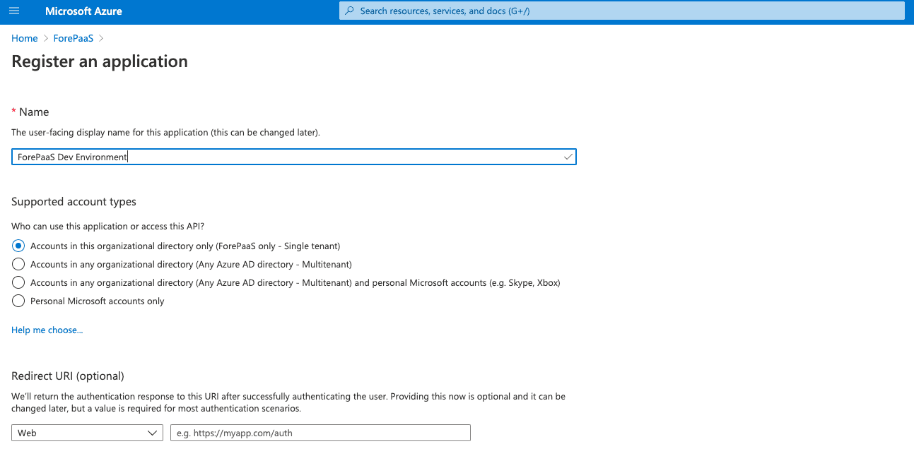

Name
The name is purely descriptive: it will be useful to find your configuration within your Azure AD.
App registration

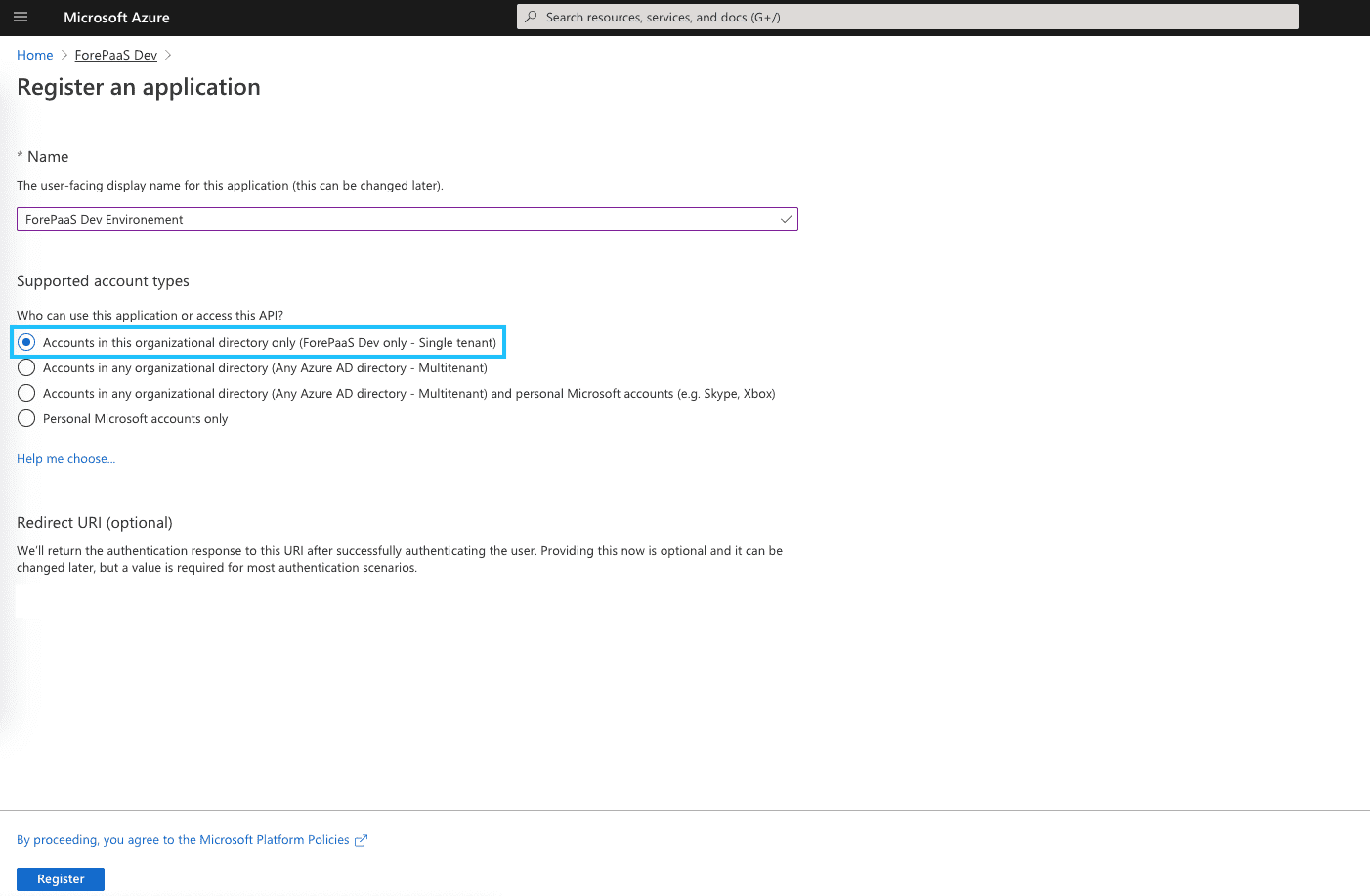

Supported account types
This parameter specifies which Azure AD directories you'll be able to use to authenticate on the Data Platform IAM. It is recommended to select Accounts in this organizational directory only in order that only your AD can log in to your Data Platform IAM.
App registration
Redirect URL
Select Web.
App registration

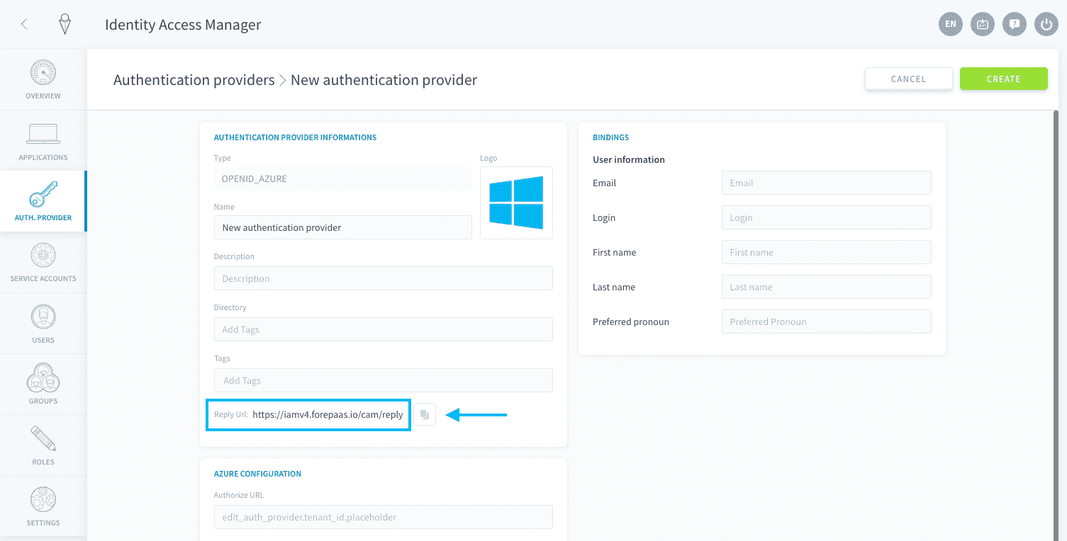

In the URL field, copy and paste the Reply URL field in the new authentication provider you added on Data Platform (it is the same for the entire Data Platform IAM).
App registration
Once this is done, click on Register.
App registration

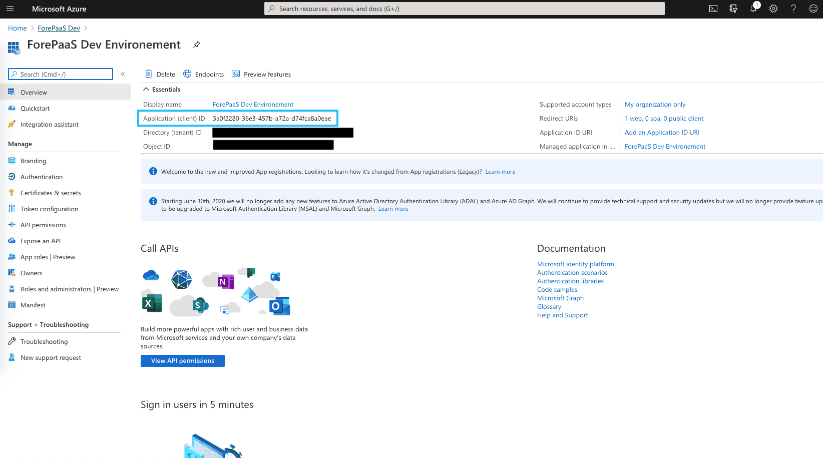

Step 3. Retrieve the Client ID
The Client ID is the user ID of your newly added application (i.e. the Data Platform IAM). You can find it on its Overview page: look for Application (client) ID.
App registration
Note that this Client ID will be required later on during the IAM configuration.

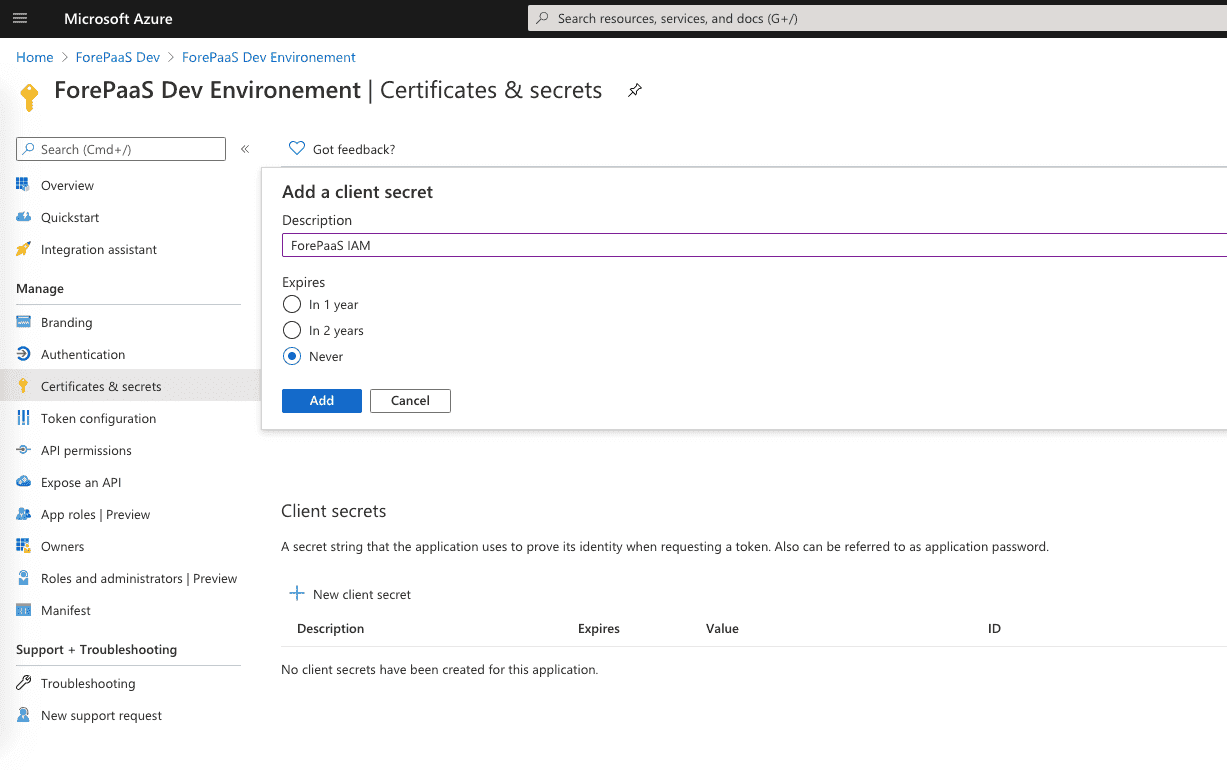

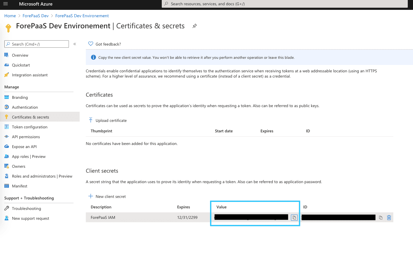

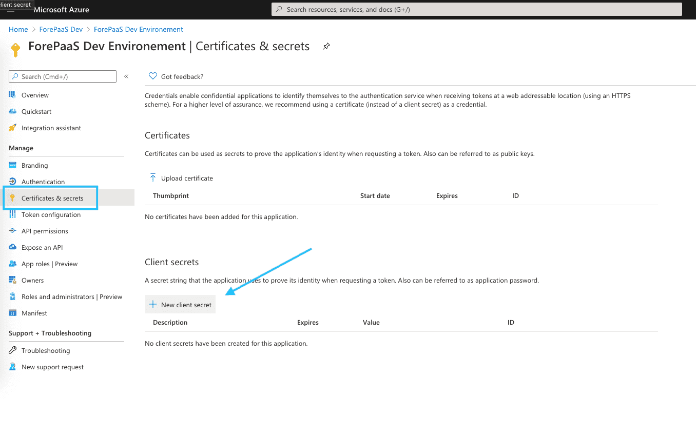

Step 4. Retrieve the Client Secret
On the page of your IAM application, click on Certificates & secrets in the sidebar. Click on New client secret.
App registration
Fill in the description and expiration date of your choice and click on Add.
App registration
Once the client secret is created, copy and save its Value.
App registration
Please note that your Client Secret will be required later on during your IAM configuration.

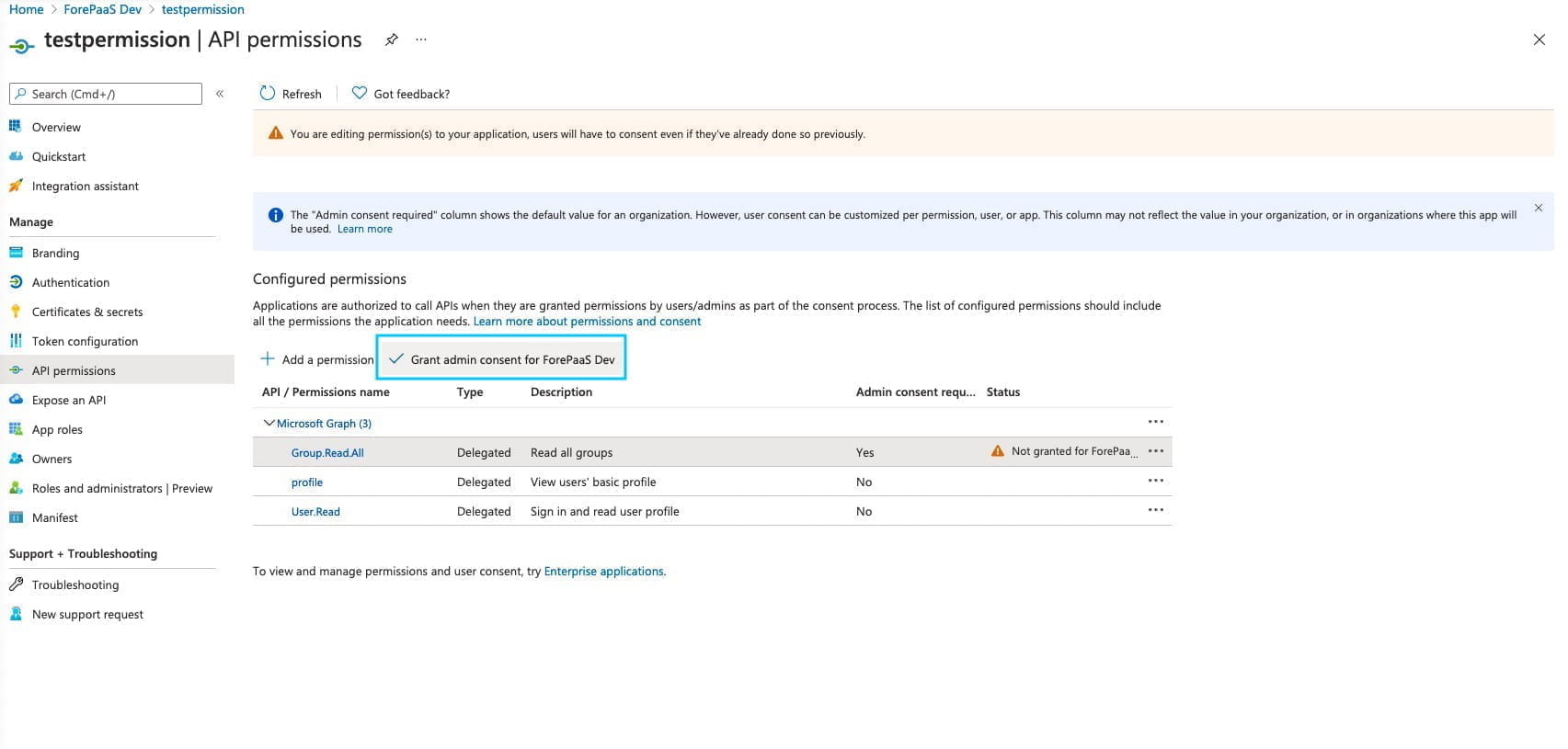

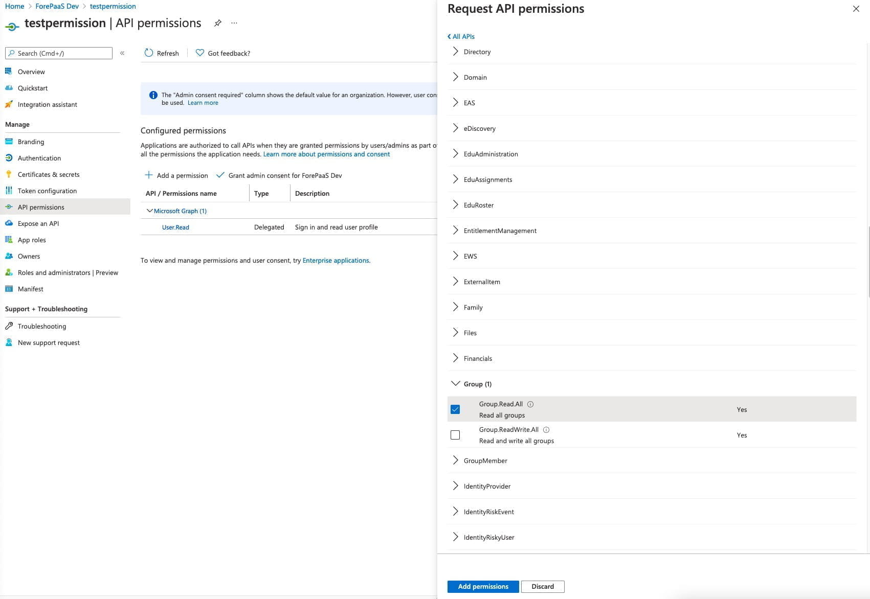

Step 5. Enable basic permissions from Azure AD

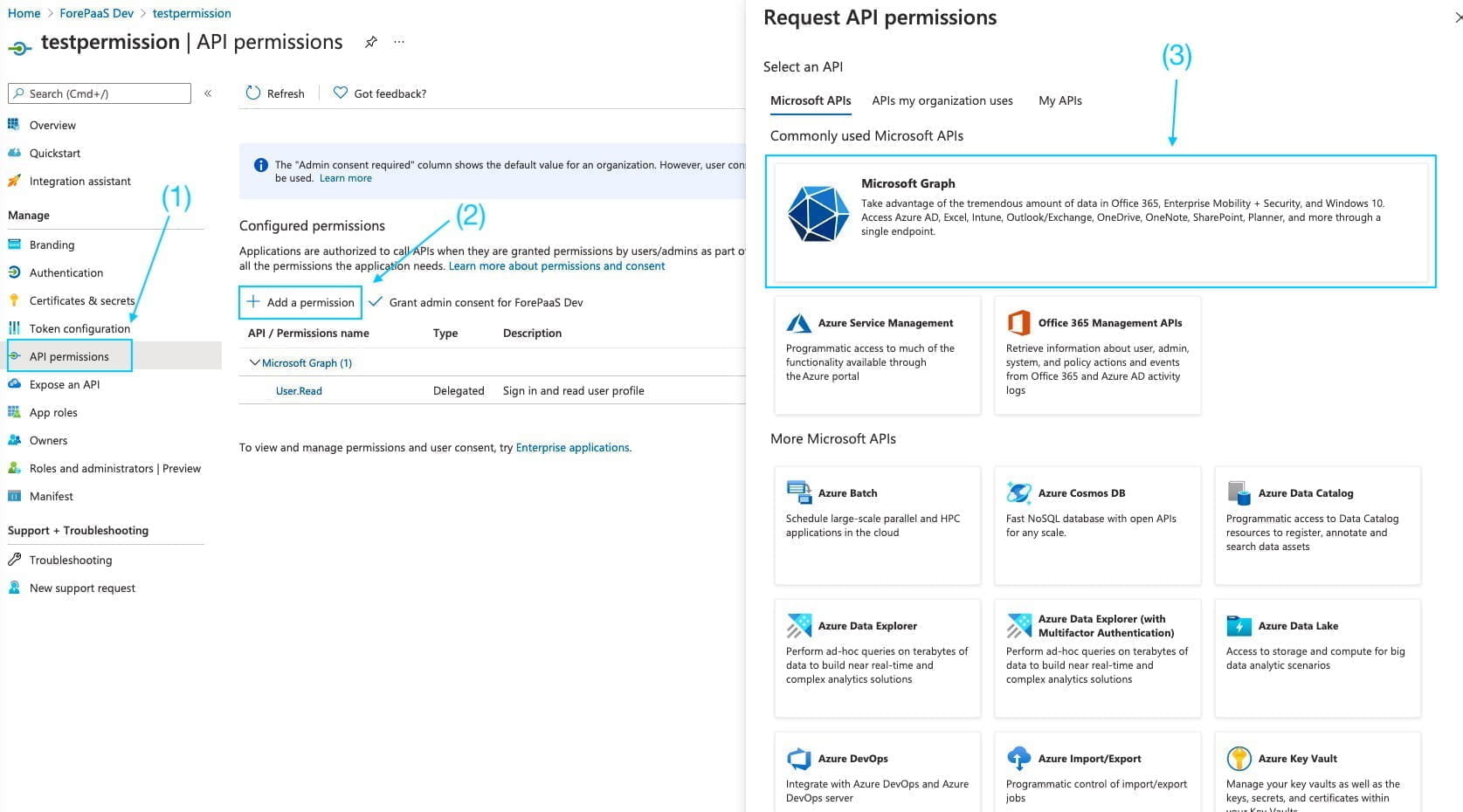

On the page of your IAM application, click on API permissions in the sidebar. Click on New permission and select Microsoft Graph.
App registration

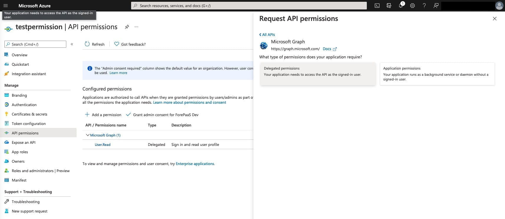

Select Delegated permissions.
App registration

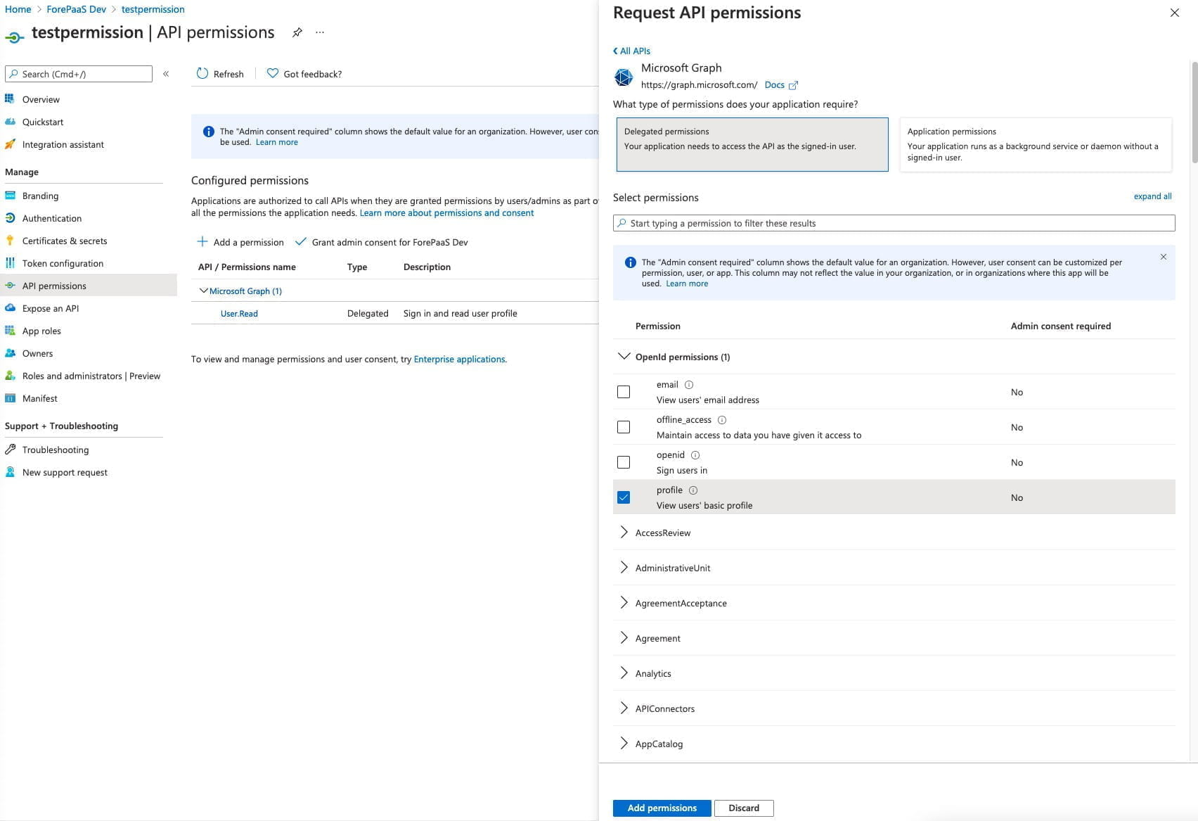

Two permissions must be added in order for the entire feature-set of Azure AD authentication provider on Data Platform to work.
  • profile: this permission is needed if you need to get user information from Azure AD using the UserInfo endpoint.
  • Group.Read.All: this permission is needed if you need to get the list of groups from your Azure AD for a custom mapping
Find them in the list and add them both.
App registration App registration

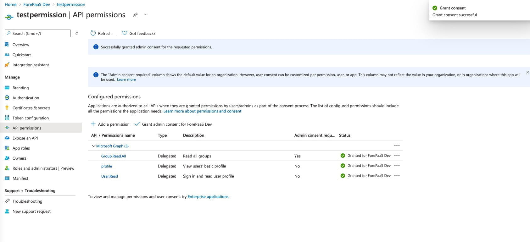

Finally, click on Grant admin consent for your-app and confirm.
App registration
When all permissions have been correctly added, your screen should look like this.
App registration

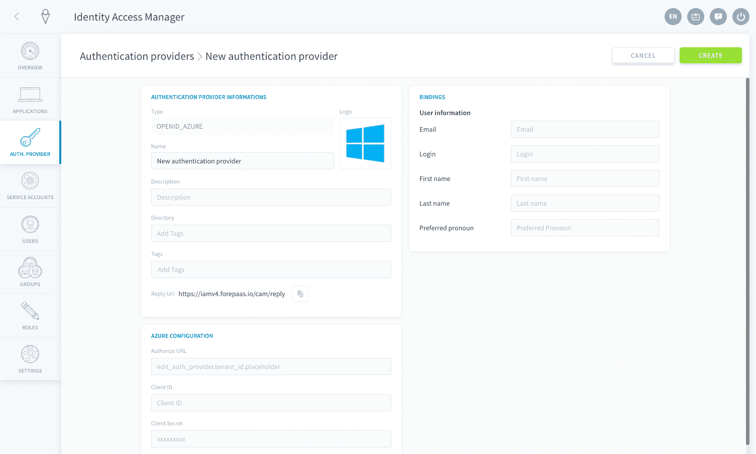

Configuration on the Data Platform Identity Access Manager
You now have to configure your new authentication provider in your Data Platform Identity Access Manager.
Configuration on the Data Platform Identity Access Manager — Azure Identity Access Manager

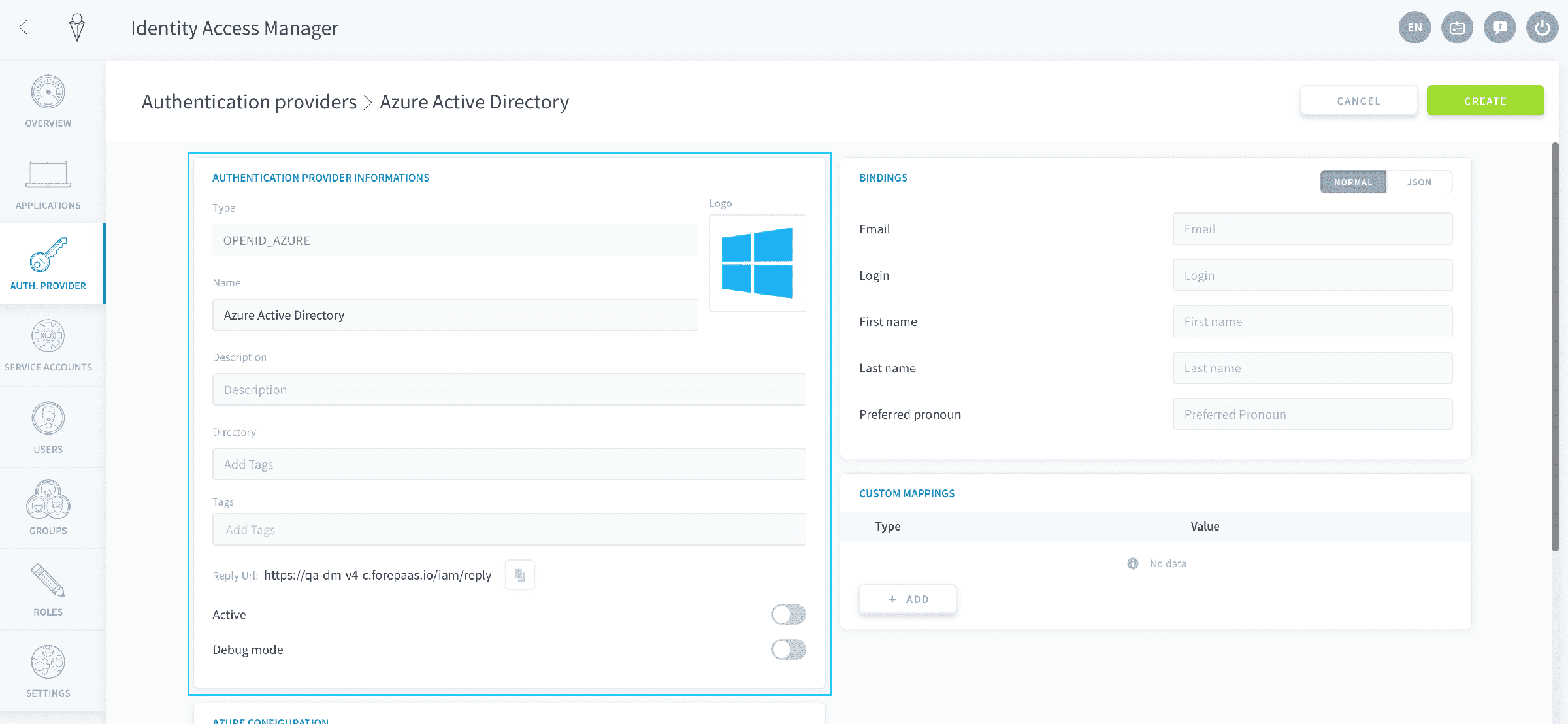

Fill in the basic information
  • Name / Description: This is the internal name and description for your new authentication method
  • Directory: This is a unified tag for all accounts that will be created from this directory. For example, you can input Azure
  • Tags: This offers more tagging options. They are completely optional
  • Reply URL: This is the Data Platform URL where your authentication provider redirects to
  • Active: This specifies whether this authentication provider can be used to login or not
  • Debug Mode: When this is turned on, this enables you to see the authentication logs in the Control Center.

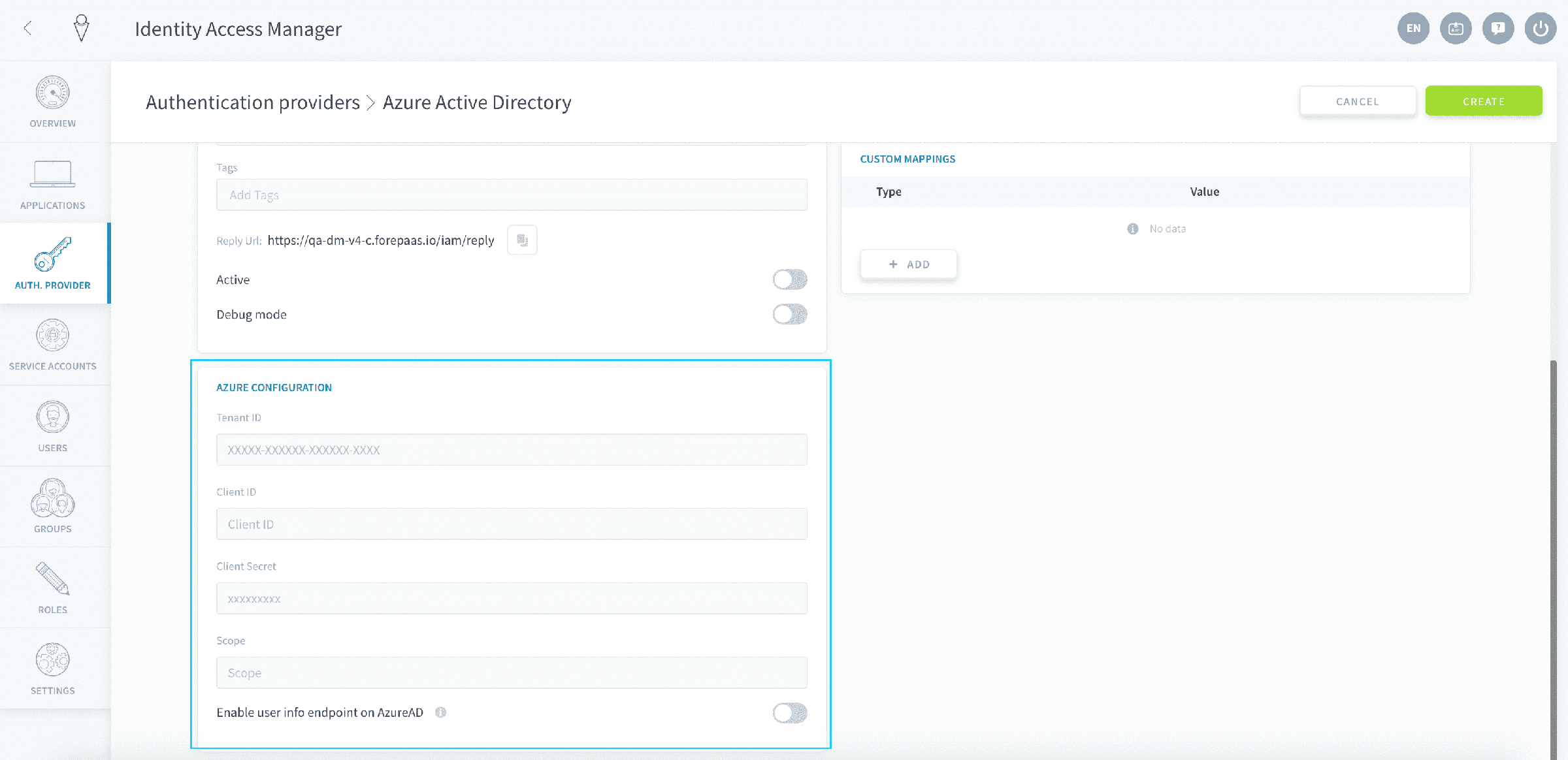

Fill in Azure configuration
Now locate the Azure Configuration panel.
Fill in Azure configuration — Azure config2
Fill in the information collected on Azure in the previous section, as such:
  • Tenant ID: Tenant ID (retrieved in step 1 of the configuration on Azure)
  • Client ID: Client ID (retrieved in step 3 of the configuration on Azure)
  • Client Secret: Client Secret Value (retrieved in step 4 of the configuration on Azure)
  • Scope: This represents how much information Data Platform will be able to access from your Azure AD. This field is optional: if left blank it will use the value openid email profile
  • Enable user info endpoint on AzureAD: This endpoint will allow the IAM to do an extra GET https://graph.microsoft.com/v1.0/users/me call on Azure AD Graph API, the result of which will add a sub-object "user" in addition to the standard OpenID field in the response. This allows you to get additional information on users, like the job title.

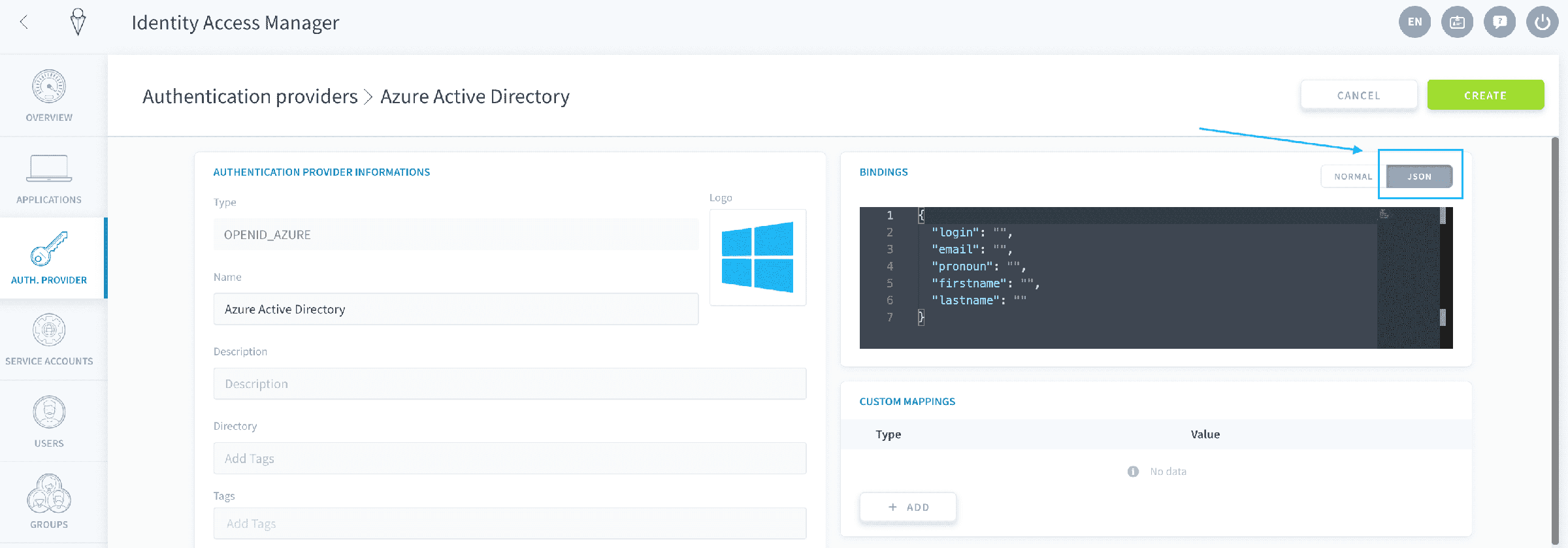

Bindings

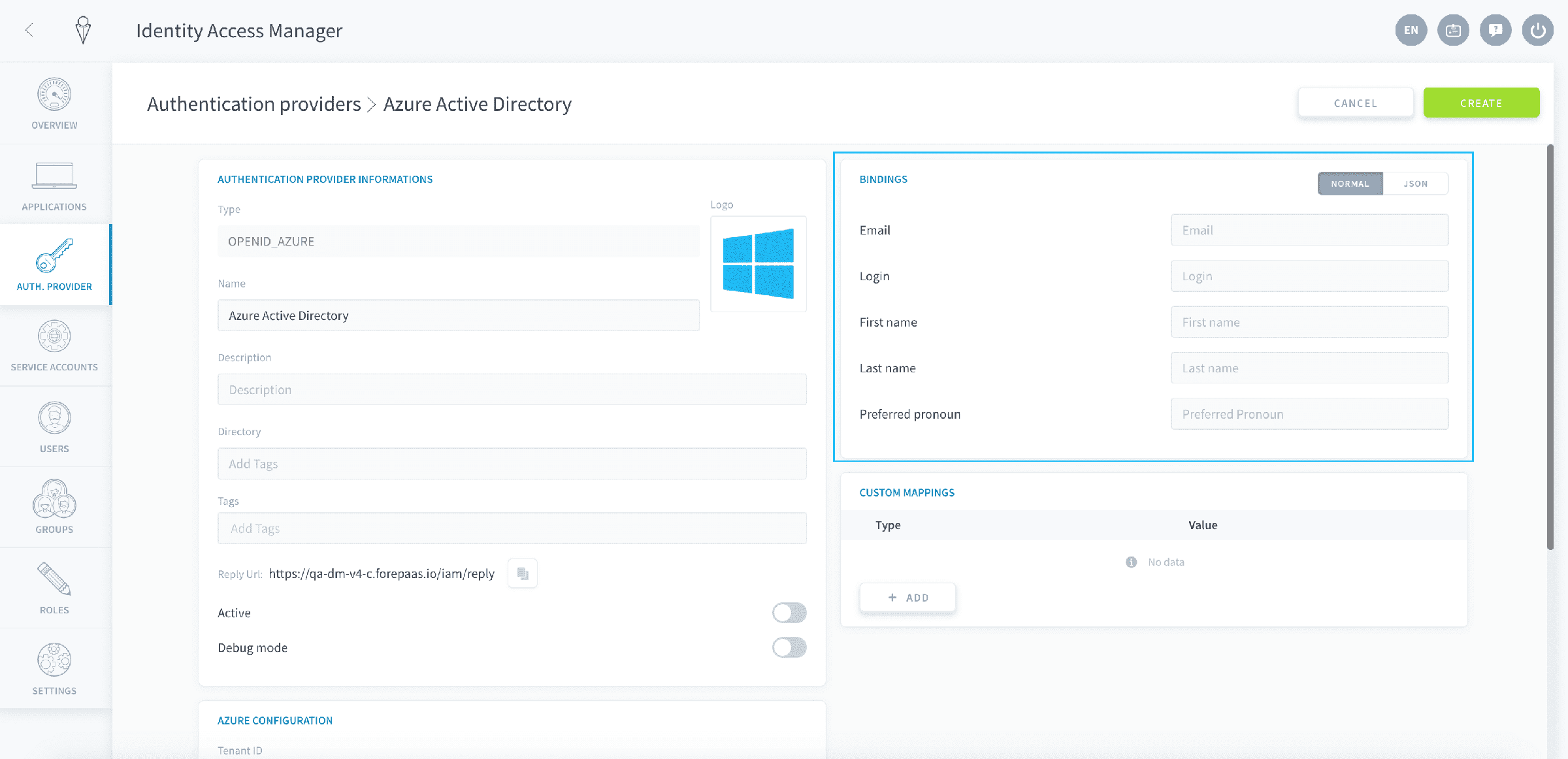

The Bindings panel allows you to customize the mapping of the fields between Azure AD and Data Platform.
Email, login, first and last name are mapped by default.
Bindings — Azure bindings
Bindings can be overriden if you need to save additional information from Azure AD into your Data Platform Identity Access Manager, like the job title.

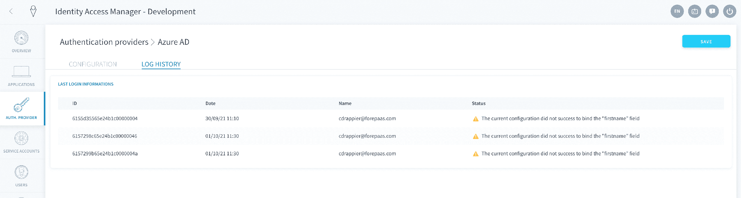

2 - Open the Log History page of the IAM authentication provider (here Azure AD).
Bindings — Azure logs
3 - Open the latest log: the original response from Azure AD will look like this:

4 - On top of the default email, login, first and last name, any additional property from Azure AD can be saved as a custom configuration.XXX field on Data Platform by using the "JSON" mode.
Bindings — Azure bindings2
For example, you can add a fullname property on Data Platform from the name field from Azure AD:
  "login": "email",
  "email": "email",
  "pronoun": "",
  "firstname": "given_name",
  "lastname": "family_name",
  "configuration.fullname": "name"
Test the result of your bindings by checking the logs of further test connections in Log History: the Computed Result section of each login will show what properties have been saved in Data Platform.

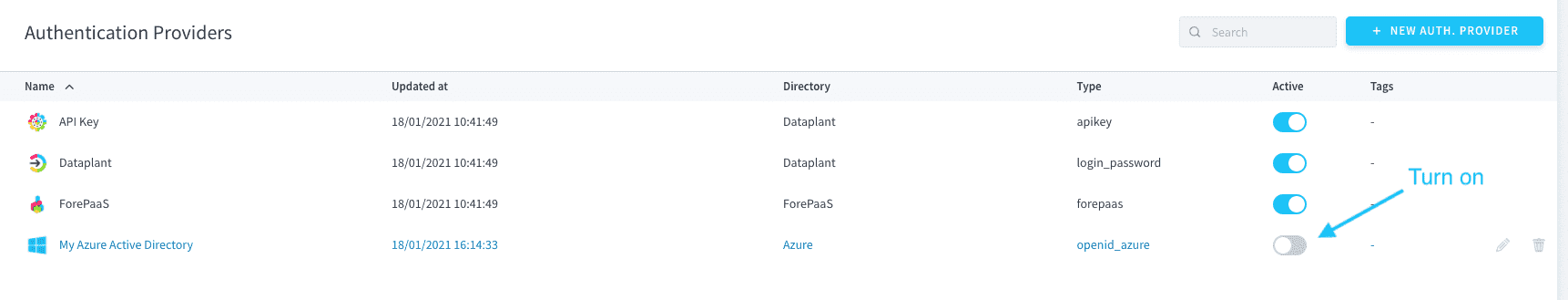

Set live
You are all set configuring your Azure AD! If you haven't done it already, click on Create - else make sure to Save.
In the Authentication Providers list, you now see your new method. Make sure you set it as active.
Set live — Auth active
Make sure this new authentication method is visible for the applications of your choice. You should now see an Azure AD option on your application's login page. By clicking on it, you will be redirected to the Azure login screen, or directly into the app if you are already logged into your account.
