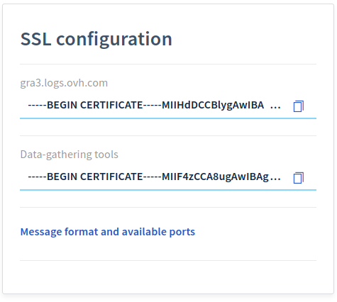

Fill the value of /etc/ssl/certs/ldp.pem with the "Data-gathering tools" certificate you will find in the Home page of your service.

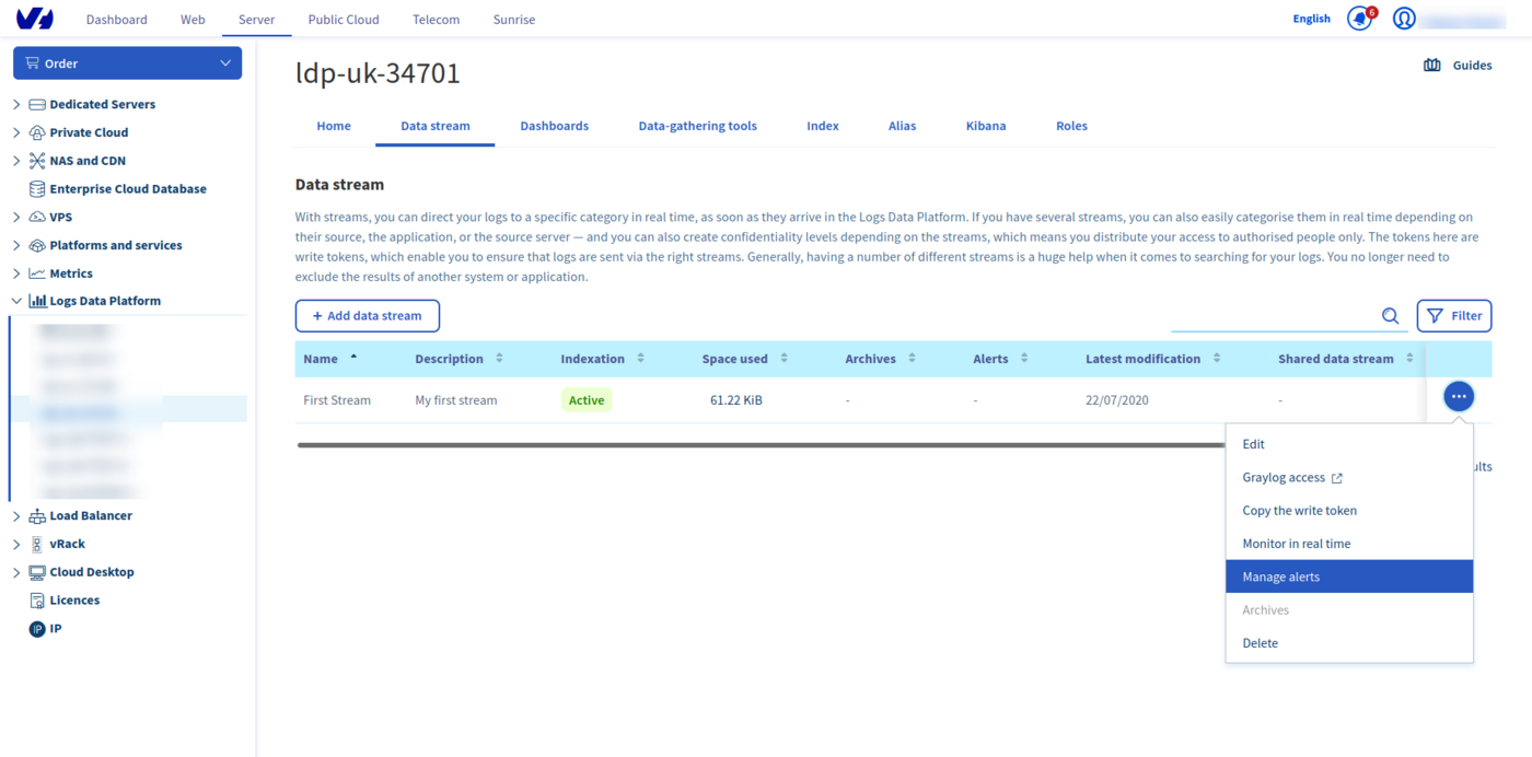

For this, go to the stream page and use the menu at the right to navigate to the Manage alerts menu.
Navigate to alert

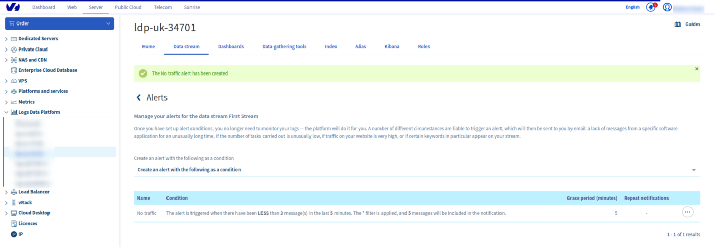

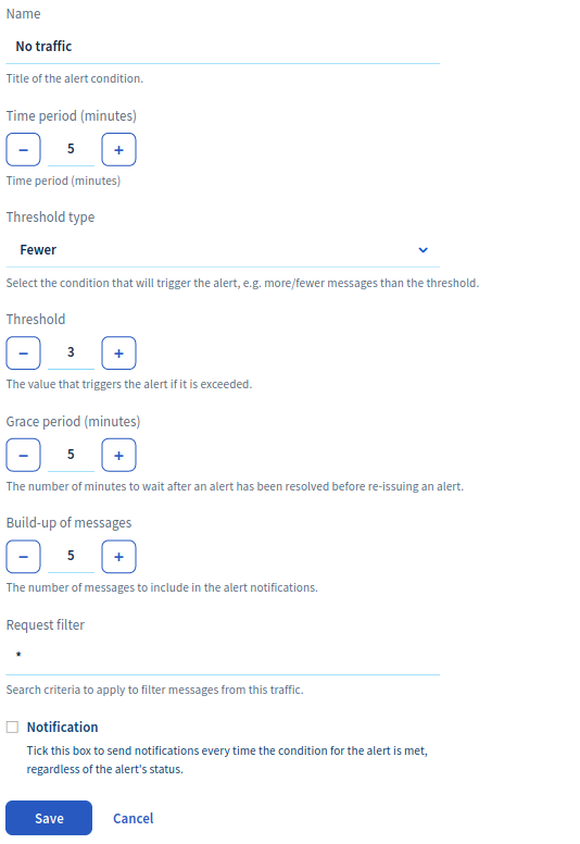

On this interface, select Message count in the Create an alert drop box. Configuring alerts is as easy as filling in the terms describing the behavior of your alerts. For example you can do the following:
Trigger an alert named No Traffic when there are less than 3 messages in the last 5 minutes and then wait at least 5 minutes before triggering a new alert (grace period).
Alert Creation
The sentence above contains the terms that you have to use to create your alerts. Click on Save and your alert will be up and running immediately.
Alert Created
You can remove the alert by clicking on the Delete button.

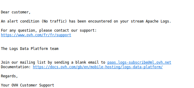

As soon as the alert is fired you will receive a mail, detailing the alert condition that triggered the alert.
No traffic mail

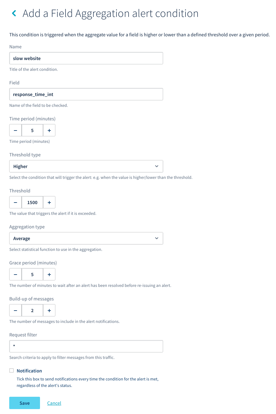

A slow website is a poor experience for your users and can make you lose customers. There are many possible causes for a slowdown: too many connections, a misbehaving web application or an network problem. Fortunately, your Apache logs give you the response time of your server that you can use to trigger an alert when your website is too slow.
To configure an alert based on your website's response time, Select the Field aggregation condition under the Create an alert drop box on the Alerting page. As with the Counter Alert, you have to fill the different fields to create your alert:
Slow website alert

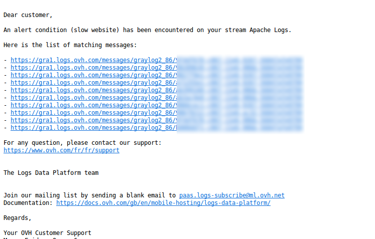

Here, we have configured an alert to be sent when the minimum value of response_time_int is higher than 1500 in the last 5 minutes. That means an alert will be triggered every time you have a web request that took more than 1500 milliseconds (1.5 seconds) to complete. The triggered alert will send you an email similar to the previous one, with a link to the last message included so that you can directly see what pages are too slow.
Slow website alert

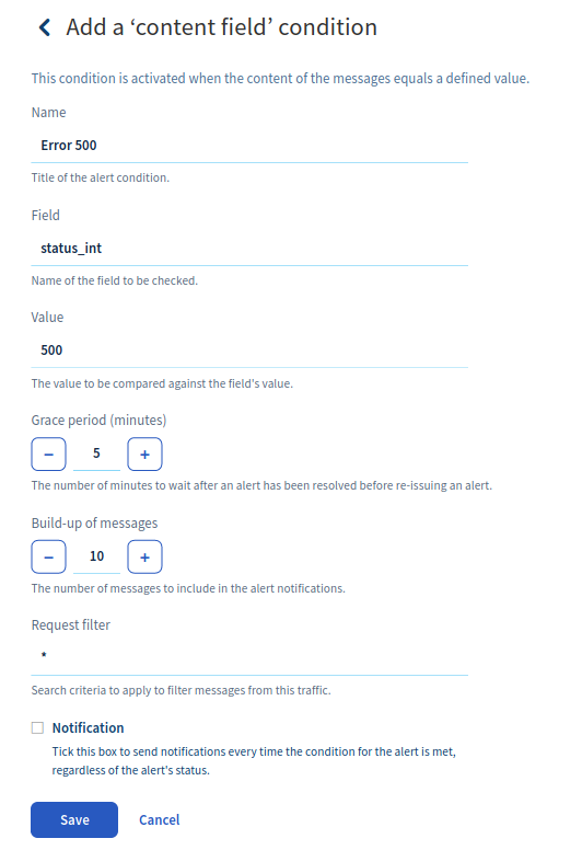

For this alert, we want to be alerted when there is any error 500 on our website. The Field content is the one that you must use when you want some value to be detected in your field. This alert type is located under the Text Content tab in the alerting panel.
Like the previous alert, you have to describe your alert to configure it. Here, the sentence states that the alert must be triggered when the field status_int is set to 500.
Slow website alert
You will then receive an email with the messages included. You can then directly navigate to your Graylog stream for further investigations:
