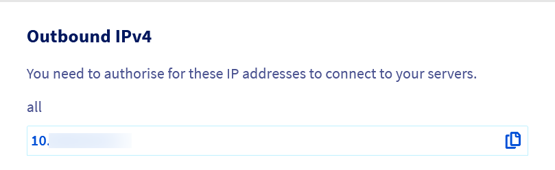

The list of your output IP addresses is available via the OVHcloud Control Panel and the OVHcloud API.
From the OVHcloud Control Panel
The list of IPv4 output addresses that may be used by your OVHcloud Load Balancer service is available on the homepage of your Load Balancer service under the heading "IPv4 output".
IPv4 output address of your OVHcloud Load Balancer service

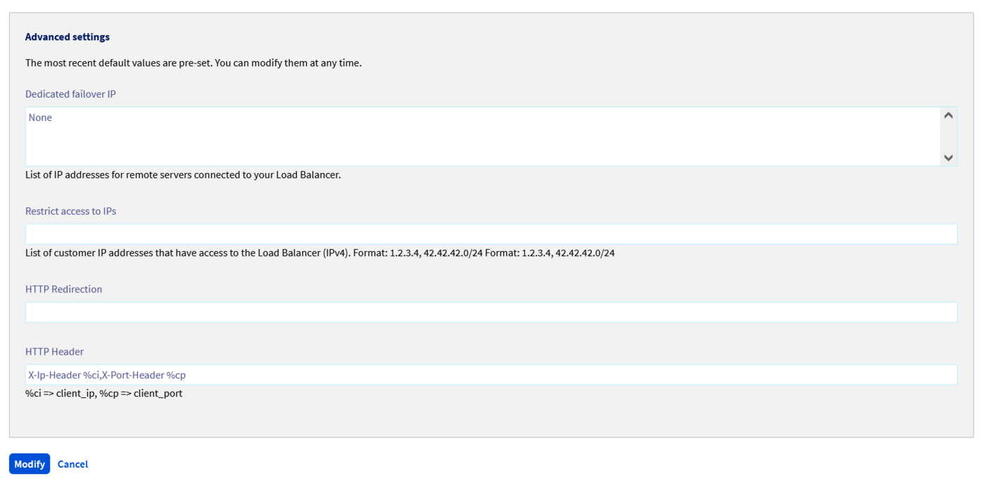

Custom headers can be configured via the OVHcloud Control Panel and the API, whether on a new frontend or an existing frontend.
Go to the Frontends tab in the dashboard of your OVHcloud Load Balancer service and select the frontend to edit or click on the Add a frontend button to create a new one. An editing window will appear, displaying an HTTP Header field in the Advanced Settings section.
If you want to configure multiple headers, they must be separated by commas, without spaces. For example, you can define the following headers: X-Ip-Header %ci,X-Port-Header %cp.
Configuration of HTTP headers of a Frontend via ovh manager API
Click on the Update button after configuring the headers, then on Deploy zone: YOUR ZONE to apply the changes in the concerned zone.

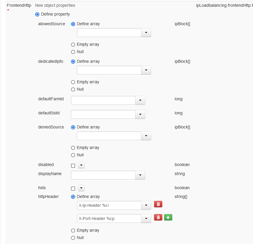

From the OVHcloud API
In the API, the headers are specified within an httpHeader list. Unlike the OVHcloud Control Panel, each header must be its own entry in the list:
  "httpHeader": [
    "X-Ip-Header %ci",
    "X-Port-Header %cp"
  • Modification of an existing Frontend :
ParameterMeaning
serviceNameName of the Load Balancer service concerned
frontendIdIdentifier of the frontend where to configure the HTTP headers
httpHeaderList of headers to configure
