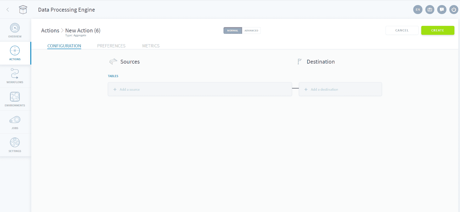

Create a new Aggregate PySpark action:
Transfer raw data into a primary table — Py agg ui

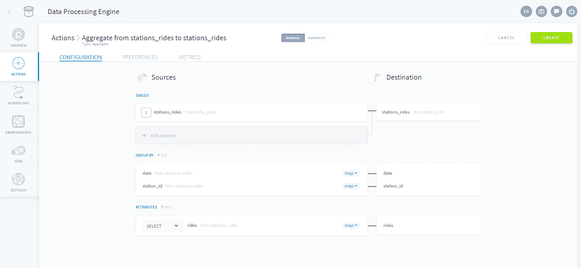

Select the source (left) and destination table. Matching attributes are automatically assigned where possible. It is possible to manually select which attributes are mapped between the source and destination.
Transfer raw data into a primary table — Py agg ui2
If needed, you can change the mapping to either SQL or plain text by clicking on the MAP button and selecting either SQL or txt.
In the attributes section, it is also possible to change the compute mode of each attribute. In the example above, SELECT has been chosen but other options are available.

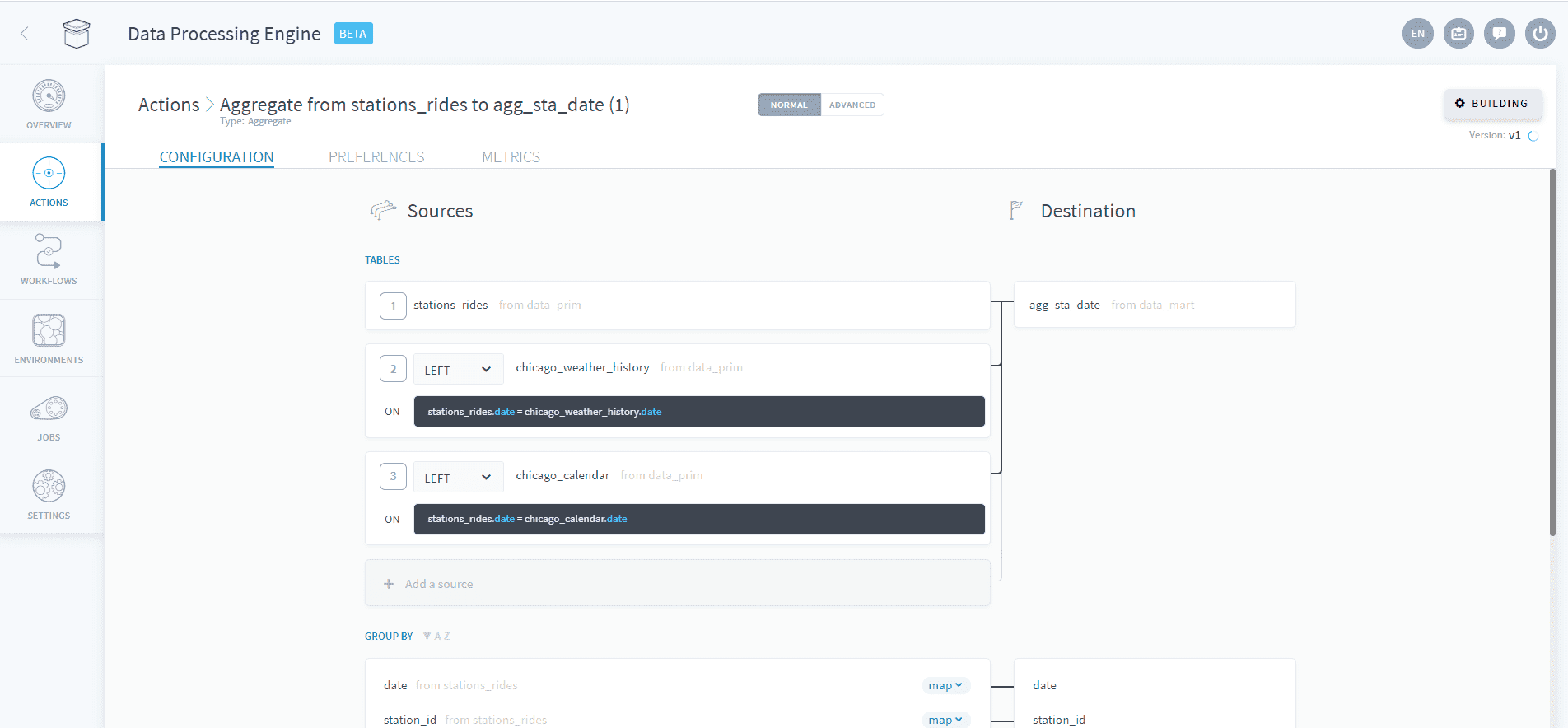

To specify a join, click on Add a source located just below the source table, you will be prompted to select a table to join with. Select the type of join from the dropdown menu, and input the join conditions in the UI. Multiple source tables can be joined.
Join a referential to a primary table — Py agg ui3
Attributes from all the joined tables can then be selected in the bottom attributes section either from the dropdown menus or using SQL.

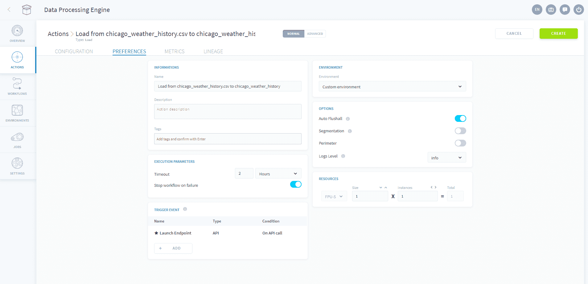

Once you're satisfied with the mapping of your attributes, use the preferences tab to configure the action settings.
Configure the action's preferences — Py settings
Note that the Always-up execution mode isn't available with the PySpark action and that you must use the serverless mode with it.
