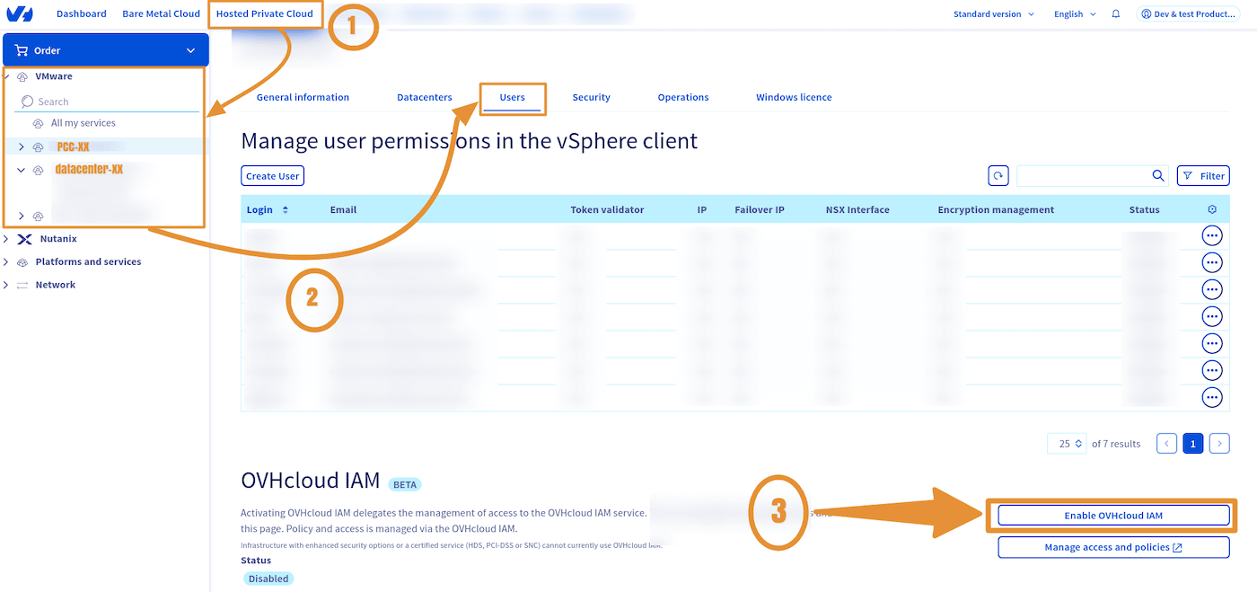

Via the OVHcloud Control Panel
Select your infrastructure, then go to the Users tab.
Under the OVHcloud IAM section, click Enable OVHcloud IAM.
Enable IAM

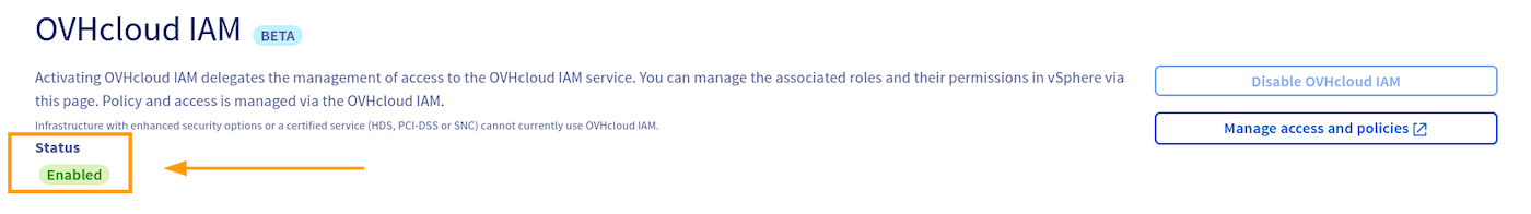

Once IAM is enabled, its status will be Enabled and green.
Enable IAM
