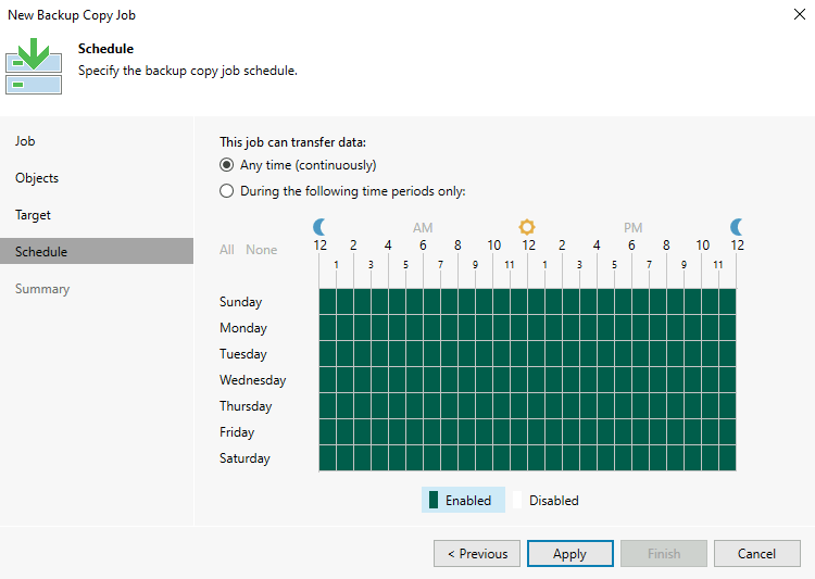

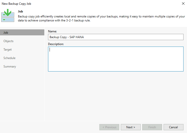

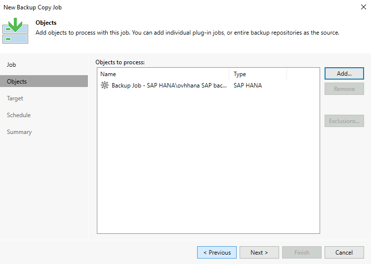

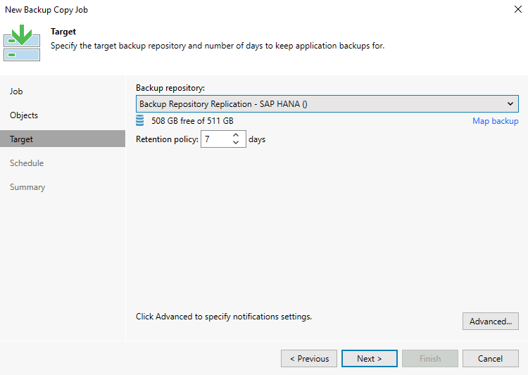

2.2.2 - Creation of the Backup Copy job (optional)
A Backup Copy job allows you to duplicate backups from one Backup Repository to another, ensuring the security of these backups on a separate storage location. This operation is useful for protecting critical data from loss or corruption by keeping a copy on a remote backup site. With this feature, you can configure advanced backup strategies to ensure the resilience and availability of your data in the event of a disaster.
Ports tcp/2500-3300 must be open between Backup Repositories.
Step 1
Step 2
Step 3
Step 4
Step 5
Step 6

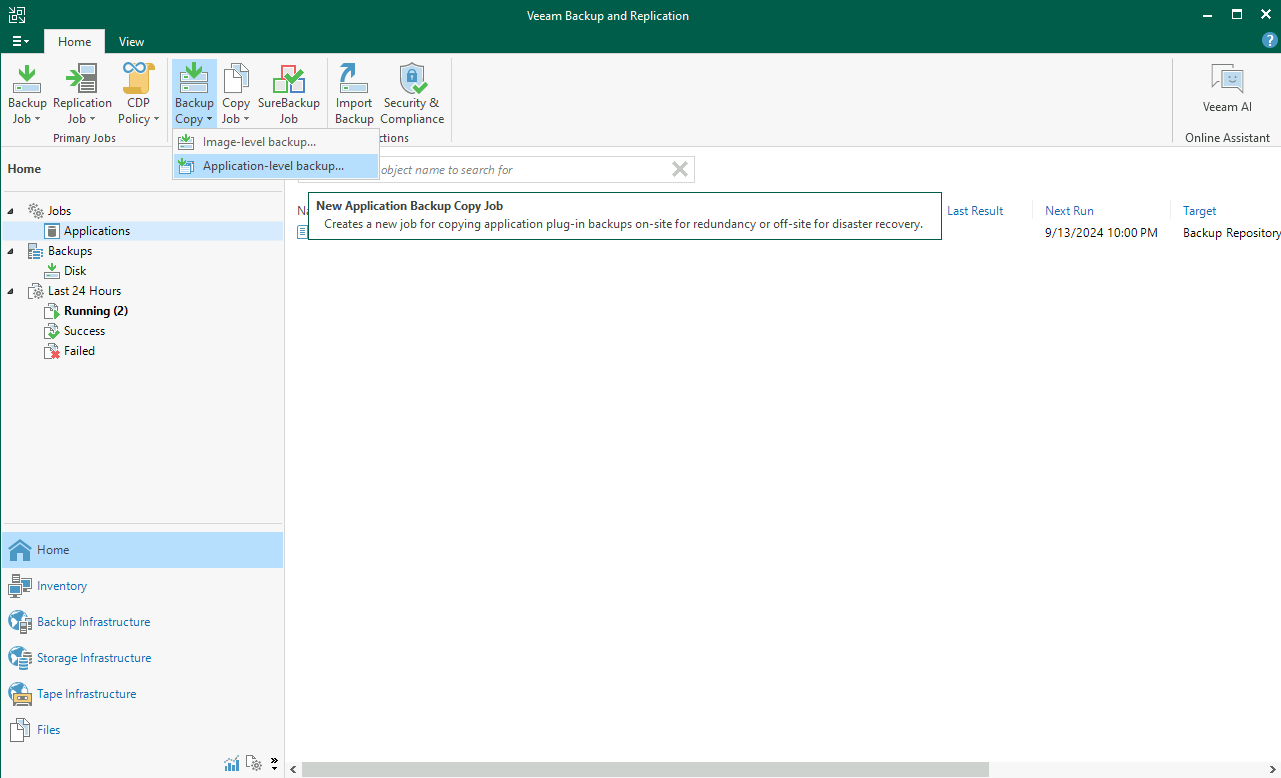

Open the Veeam Backup and Replication console, select the Home menu, Backup Copy, then Application-level backup....
backup_copy_1

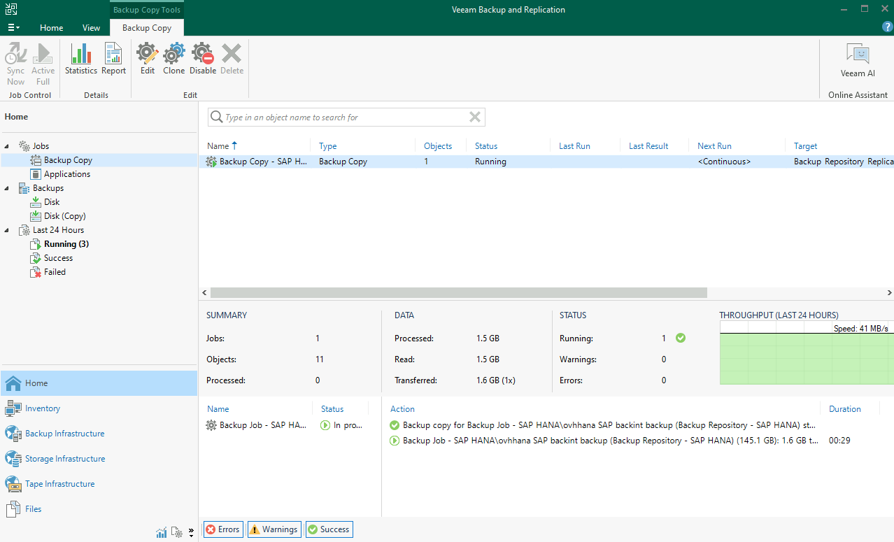

If you are in a SecNumCloud context and want to secure your backups on a second backup repository, configure a Backup Copy job.

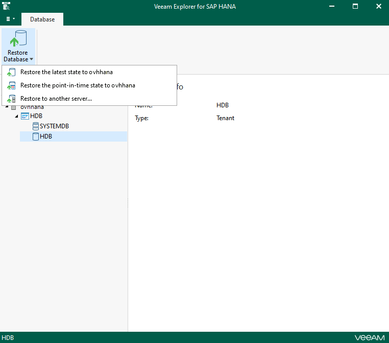

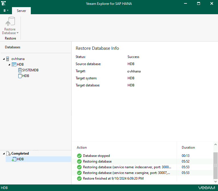

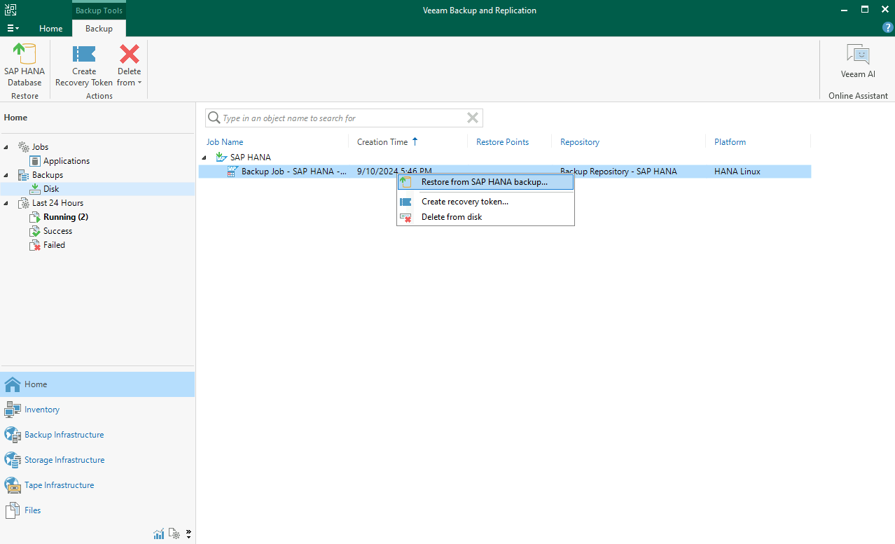

4 - Restoration
To restore your SAP HANA database from a backup taken with Veeam Backup and Replication, you can perform the following steps from the Veeam Backup and Replication console and Veeam Explorer for SAP HANA.
The following ports must be open between your Veeam Backup and Replication server and your SAP HANA database:
  • SAP Host Agent HTTP – tcp/1128
  • SOAP HTTP - tcp/5<NN>13
If you want to perform communication via the HTTPS protocol, the ports are:
  • SAP Host Agent HTTPS - tcp/1129
  • SOAP HTTPS - tcp/5<NN>14
Step 1
Step 2
Step 3
Open the Veeam Backup and Replication console, select Home, Backups, Disk, then click on Restore from SAP HANA backups... by right-clicking the backup of your SAP HANA database.
