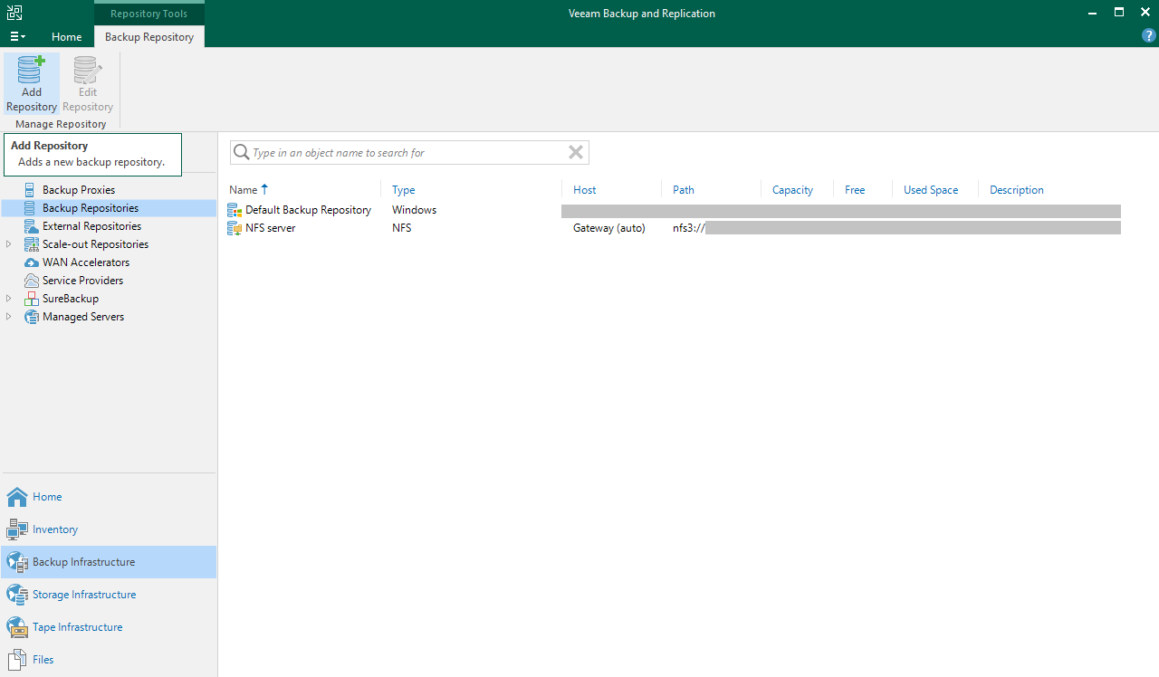

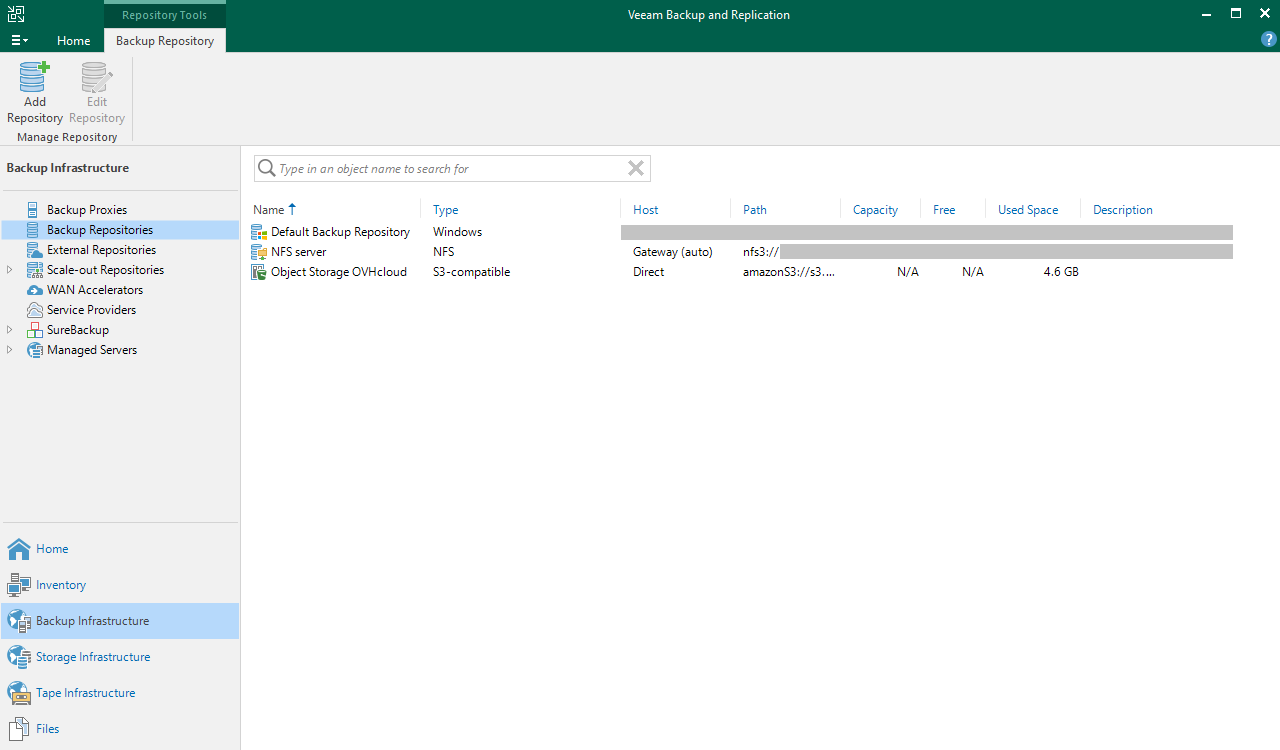

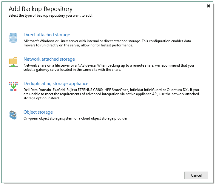

2 - Configuration of the Backup Repository
After installing Veeam Backup and Replication on your Windows server, you need to configure the Backup Repository.
A Backup Repository is a storage space where Veeam Backup and Replication hosts the backups.
At this stage, two scenarios can occur:
2.1 - Configuration of the Backup Repository for non-SecNumCloud needs
In this configuration, you can use a storage space, as well as an Object Storage to secure the backups in another OVHcloud region.
2.1.1 - Creation of the Backup Repository
Step 1
Step 2
Step 3
Step 4

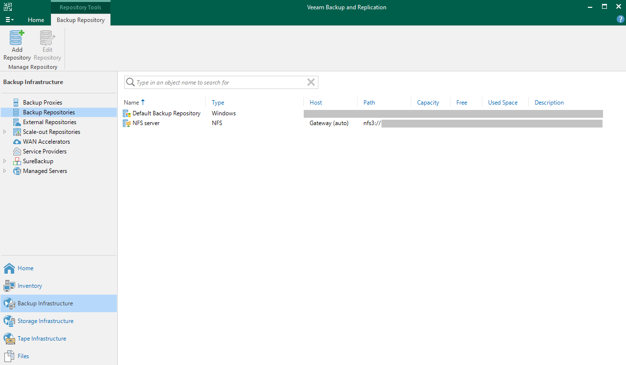

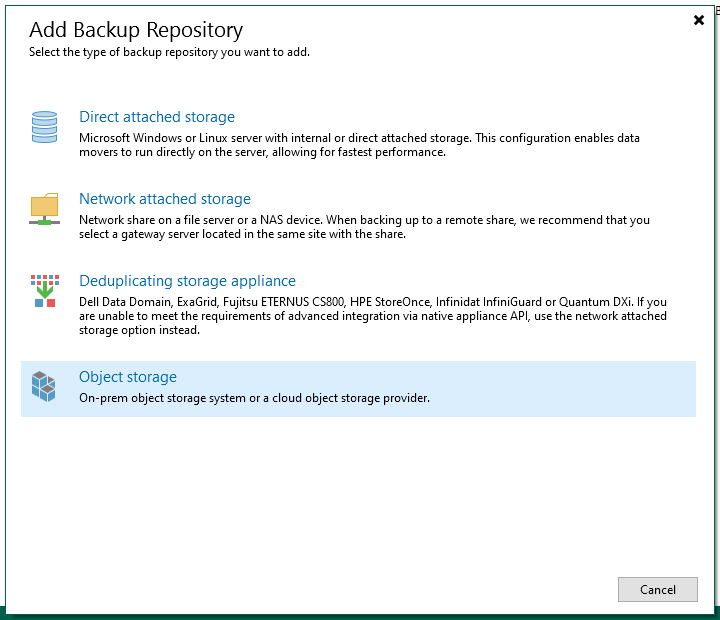

Open the Veeam Backup and Replication console, select Backup Infrastructure, then Backup Repositories.
Click on Add Repository to start the configuration assistant.
backup_repository_1

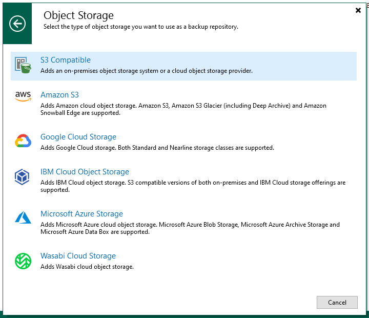

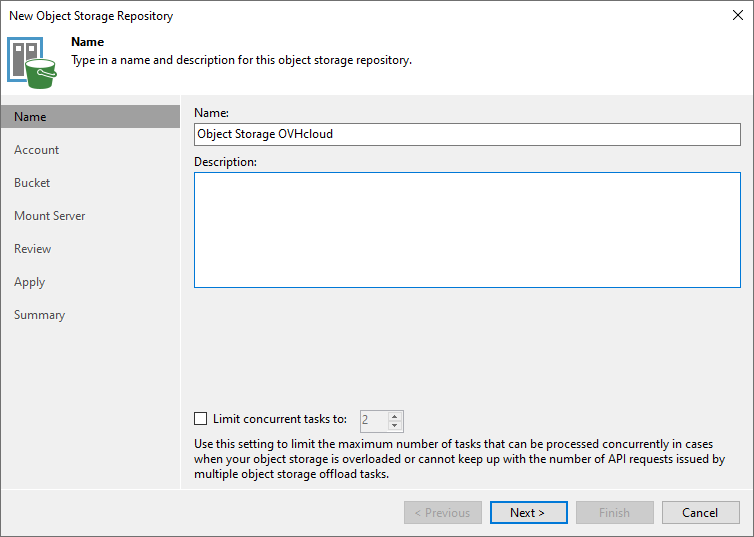

2.1.2 - Creation of Backup Repository Object Storage (optional)
This Backup Repository will be used to secure your backups on a secondary storage space, which can be hosted on a second OVHcloud region.
To discover the steps to create an Object Storage bucket, please refer to the detailed steps in our guide.
Step 1
Step 2
Step 3
Step 4
Step 5
Step 6
Step 7

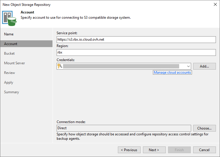

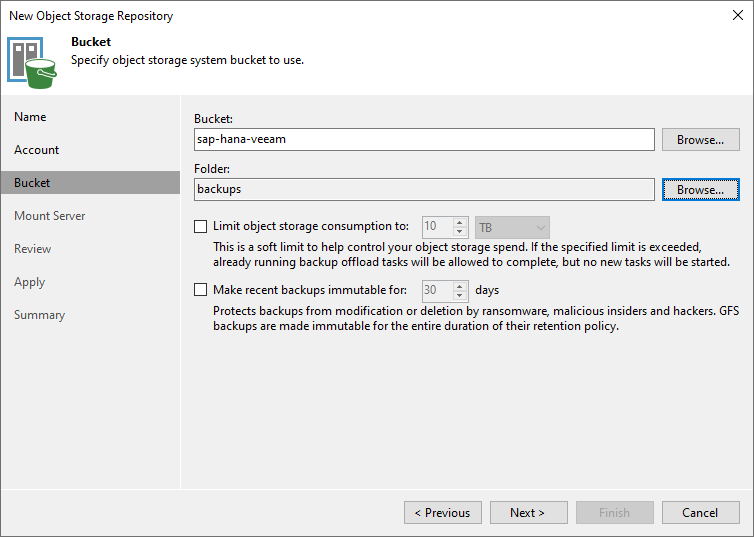

Click Add Repository to start the configuration assistant.
backup_repository_s3_1

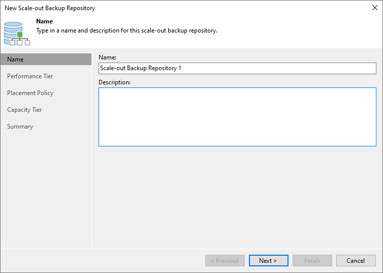

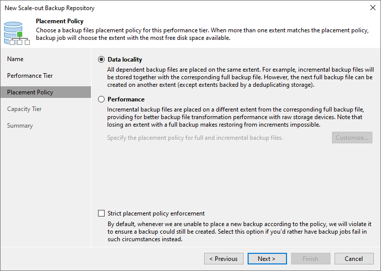

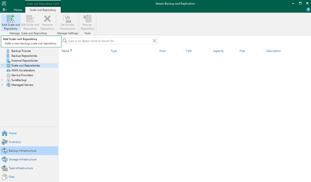

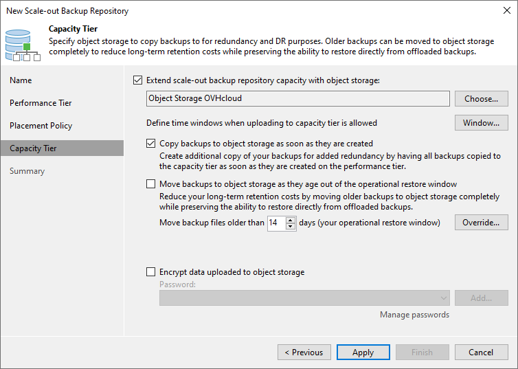

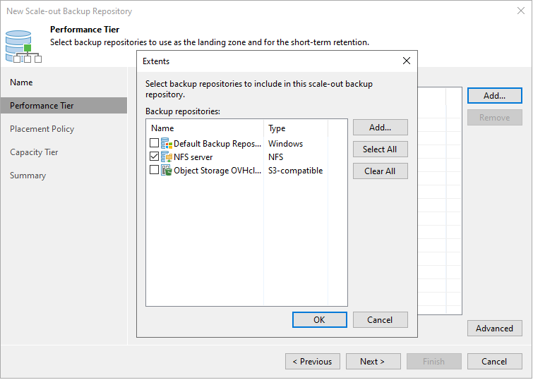

2.1.3 - Creation of Scale-out Backup Repository (optional)
Creating a Scale-out Backup Repository will secure your backups deposited in your first Backup Repository by copying them to your second Backup Repository without any action required from you.
Step 1
Step 2
Step 3
Step 4
Step 5
Step 6
Step 7
Step 8

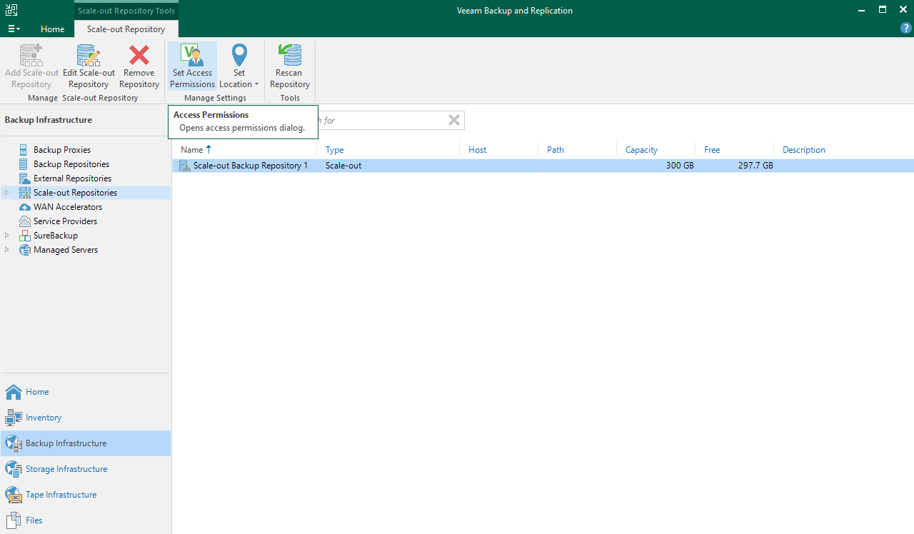

Open the Veeam Backup and Replication console, select Backup Infrastructure, then Scale-out Repositories.
Click Add Scale-out Repository to start the configuration assistant.
sbr_no_snc_1

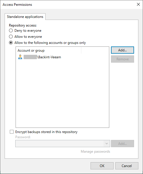

2.2.1 - Creation of a Backup Repository
Step 1
Step 2
Step 3
Step 4
backup_repository_1
For more information on configuring Backup Repositories, please refer to the Veeam Backup and Replication documentation.

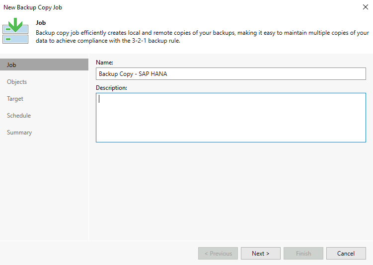

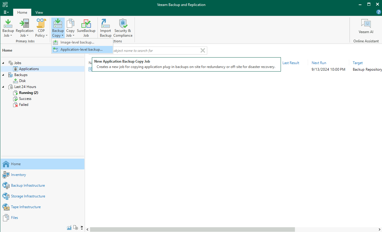

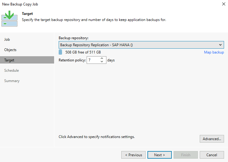

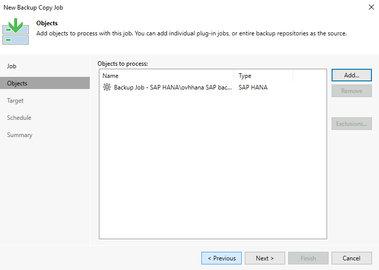

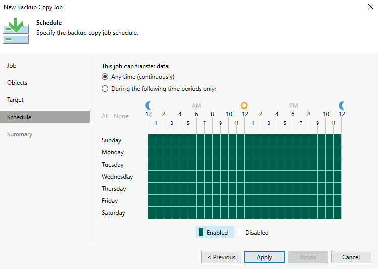

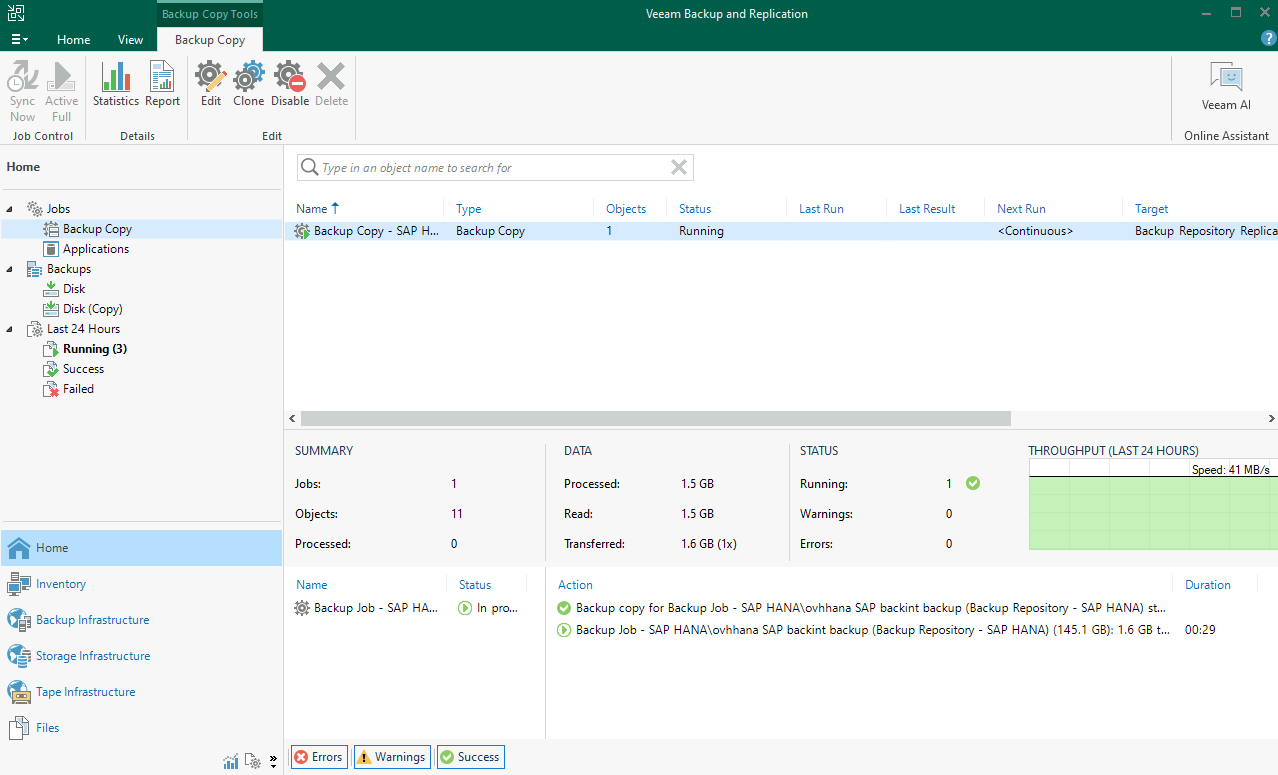

2.2.2 - Creation of the Backup Copy job (optional)
A Backup Copy job allows you to duplicate backups from one Backup Repository to another, ensuring the security of these backups on a separate storage location. This operation is useful for protecting critical data from loss or corruption by keeping a copy on a remote backup site. With this feature, you can configure advanced backup strategies to ensure the resilience and availability of your data in the event of a disaster.
Ports tcp/2500-3300 must be open between Backup Repositories.
Step 1
Step 2
Step 3
Step 4
Step 5
Step 6
Open the Veeam Backup and Replication console, select the Home menu, Backup Copy, then Application-level backup....
backup_copy_1

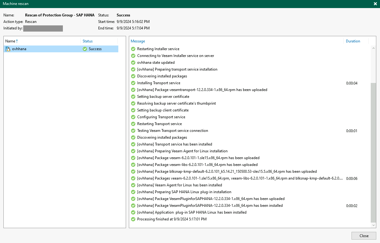

3 - Installation of Veeam Plug-in for SAP HANA
The installation of Veeam Plug-in for SAP HANA can be accomplished using one of the following two methods:
  • The "Standalone Mode" method involves a manual installation using the binary extracted from the Veeam Backup and Replication ISO on the server hosting the SAP HANA database. This method offers limited functionality through the Veeam Backup and Replication console.
  • The "Managed Mode" method is an automated installation performed via the Veeam Backup and Replication console, allowing for the use of several features such as scheduling a backup job.
For the purposes of this documentation, we will use the "Managed Mode" method in order to use all the features provided by Veeam.

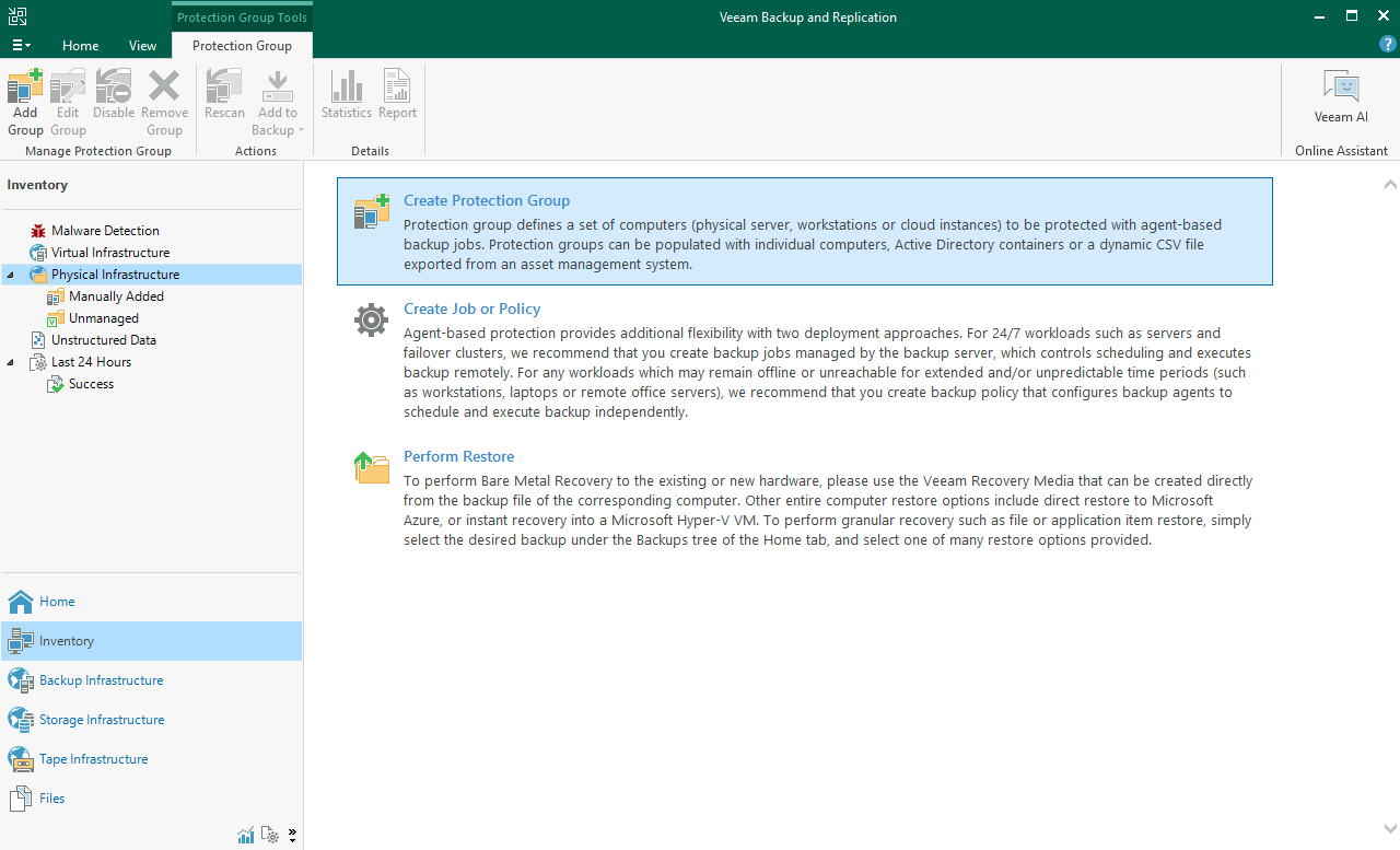

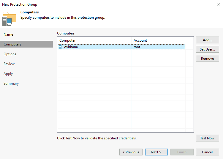

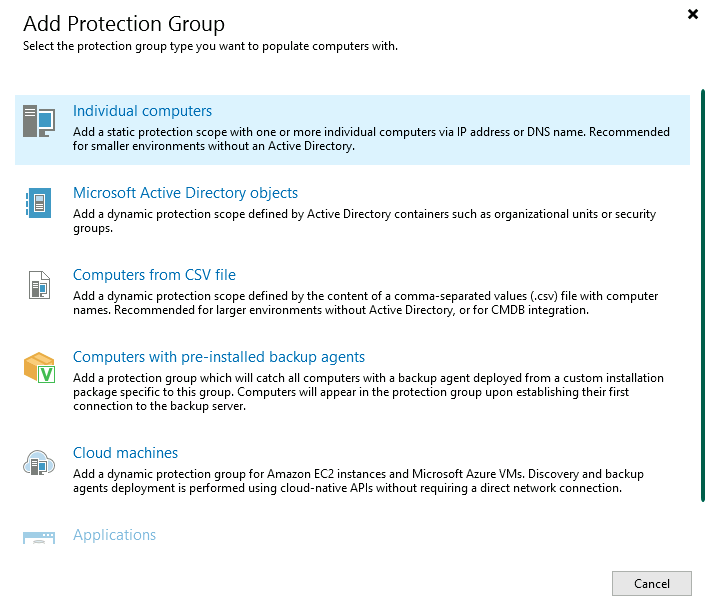

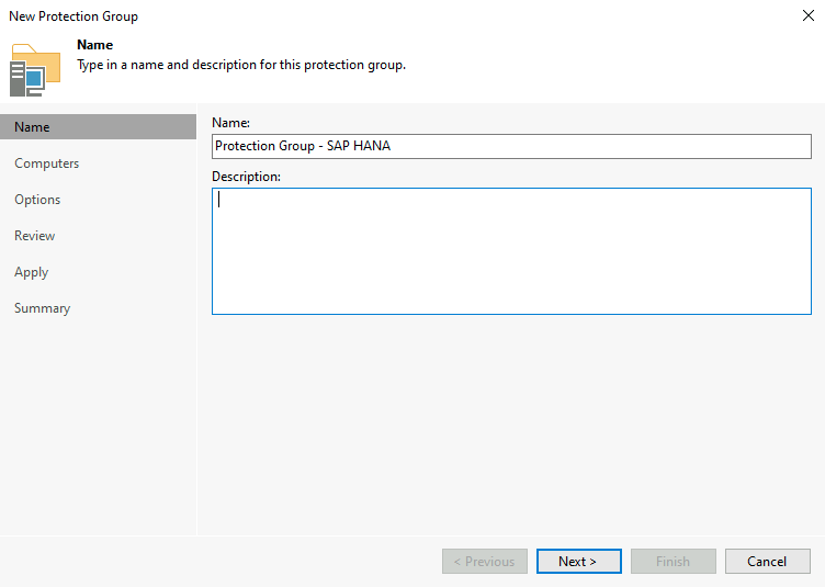

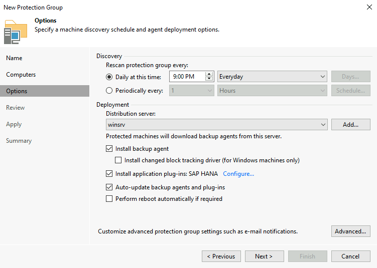

3.1 - Creation of a Protection Group
The creation of a protection group is a prerequisite for the installation of Veeam Plug-in for SAP HANA in Managed Mode.
Step 1
Step 2
Step 3
Step 4
Step 5
Step 6
Open the Veeam Backup and Replication console, select Inventory, then Physical Infrastructure.
Click on Create Protection Group.
pg_hana_1

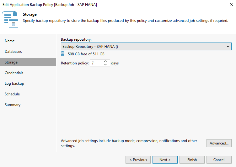

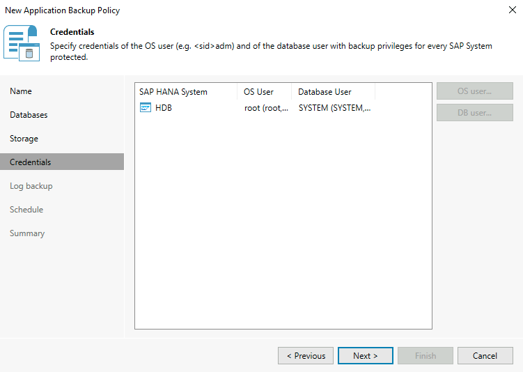

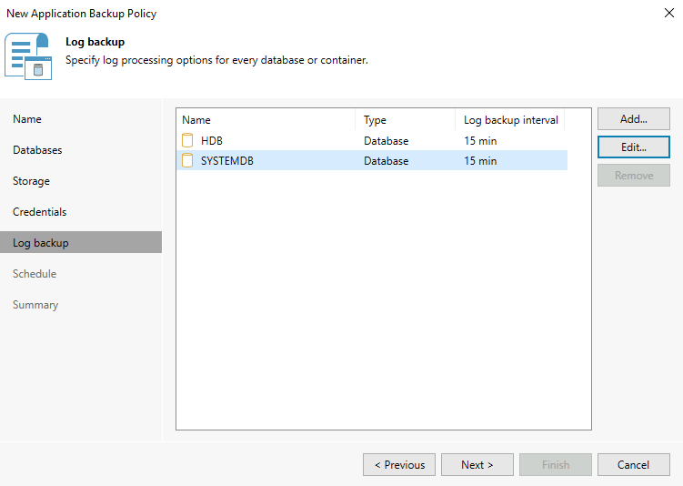

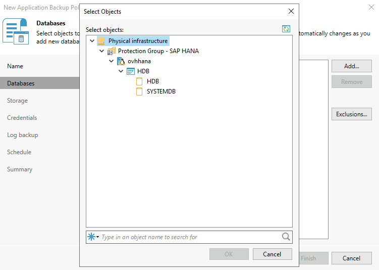

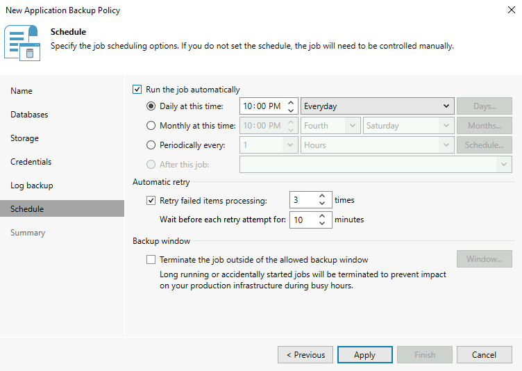

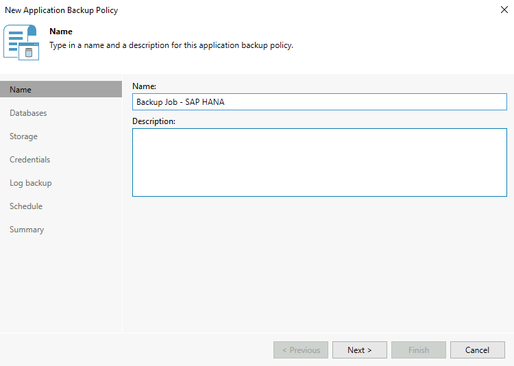

3.2 - Creating the backup job
Following the installation of Veeam Plug-in for SAP HANA in Managed mode, we are now able to create a backup job and manage its scheduling via the Veeam Backup and Replication console.
Step 1
Step 2
Step 3
Step 4
Step 5
Step 6
Step 7
Step 8
Step 9

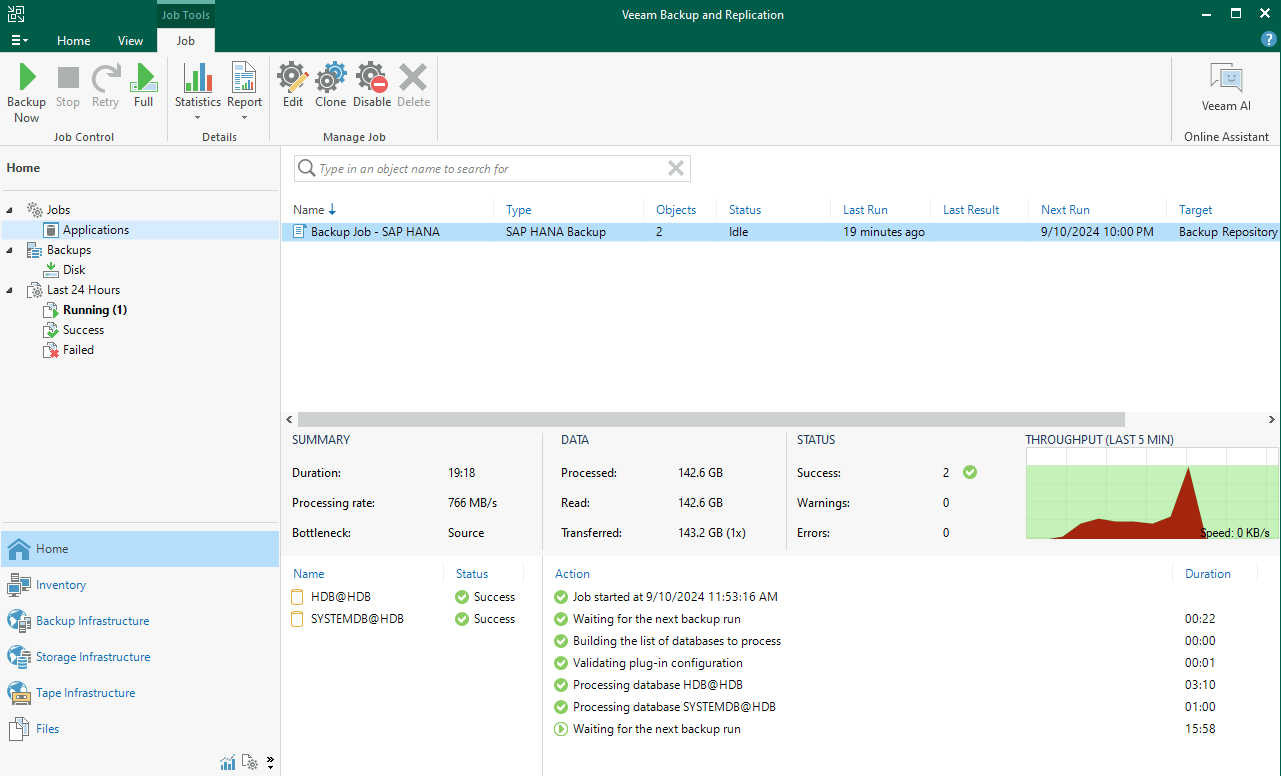

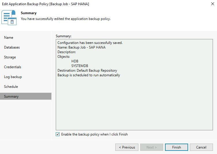

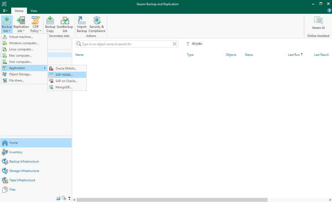

Open the Veeam Backup and Replication console, select the Home menu, Backup job, Application, then SAP HANA.
bj_hana_1
You can now run a backup of your SAP HANA database to ensure that your configuration works as desired.
To do this, simply go to the Home menu, select Jobs then Applications, then select your backup job and click on Full. This will launch a full backup of the SAP HANA databases configured in this backup job.
You can follow the progress of the backup job.
full_backup

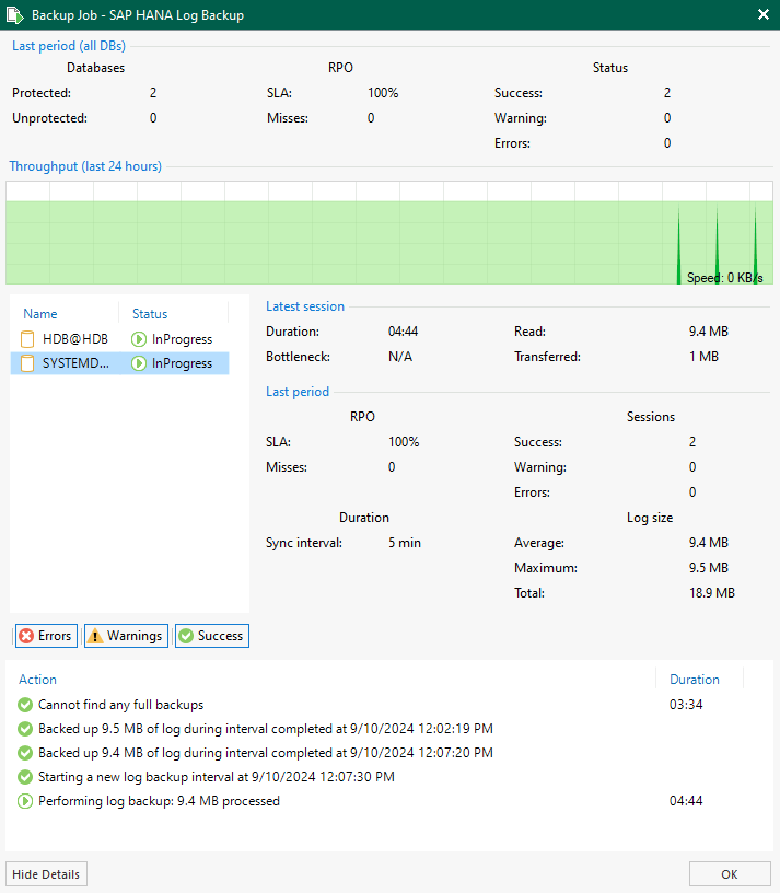

When performing log backups, you have the option to access detailed information.
log_backup

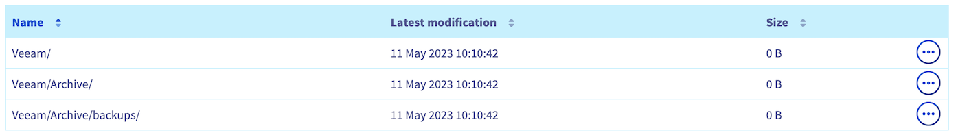

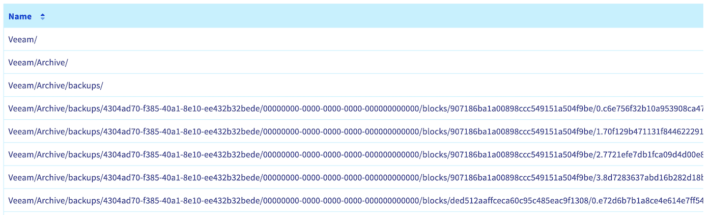

If you have configured a Scale-out Repository with an Object Storage bucket, you can observe your backups on your Object Storage bucket.
sbr_s3

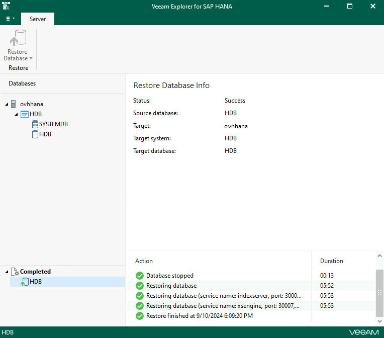

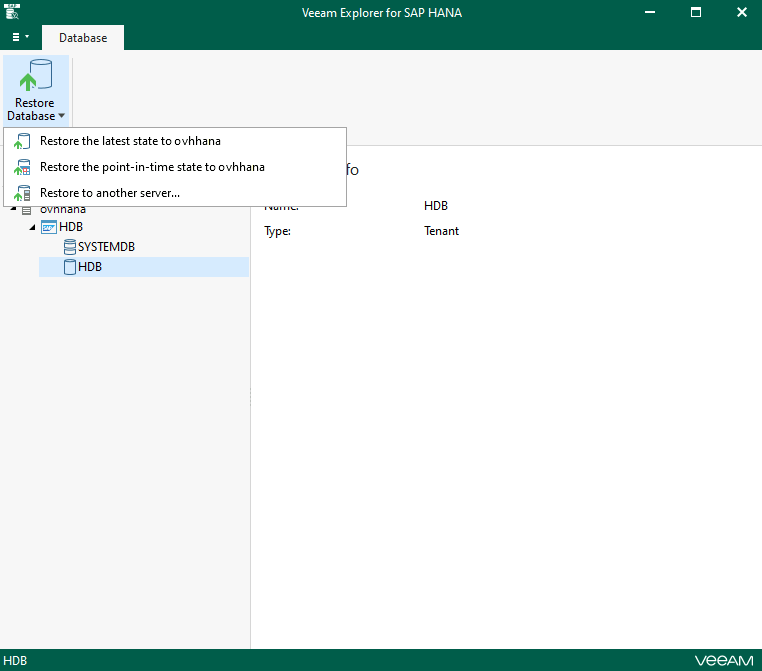

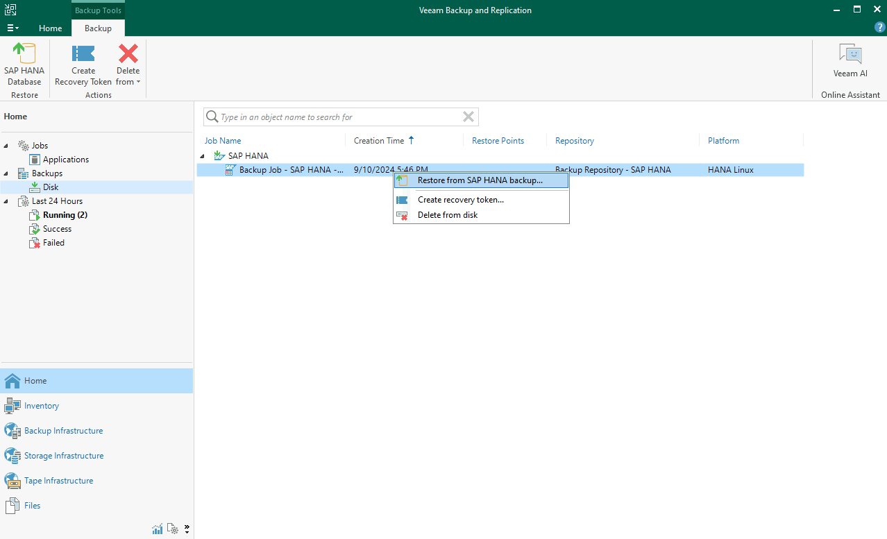

4 - Restoration
To restore your SAP HANA database from a backup taken with Veeam Backup and Replication, you can perform the following steps from the Veeam Backup and Replication console and Veeam Explorer for SAP HANA.
The following ports must be open between your Veeam Backup and Replication server and your SAP HANA database:
  • SAP Host Agent HTTP – tcp/1128
  • SOAP HTTP - tcp/5<NN>13
If you want to perform communication via the HTTPS protocol, the ports are:
  • SAP Host Agent HTTPS - tcp/1129
  • SOAP HTTPS - tcp/5<NN>14
Step 1
Step 2
Step 3
Open the Veeam Backup and Replication console, select Home, Backups, Disk, then click on Restore from SAP HANA backups... by right-clicking the backup of your SAP HANA database.
