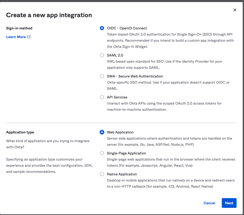

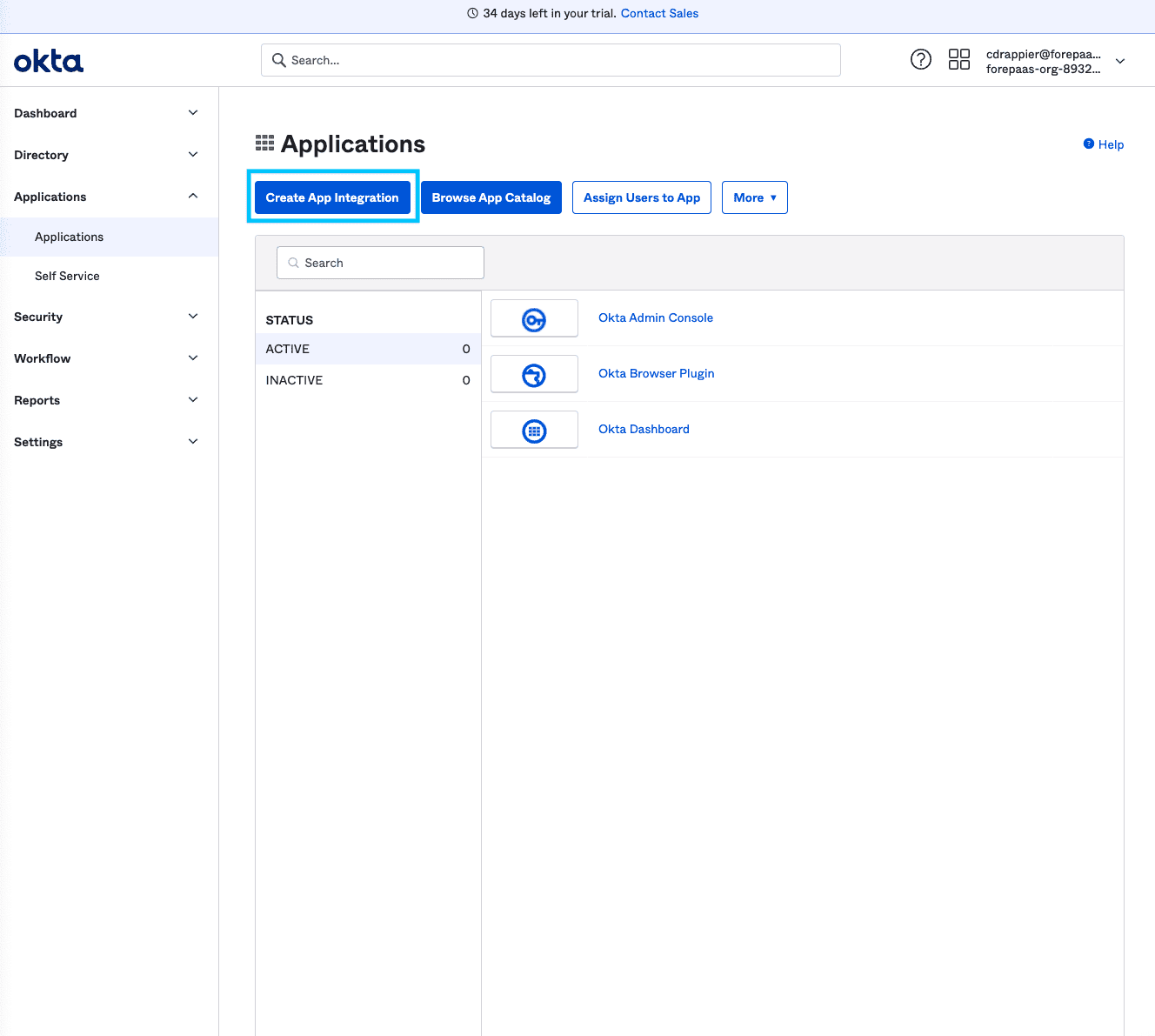

In the sidebar, select Applications. Then click on Create App Integration.
App registration
Select OIDC (OpenID Connect) as the method and Web Application as the application type.
App registration
Press Next.

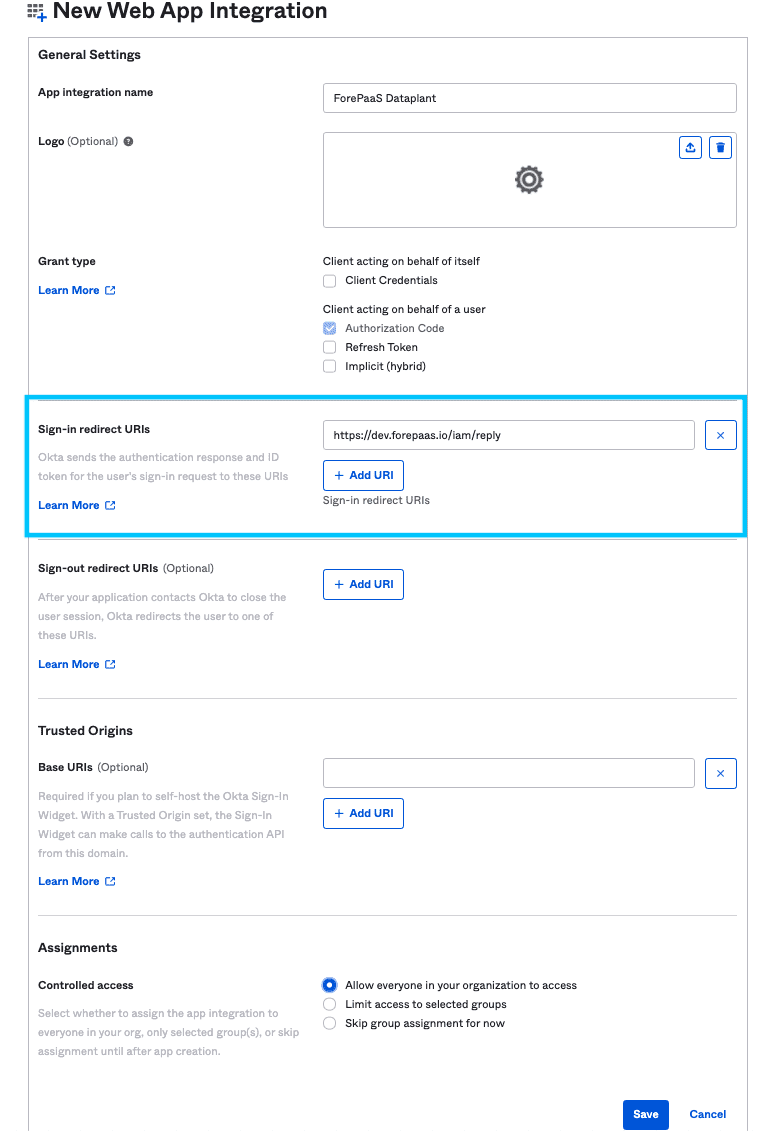

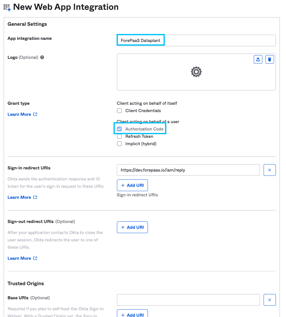

Give the name of your choice to this new application and make sure that the Grant Type is Authorization Code.
App registration
Scroll down to the Sign-in Redirect URIs section.
App registration
In the URL field, copy and paste the Reply URL field in the new authentication provider you added on Data Platform (it is the same for the entire Data Platform IAM).
App registration
Save the new application integration.

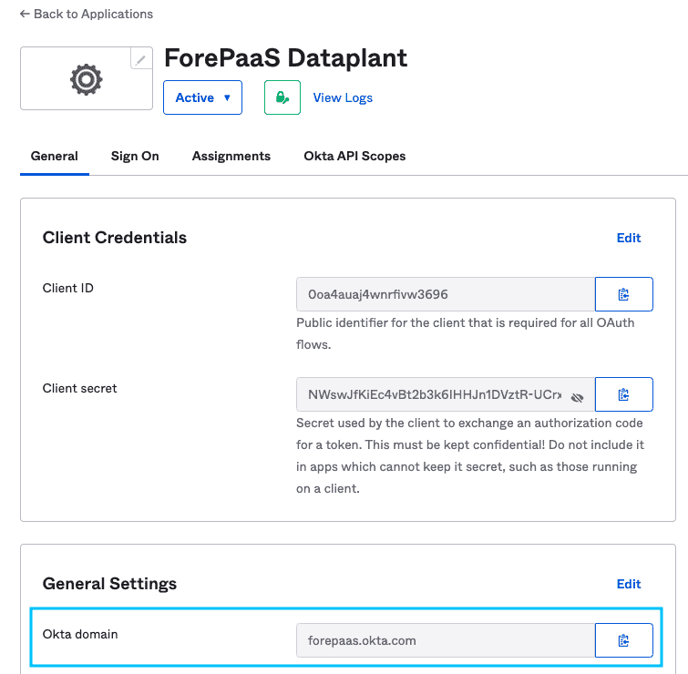

Step 2. Retrieve the Domain

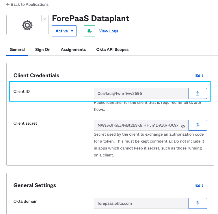

The Domain is the equivalent of your tenant id on Okta. You can find it in the General Settings of the application: look for the Okta domain section.
App registration
Note that this Domain will be required later on during the IAM configuration.
Step 3. Retrieve the Client ID
The Client ID is specific to your application. You can find it in the Client Credentials of the application: look for the Client ID section.
App registration
Note that this Client ID will be required later on during the IAM configuration.

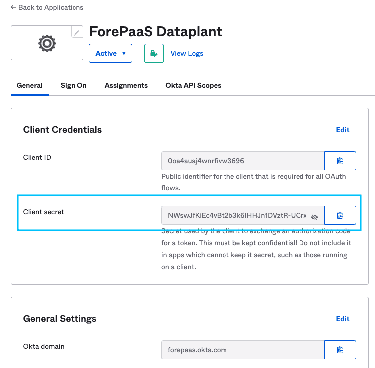

Step 4. Retrieve the Client Secret
The Client Secret is specific to your application. You can find it in the Client Credentials of the application: look for the Client secret section.
App registration
Note that this Client Secret will be required later on during the IAM configuration.
Summary
If you have properly followed all the previous steps, you should have this list of information.
Okta domain (Step 2): xxxxxxxxxx.okta.com
Client ID (Step 3): XXXXXXXXXXXXXXXXXXXXXXXXXXXXXXXX
Client secret (Step 4): XXXXXXXXXXXXXXXXXXXXXXXXXXXXXXXX

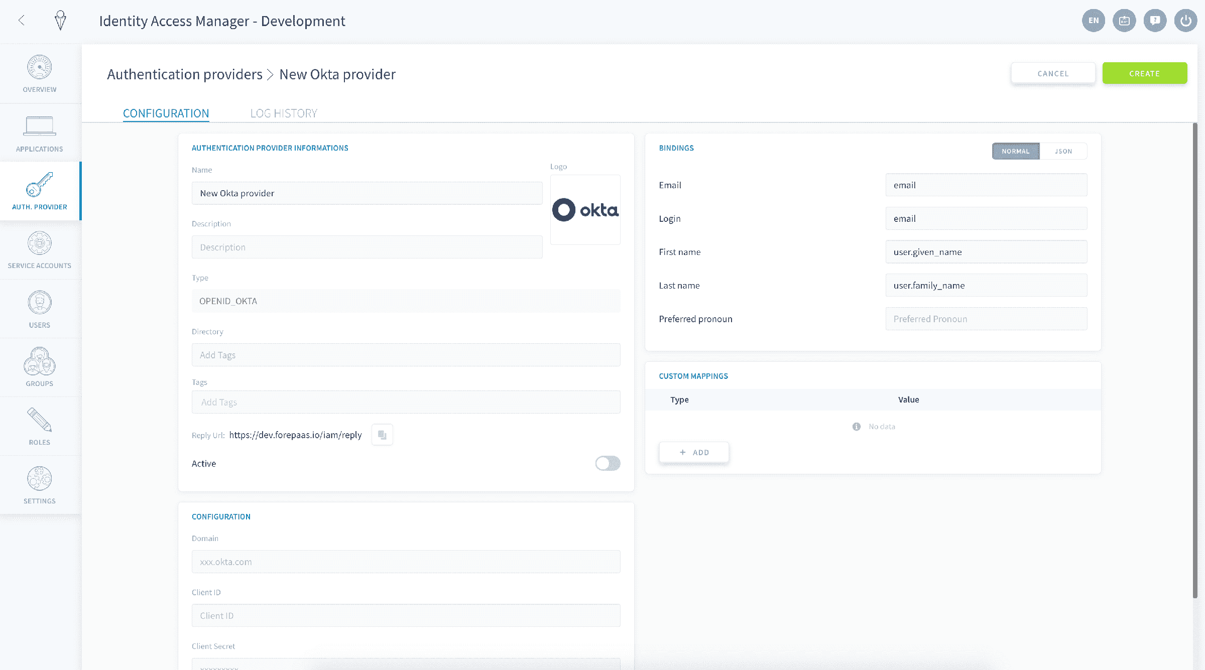

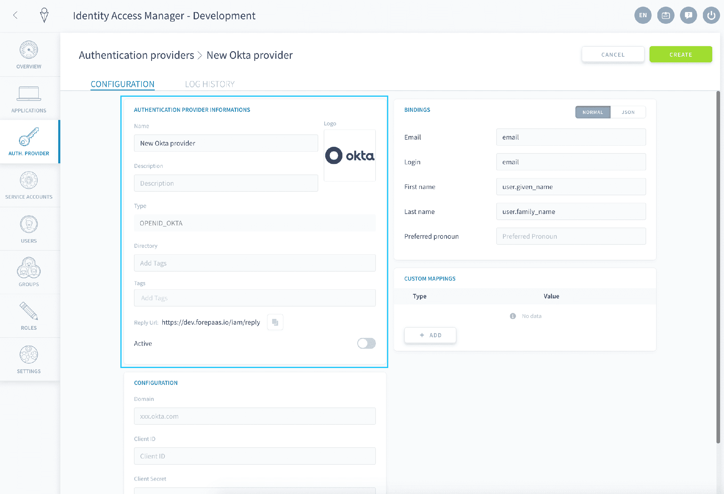

Fill in the basic information

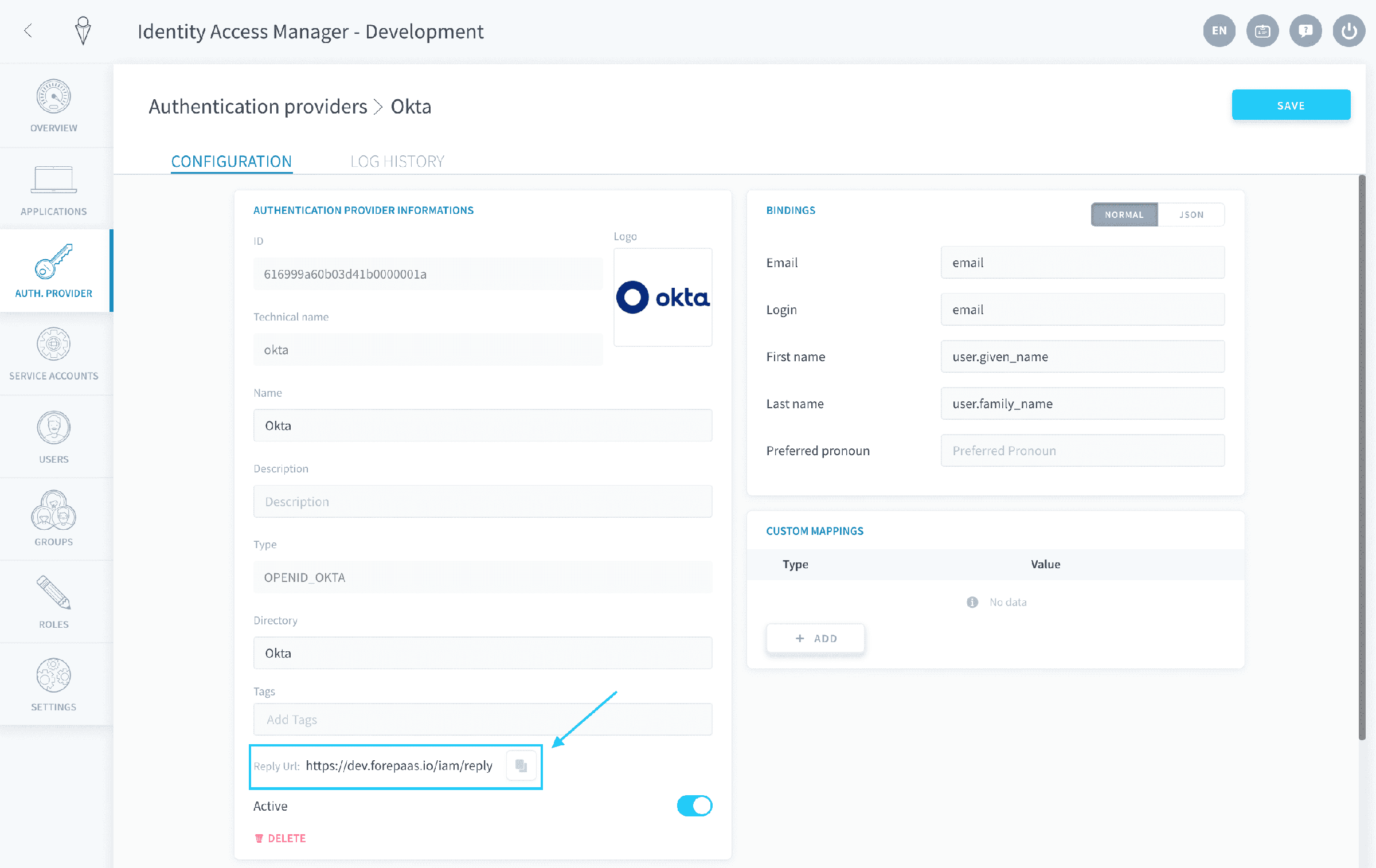

  • Name / Description: This is the internal name and description for your new authentication method
  • Directory: This is a unified tag for all accounts that will be created from this directory. For example, you can input Okta
  • Tags: This offers more tagging options. They are completely optional
  • Reply URL: This is the Data Platform URL where your authentication provider redirects to
  • Active: This specifies whether this authentication provider can be used to login or not
Fill in the basic information — Okta config1

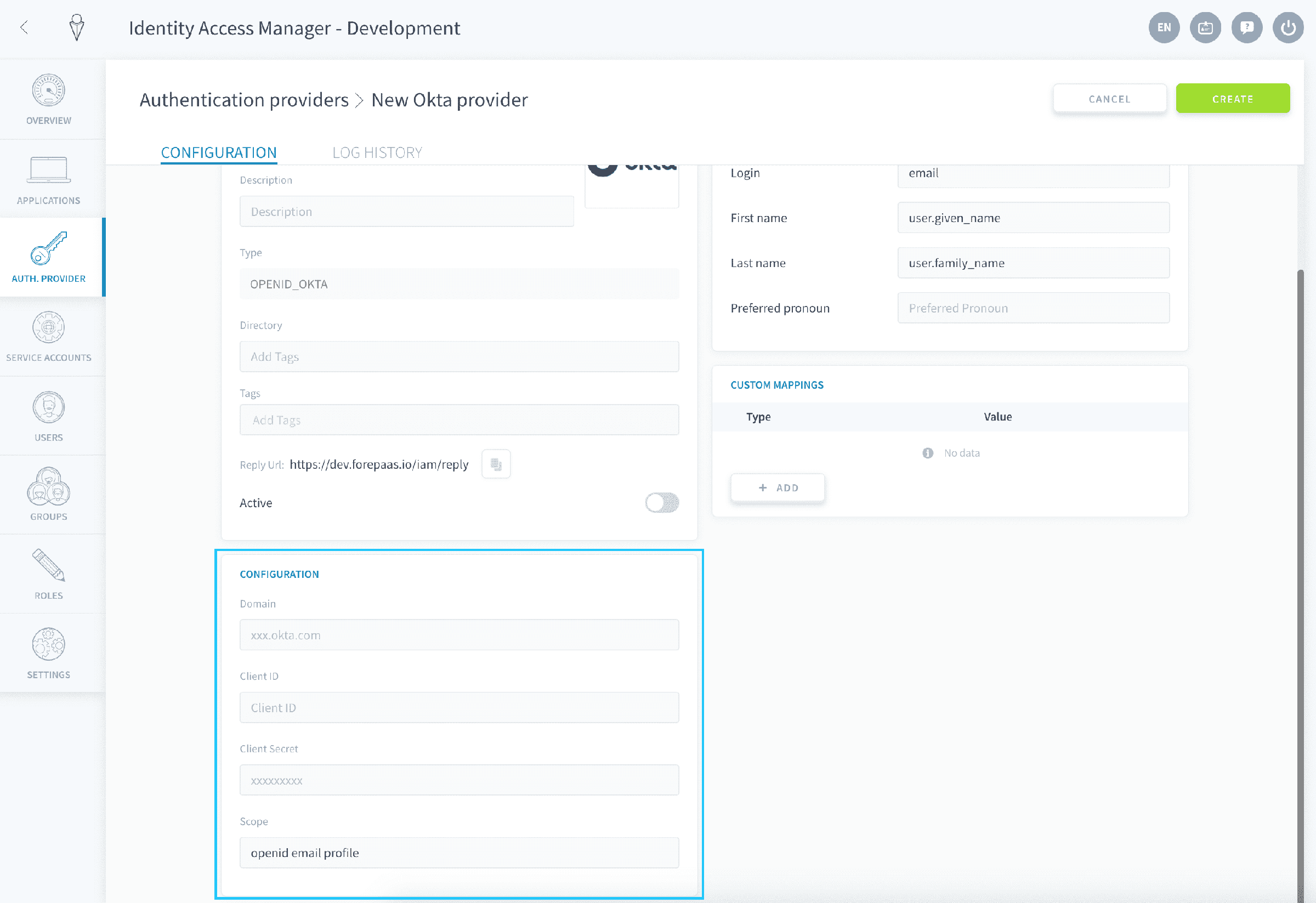

Fill in Okta configuration
Now locate the Okta Configuration panel.
Fill in Okta configuration — Okta config2
Fill in the information collected on Okta in the previous section, as such:
  • Domain: Okta domain (retrieved in step 2 of the configuration on Okta)
  • Client ID: Client ID (retrieved in step 3 of the configuration on Okta)
  • Client Secret: Client secret (retrieved in step 4 of the configuration on Okta)
  • Scope: This represents how much information Data Platform will be able to access from your Okta. This field is optional: the default value is openid email profile

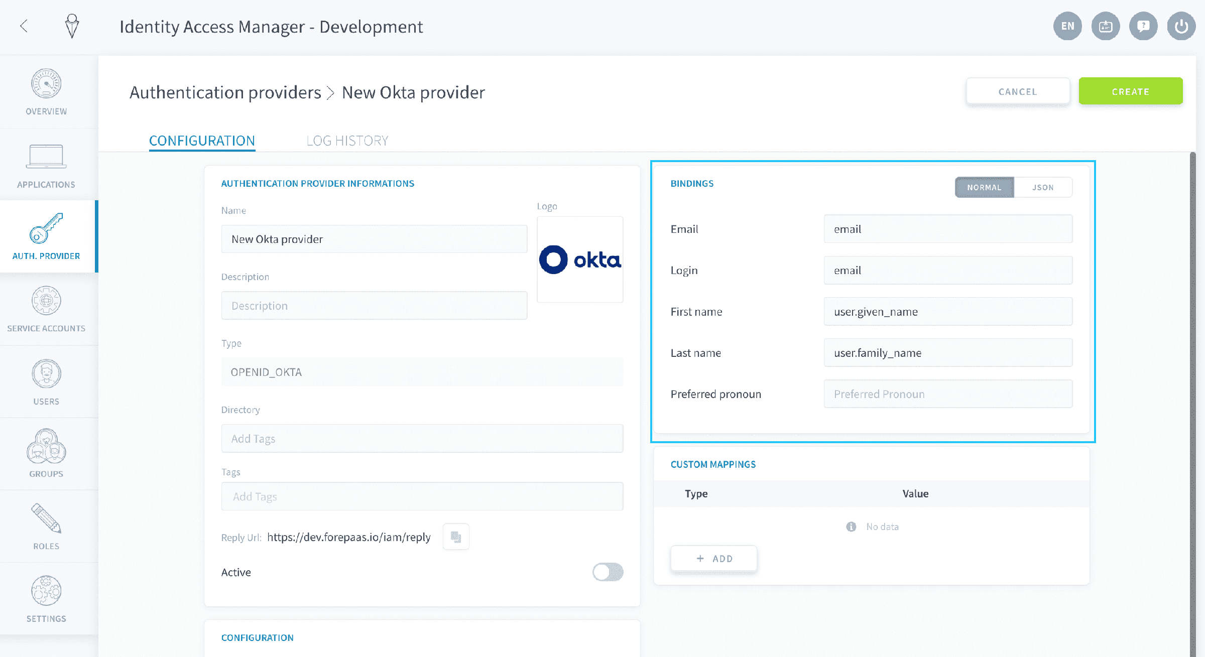

Fill in the bindings rules
The Bindings panel allows you to customize the mapping of the fields between Okta and Data Platform.
Email, login, first and last name are mapped by default.
Fill in the bindings rules — Okta bindings

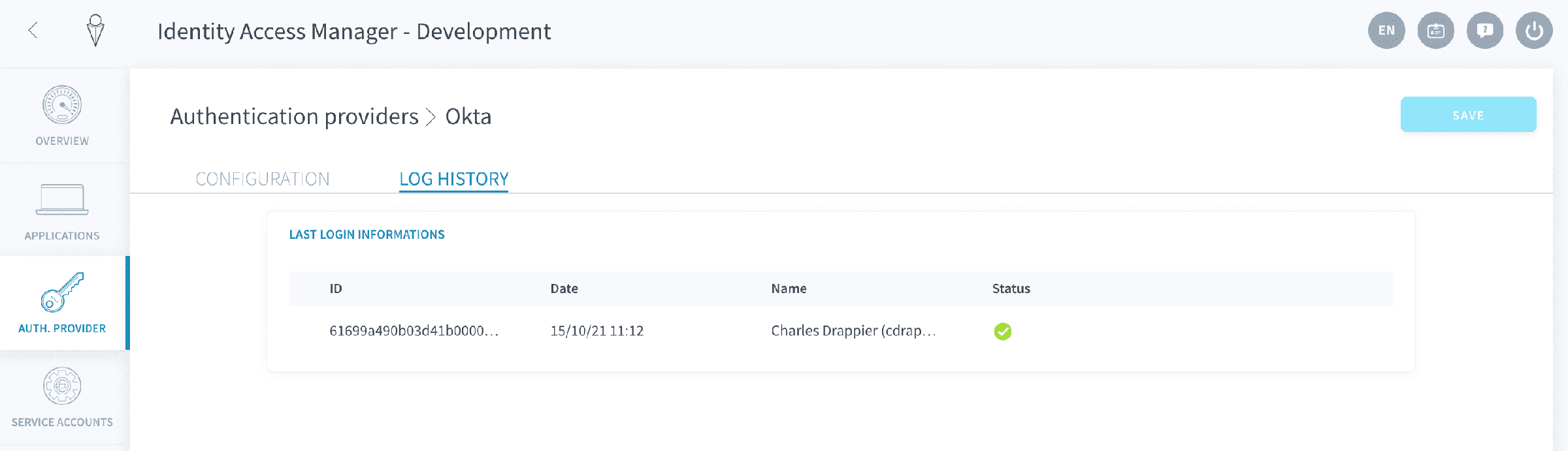

The easiest way to configure bindings is to retrieve a response from a login of an user by following these steps:
1 - Do a sample login to any Data Platform application using your newly configured Okta authentication provider.
2 - Open the Log History page of the IAM authentication provider (here Okta).
Fill in the bindings rules — Okta logs
3 - Open the latest log: the original response from Okta will look like this:

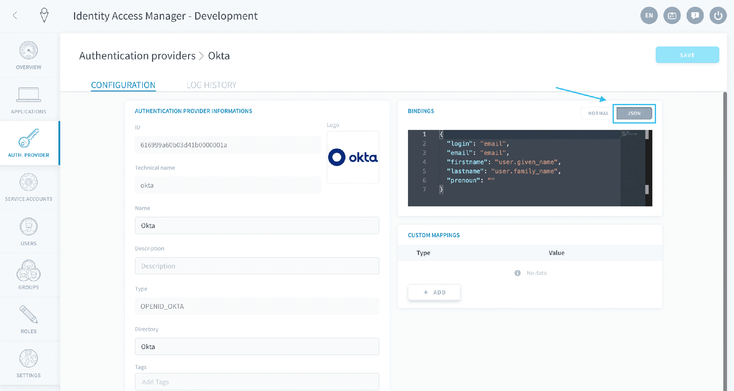

4 - On top of the default email, login, first and last name, any additional property from Okta can be saved as a custom configuration.XXX field on Data Platform by using the "JSON" mode.
Fill in the bindings rules — Okta bindings2
For example, you can add a fullname property on Data Platform from the name field from Okta:
  "login": "email",
  "email": "email",
  "pronoun": "",
  "firstname": "user.given_name",
  "lastname": "user.family_name",
  "configuration.fullname": "name"
Test the result of your bindings by checking the logs of further test connections in Log History: the Computed Result section of each login will show what properties have been saved in Data Platform.

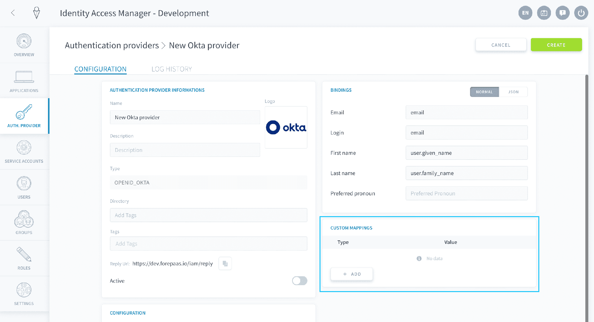

Custom mappings
The Custom mappings panel allows you to automatically assign all users logged in through this authentication provider to a role or a group.
Custom mappings — Okta custom mapping
Learn how to set up custom mappings.

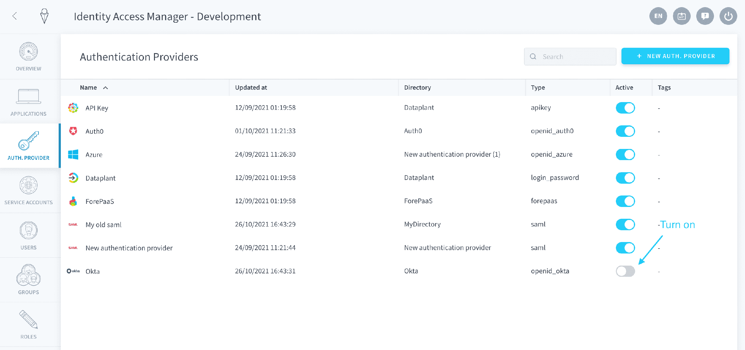

Set live

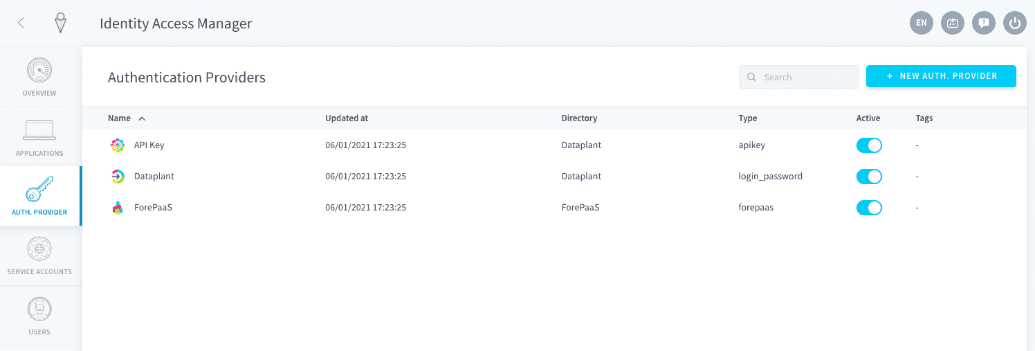

You are all set configuring your Okta connector! If you haven't done it already, click on Create - else make sure to Save.
In the Authentication Providers list, you now see your new method. Make sure you set it as active.
Set live — Auth active okta
