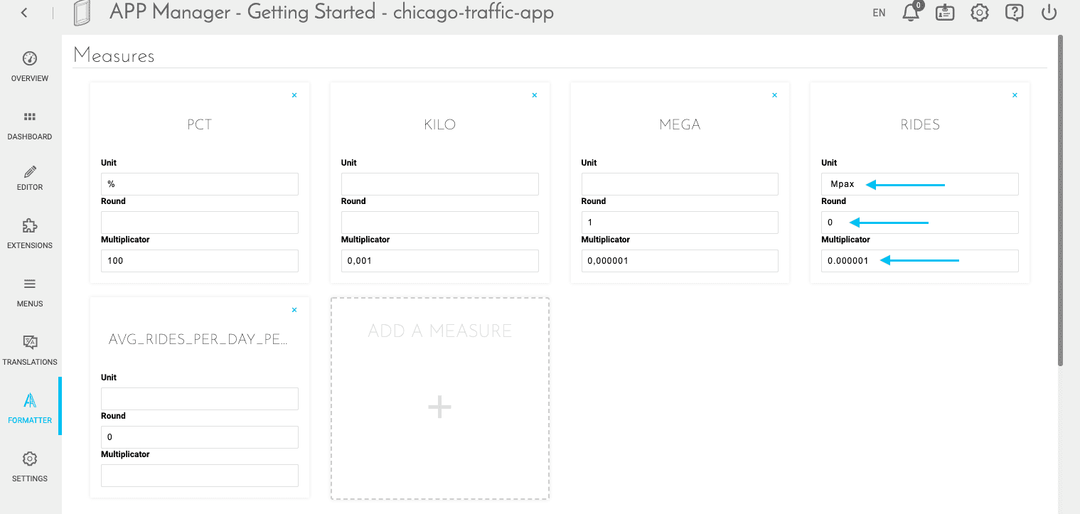

Your ride counts run into the millions, and a chart that prints 25833640 is hard to read. A number format fixes that once for the whole application.
Click Formats in the toolbar. The Number and date formats dialog lists the formats the application already has, such as percentages and shortened numbers.
Under Measures, enter Rides in the name field and click Add. Then fill in the new entry:
FieldValueEffect
UnitMpaxAppended after the number: millions of passengers
Multiplier0.000001Turns a number of rides into millions
Decimals2Rounds to 2 decimals
Leave Shorten above and Suffixes empty. Next to the name of the entry, a preview shows a sample value in this format, 1.23Mpax: check it before you save.
The Rides entry in the Number and date formats dialog: Mpax, 0.000001, 2 decimals
Click Save, then Close.
The formats are saved in the sources of the version, in config/formatter.json, and are shared by every chart of the application. They travel with the version when you copy it in Step 5.

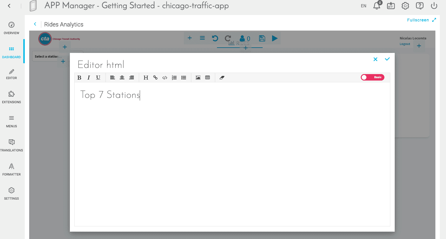

Step 3: Adding a heading

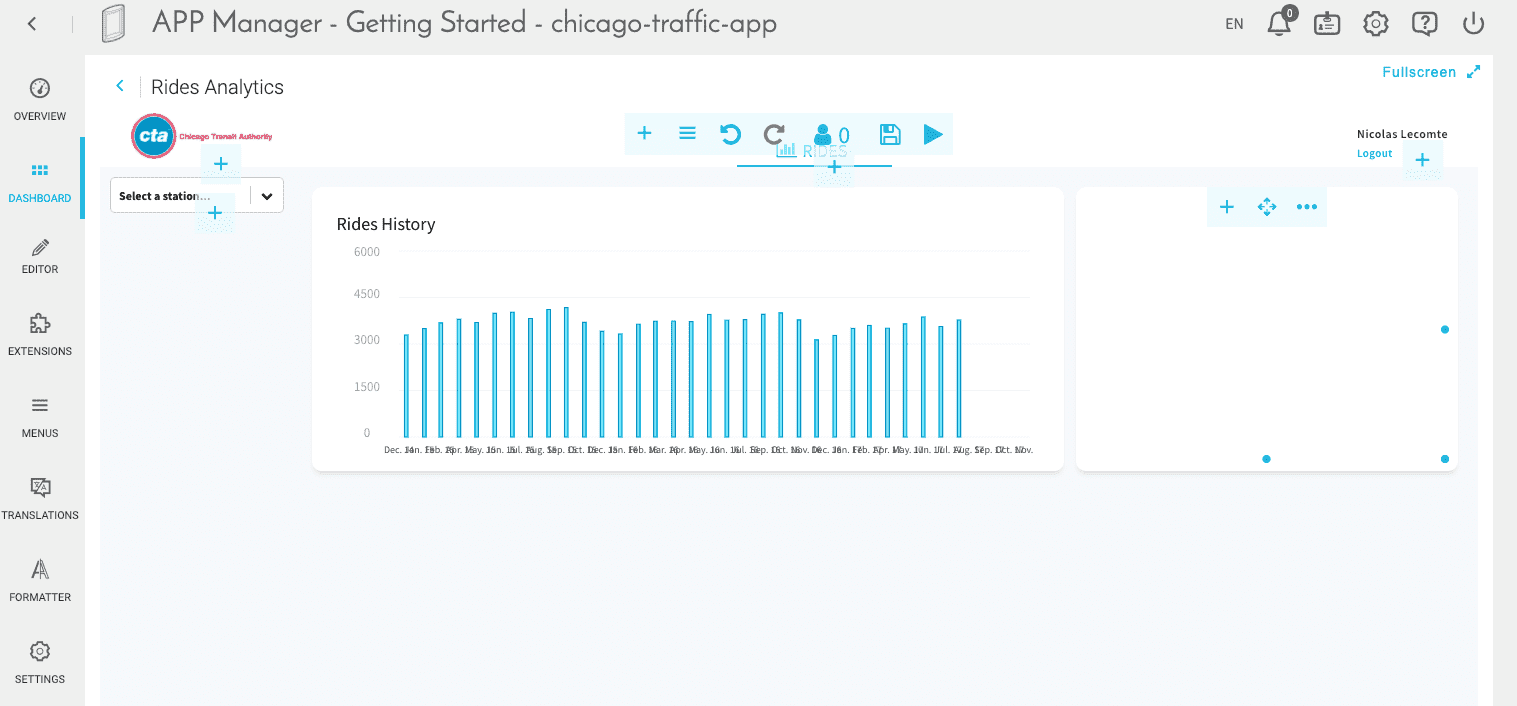

Point at the empty container below Filters and click its + Add button, then select Basic > HTML.
The HTML options panel opens on the right. In HTML, enter:
<h1 class='text-xl'>Top 7 Stations</h1>
The Top 7 Stations heading in the container, with the HTML options panel open
The content of an HTML block is injected as it is. Anyone who can edit the dashboard can run a script in the session of every reader, so only give edit access to people you trust.
The + Add button of the container only shows while your pointer is over the container.

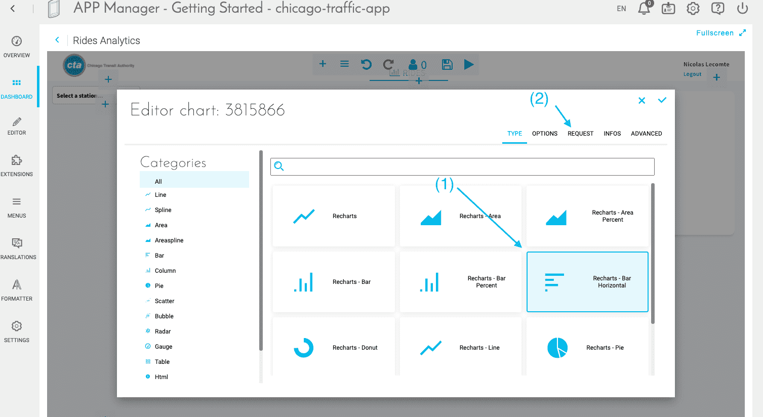

Click + Add in the same container again and select Charts > Bar horizontal.
In the General tab, name the chart Top 7 stations.

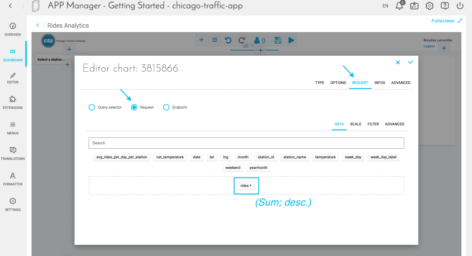

Open the Data tab. Leave Data source on Query builder, then describe the ranking:
  • Under Measures, click + Add and select rides with the sum aggregation.
  • Under Group by, click + Add and select station_name.
  • Under Order by, click + a criterion and select rides, descending.
  • In Row limit, enter 7, to keep only the 7 busiest stations.

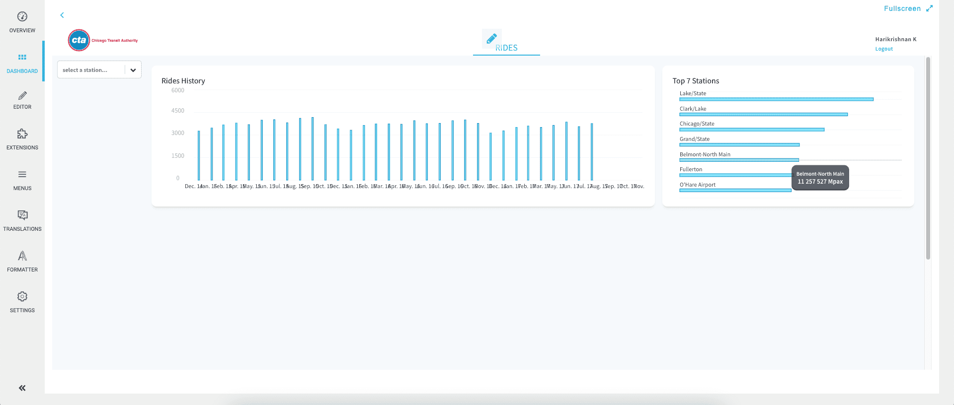

Open the Format tab. It lists the fields of the chart. On the rides row, select the Rides format you declared in Step 2: the preview reads 1.23Mpax. The axis and the tooltips of the chart now use it.
The chart's Format tab, with the Rides format selected for the rides field

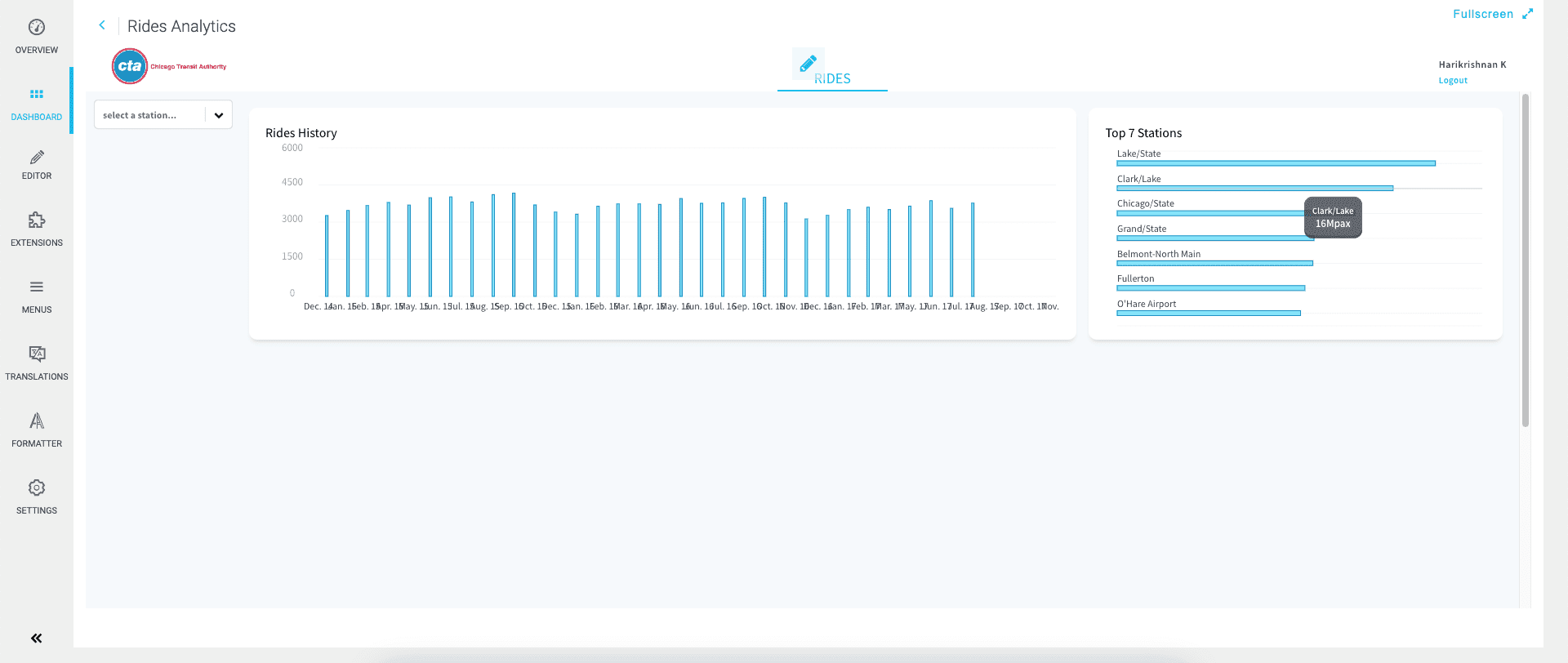

Click Apply. The chart queries your data through your API and draws the 7 busiest stations, with an axis in Mpax.
The Top 7 stations bar chart under the heading, with its axis in Mpax

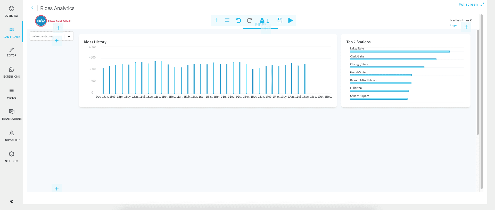

Click Save in the toolbar. The counter next to it goes back to no changes.
The saved dashboard with its heading and chart, the toolbar counter showing no changes

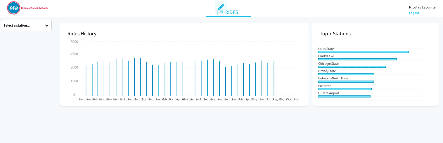

Once v3 is running, open your application and sign in with Data Platform. Home now shows the Top 7 Stations heading and the ranked chart, with its figures in millions of passengers.
What you have built
Your application has a number format shared by all its charts, and a ranked chart on its Home page, deployed as version v3 without interrupting your users. You can reuse the same format in every chart that displays rides.
