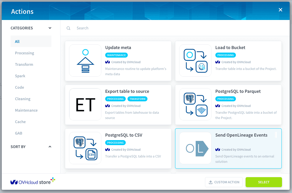

  1. Navigate to the Actions tab in the Data Processing Engine.
  2. Click New action.
  3. Select Send OpenLineage Events from the action store.
This action requires no additional configuration. It automatically reads the endpoint and authentication token from your OpenLineage Consumer settings and uses them to forward events.
