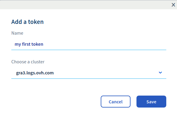

Legacy tokens
Existing legacy tokens still work for services without IAM, but new ones can no longer be created. They are not available to IAM-enabled users. We strongly encourage you to migrate to IAM now and use the more flexible tokens described above.

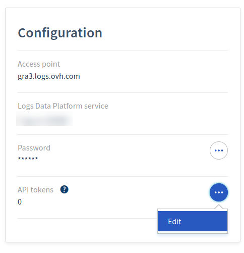

Once you have logged into Logs Data Platform, your existing legacy tokens are listed under API tokens in the Configuration panel.
Token Menu
On this page you can still revoke a token. Note that you cannot modify a token.
