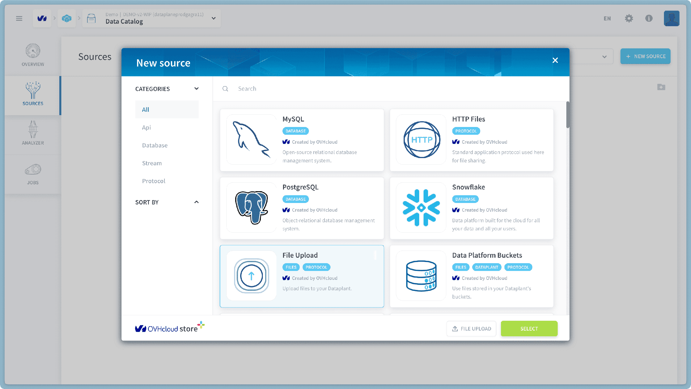

Step 1: Create a new source in Connectors

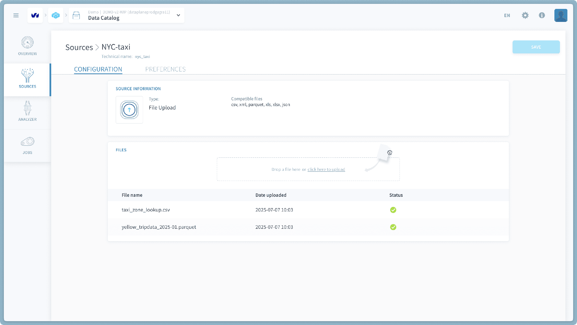

  • Create a new File Upload source and name it "NYC-taxi". Step 1: Create a new source in Connectors — Nyc taxi step
  • Upload the yellow_tripdata_YEAR_MONTH.parquet and taxi_zone_lookup.csv files, then click create. Step 1: Create a new source in Connectors — Nyc taxi step (2)

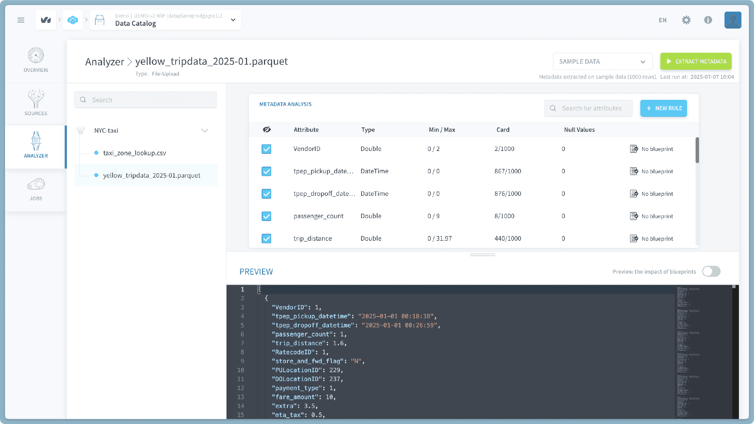

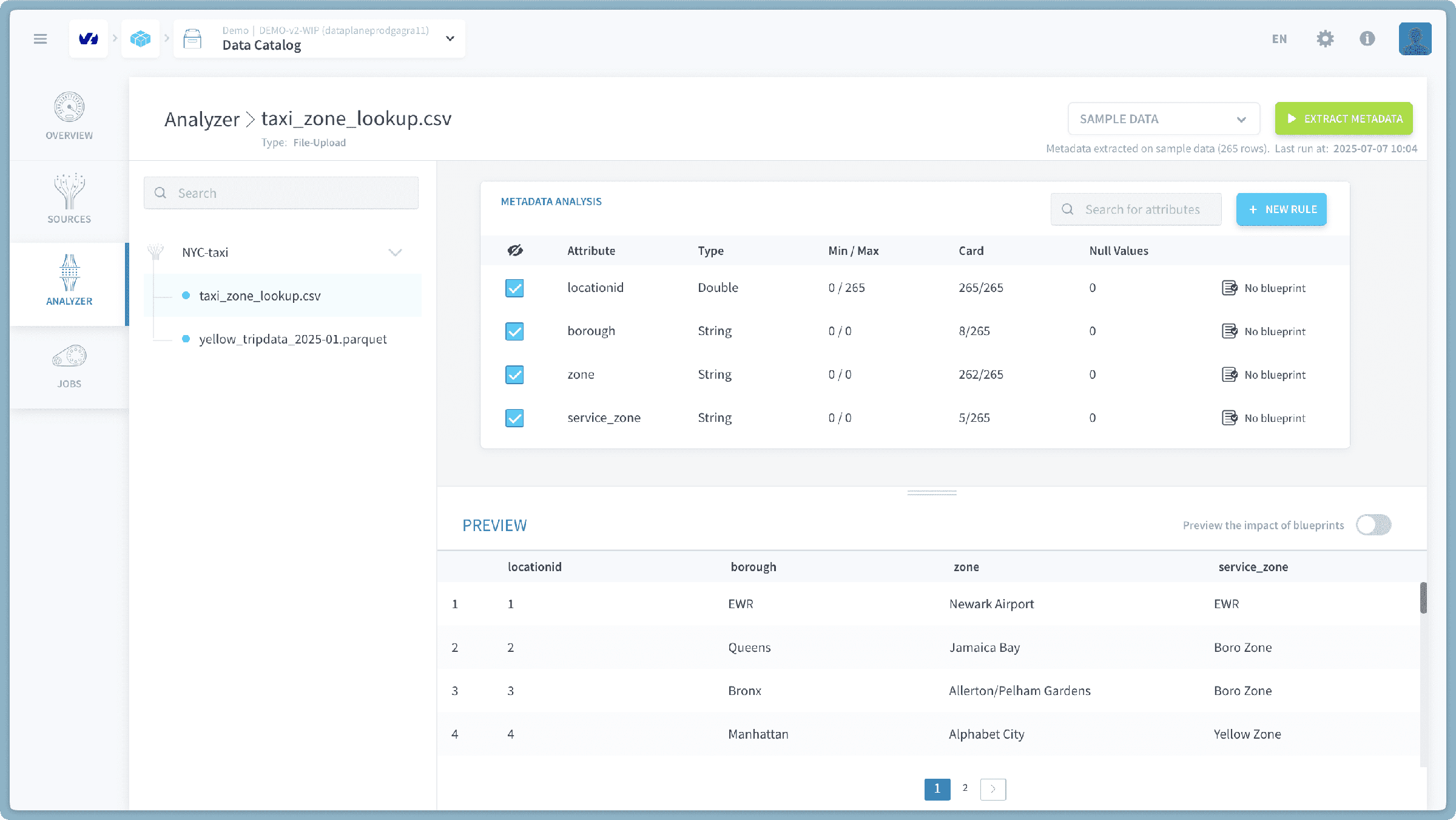

  • Go to the Analyzer tab and perform meta extraction to infer schemas for the uploaded files. Step 1: Create a new source in Connectors — Nyc taxi step (3) Step 1: Create a new source in Connectors — Nyc taxi step (4)

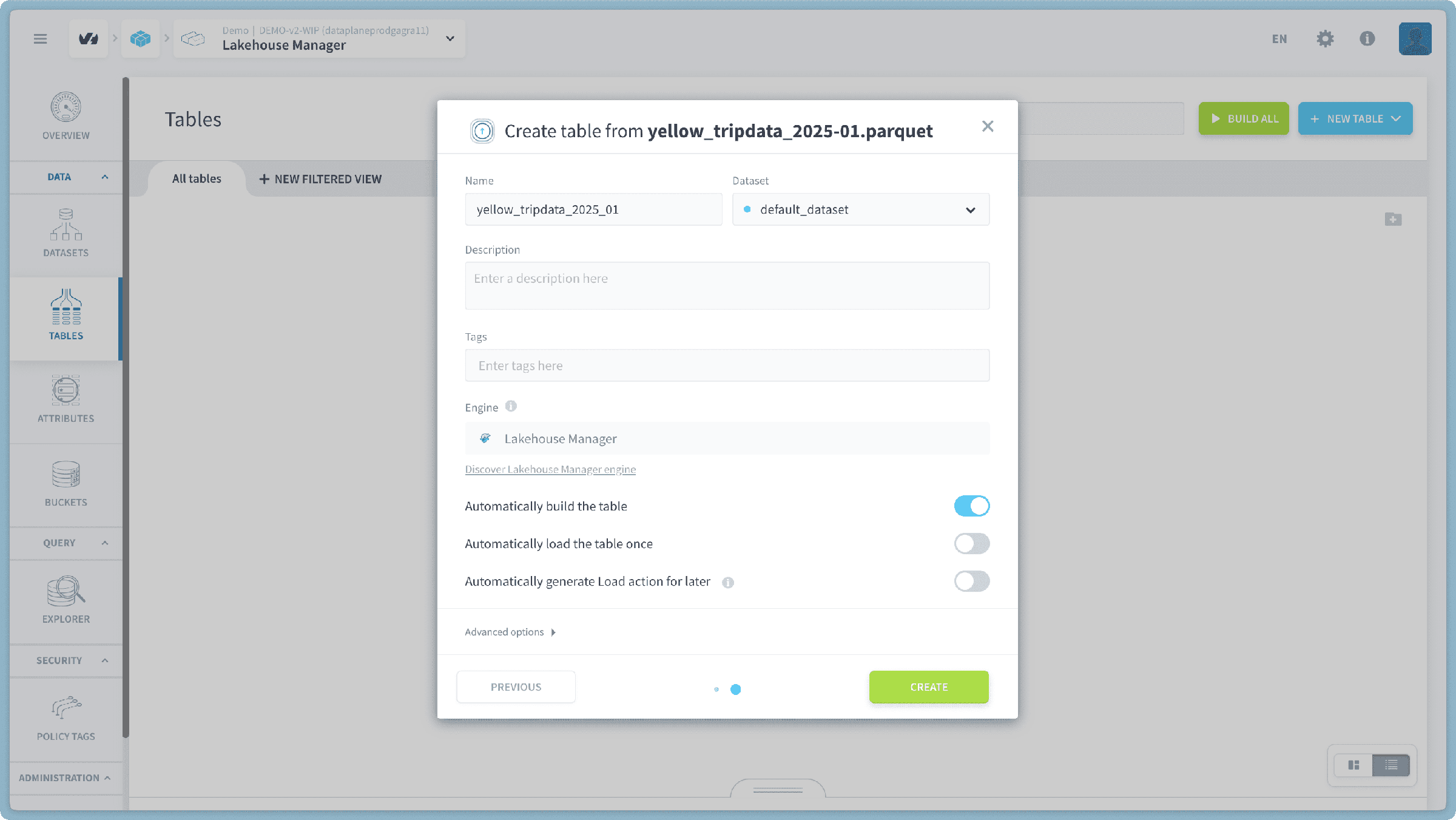

Step 2: Create Tables in Lakehouse Manager

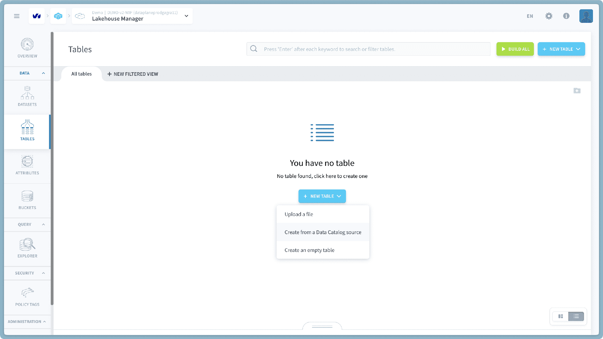

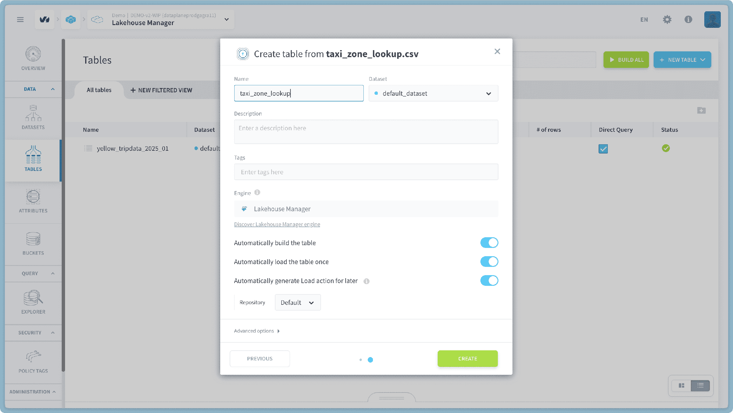

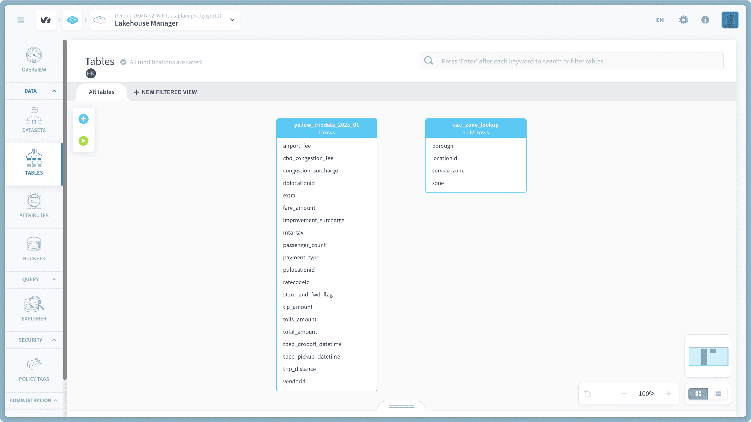

  • Go to Tables tab → click on Create from a Connectors source. Step 2: Create Tables in Lakehouse Manager — Nyc taxi step
  • Select the yellow_tripdata_YEAR_MONTH.parquet file → and only select the option "Automatically build the table". Step 2: Create Tables in Lakehouse Manager — Nyc taxi step (2)
  • Repeat for the taxi_zone_lookup.csv file, select all the options since this table is smaller and can be fully loaded by Iceberg quickly. Step 2: Create Tables in Lakehouse Manager — Nyc taxi step (3) Step 2: Create Tables in Lakehouse Manager — Nyc taxi step (4)

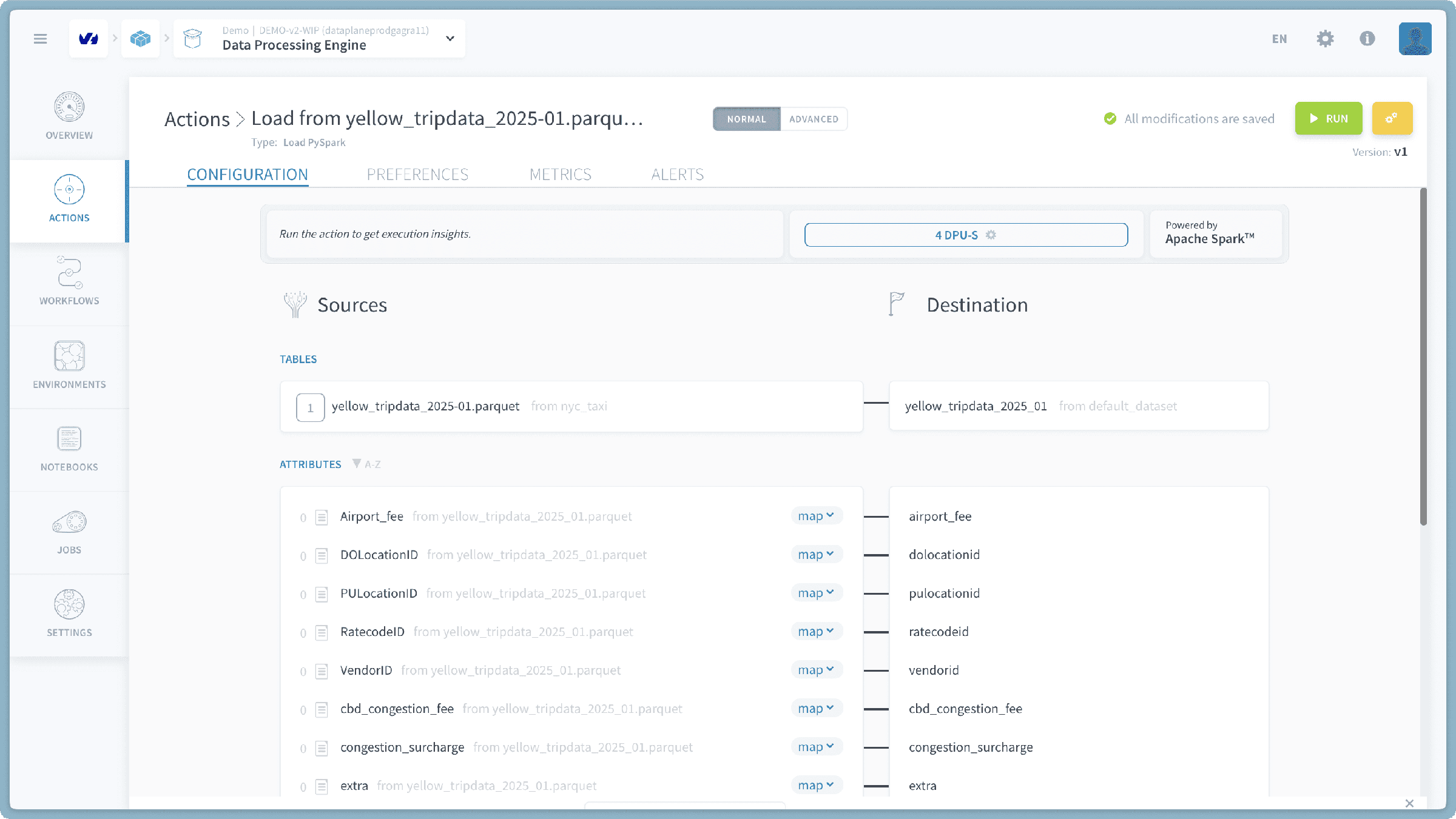

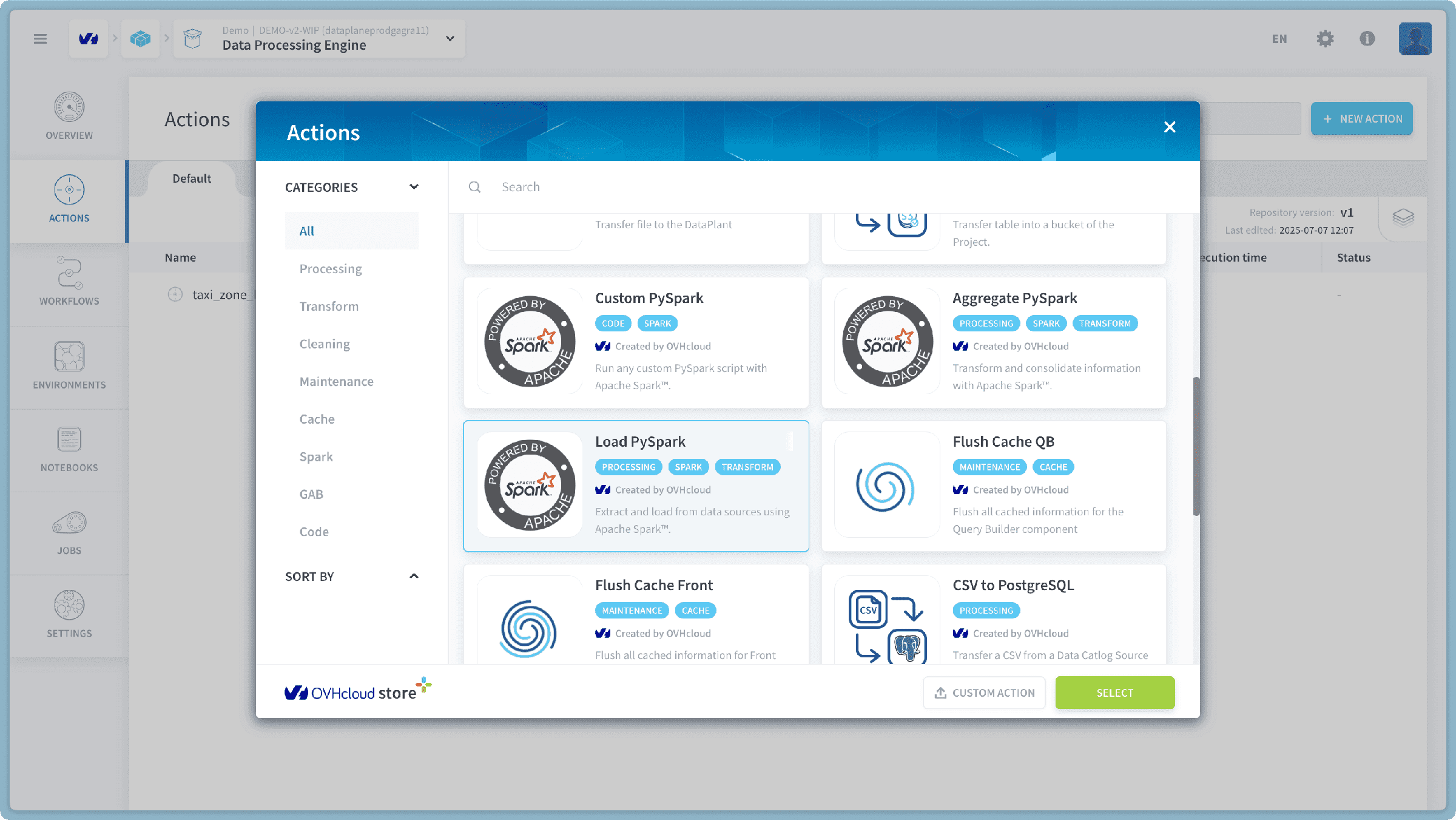

  • Go to Actions tab → Create new action → Use Load PySpark. Step 3: Use Load PySpark action in the DPE — Nyc taxi step
  • Set:
    • Source: yellow_tripdata_YEAR_MONTH
    • Destination: yellow_tripdata_YEAR_MONTH Table in the Lakehouse Manager.
  • Ensure schema mapping is correct (the source columns should align with the table’s schema)
  • Save and run the action. Step 3: Use Load PySpark action in the DPE — Nyc taxi step (2)

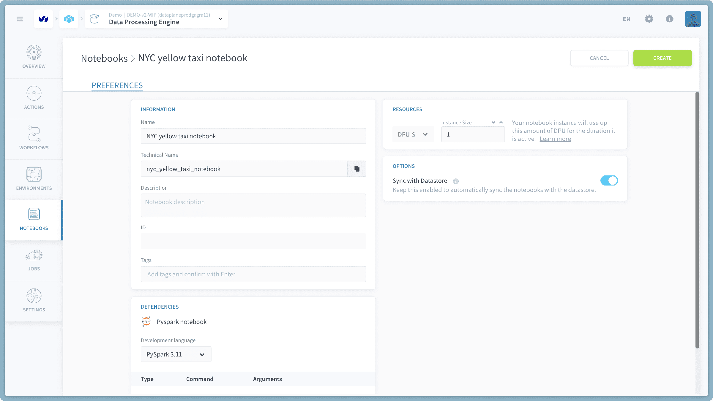

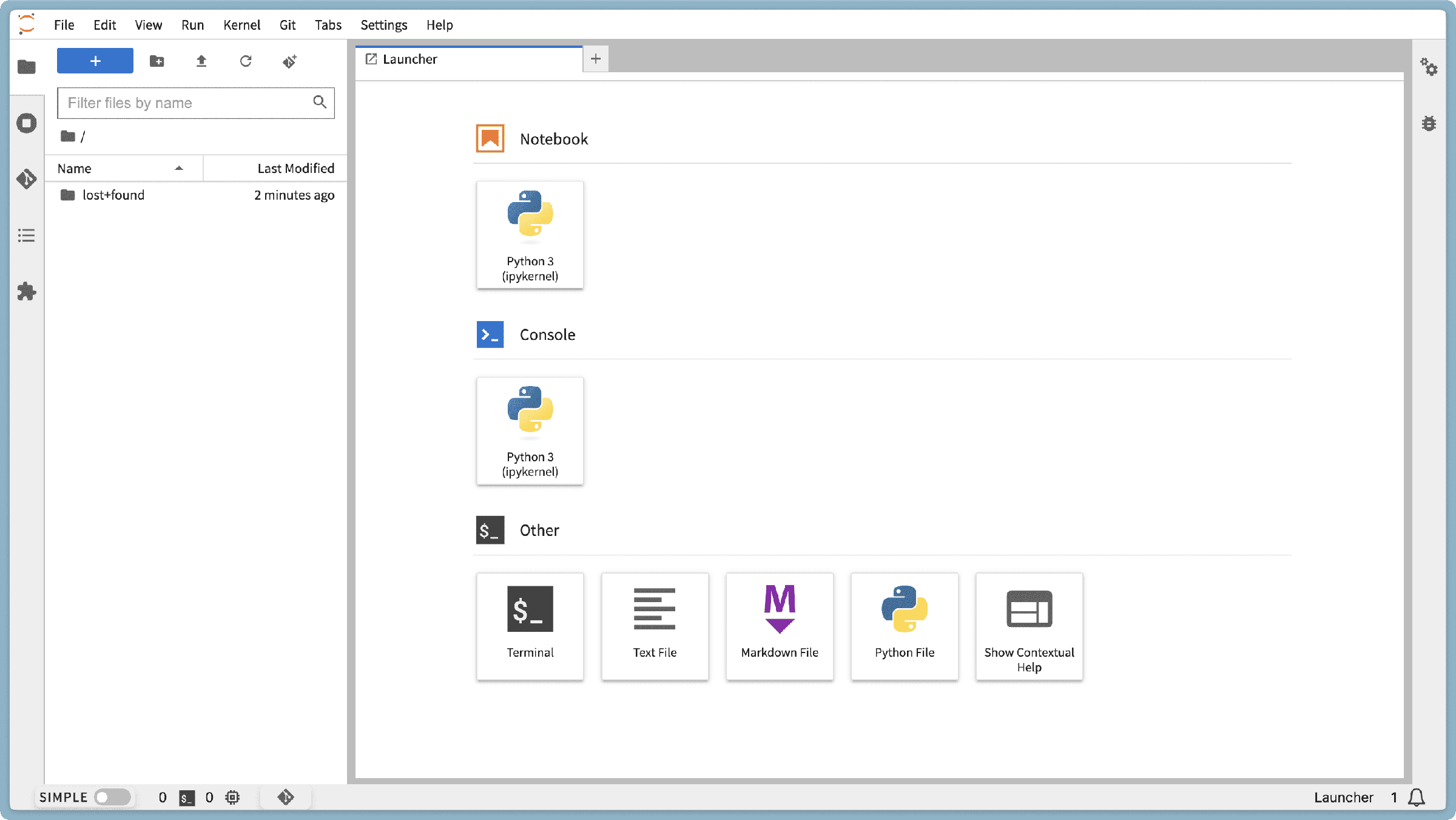

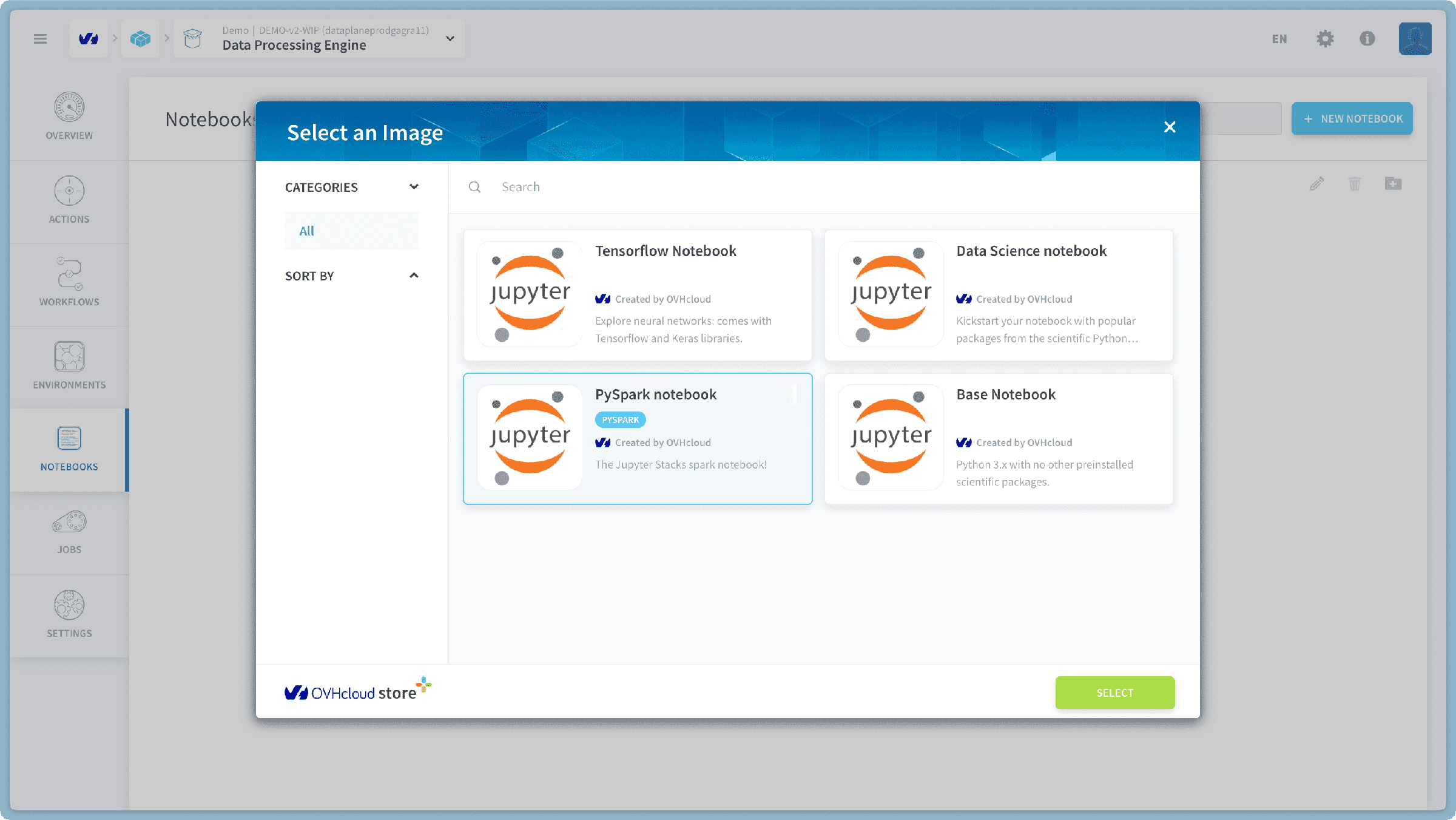

  • Go to the "Notebooks" tab → New notebook → Select PySpark Notebook. Step 4: Create a Jupyter Notebook in the DPE — Nyc taxi step
  • Name it as NYC yellow taxi notebook. Step 4: Create a Jupyter Notebook in the DPE — Nyc taxi step (2)
After launching, the platform will take a few moments to initialize a JupyterHub instance. Once it's ready, click the Open in Jupyter button to access the notebook interface.
Step 4: Create a Jupyter Notebook in the DPE — Nyc taxi step (3)

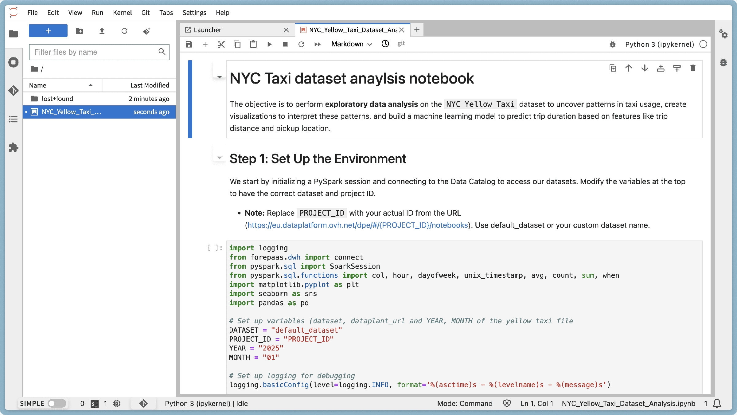

PySpark Notebook Walkthrough
The notebook below includes the full PySpark code, structured step by step with inline comments and explanations. You can download it and upload it directly into your Jupyter environment on the OVHcloud Data Platform. Each step is explained in detail to help you follow the analysis process, and a summary is provided at the end for quick reference.
PySpark Notebook Walkthrough — Nyc taxi step

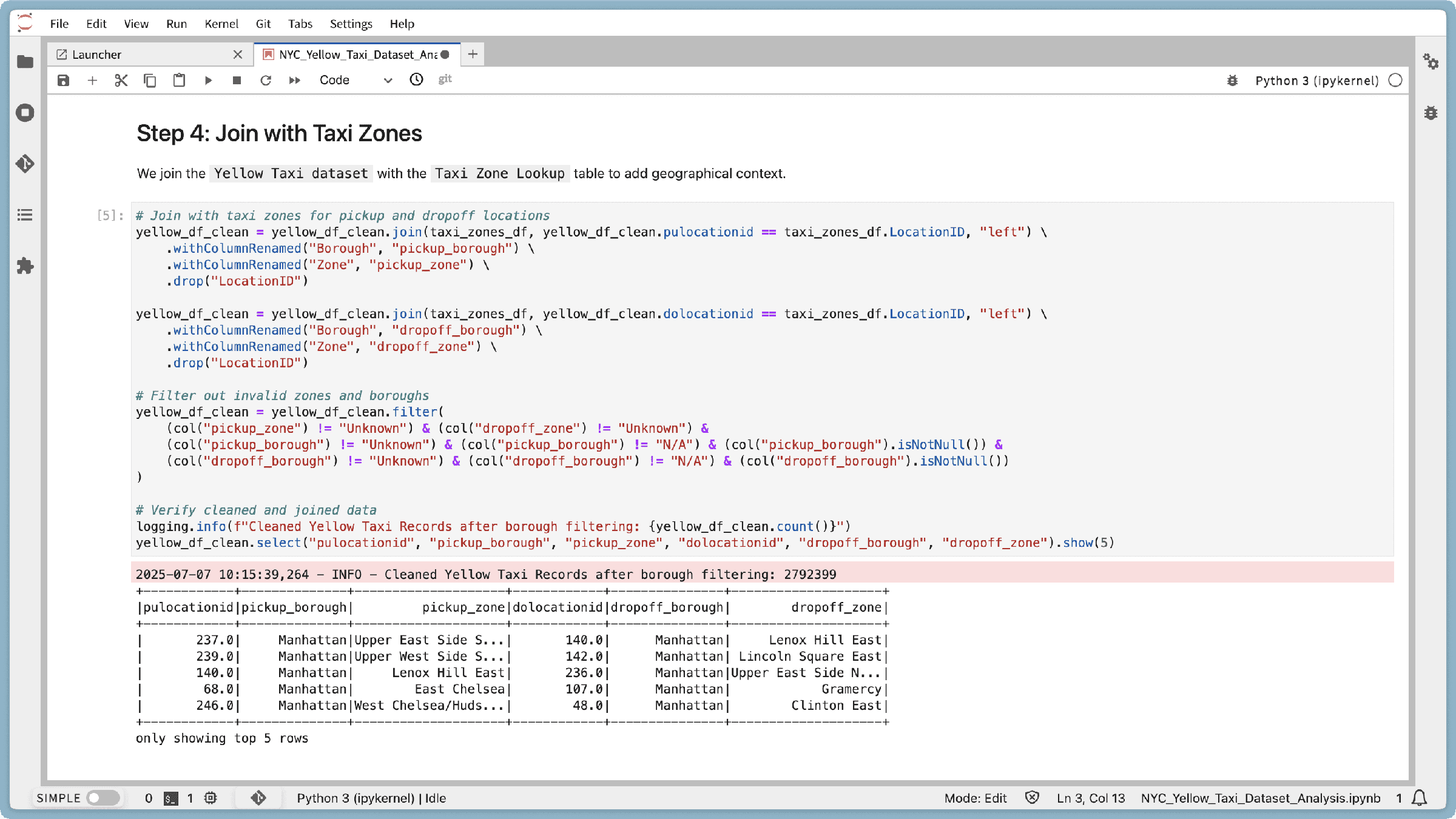

  • Cleaning and joining trip data with zone lookups

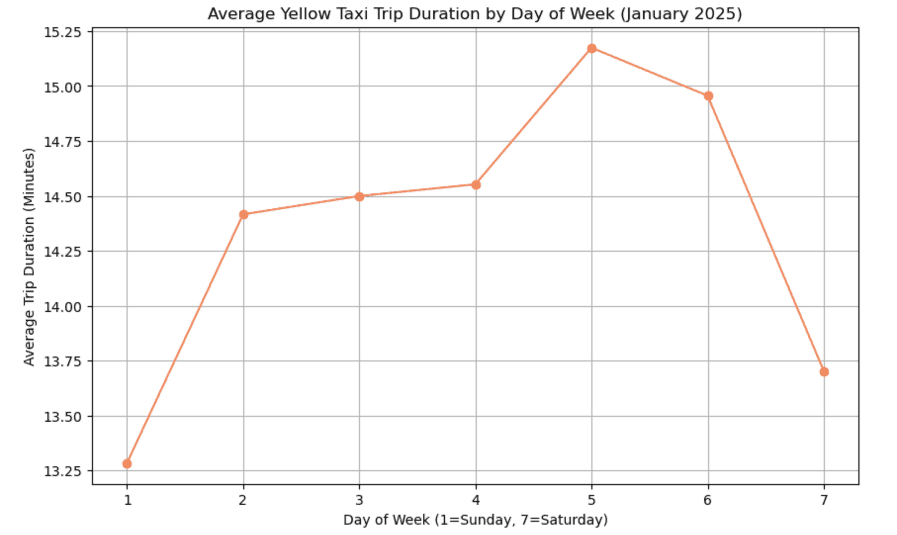

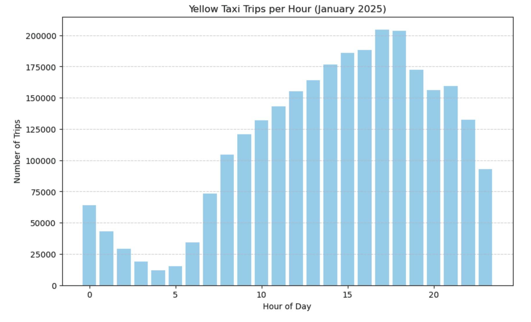

Below are a few sample outputs from the notebook:
What’s Inside the Notebook? — Nyc taxi step What’s Inside the Notebook? — Nyc taxi step (2) What’s Inside the Notebook? — Nyc taxi step (3)

Insight:
Trip distance was by far the most influential predictor. Pickup borough had some impact, while time-based features (hour and weekday) had minimal effect on trip duration.
