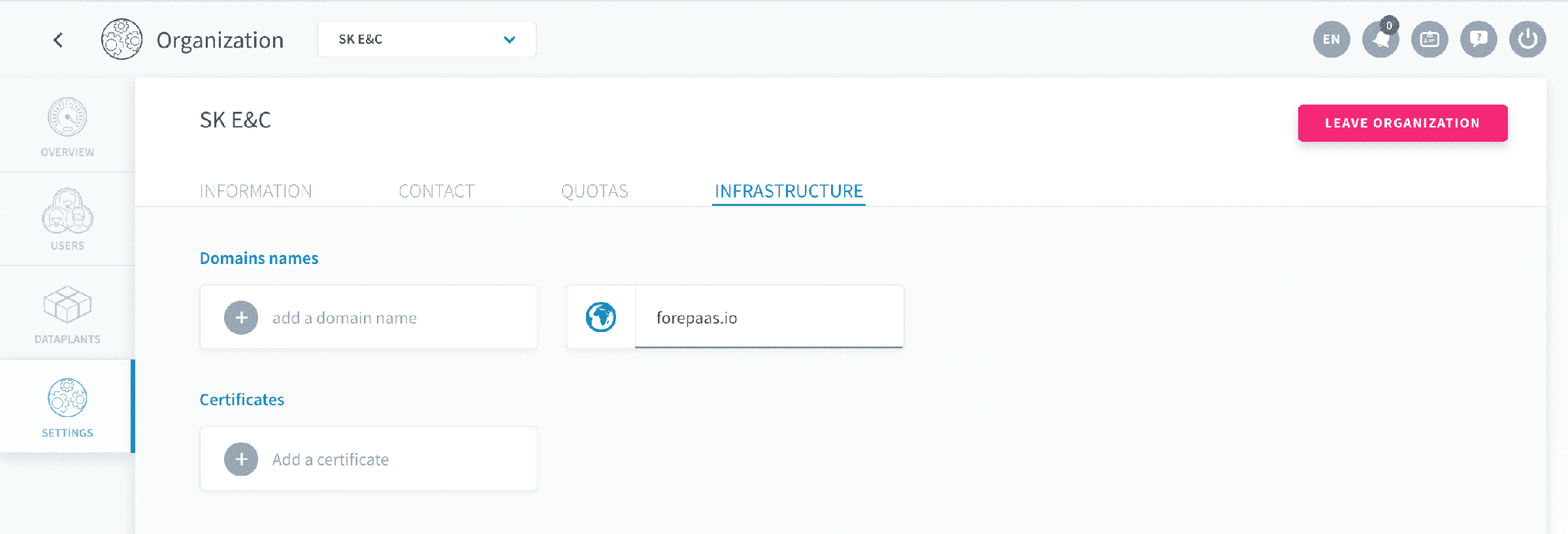

Register domain for your organization
Head over to the Organization information, access the Settings section and navigate to the Infrastructure tab.
Infrastructure

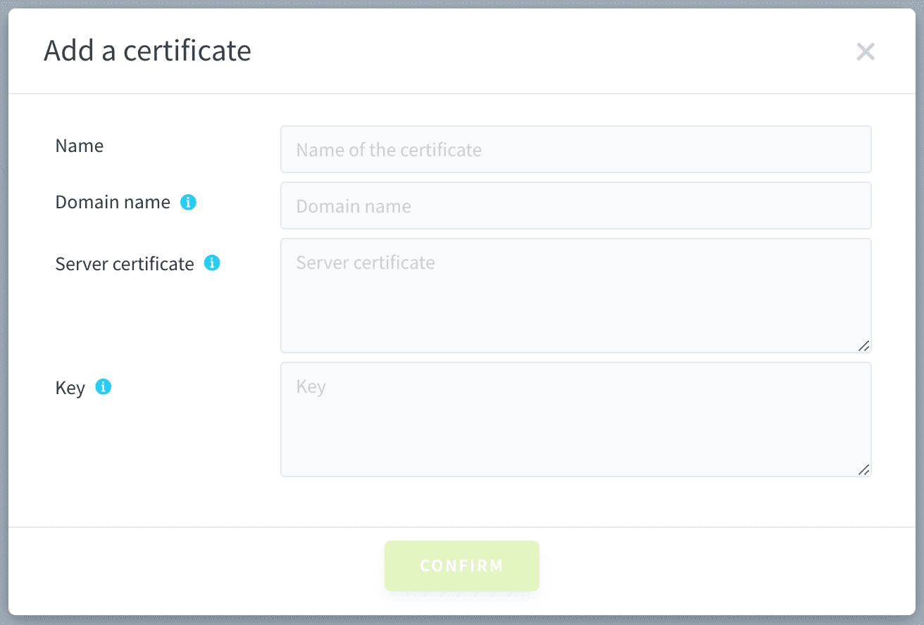

Click on Add a Certificate. In the new certification window, enter your information:
  • Name: a descriptive name for your own usage (has no incidence on the actual certificate name)
  • Domain name: the hostname associates with the SSL certificate that you generated
  • Server certificate: copy the content of the .pemfile provided by your SSL Certification Authority
  • Key: copy the content of the .keyfile that you created using OpenSSL
Certificate

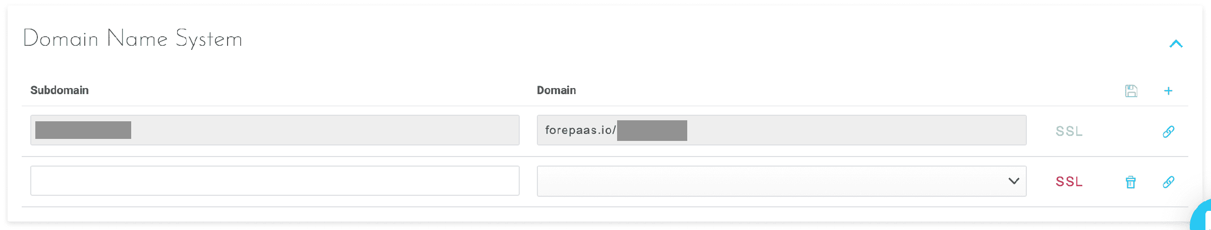

Register domain for your application
Navigate to the project and edit the application that you would like to change the DNS for. Head to the Settings tab and go the Domain Name System section.
Following our example, create a DNS entry for my-app.example.com as a CNAME to my-project.eu.dataplatform.ovh.net, where:
  • my-app.example.comis the hostname you provided an SSL certificate for
  • my-project.eu.dataplatform.ovh.net is the project's main URL
Your application is now available at your own URL, for example https://my-app.example.com/.
Register domain for your application — Domain
