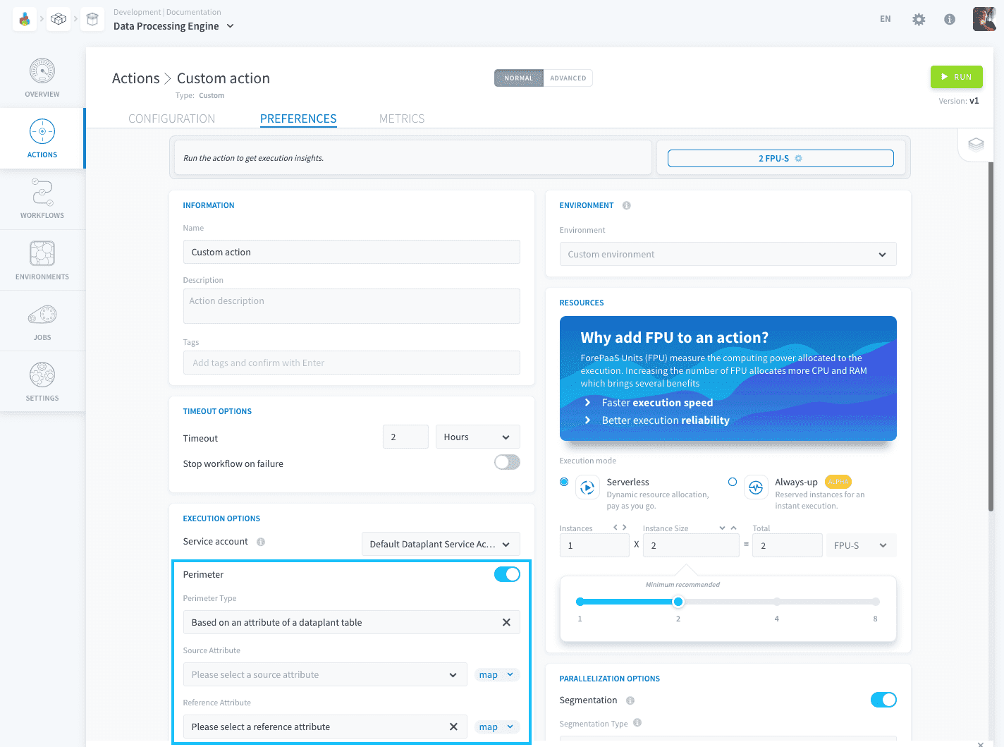

To configure this perimeter option select Based on an attribute of a Project table in the "Perimeter Type" dropdown.
Configuration — P1
If you are using the advanced mode interface, you will need to add the following fields to your action JSON configuration:
"perimeter": {
  "active": true,
  "type": "dwh_attributes",
  "values": "dwh/default_dataset/tmp_dates/date",
  "var_name": "date_order",
  "attribute": "date",
  "attribute_type": "map"
