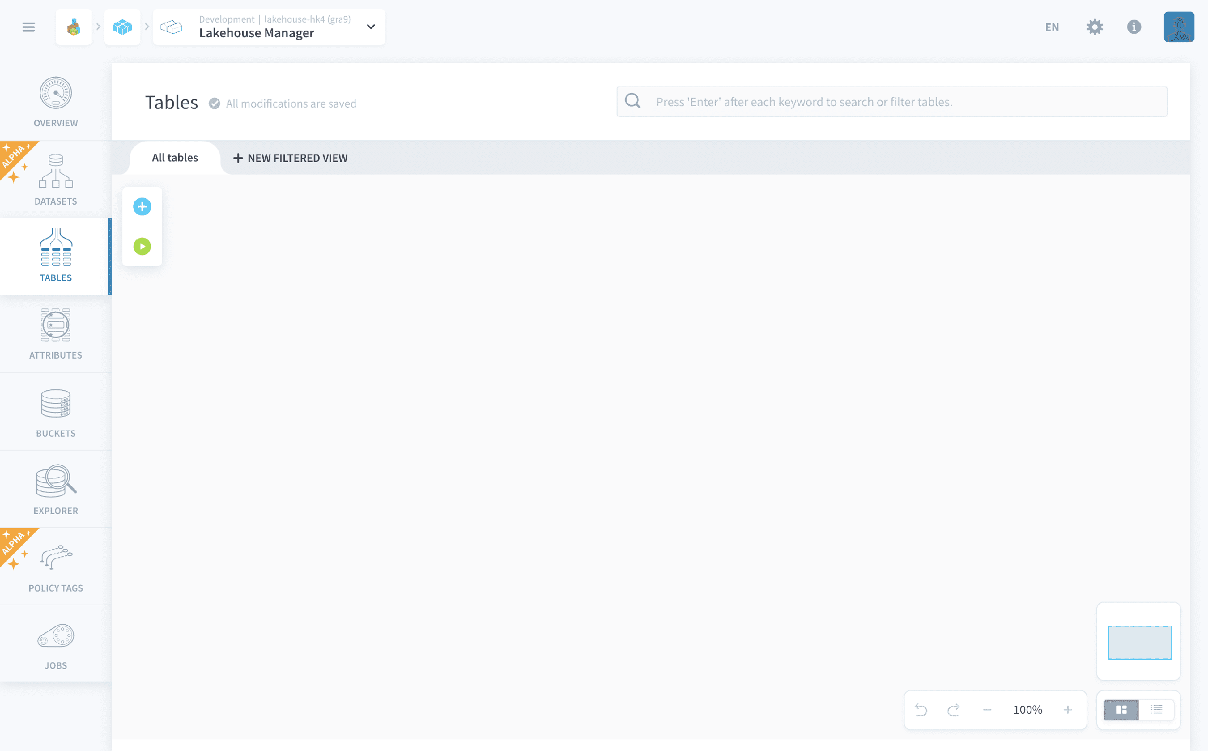

Once that your metadata has been extracted, it's time to head to the Tables dashboard. This is where you will build a unified and queryable view of all your data.
The empty Tables page should look like this.

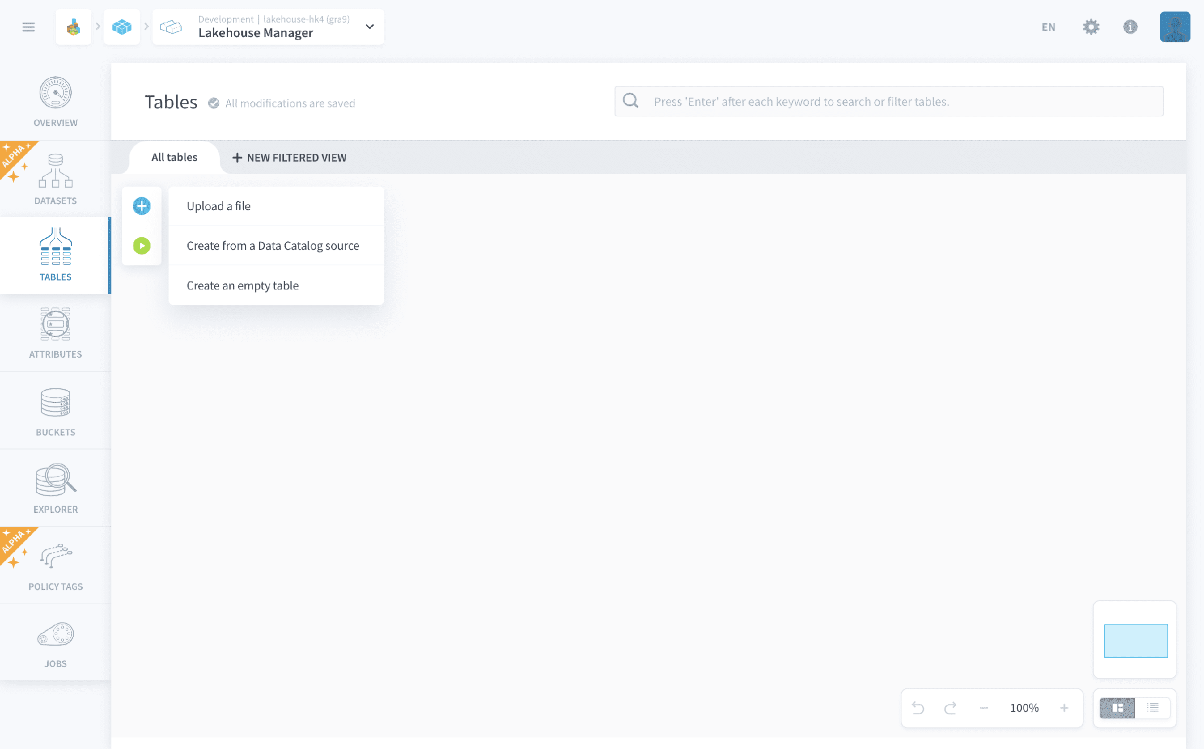

First, hover your cursor over the blue ➕ icon on the left-hand side of the screen. This will reveal the create options :
  • Upload a file
  • Create from Connectors source
  • Create an empty tables

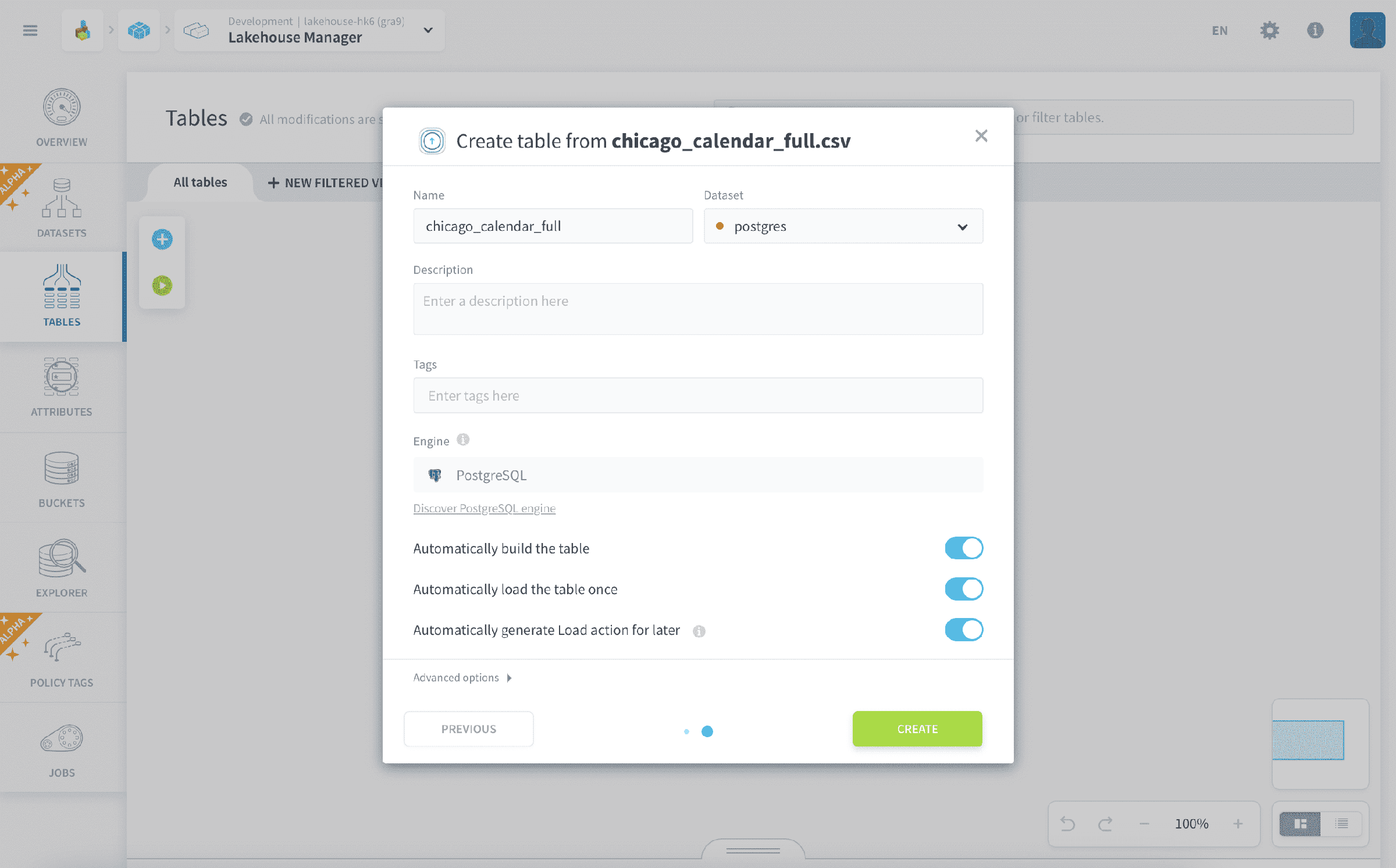

For the purpose of this tutorial, we shall proceed with Create from a Connectors source.
Lakehouse Manager

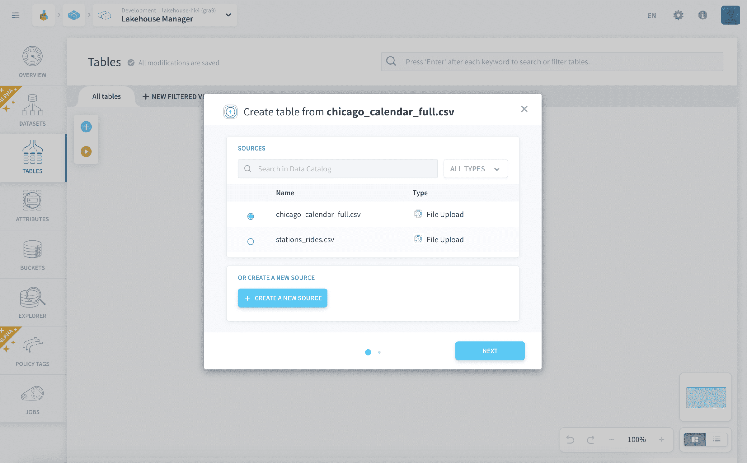

Once you click on create from a connectors source, you will be shown a list of sources from the the previous step. Click on source you want to add and proceed further by clicking on Next. Here we can choose the one of the external datasets you have created. No need to change any of the other default settings here.
The options Build the table, load the table once, and generate Load action for later can be disabled and each step can be done individually as well. This can be explored in detail in the Tables guide.
Press Create and proceed to repeat the same with the second table as well.

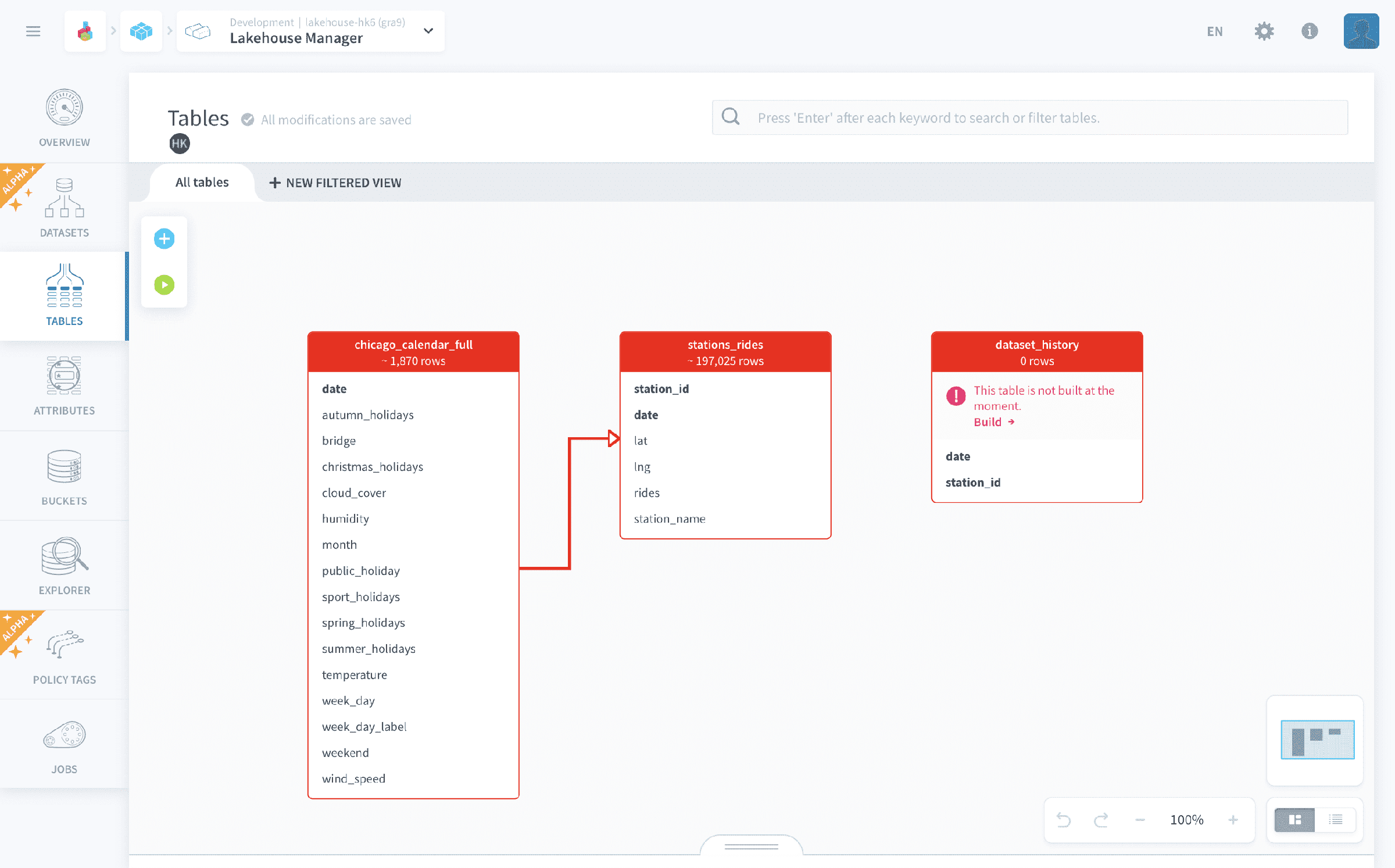

Note that each time you make a change on the Tables page, your visual configuration is automatically saved.

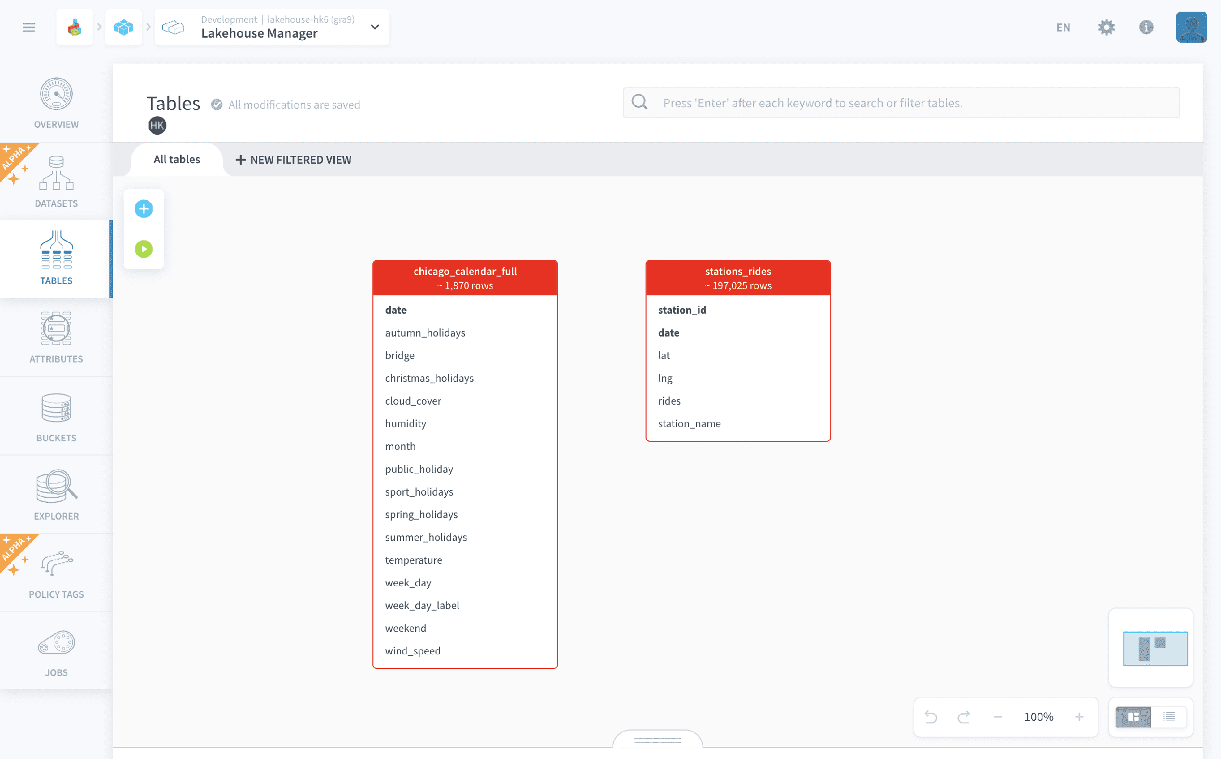

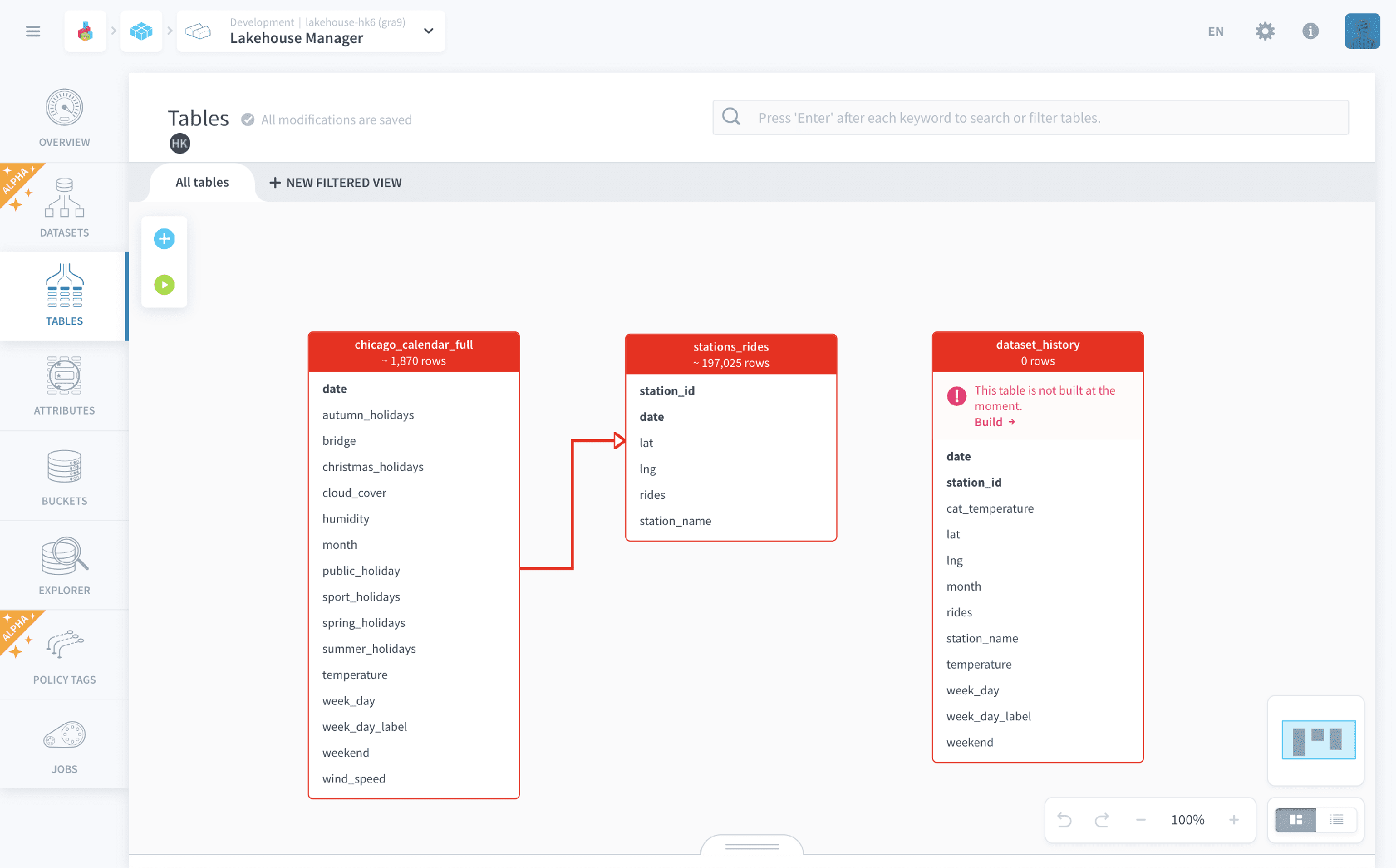

At this stage, your Tables page should look like this.
Lakehouse Manager

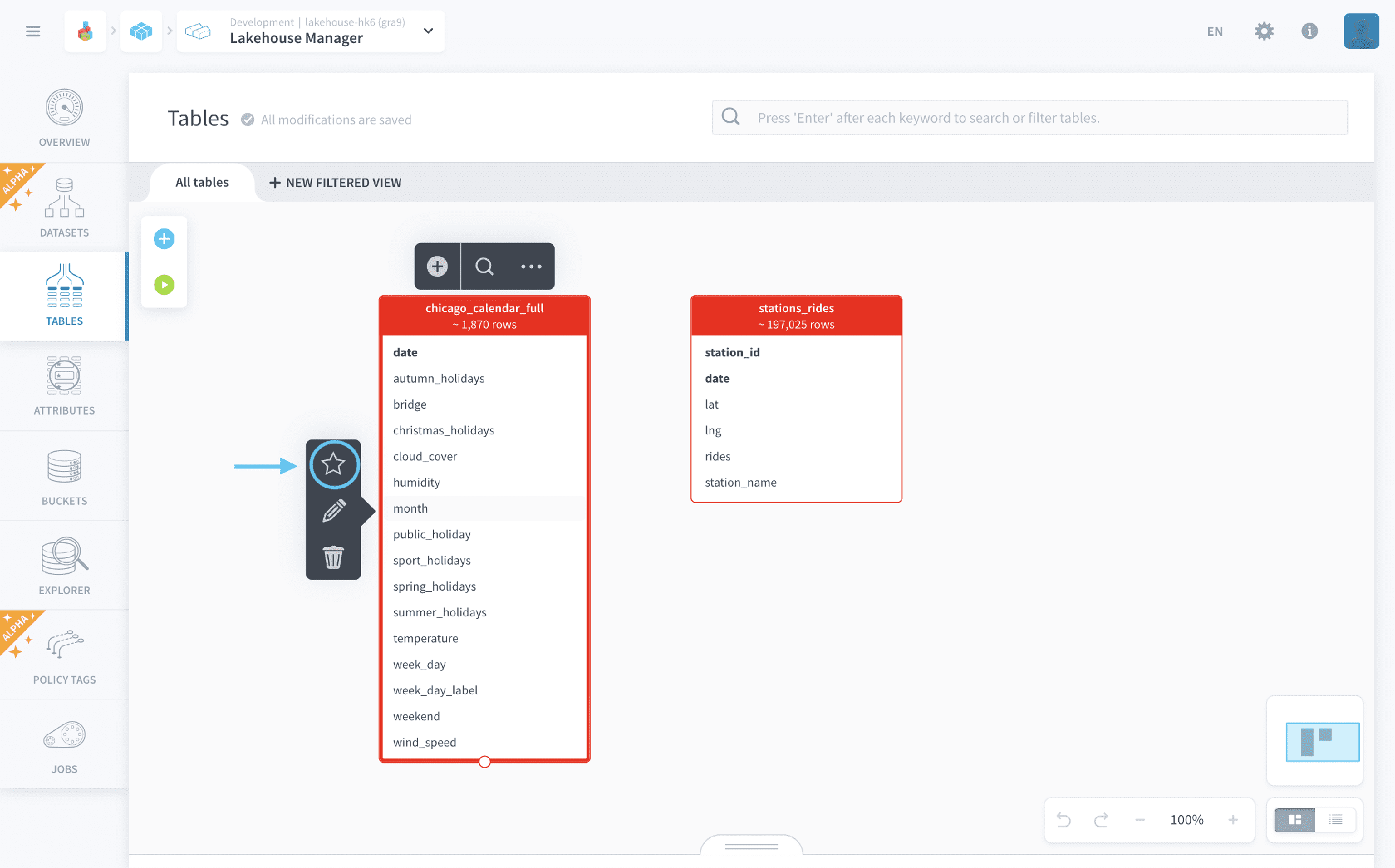

You may notice that some attributes in your tables are written in bold. The platform has automatically detected that they were primary keys, i.e. the attribute (or set of attributes) used to uniquely identify each data row in the table.
You can manually change the primary keys for any table by hovering your mouse cursor over the attribute and clicking on the star ⭐ icon.
You may notice that while using External Datasets some attributes in your tables are written in bold. The Platform has automatically detected that they were primary keys, i.e. the attribute (or set of attributes) used to uniquely identify each data row in the table. The Lakehouse Manager Engine is more big data engine, and by default the concept of primary keys do not exist. Hence you will not be seeing any attributes in bold.
Lakehouse Manager
Note that the Platform uses the metadata information captured in the Analyzer step to automatically create tables and assign attribute names & types. The source files provided are good to go, however in a real Project you should use the Analyzer to check the data sources, before dragging and dropping them in the Tables page.

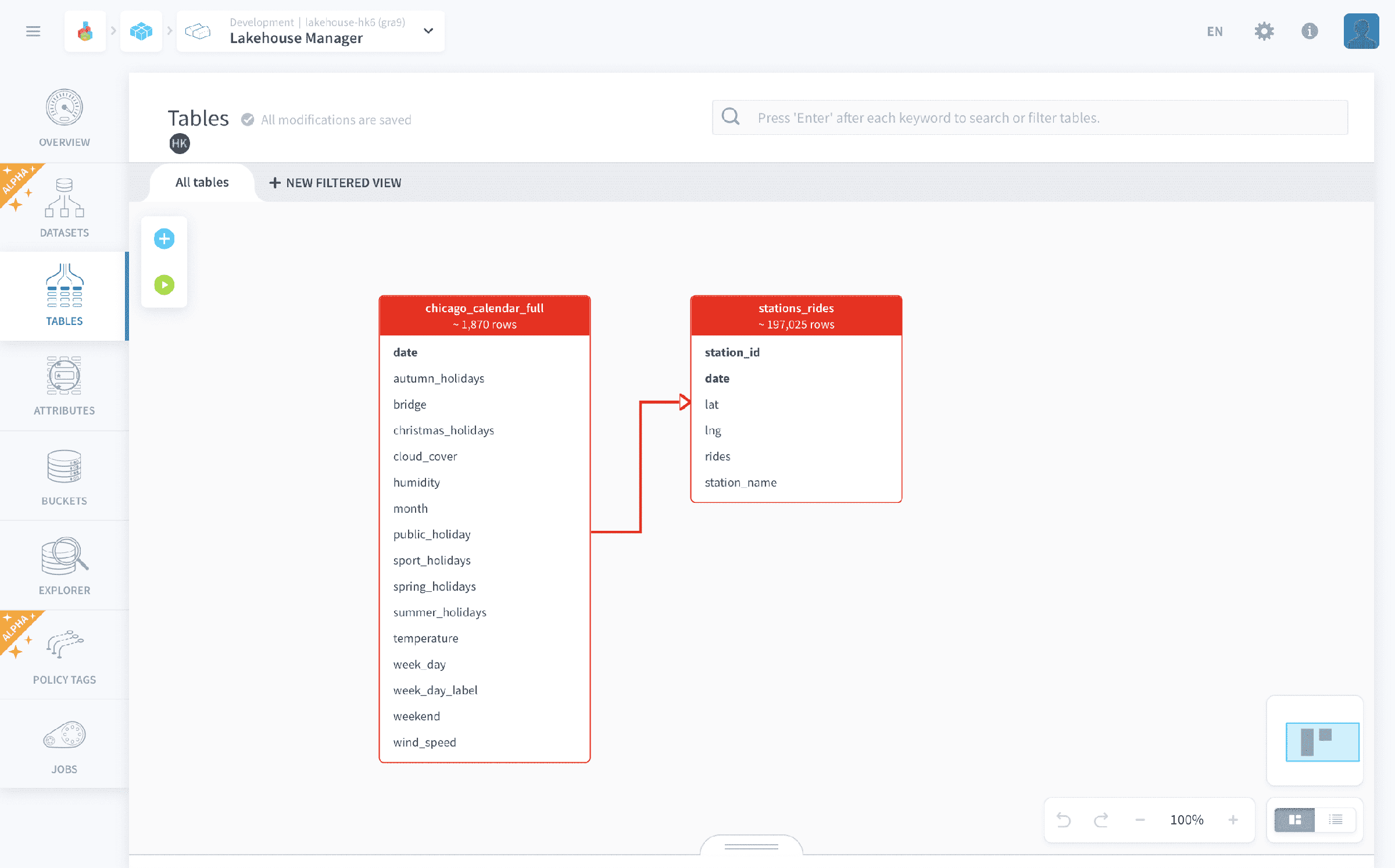

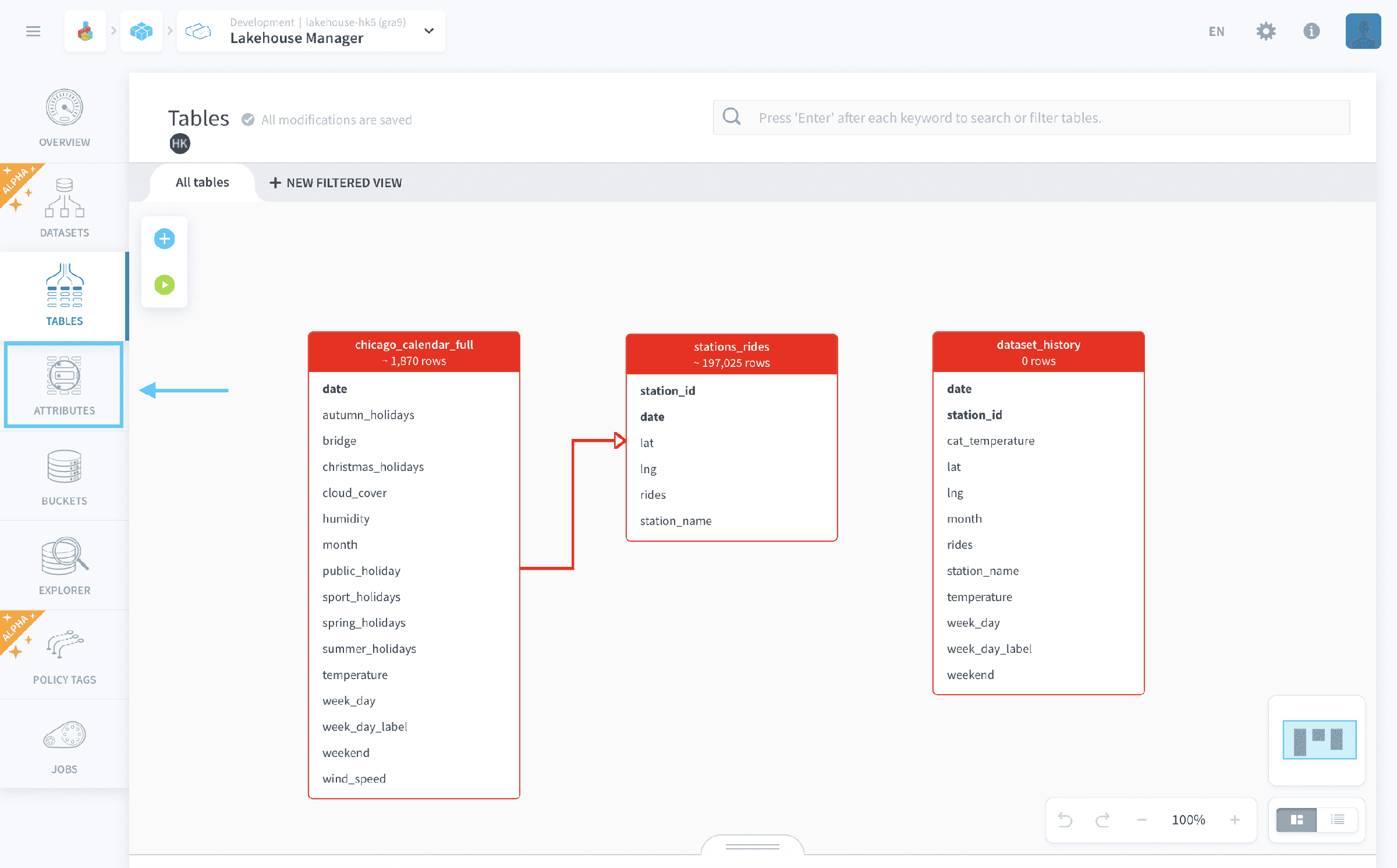

Join tables together
You need to tell the Lakehouse Manager how your tables relate to each other.
You will join tables that relate to each other in a parent/ child relationship. A parent is a table that has detailed information about a particular subject: for example, the weather in Chicago at a certain date. A child table references multiple parent tables. Another way to look at it is that a child table inherits values from the parent table (just like children in real life, except that a child can have more than two parents!)
The table stations_rides is a child table. It contains ridership information by date and train station. But it does not have detailed information about the days. Both your tables have date as a primary key. So, if you link the chicago_calendar_full parent table to the stations_rides child table, you will automatically have added weather information to your ridership, for each day of the year.

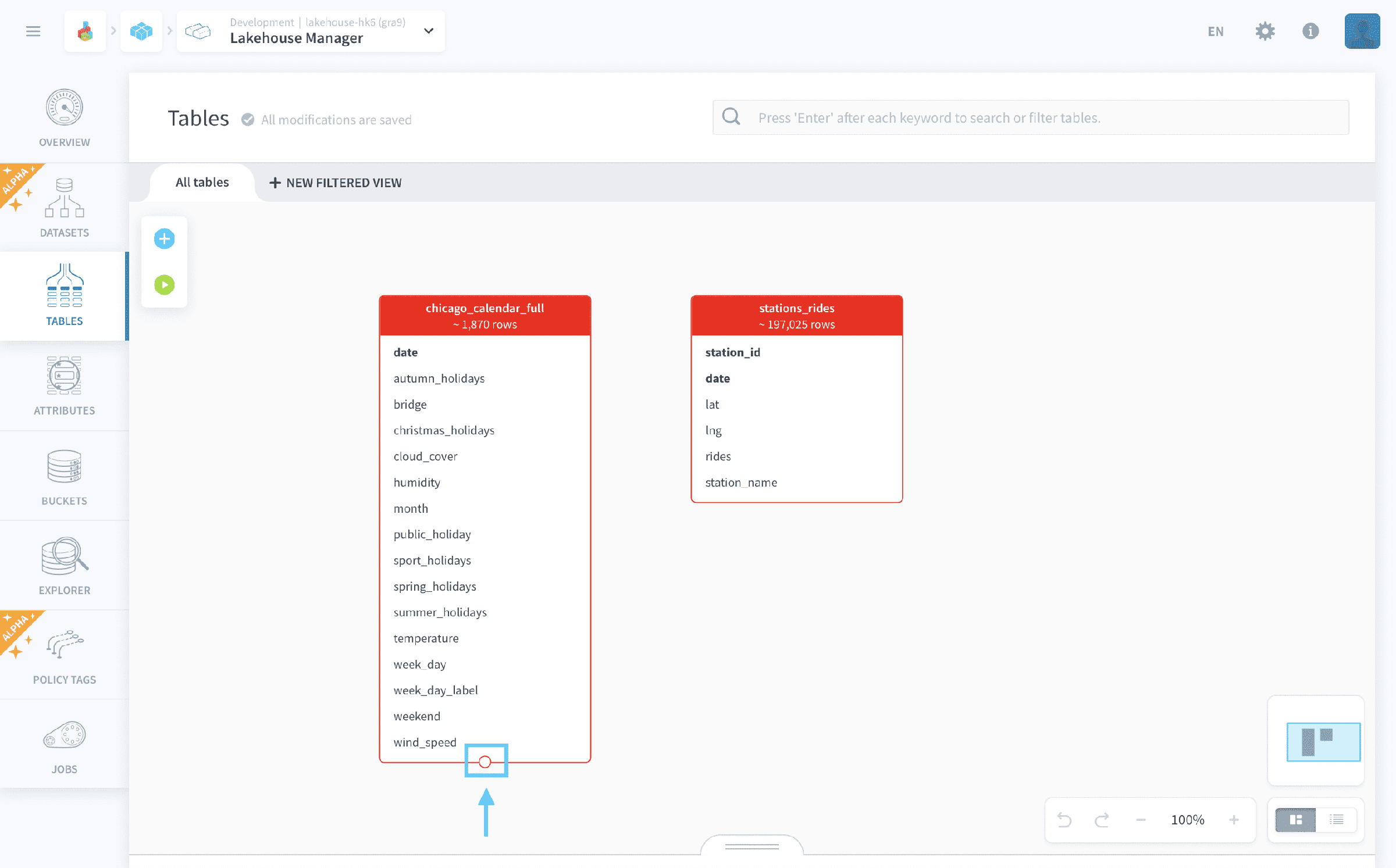

First, click once on chicago_calendar_full parent table to select it, then click on the white circle at the bottom of the table:
Lakehouse Manager
Simply drag the arrow to the child table stations_rides and drop/unclick. Your screen should be like this:
Lakehouse Manager

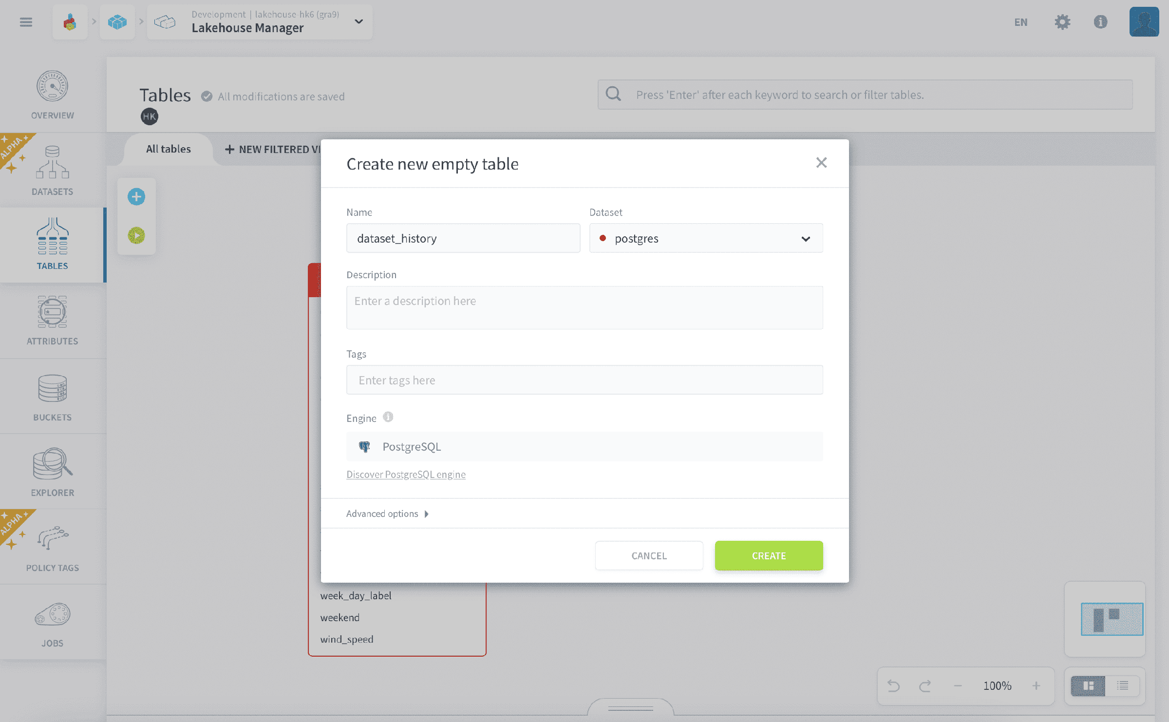

To create your first aggregate table, click on the blue ➕ icon. Select Create an empty table, and you will be shown a new table configuration where you set a name (dataset_history for example) and save it.

Then, drag and drop date and station_id from the source table stations_rides into the table dataset_history and set these attributes as primary keys.
Lakehouse Manager

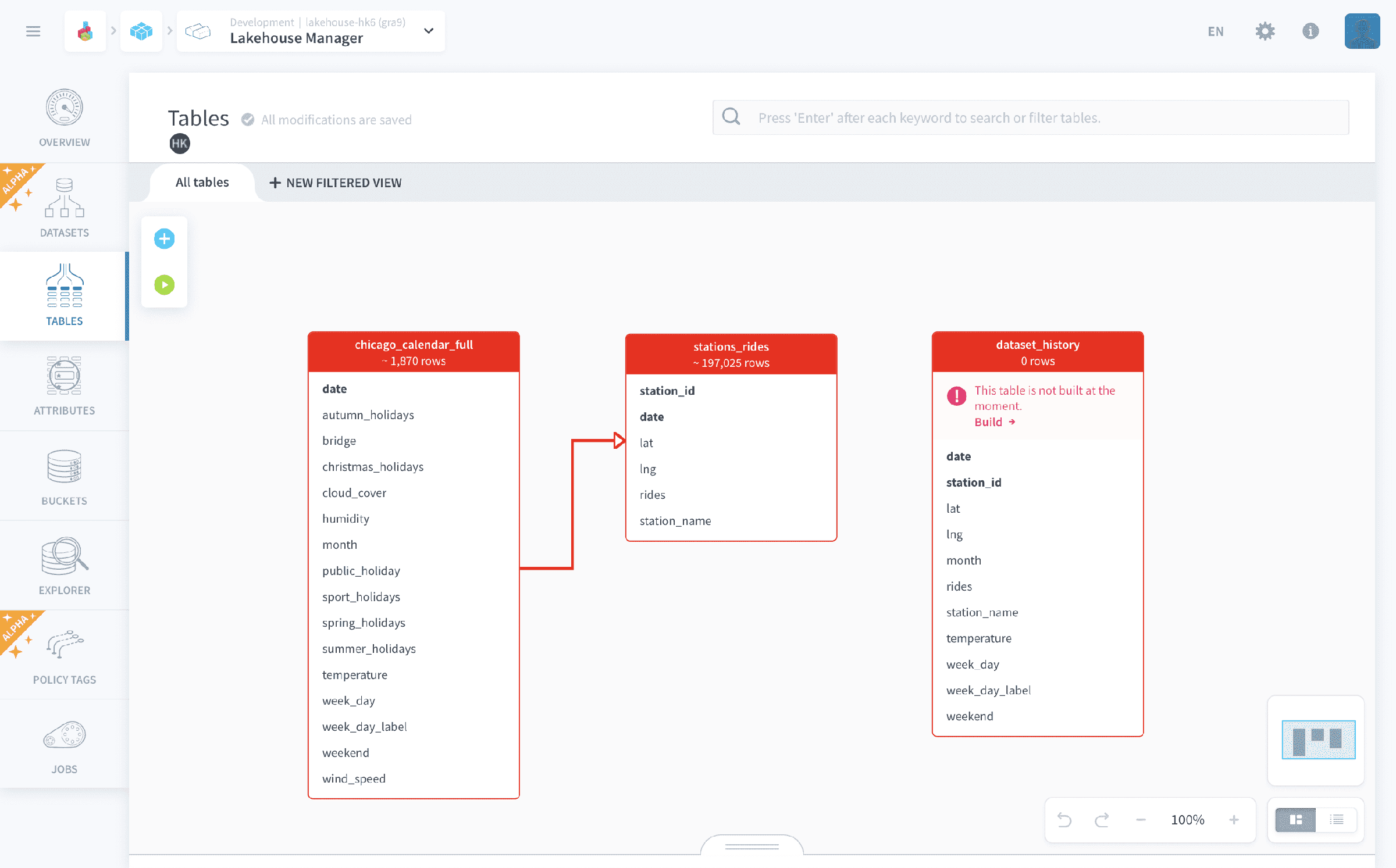

Move the attributes below to dataset_history and do not set them as keys (since they are simple data of each row and are not unique):
Original tableAttributes to drag-and-drop
stations_rideslat / lng / rides / station_name
chicago_calendar_fullmonth / temperature / week_day / week_day_label / weekend /
Lakehouse Manager

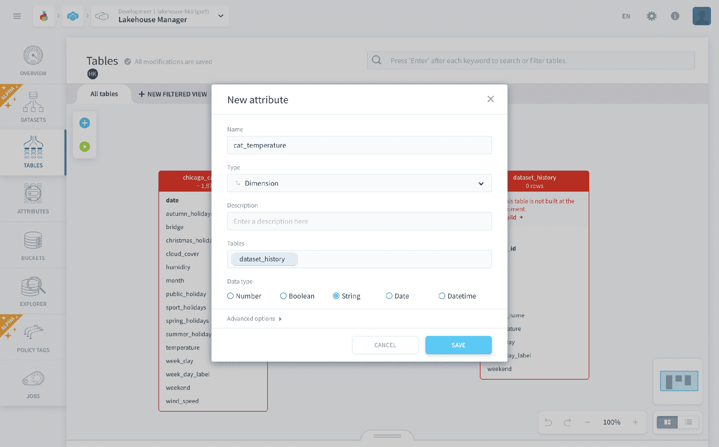

Finally, you will need to create one new attribute to help translate numerical temperature data into understandable categories (cold, hot, ..).
Start by clicking on the ➕ icon that appears at the top of the table dataset_history when you click on it. You can then create or edit an attribute inside a table.
Define the attribute as such:
Attribute nameTypeNature
cat_temperatureStringDimension
Lakehouse Manager
For the moment, this attribute is not physically specified. This will be done later in another component: the Data Processing Engine.

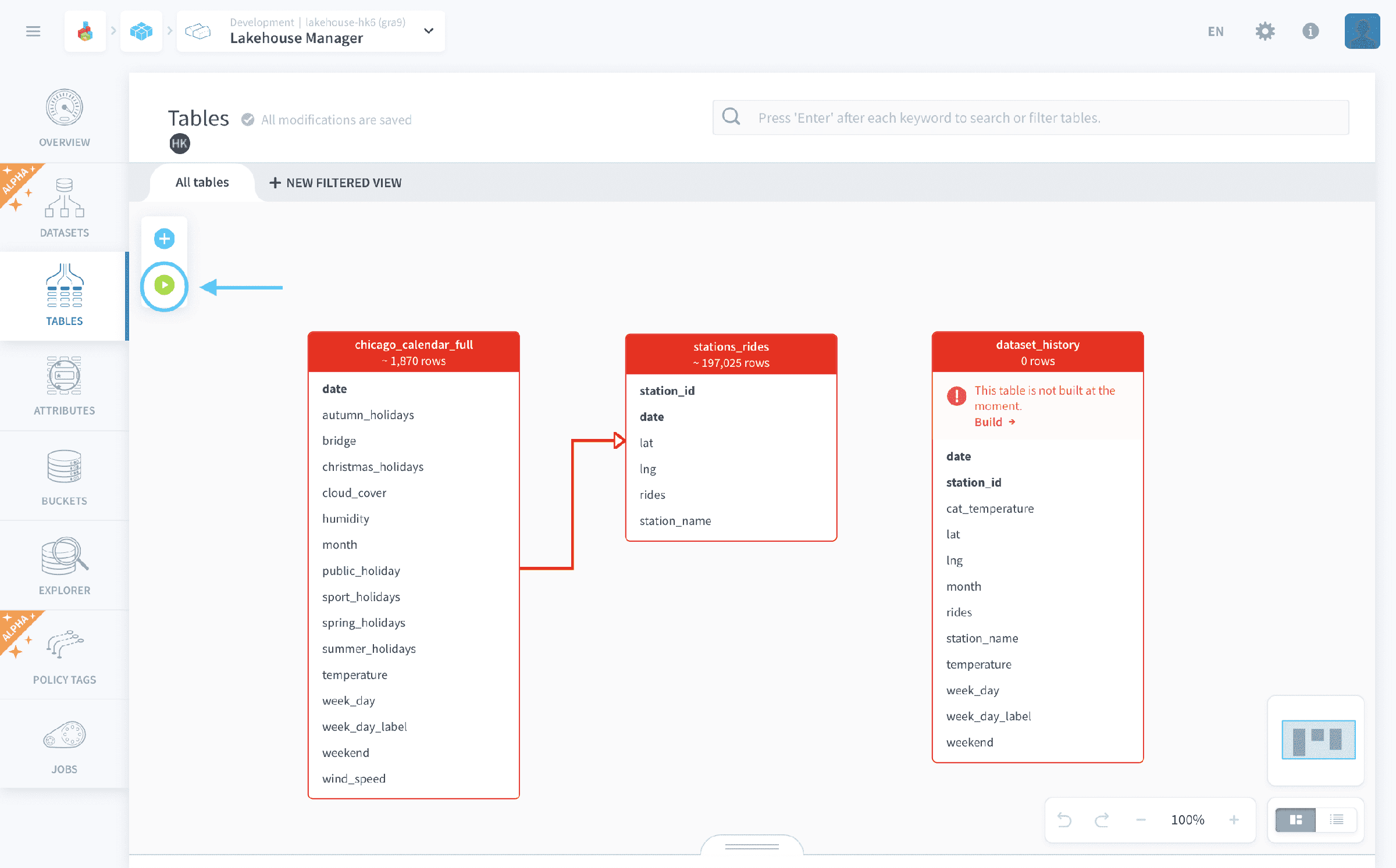

One last quick check! Make sure to double-check that your data model looks exactly like the one in the screenshots before moving to the next step. If some attributes are missing you will get stuck in later steps of the tutorial.
Lakehouse Manager
Now, click on the Build icon (under the blue ➕ icon) to effectively create/update the tables and attributes in your dataset. This still doesn't load the data into the tables (which will be done in the next article), it simply applies the logical schema to tables and attributes in your underlying dataset.
Lakehouse Manager
While the visual logical schema of the data is automatically saved, changes to your tables won't be visible in the rest of the Platform as long as they are not built.
The build task for this tutorial shouldn't take more than a few minutes to run. Once it is done, you can move on.

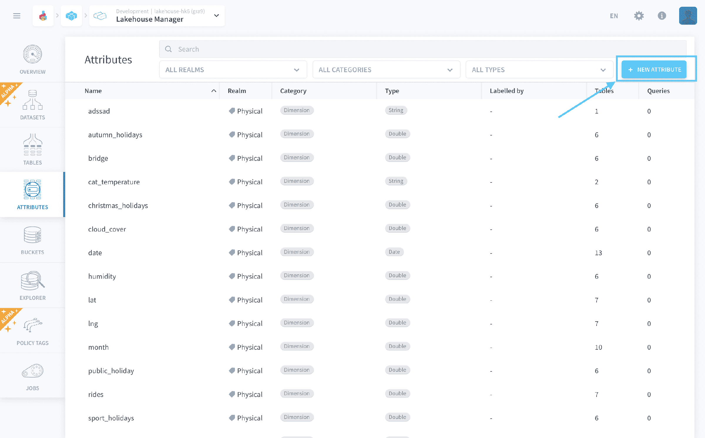

Switch to the Attributes page. This page lists all physical and virtual attributes in your data model, and the lineage in your Project.
Lakehouse Manager

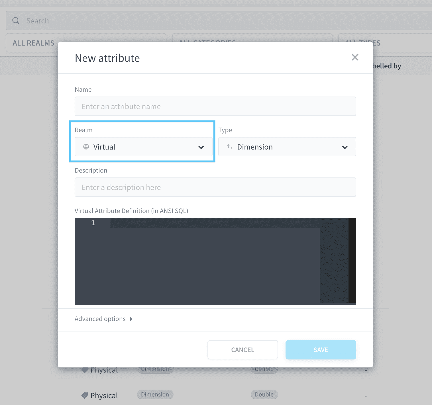

Click on the New Attribute button to create a virtual attribute.
Lakehouse Manager
In the creation window, make sure to select Virtual as the realm.
Lakehouse Manager
Now add these two attributes and their respective SQL code:

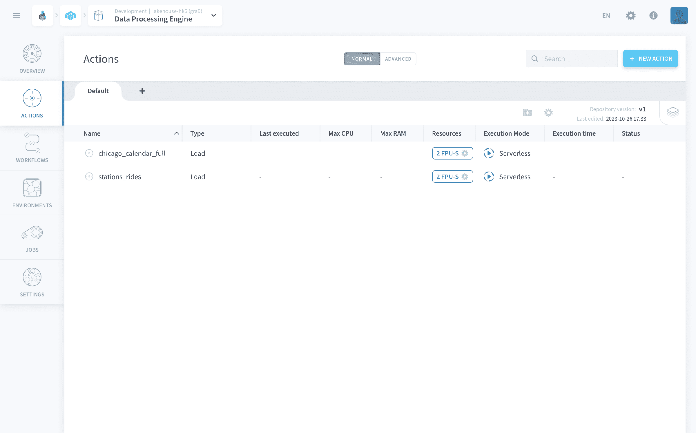

An action consists of a unitary physical operation on the data. Actions can be organized in stages in order to produce automated data processing pipelines called workflows.
Click on the Actions menu of your Data Processing Engine. You should see the two Load actions that were automatically generated in the previous step:
DPE Actions
These Load actions will physically extract the data from your sources and load it into your data warehouse, following the schema made in the Lakehouse Manager.

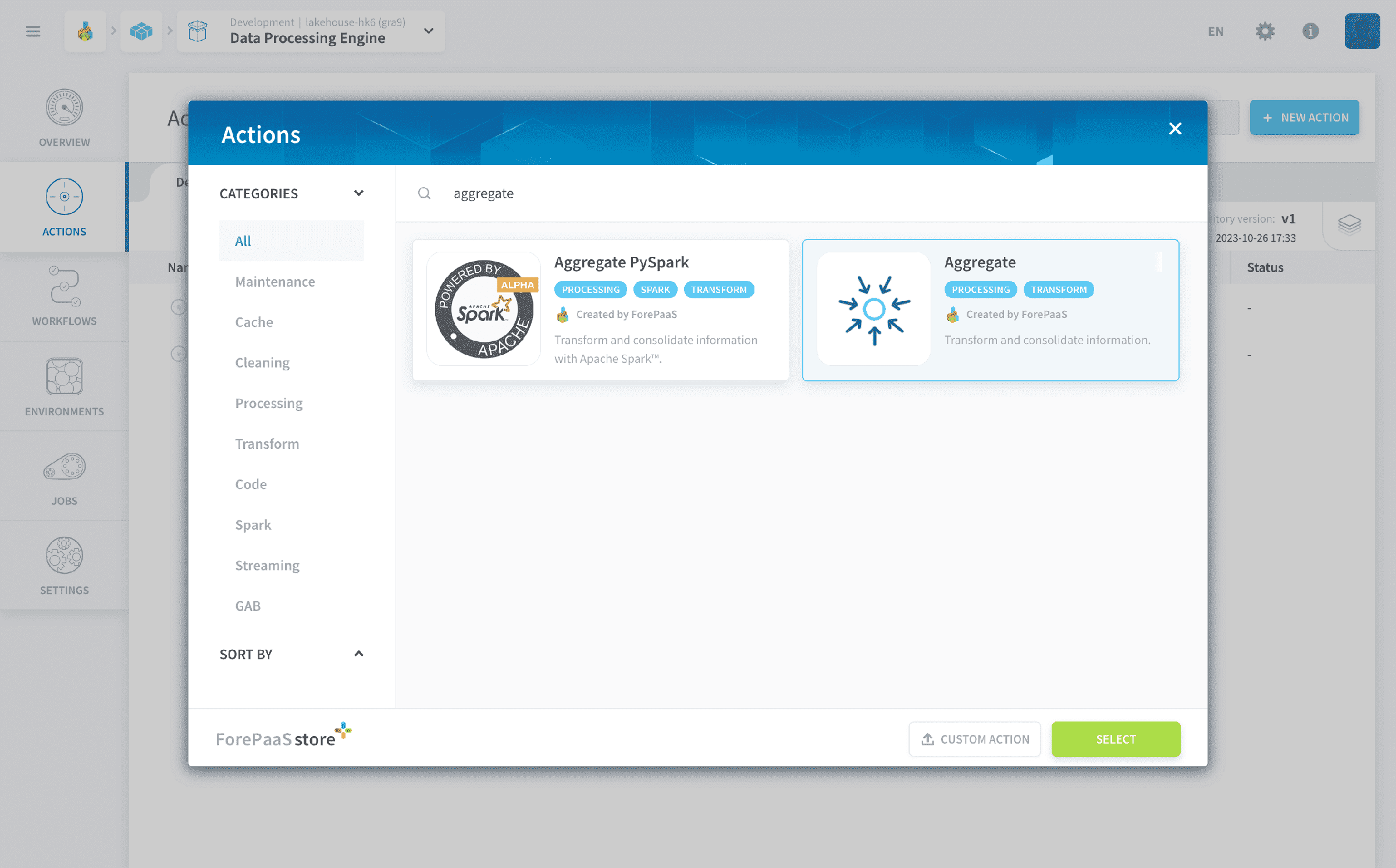

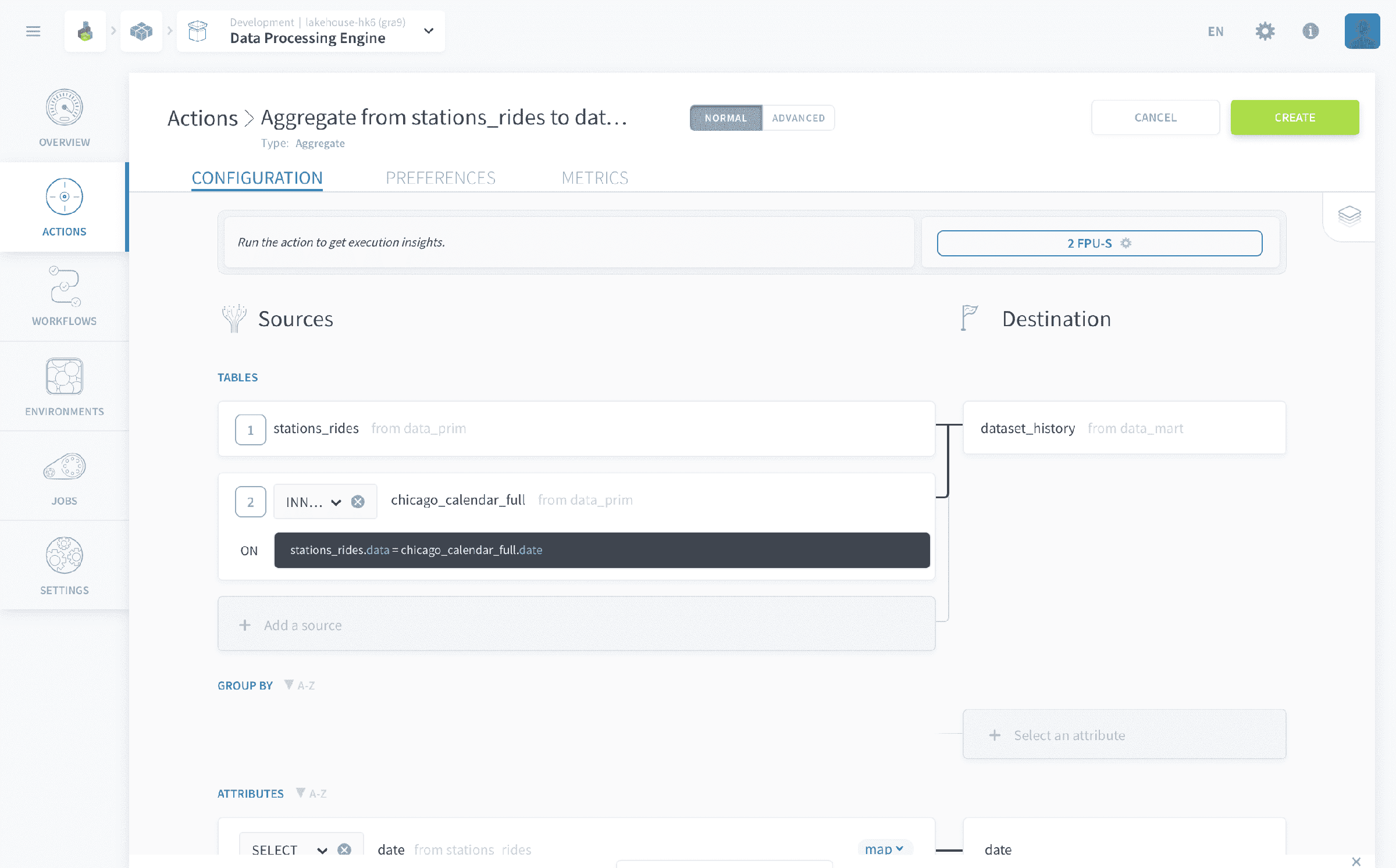

For this tutorial, you will create an action used to aggregate your data into the dataset_history table you created in the previous part.
Click on New action and select the Aggregate action template from the Platform Store.
DPE agg action 1
There will be 2 simple steps to configure the aggregate action:
  • (1) Select a source table : stations_rides
  • (2) Select the destination table: dataset_history
After a couple of seconds, the Data Processing Engine will automatically find all the join conditions required, and map attributes.
Change the join condition to an INNER join using the dropdown menu. This will ensure that you do not have any null fields in the records of your dataset_history table.
DPE agg action 2

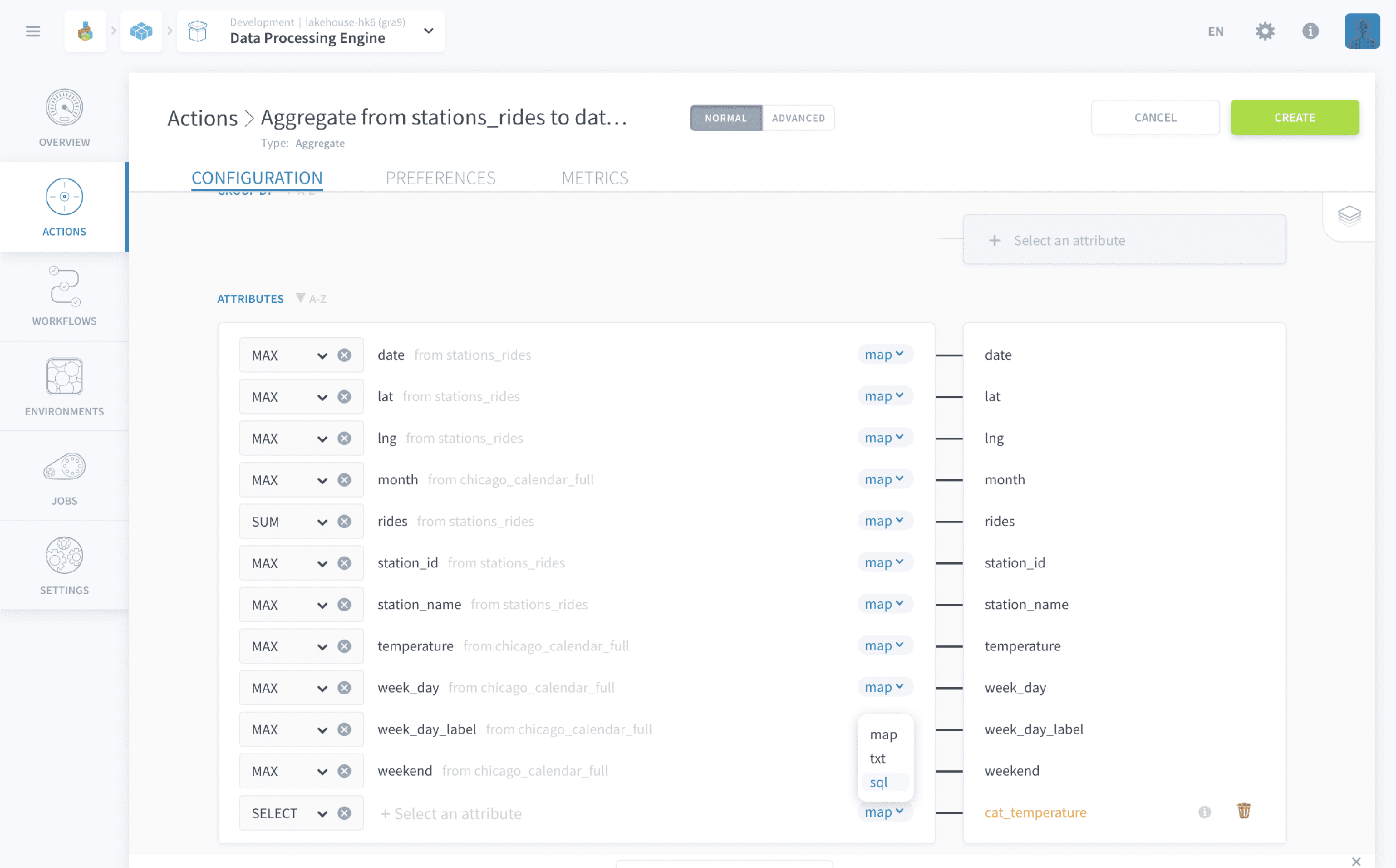

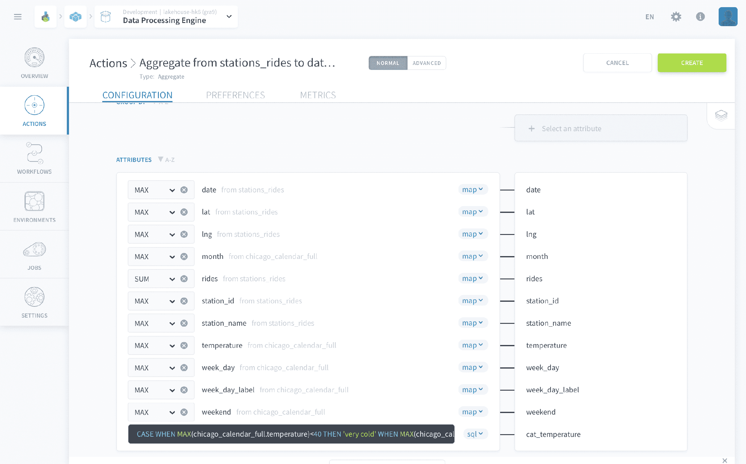

Attributes have been mapped automatically. Find the attribute rides, which is the metric you are looking to aggregate, and switch it to a SUM function. Everywhere else, leave the MAX function as it is: most DBMS require you to apply an aggregate clause to attributes that aren't part of the GROUP BY clause.
DPE agg action 4
Finally, let's define the categorical attribute cat_temperature that you created earlier. Click on the < map > (short for "mapping") option in blue option dropdown as shown below and switch it to < sql >.
DPE agg action 3
Simply copy-paste the SQL command below:
CASE
WHEN MAX(chicago_calendar_full.temperature)<40 THEN 'very cold'
WHEN MAX(chicago_calendar_full.temperature)<48 THEN 'cold'
WHEN MAX(chicago_calendar_full.temperature)<55 THEN 'medium'
WHEN MAX(chicago_calendar_full.temperature)<62 THEN 'hot'
ELSE 'very hot'
END
Leaving a destination attribute unmapped in the Aggregate action configuration will trigger an error when the action is launched. If you'd rather leave the destination field empty, make sure to simply remove it from the list of mapped attributes.
Learn more about Aggregate actions
Click on Create at the top-right.

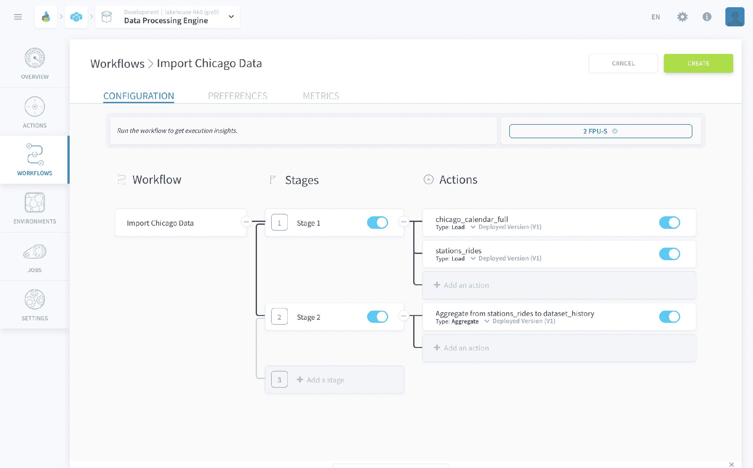

A workflow defines the order in which your actions run.
Within a workflow, actions are organized in sequential stages. Within a stage, all actions will be run in parallel while stages will always run one after the other. The same action can be used multiple times in the same workflow. A workflow, just like an action, can either be launched manually, set up to run on a schedule or triggered through an API call.
Note that it is important to remember that stages are run one after the other in the order you planned them while actions contained in a stage are all run all at the same time regardless of the order. In short, the order of the actions inside a stage does not matter while the stages’ order inside a workflow does.

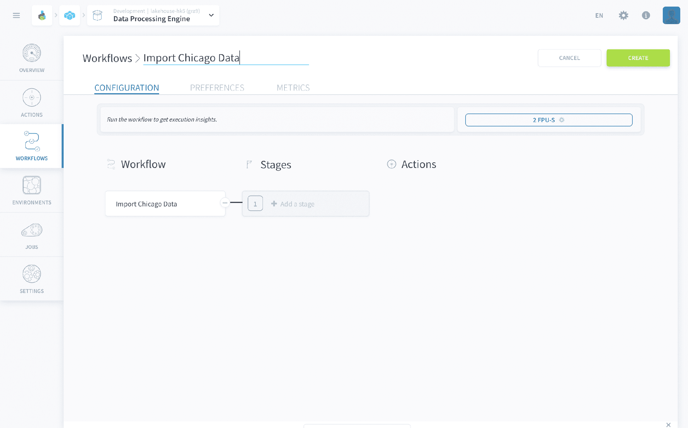

To create your first workflow, you'll need to head to the Workflow tab and click on New Workflow. Head to preferences or double-click on the header name to set a new name Import Chicago Data.
DPE workflow 1
Let's start by defining two different stages by clicking on Add a stage. Then, add actions in each stage using the dropdown search selector following the screenshot provided as a guide for each stage.
DPE workflow 2
After creating the workflow (create), press Play.

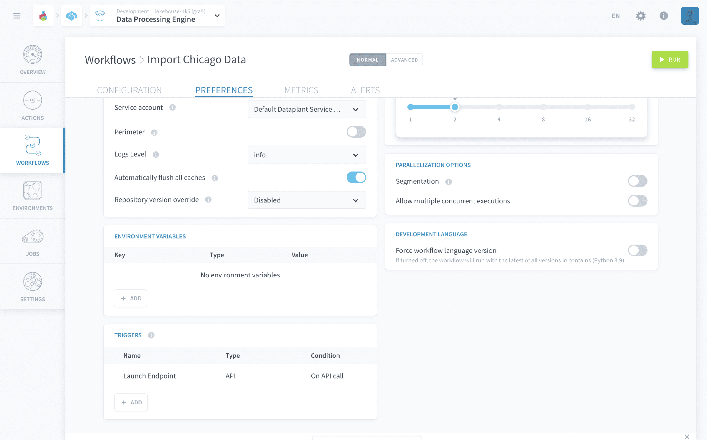

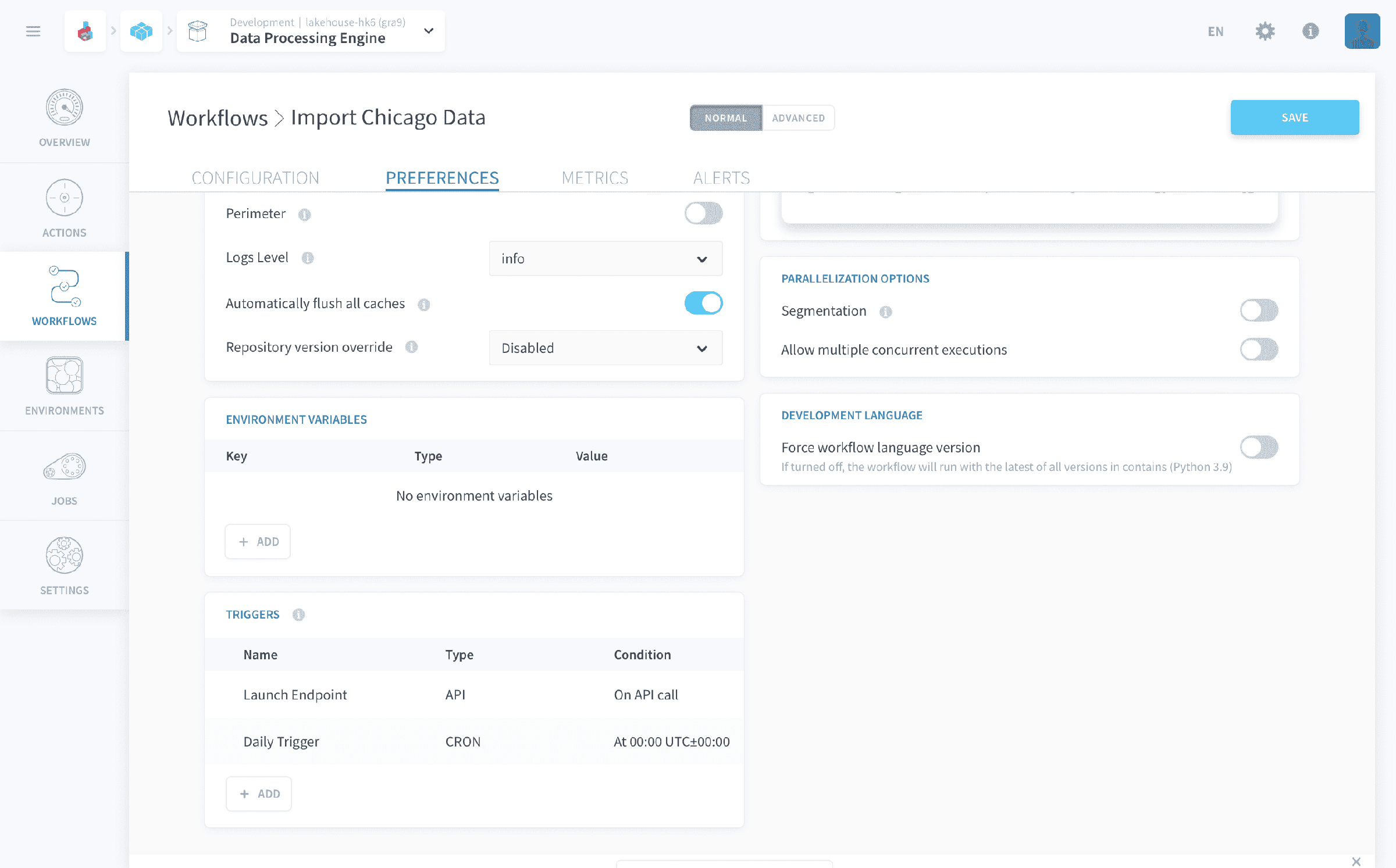

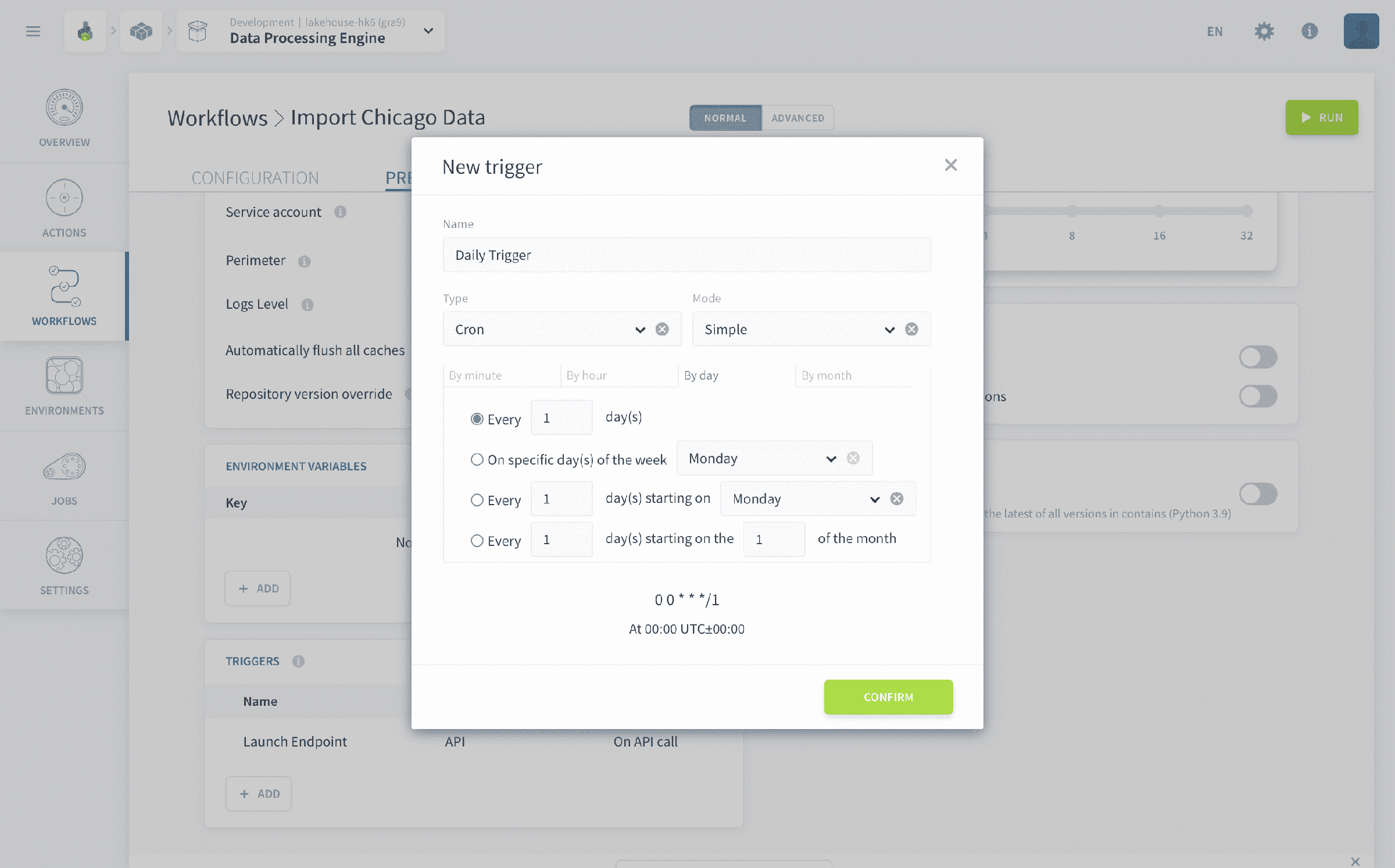

While the workflow is running, something you can do is schedule it to run daily using a trigger.
Head to the Preferences tab of your workflows and scroll to the Triggers widget on the bottom left side. Click +Add.
DPE workflow 4
Select the trigger type as CRON and mode as Simple. Navigate to the Daily tab and in the list of options select Every 1 day(s) as shown in the picture below:
DPE workflow 4
Hit the Confirm button to create the new trigger event with the name of your choice and it will append it below the Launch Endpoint present by default in the Trigger event table.
DPE workflow 5

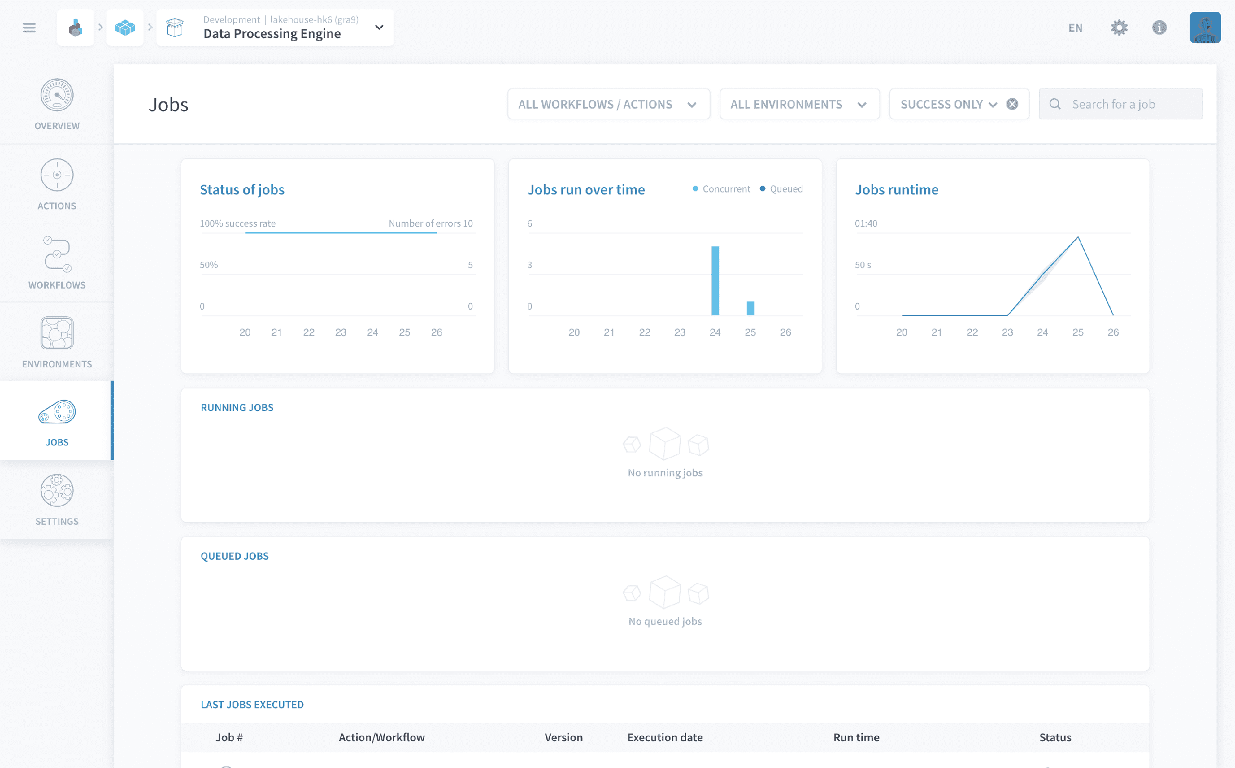

Jobs
To wrap up this section, here are a few words about the last tab of the Data Processing Engine component: jobs.
The Jobs tab summarizes all executions triggered in the Data Processing Engine and includes advanced metrics reports. Jobs are listed under three main categories: running, queued and past executions. Having a look at the last jobs executed, you can verify the status of the workflow you just launched.
DPE Jobs
You now have completed the Data Engineering section of the Getting Started tutorial.

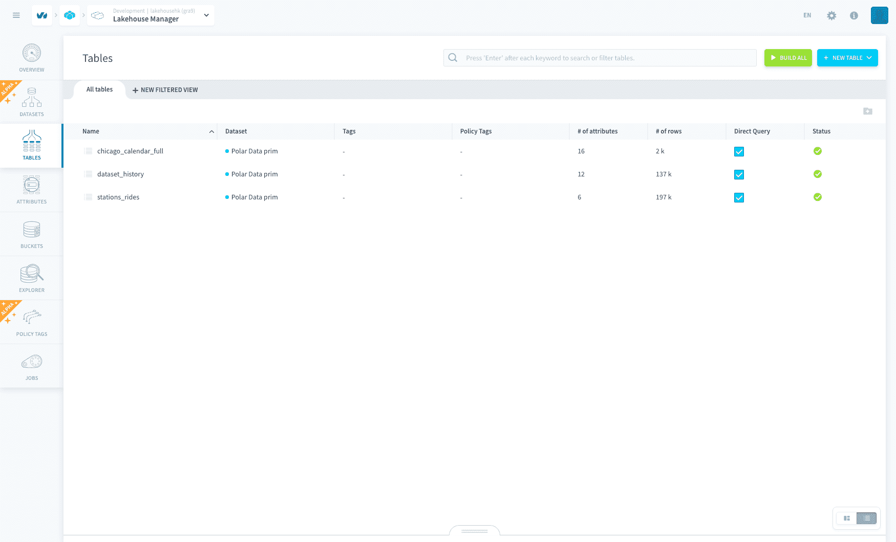

A good way to make sure your data properly loaded is to go back to the Lakehouse Manager and look at the number of rows loaded into the table. Just open the list view mode and check the rows column, if the field has a number (indicating how many rows have been loaded) then everything worked well.
rows loaded
