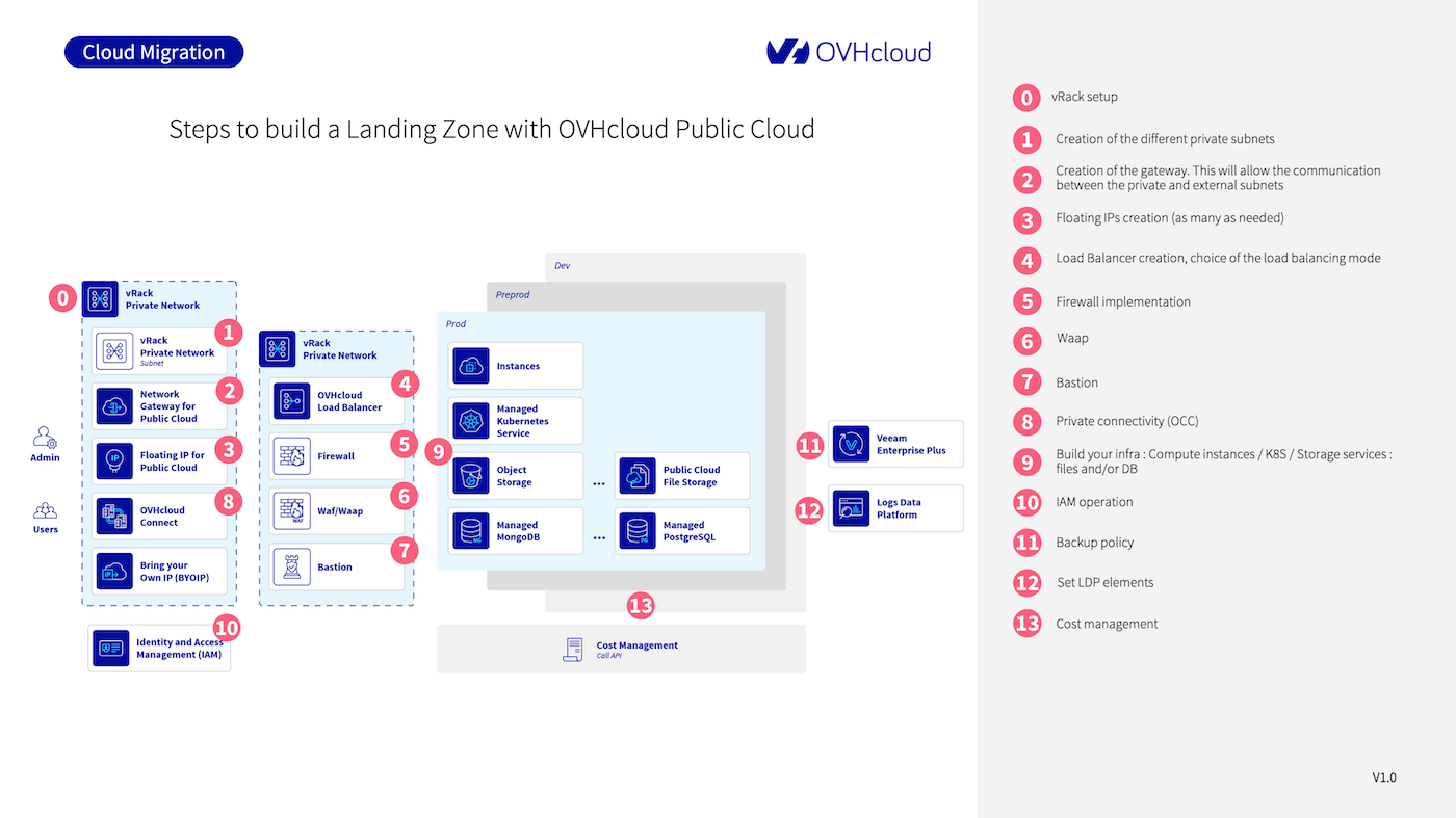

To help you design a secure, scalable, and production-ready cloud foundation, the following diagram illustrates the key steps in building a Landing Zone on the OVHcloud Public Cloud:
Landing zone architecture diagram
Each numbered step corresponds to a component or action in the setup process. Below are detailed explanations for each:
0. vRack setup
A vRack (Virtual Rack) is the foundational component that allows private networking between resources.
When you create a Public Cloud project, OVHcloud automatically provisions a vRack for you. This virtual layer isolates your internal communication and enables secure interconnections between services (instances, databases, gateways, etc.) across regions and even between different OVHcloud services (Bare Metal, Hosted Private Cloud).
You will use the vRack to attach all private subnets and connect public and private-facing services securely.
1. Create a private subnet
Inside the vRack, define private subnets to segment your network. For example, you can have separate subnets for frontend, backend, databases, and bastions.
  • Subnets can be created in different regions.
  • Choose appropriate CIDR blocks to avoid overlap and ease future scaling.
  • Subnets can be layer 2 (flat) or layer 3 (routed with gateway).
Subnet creation is done from the OVHcloud Console, via the OpenStack API, or using Terraform.
2. Set up a Gateway
To enable outbound or cross-zone communication for your private subnet, set up a Network Gateway for Public Cloud. It acts as a NAT device to allow traffic from your private subnet to the internet or other public resources.
  • Required for downloading packages, external API calls, etc.
  • You can route traffic through the gateway to a firewall or WAAP if needed.
  • Each gateway is regional and connects only subnets from that region.
Follow this guide to set up a gateway.
3. Assign Floating IPs
A Floating IP is a public IP that you can attach to a resource (usually an instance or load balancer) within a private network.
Use cases include:
  • Exposing a single VM for SSH access (e.g., for a bastion)
  • Public-facing applications hosted inside a private subnet
  • Failover and migration between zones
Use Floating IPs to expose selected private resources (e.g., instances, services) to the public internet securely. Follow this guide to link a Floating IP.
4. Set up a Load Balancer
An OVHcloud Load Balancer lets you distribute traffic between multiple backend instances in different availability zones.
  • Choose the load balancing mode: HTTP(S), TCP, or passthrough.
  • Supports health checks, SSL termination, and sticky sessions.
  • Integrated with Floating IPs for public exposure or stays private.
This is essential for creating highly available applications and distributing load intelligently.
Follow this guide to set up and use a Load Balancer.
5. Implement firewall rules
Although OVHcloud doesn’t provide a built-in firewall-as-a-service, you can:
  • Use Security Groups on each instance (similar to AWS)
  • Deploy a third-party virtual firewall like Stormshield in your vRack
  • Firewall solutions should inspect north-south (ingress/egress) and east-west (internal) traffic where applicable.
Follow this guide to set up and use a Stormshield firewall.
6. Add WAAP protection
To protect your web and API applications, deploy a Web Application and API Protection (WAAP) service like Ubika.
  • Shields against DDoS, SQL injection, XSS, and OWASP Top 10 threats
  • Offers bot management, WAF, API gateway, and rate limiting
  • Can be inserted transparently between your Load Balancer and backend services
Follow this guide to deploy a WAAP protection with Ubika.
7. Configure a Bastion Host
A Bastion is a secure access point to manage instances located in private subnets. OVHcloud provides a hardened, audited open-source bastion tool for this purpose.
Use it to:
  • Enforce secure, audited SSH access
  • Define fine-grained user permissions (LDAP, AD, IAM)
  • Monitor access logs and session replay
See documentation about Bastion on our GitHub account.
8. Enable private connectivity (OCC)
If you need to connect your on-premise infrastructure or other OVHcloud services securely to the Landing Zone, use OVHcloud Connect (OCC).
  • Dedicated Layer 2 or Layer 3 link between your site and OVHcloud POPs
  • Bypasses the public internet, ideal for compliance and latency-sensitive apps
  • Integrated into the vRack
See this documentation.
9. Deploy your infrastructure
With networking and security in place, deploy your core services:
  • Compute: Public Cloud Instances (GP/CPU/GPU)
  • Containers: Managed Kubernetes Service
  • Storage:
    • Block storage (via volumes)
    • Object Storage (S31-compatible)
    • Public Cloud File Storage (NFSv4)
  • Databases: Managed MongoDB, PostgreSQL, MySQL, Kafka
These services can be managed using the OVHcloud Console, OpenStack CLI, or Terraform.
10. Set up Identity and Access Management (IAM)
IAM is essential for defining who can access what and under which conditions. With OVHcloud IAM, you can:
  • Create and assign roles and policies per user/group
  • Integrate with SAML, OIDC, or use native IAM
  • Isolate access by project, service, or region
See the related documentation.
11. Define backup policies
Ensure business continuity by protecting critical data and workloads:
  • Snapshots: Ideal for short-term recovery or pre-update backups
  • Instance backups: Full images for rollback or cloning
  • Veeam Enterprise: Available for advanced backup/restore workflows
Define a backup strategy aligned with your RPO (Recovery Point Objective) and RTO (Recovery Time Objective).
12. Centralize logging with Logs Data Platform
Logs Data Platform (LDP) allows you to:
  • Aggregate logs from apps, systems, and network devices
  • Create dashboards and alerts (Kibana, Grafana-compatible)
  • Retain logs based on compliance needs (GDPR, ISO 27001, etc.)
This is key for observability, security audits, and troubleshooting. Follow this documentation.
13. Implement cost control and monitoring
Keep control of your cloud spending with:
  • Budget alerts and consumption dashboards
  • API access to cost usage reports
  • Daily/hourly resource tracking
Use tagging, IAM roles, and alerts to link costs to teams, environments, or services. For more information, read this documentation.
