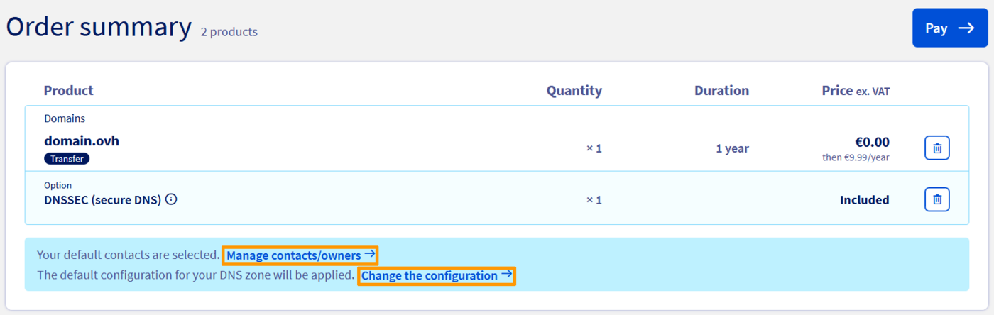

Holder management and DNS server details
  • By clicking Modify configuration in this step, you can enter the names of the DNS servers that the domain name currently uses. This way, the domain name will already be associated with these DNS servers in the OVHcloud configuration.
  • If you continue without performing this operation, the domain name will be provided with a new DNS zone on OVHcloud DNS servers. You may then need to modify the DNS zone manually.
  • In some cases, the transfer process may require additional information about the domain name holder. To add this information, click Manage Contacts/Holder.
