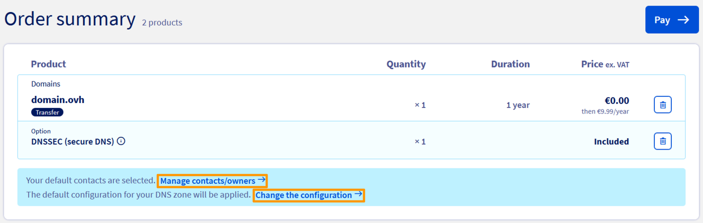

Throughout the order process, we advise taking the following points into account:
  • details of the domain name holder Especially since the GDPR came into effect, it is essential to ensure that information about the domain name holder matches the information stored by your current domain name registrar. This will help you avoid being suspected of domain name theft.
  • entering DNS servers for your domain name. If you are currently using your domain name to keep a website or email service online, you will need to specify their DNS servers in order to avoid any service interruptions.
Holder management and DNS server details
  • By clicking Modify configuration in this step, you can enter the names of the DNS servers that the domain name currently uses. This way, the domain name will already be associated with these DNS servers in the OVHcloud configuration.
  • If you continue without performing this operation, the domain name will be provided with a new DNS zone on OVHcloud DNS servers. You may then need to modify the DNS zone manually.
  • In some cases, the transfer process may require additional information about the domain name holder. To add this information, click Manage Contacts/Holder.
