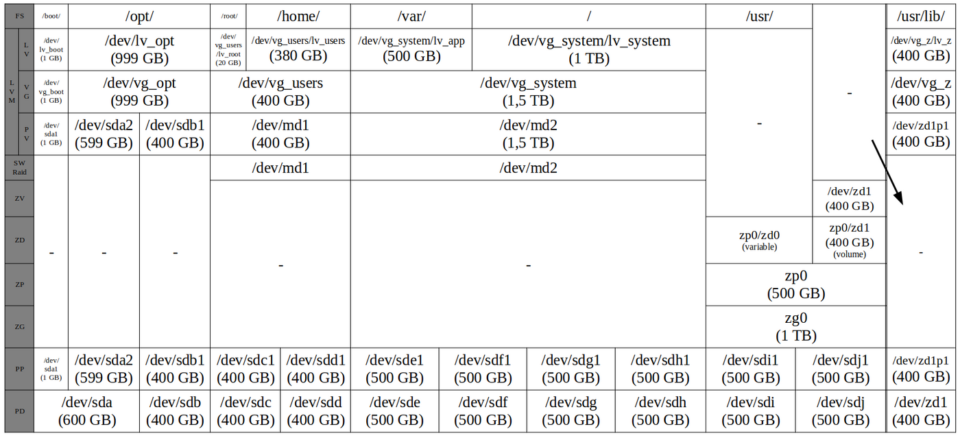

Partitioning
Partitioning layout is about how your data will be organised and seen by the OS, i.e everything that comes on top of your physical disks (or virtual disk if you have configured hardware RAID), up to the filesystem that is mounted, from the lowest to the highest layer:
  • disk (physical/virtual disk, PD),
  • partition (physical partition, PP),
  • ZFS: vdev (zgroup, ZG), zpool (ZP), ZFS dataset (ZD), ZFS volume (ZV),
  • software RAID (SR),
  • LVM: physical volume (PV), volume group (VG), logical volume (LV),
  • filesystem with a mountpoint (FS)
The following table provides an overview of the different partitioning components and how these layers interact with each other:
Partitioning Layers Table
In the table above, /dev/zd1 represents a ZFS volume (also known as zvol). This is a virtual disk on top of ZFS dataset (ZD) and a zpool (ZP), that is seen as a normal physical disk (PD) by the Operating System. This feature is not available on the OVHcloud API and we do not plan on implementing it.
