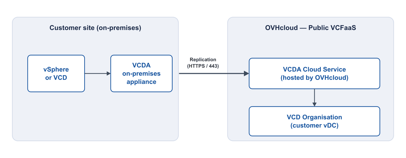

Solution architecture
The diagram below shows the data flows between your source site and your Public VCF as-a-Service organisation:
The VCDA on-premises appliance is free and provided by Broadcom. No additional licence is required on the OVHcloud side to use the Public VCF as-a-Service migration feature.

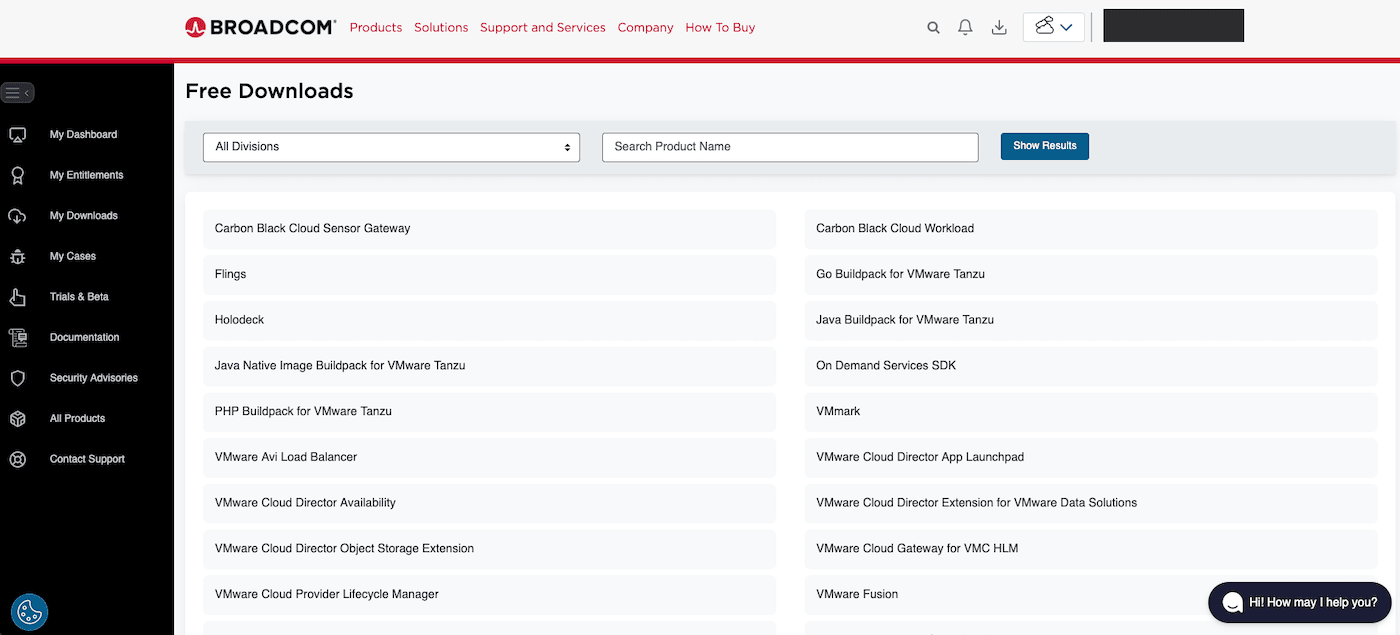

Log in to the Broadcom Support portal with your account.

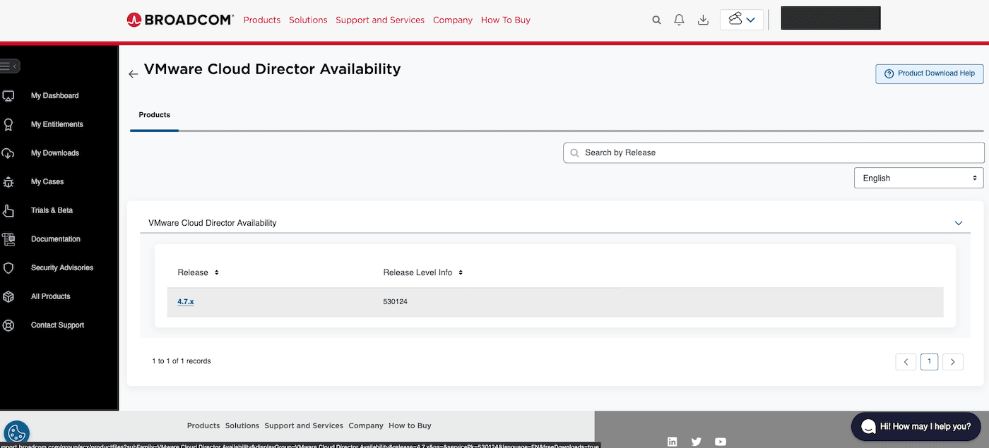

On the Free Downloads page, locate the VMware Cloud Director Availability entry.

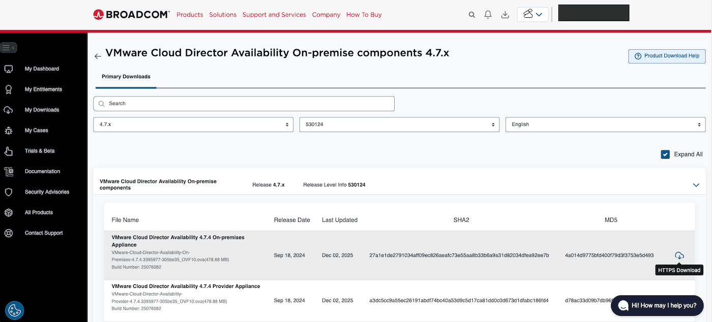

Select the latest available version (4.7.x at the time of writing).
Then download the VMware Cloud Director Availability On-premises Appliance (OVA file). Keep this file — you will use it in the next step.

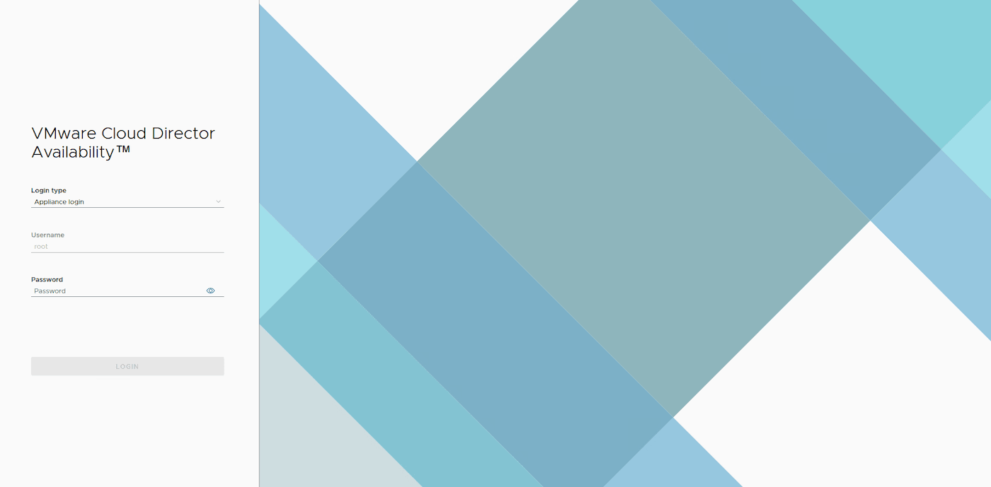

Step 3: Connect to the appliance administration portal
Once the appliance is deployed and powered on, access its web interface from a browser:
Log in with the root account and the password defined during deployment.

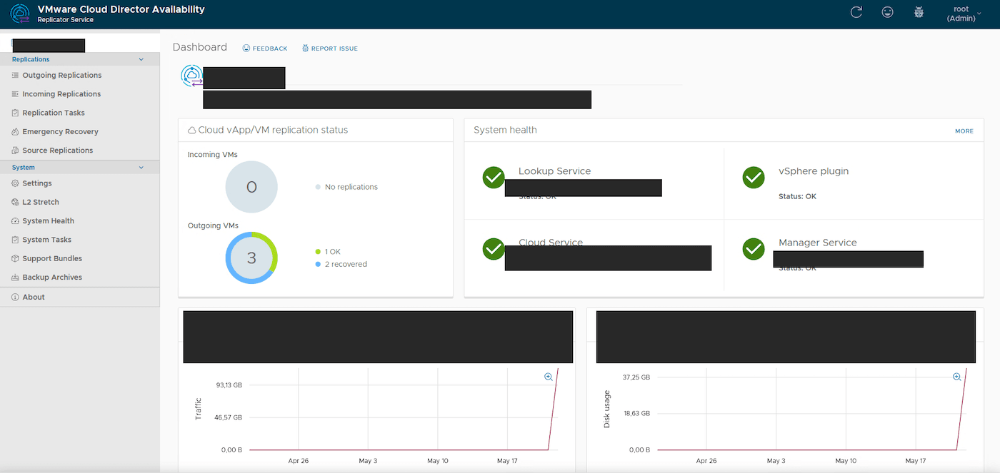

The initial setup completes automatically. The main dashboard of the appliance is then displayed:
In the System health section, check that the following services have the OK status:
- Lookup Service
- vSphere plugin
- Cloud Service
- Manager Service
If one of the services is in error, check:
- the network connectivity between the appliance and your vCenter;
- the validity of the SSO credentials;
- that the appliance has Internet access on port
443.

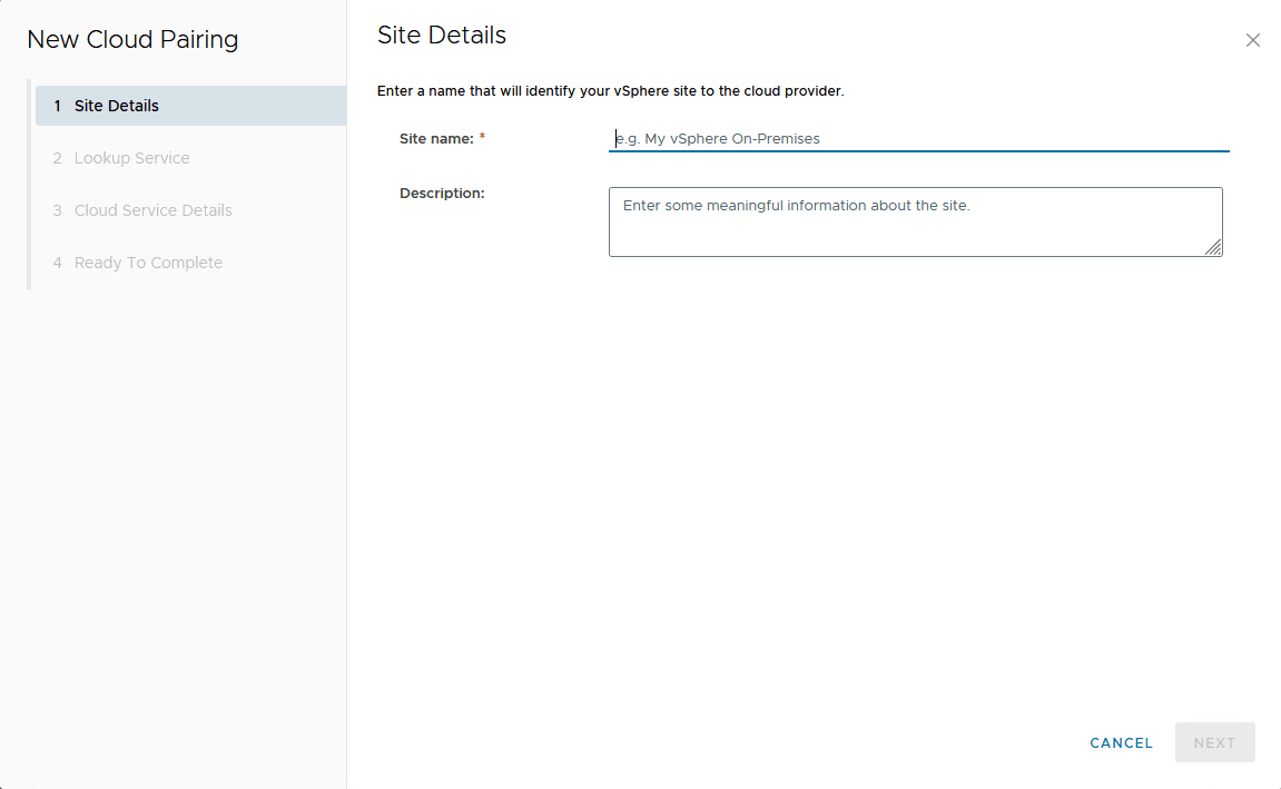

Step 5.1: Site Details
Enter the information identifying your site to the cloud provider:
Click Next.

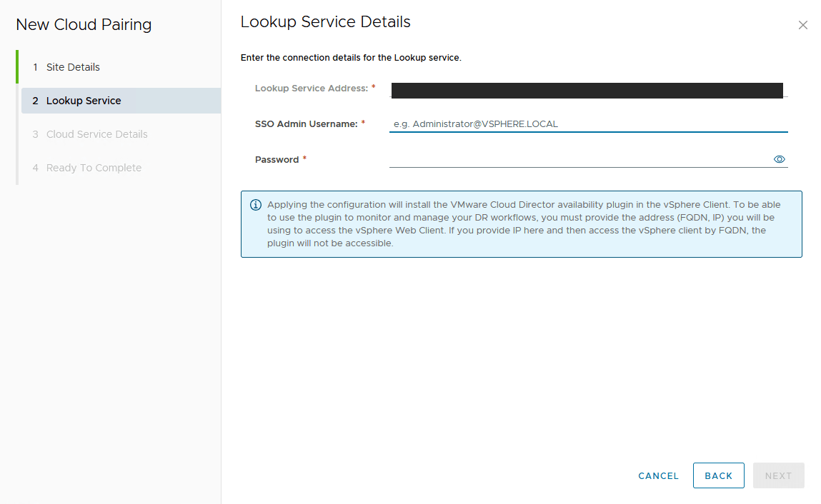

Step 5.2: Lookup Service
Enter the connection details for your source vCenter Lookup Service:
Applying the configuration installs the VMware Cloud Director Availability plugin in your vSphere Client. To be able to use the plugin, the address you enter (FQDN or IP) must match the one you will use to access the vSphere Web Client.
Click Next.

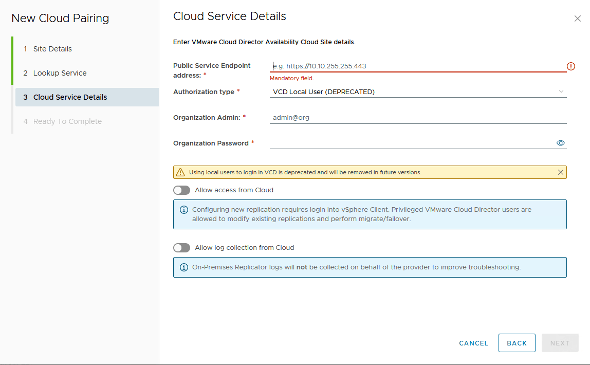

Step 5.3: Cloud Service Details
Enter the connection details for the OVHcloud VCDA service associated with your Public VCF as-a-Service organisation:
You can also enable the following options:
- Allow access from Cloud: allows OVHcloud to modify existing replications and perform migrate/failover operations from the Cloud Director portal;
- Allow log collection from Cloud: allows OVHcloud to collect on-premises appliance logs for support purposes.
Click Next.
