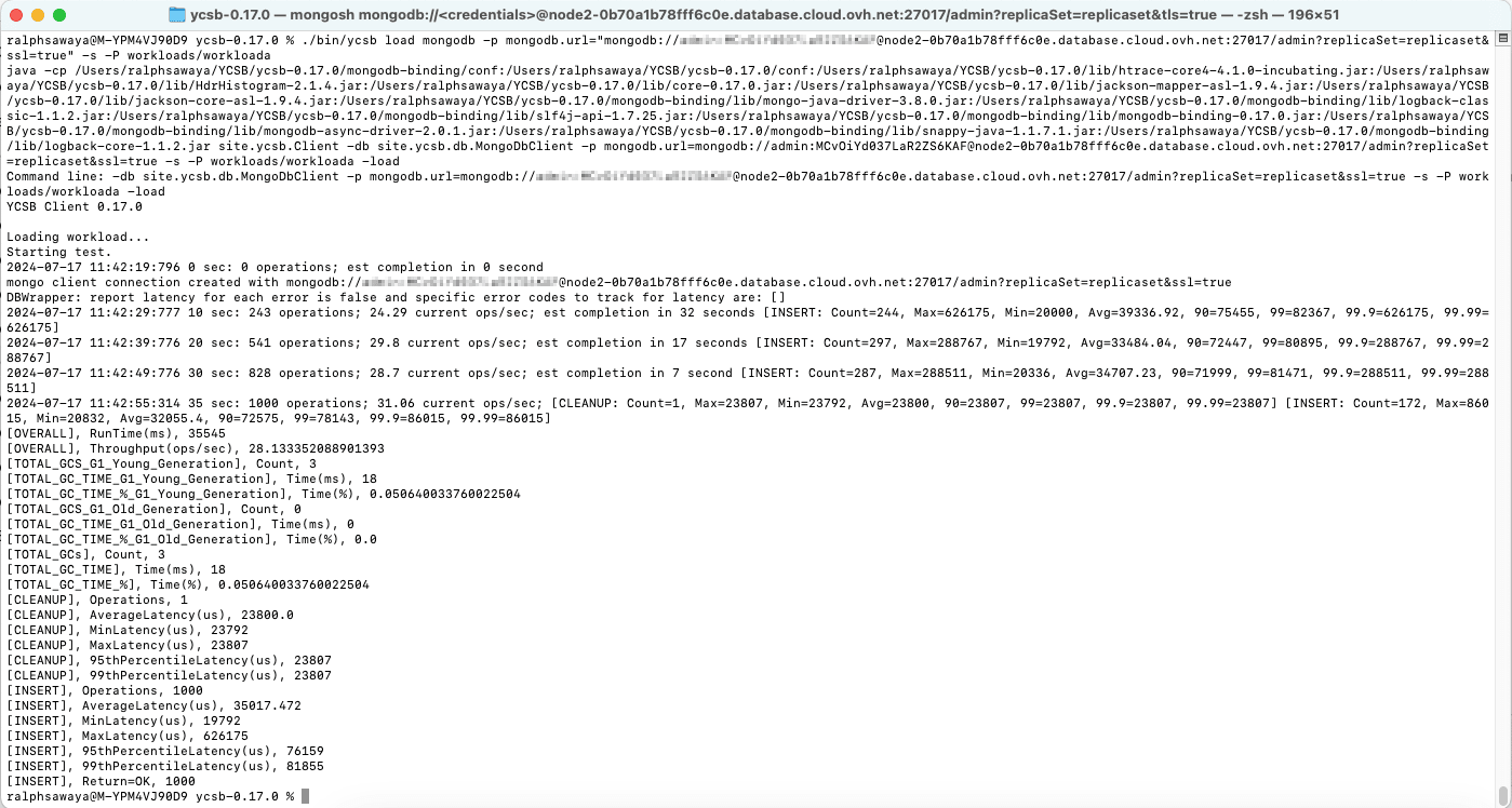

Step 4: Load Data into MongoDB with YCSB - Example Loading the Provided workloada
For more details on how to run a workload, see YCSB Run a Workload.
While located in the ycsb-0.17.0 directory, execute the following command with the provided workloada to load data into MongoDB.
./bin/ycsb load mongodb -p mongodb.url="mongodb://myuser:mypassword@node2-0b70a1b78fff6c0e.database.cloud.ovh.net:27017/admin?replicaSet=replicaset&ssl=true" -s -P workloads/workloada
YCSB Load
Verify that the database ycsb and collection usertable got created and loaded with data.

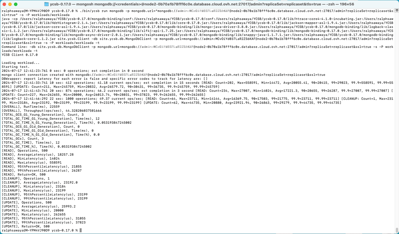

Step 5: Run The YCSB Workload - Example Running the Provided workloada
While located in the YCSB > ycsb-0.17.0 directory, execute the following command with the provided workloada to run the workload.
./bin/ycsb run mongodb -p mongodb.url="mongodb://myuser:mypassword@node2-0b70a1b78fff6c0e.database.cloud.ovh.net:27017/admin?replicaSet=replicaset&ssl=true" -s -P workloads/workloada
YCSB run
Step 6: Analyze and Benchmark the YCSB Output Metrics
Take note of the run command output in Step 5, and benchmark it with other databases.

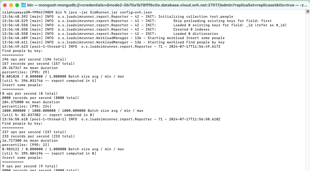

  • Run performance tests using SimRunner on your MongoDB cluster: java -jar SimRunner.jar <config file>. Here is an example of a configuration file:
    "connectionString": "mongodb+srv://myuser:mypassword@mongodb-8fff6c0e-o01ba0bef.database.cloud.ovh.net/admin?replicaSet=replicaset&ssl=true",
    "reportInterval": 1000,
    "http": {
        "enabled": false,
        "port": 3000,
        "host": "localhost"
    "mongoReporter": {
        "enabled": true,
        "connectionString": "mongodb://localhost:27017",
        "database": "simrunner",
        "collection": "report",
        "drop": false,
        "runtimeSuffix": false
    "templates": [
            "name": "person",
            "database": "test",
            "collection": "people",
            "drop": false,
            "template": {
                "_id": "%objectid",
                "first": "%name.firstName",
                "last": "%name.lastName",
                "birthday": "%date.birthday"
            "remember": ["_id", { "field": "first", "preload": false}],
            "indexes": []
    "workloads": [
            "name": "Insert some people",
            "template": "person",
            "op": "insert",
            "threads": 1,
            "pace": 100,
            "batch": 1000
            "name": "Find people by key",
            "op": "find",
            "params": {
                "filter": { "_id": "#_id" }
            "threads": 4
SimRunner run
  • The report output, mongoReporter, of the execution was set to be stored on the locally running MongoDB: "connectionString": "mongodb://localhost:27017"
SimRunner output
